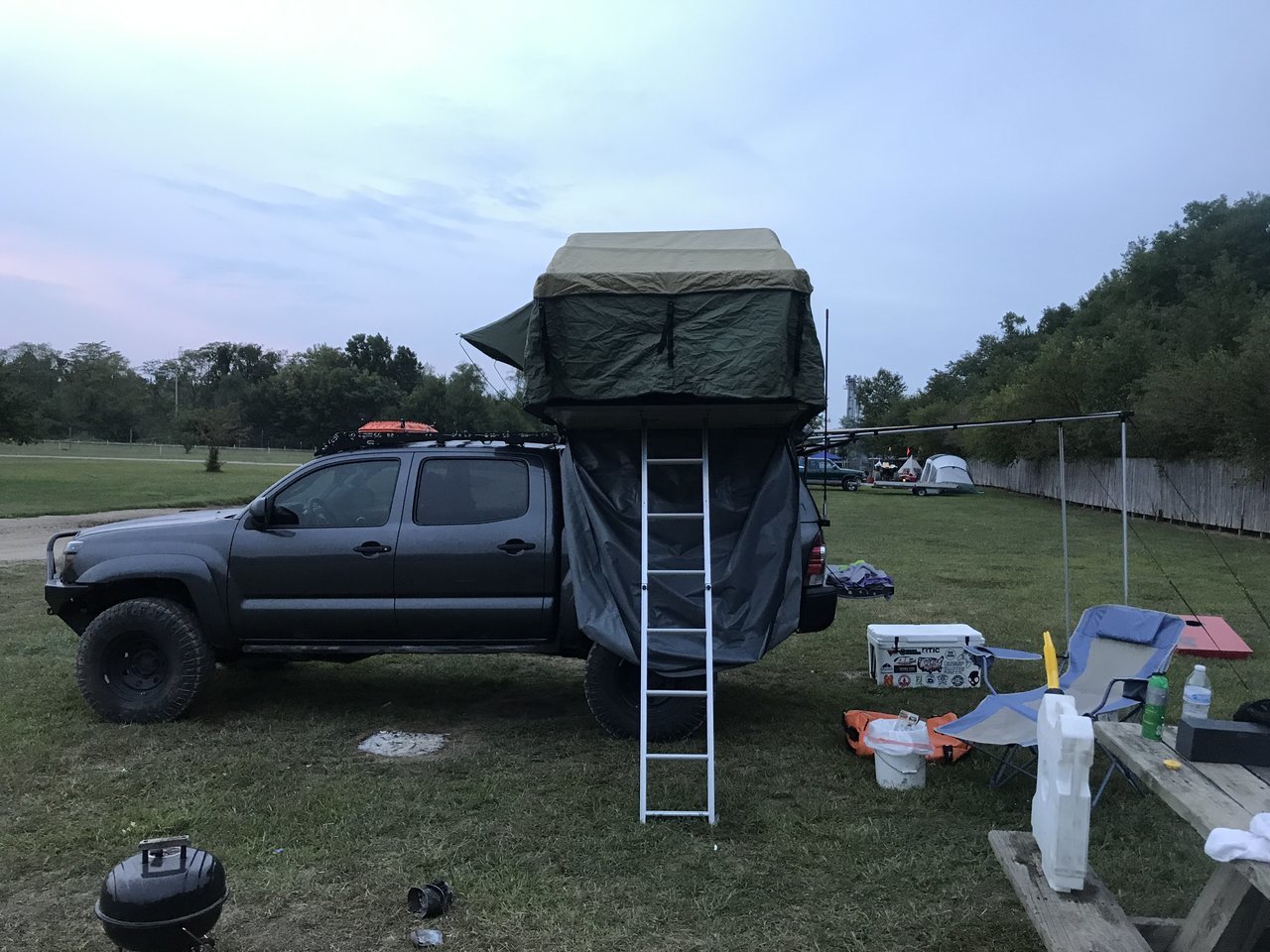

    Can't wait to get my rack in, getting some great ideas from you guys! Anybody ever mount a rtt on their prinsu or is that too much weight?

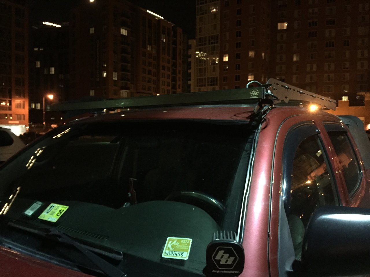

    Probably not the coolest shit, but I ended up hacking up my old mcm fab bolt on light bar mounts that I had to cut and extend out with a welder to fit my 52 inch bd light bar. When adding it to the rack I just cut off the bottom roof points on the mounts and then drilled holes to mount up.
    Going this route made a hell of a channel with the light bar in front of the wind fairing and was quite turbulent at speeds approaching 50 mph and got worse after that. Given that my rack generally sits unloaded unless on trail, I removed the wind fairing. Now my truck doesn’t make a sound unless I hit 65 as that’s when the wind starts to echo off the light bar like it used to before the rack. I know this rack is prettier with the wind fairing, but if I didn’t have the light bar I would still run it without the wind fairing just due to the noise alone.

    Prinsu works great for rtt's
    ScubaSteve318[QUOTED] likes this.

    Ah I see your interest now as it sounds like you learned the hard way like I had to. I ended up cutting the front tip about 2 inches off from the front and then got a steel strip and cut 1.5 inches off and welded that on at a 90 degree. Sure it’s not as aero as a 45 degree slant, but it works fine. Considering mcm is the cheapest for a mount, it’s a no brainer to get their product but if you got a welder or access to a shop or someone who does, job can be done in like 20 min. As far as finding mounts for a 52 inch, you likely also know like I do that they don’t exist. It was sad to realize that bd didn’t even know who to recommend for a light bar mount. I’m pretty sure that bd carries the light bar cover as they had to dig around to find the skinnier stealth bar cover for mine...they just don’t always post items like that on their site. Give them a call and they should have it.

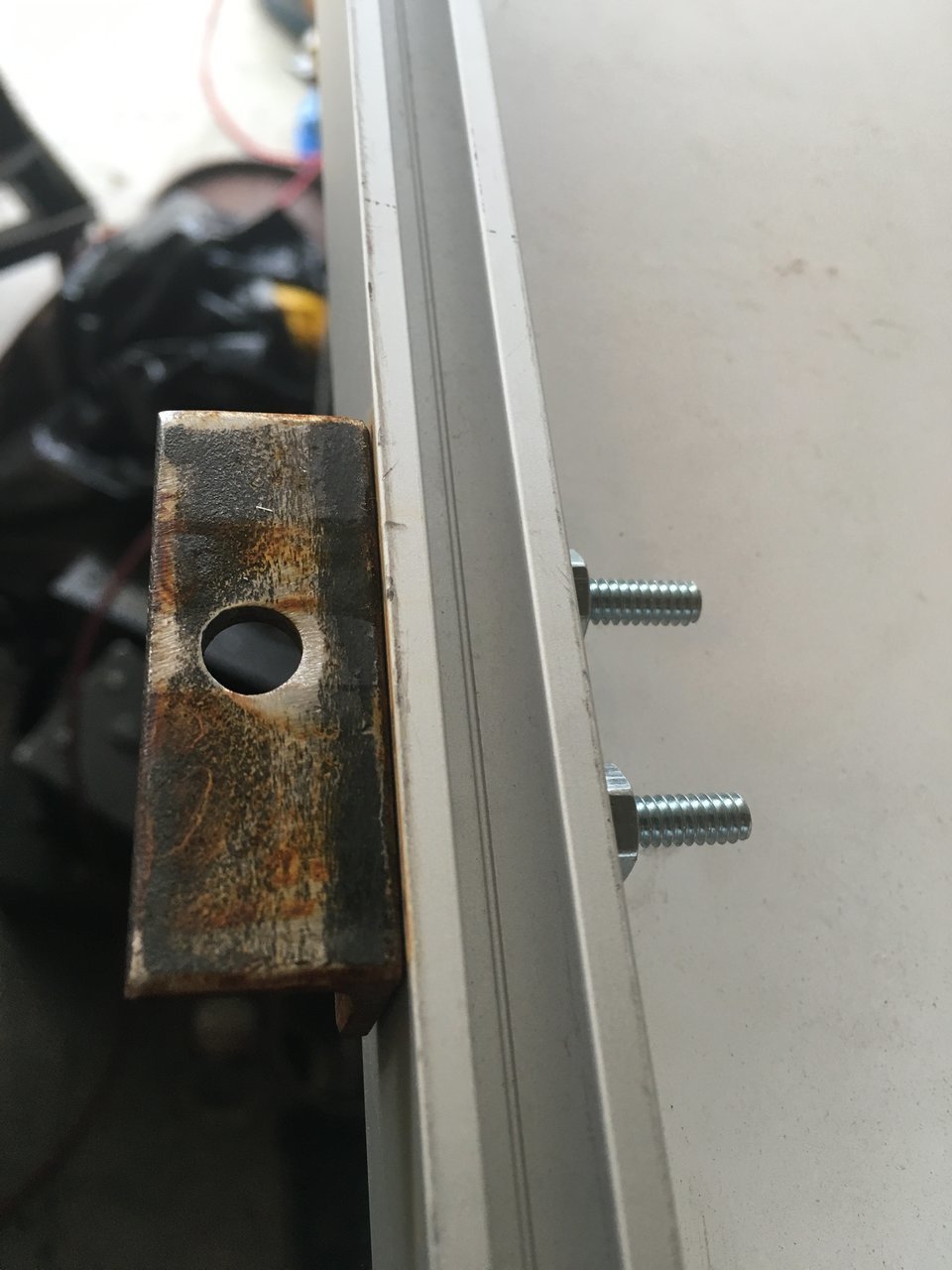

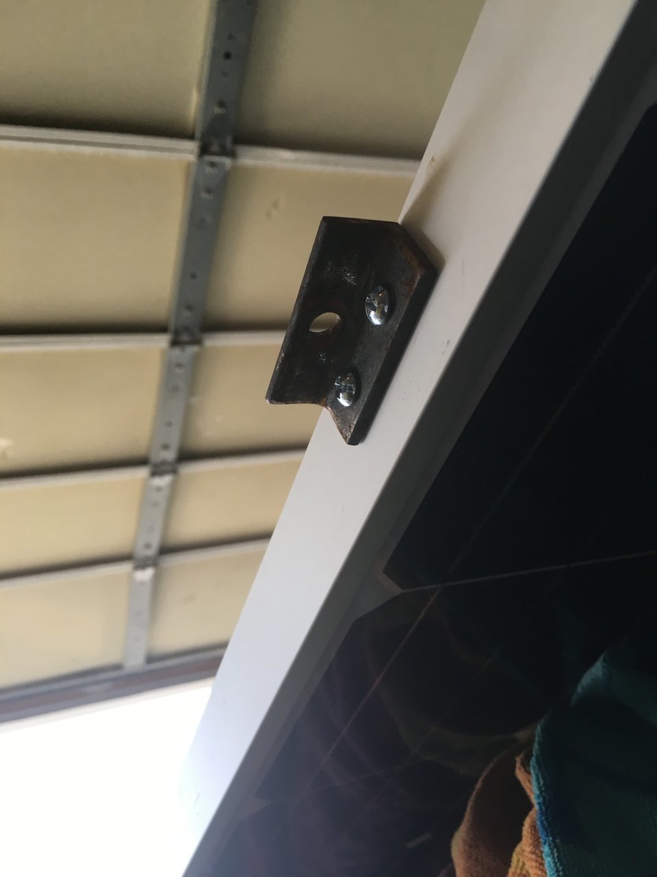

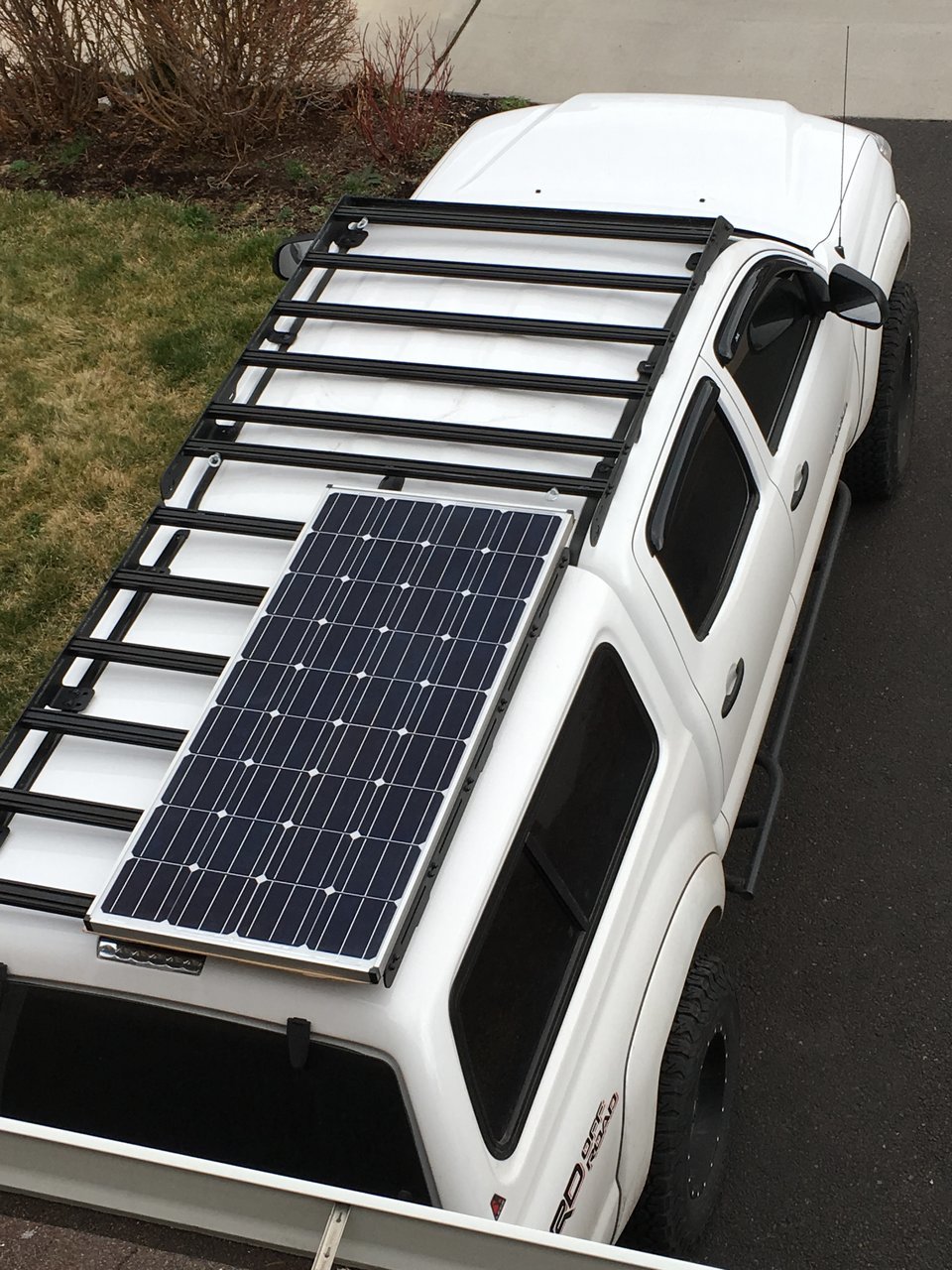

    whats up tacoma nerds alike, just trying to see if anyone has good solar panel mounting solutions with (photos). upon searching i found lots of mounted panels on prinsu racks. i know they exist but no good up close mounting photos. using angle brackets like id mount traction boards seems like a good start. thanks

    Not sure if this helps but here’s what I did.

    4-6 carriage bolts with bolts should mount that sucker up pretty easily on the roof rack.

    Thanks! Aluminum angle brackets seem to be the way to go. Ill be installing it on a cabrac. What are the dimensions of your panel?

    It’s a zamp 160w. (58.3” x 26.3“ x 1.5”).
    EDIT.... incorrect dimensions.
