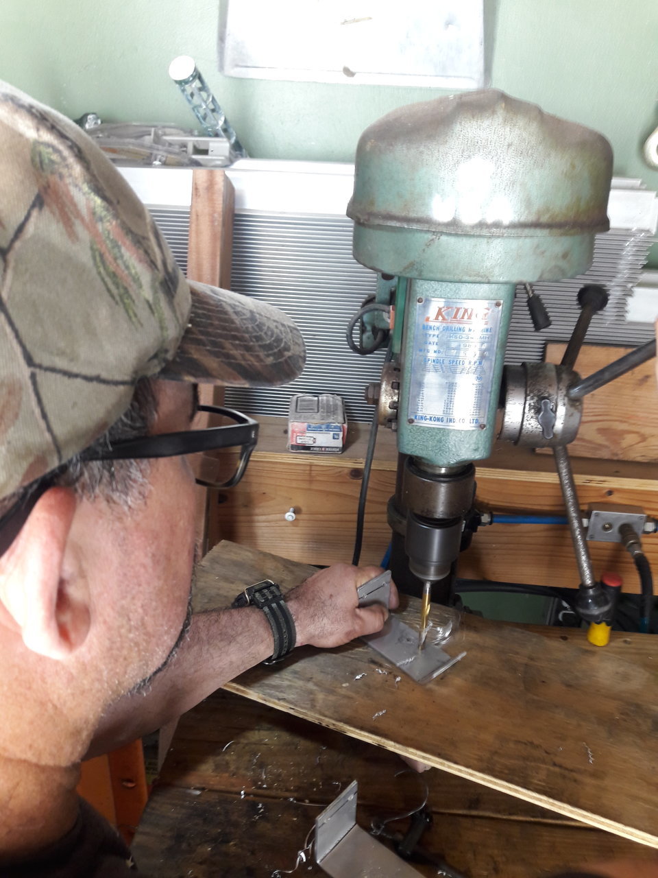

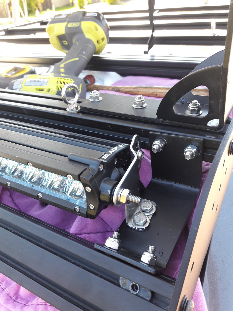

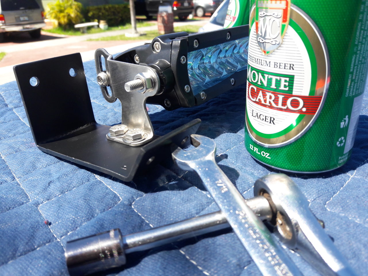

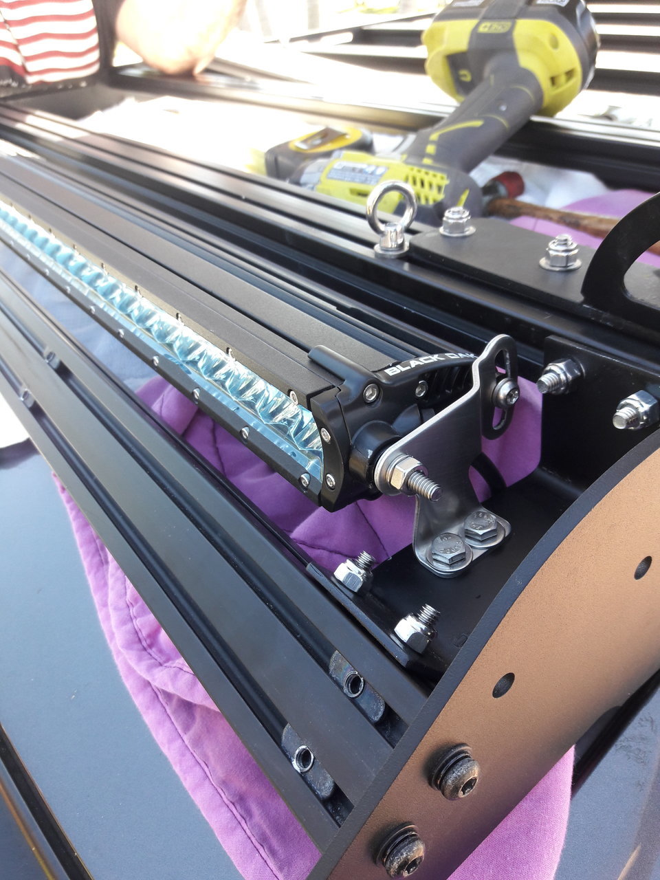

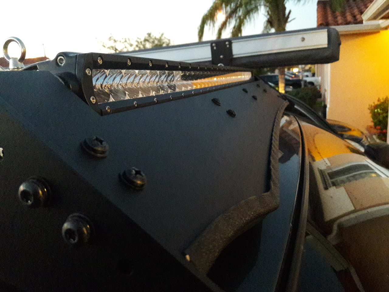

    I finally bought an L.E.D. light bar. I went with Blackoak LED 40". The vision I had was for the light bar to be behind the wind deflector but also below the 1st load bar. There were no brackets that would give me the look I wanted so I made aluminium brackets to make it happen. See below pics hope this helps.

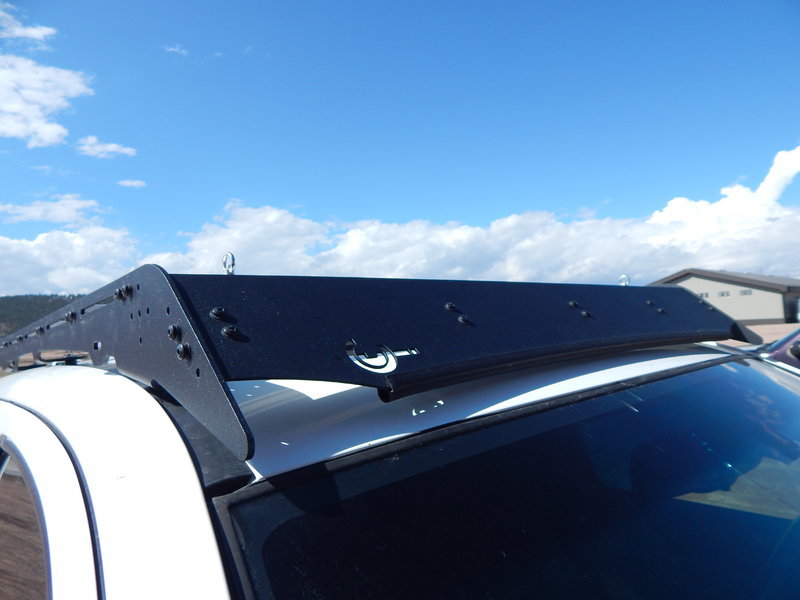

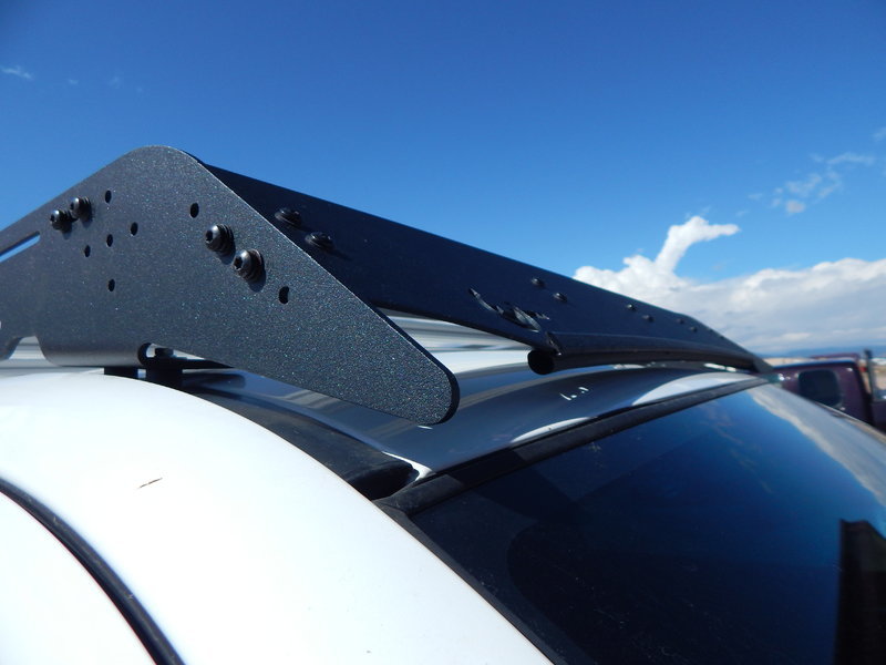

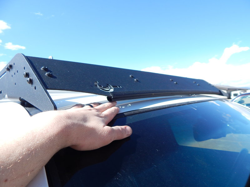

    Why did you cut your edged weather strip so short? It's suppose to go from end to end.

    I dont think there is any reason to have it at each emd where wind still goes through cause design. Probably why he did it. I left mine all the way but there is no difference in arodynamics

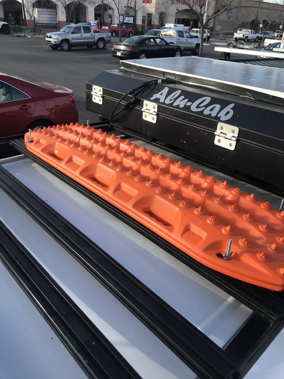

    Best in my opinion is using some 1/4-20 carriage bolts slid into the t slots. I wasn’t desperate to drill new holes or fabricate a new mount and this has worked great for probably 10,000 miles.

    1/4-20 carriage bolts are a perfect fit, FWIW.
    Wing nuts with nylon bolts is a good idea - I hadn’t thought of that.

    Nice and easy. I suppose you could throw on a couple small cable locks for security.

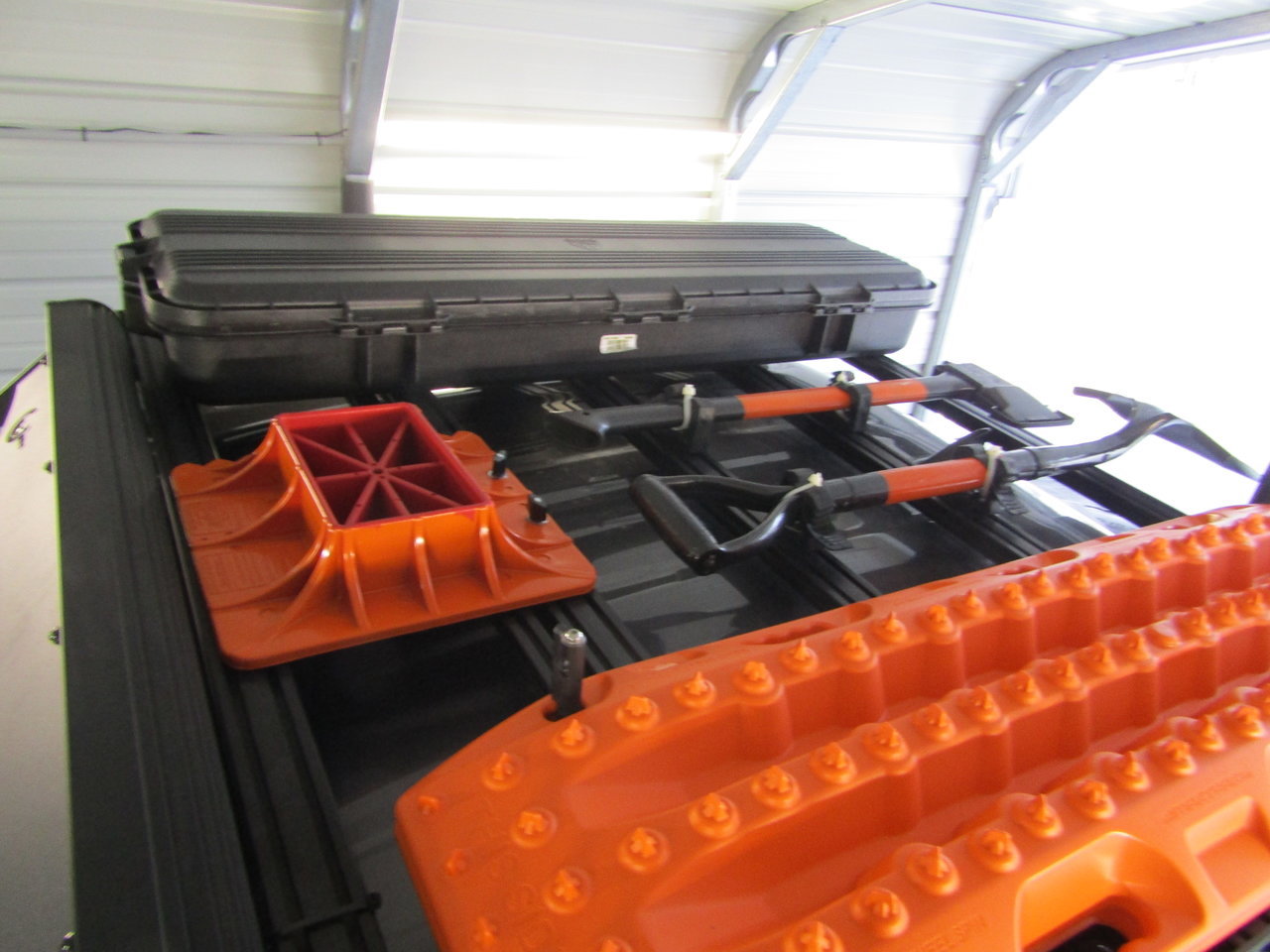

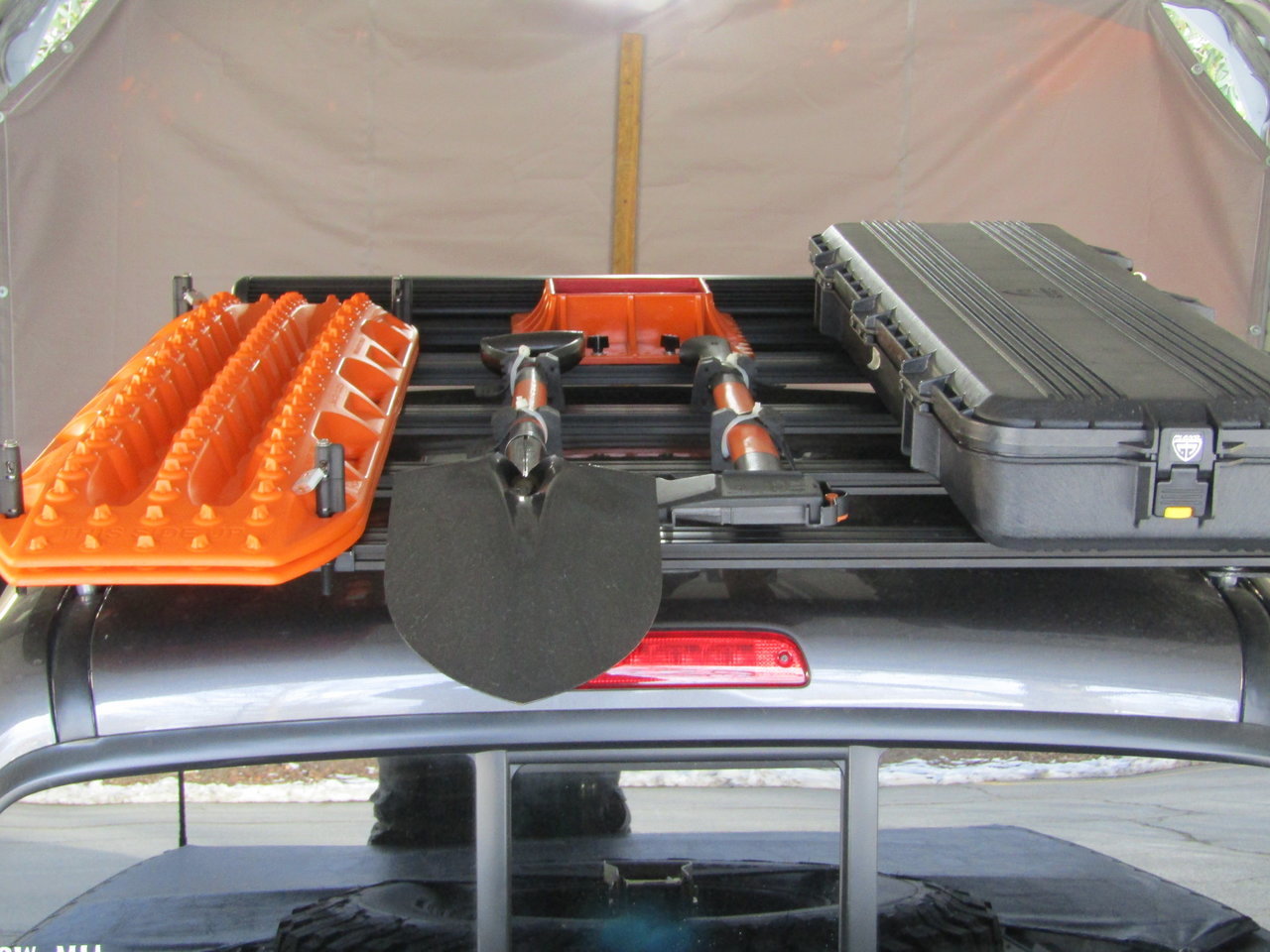

    finished getting stuff mounted..did the Alum angle for the Max Trax..very neat install..the 1/4 x 20 bolts are sweet..spent some time finding all the hardware in SS but it was worth the time...IMG_0203.jpg IMG_0201.jpg
