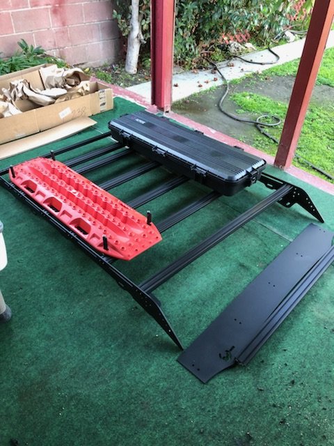

    What are you using to secure that hi lift base? And how did you mount that case? Just drill 4 holes for the carriage bolts and use a little bit of silicone to seal the holes when installing the nuts?

    Hi Lift Base uses 2 - 1/4 x 20 carriage bolts, and a pair of plastic wing nuts with brass inserts,, small dab of thread lock (soft).....pretty much yup on the case,,,did use fender washers inside the case to spread out the contact area some

    didn't mention it but th fender washers have a rubber washer same size under them.....so far no rattle from the hi lift base, but there is a a small rubber pad under the leading side also..

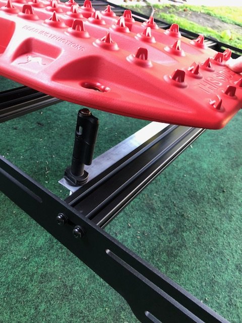

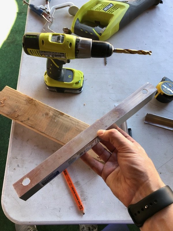

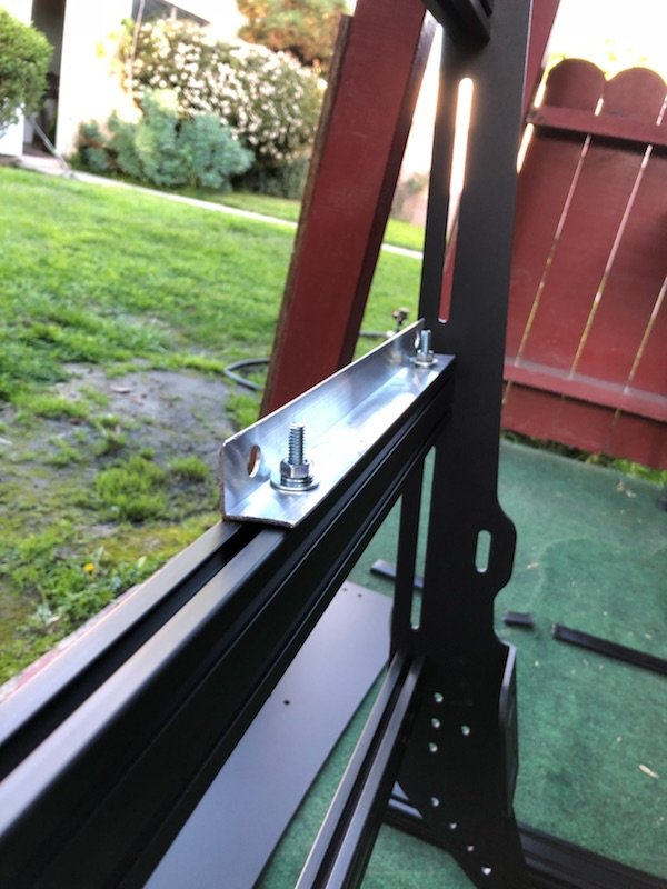

    Heres a few pics from my MaxTrax mount...
    I cut a 45 degree metal corner trim to the width of the maxtrax and drilled holes to fit the mounting pins and 1/4" carriage bolts

    Looking good. It's a nice clean mounting solution for sure. Been using mine for about 4 years with now issues.

    Definitely, with my OCD things gotta be clean and straight and very detail oriented. I couldn't find a square u bolt for the plano. I went with a rounded 2" u bolt and its bothering me knowing its not square. lol gonna try Amazon!
