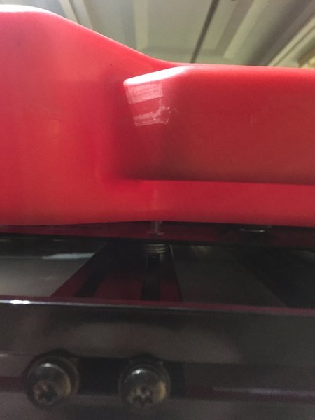

    Got my maxtrax mounted up to the prinsu plates and after tightening everything down I noticed one of the maxtrax mounting pin bolts makes contact with the topper. Just leave it or take it down and cut it? Never planning to put anything as heavy as a rtt on. One of the maxtrax pins crossthreaded during install as well.
  12. Sep 10, 2018 at 7:51 PM
    #312
    BraskaTaco
    BraskaTaco Well-Known Member
    Jan 11, 2016
    #174711
    2,144
    Midwest
    2013 Tacoma TRD OR
    Guess I'll :sawzall:

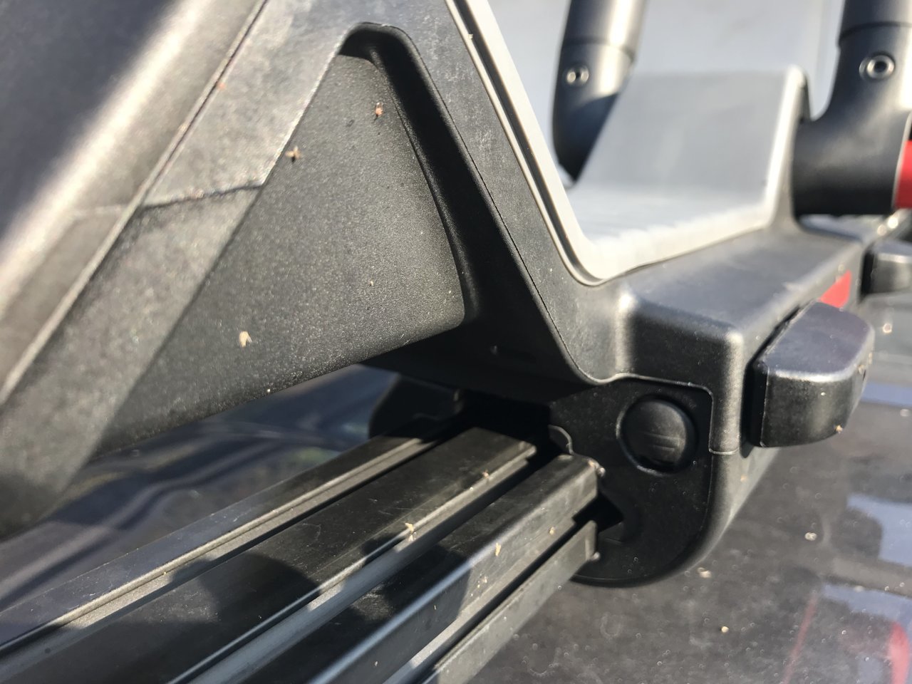

    I have the same universal plate and mounted it up. Don’t like how the bolts that slide into the cross rails stick up forcing the rotopax to sit on each bolt. I’m afraid once secured down each bolt can damage the rotopax.
  16. Oct 17, 2018 at 4:58 AM
    #316
    JHEAL77
    JHEAL77 "I love mom"
    Aug 12, 2017
    #226675
    602
    John
    Cincinnati, OH
    2015 Black Tacoma TRD Off Road
    You could get t-nuts and screw the universal plate down with the appropriate sized button head screw to eliminate that concern.
