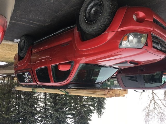

    I’ve got the old school Prinsu with the set in place feet but ran into the same issue as you due to the curvature from front to back and the set feet. I was given a few pieces of cut rubber coated pipe as spacers and they’ve worked great. Never had an issue and have carried up to 40 16’ 2x4s on it. I do have the cabrac too though so that helps with the length.

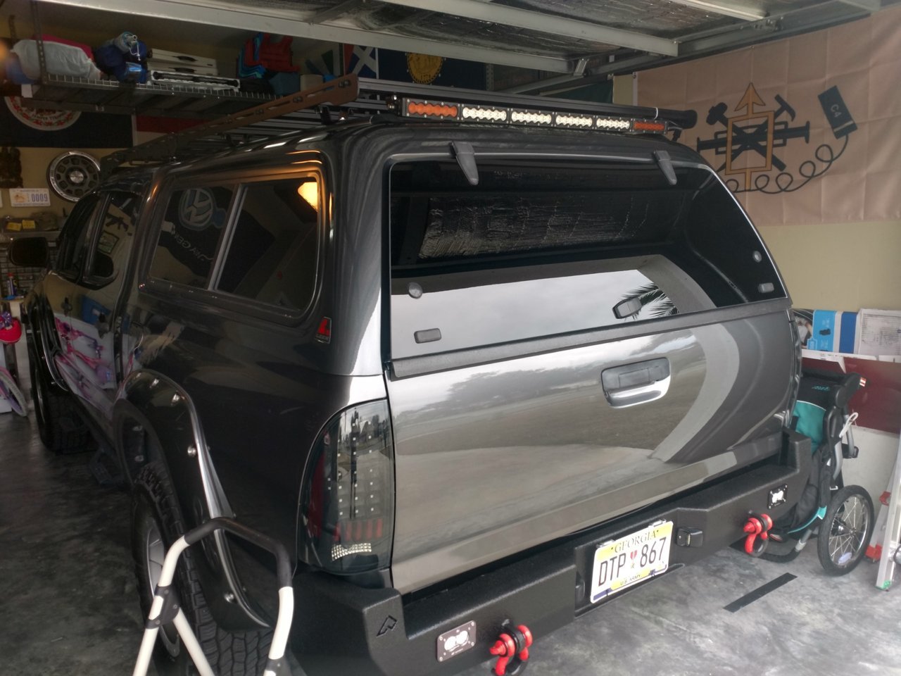

    Prinsu_Side_Lights.jpg @Bunk Moreland sorry about that I mis-posted. I ground the lights to the frame. Yes you could devise a grounding block but it isn't really necessary. My issue came from swapping my Front Runner rack to the Prinsu and not factoring in the difference in material for grounding.
    The Rigid Scene lights are so great to have on a roof rack. They angle down perfectly on the Prinsu. When I get the cabrack on I'll put two more on it.

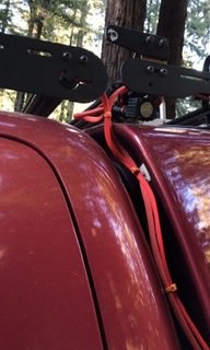

    I ran mine between the cab and camper shell using self adhesive zip tie blocks, then once under cab, zipped tied to existing cable bundle or brake lines up to my relay box. Suggest to use a color braided wire loom to protect wires and make it less obvious
