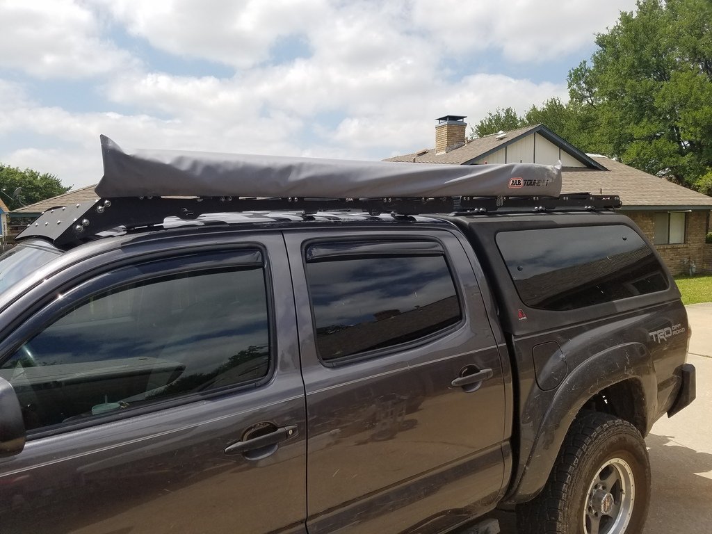

    Whats going on luke. I have already ordered the roof rack but I was wondering what size awning you went with and if you are happy with it? trying to figure out which size is just enough. I like the price of the 4' one but I think the middle size would be ideal. Thanks man

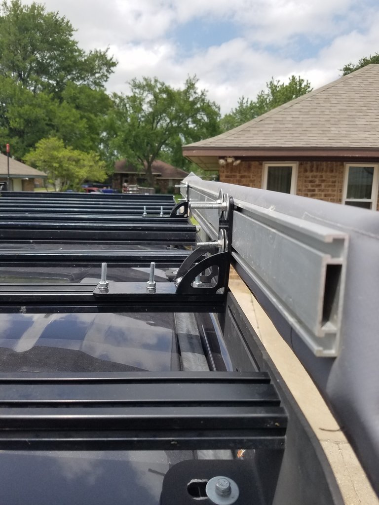

    I went with the middle size one, it extends over the bed by about 2 feet unsupported. I have not seen an issue with it.
    I am looking at adding the 4' on to the back of the cap, but I am worried about what will happen when I need to load my kayaks on to the roof of the truck.
