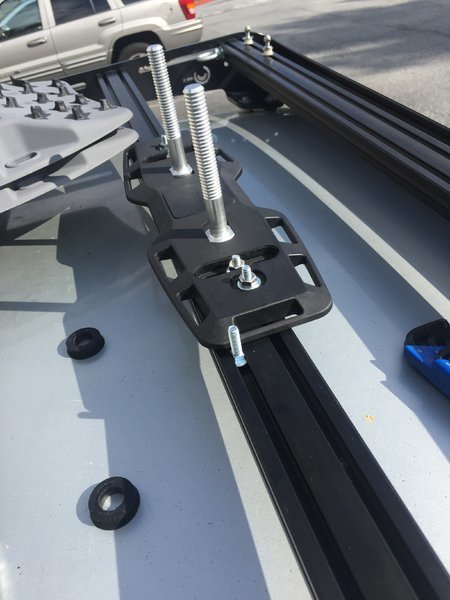

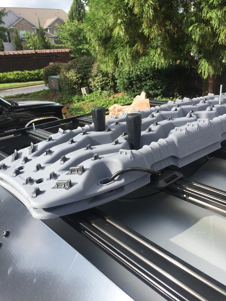

    I threw up my TREDs and plano case last weekend. Here's how I did it.
    TREDs: used they're mount would've liked to save the cash and just used longer carriage bolts but oh well.
    Finished product, the large bolt on the back is to keep the rear from sliding all over

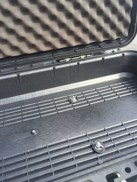

    Plano:
    I used some more carriage bolts, rubber washer, washer and wing nut in 4 holes that I drilled

    Can you replace the bolts on the treds mount with a longer carriage bolt so to allow you to secure 4 treds?

    The mount came with 2 sets of bolts. One this length and another longer so you can use all 4 treds

    I got the Treds. I bought their mount and it's alright, I'd rather save the $20 and just gone with longer 1/4" carriage bolts
