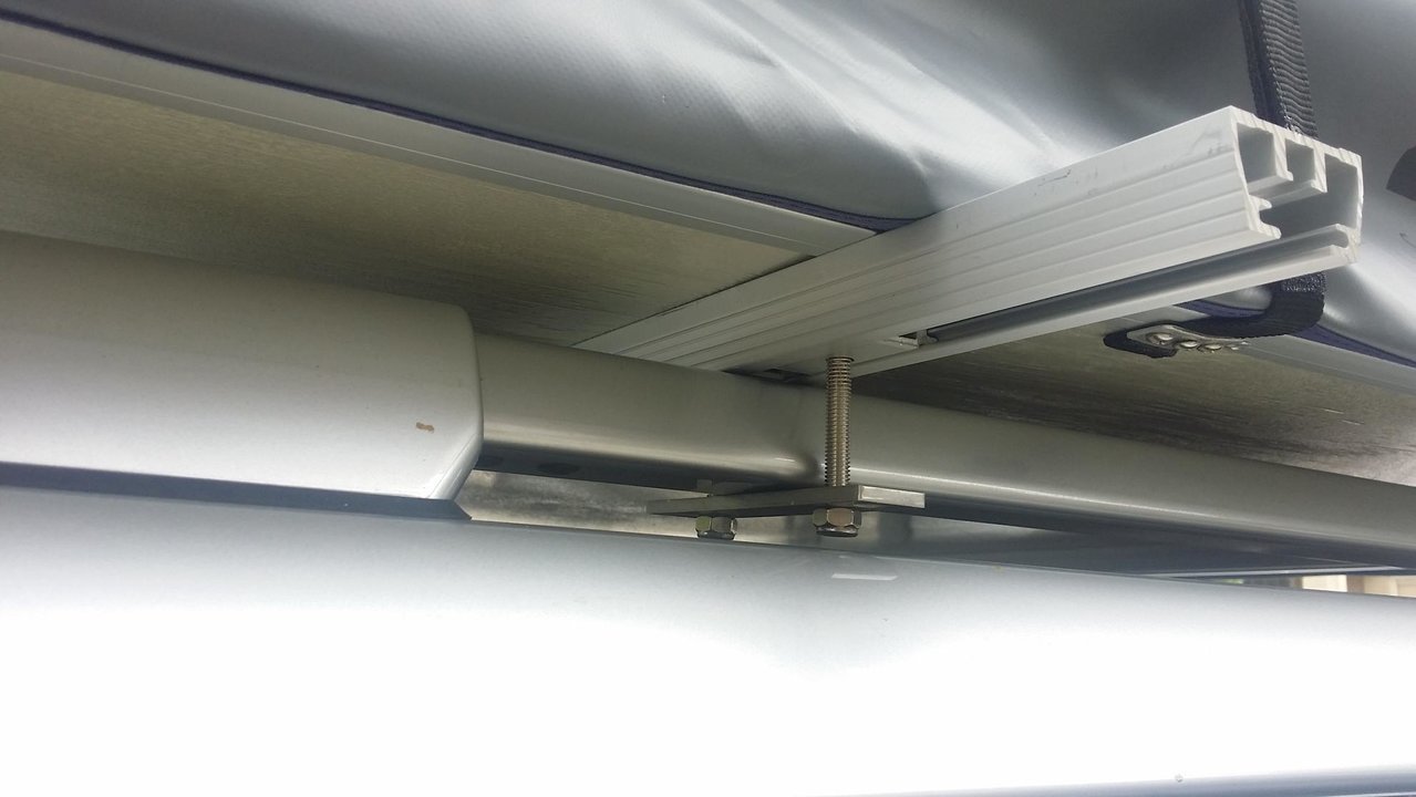

    I don't have any pics myself, but google revealed this. This is exactly what your CVT will look like. Bolts slide in the rail with threads facing the ground. Then that plate goes on, then the nuts. There are also self-tapping screws that come with the tent (4 of them). These are inserted at the end of the rails to fully tighten the mounting rail to the base of the tent. It stops weird vibrations you'll get when driving.

    OOOOOHHHHH I SEE so it doesn't actually mount "TO" the rack it kinda mounts "AROUND" the rack!!

    Exactly.

    Of coarse your rails will not stick out like these. Since your tent rails will be running perpendicular to the Prinsu rails they should be the exact width of the tent. That is assuming you will be opening the tent to the side. Your tent instructions will talk about the different options of mounting the rails. I hope they shortened the ones in the photo!
