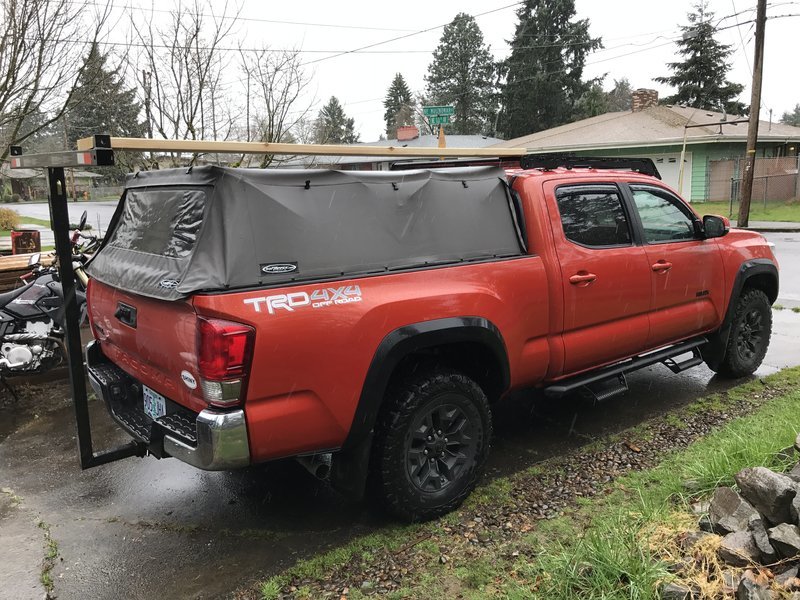

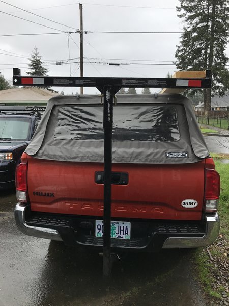

    Pretty great. It's strong and sturdy enough that short and medium length (up to 8') centres well and lashes down firm with ratchet straps.
    I have a Softopper so I can't use that for the longer material, so I got this:
    https://www.amazon.com/gp/aw/d/B00HDL2DX6/ref=ya_st_dp_summary

    Damn i was picturing the prinsu rack on shell but looks like you got best of both worlds goin on. Nice setup! thanks for response
