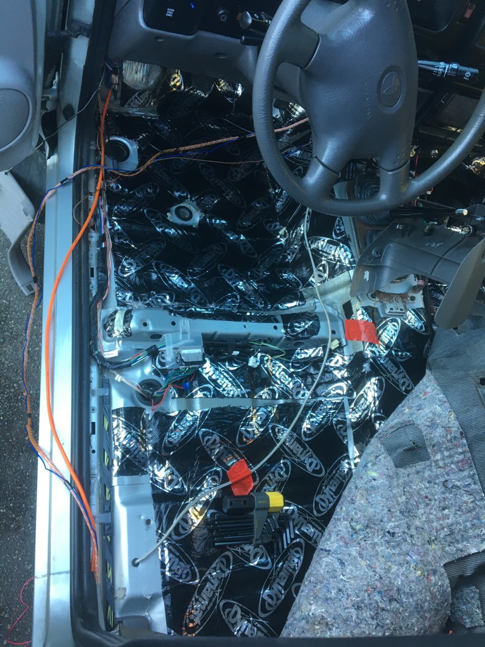

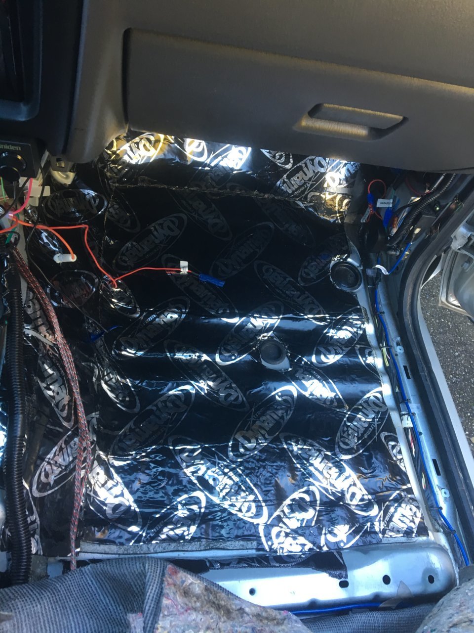

    Took everything out and pulled the carpet up to see what wiring was where underneath... more so for peace of mind, yet still got some re-routing and help with future electrical planning done.
    Driver side
    Passenger side
    Phessor likes this.

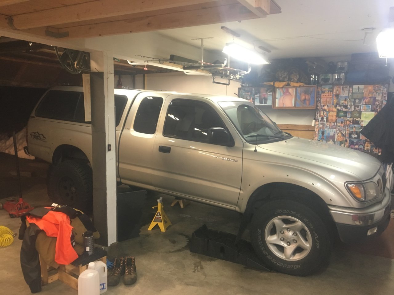

  8. Feb 19, 2019 at 3:24 PM

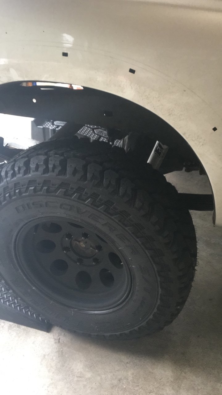

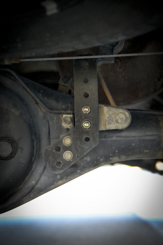

    Before & After
    Half way through

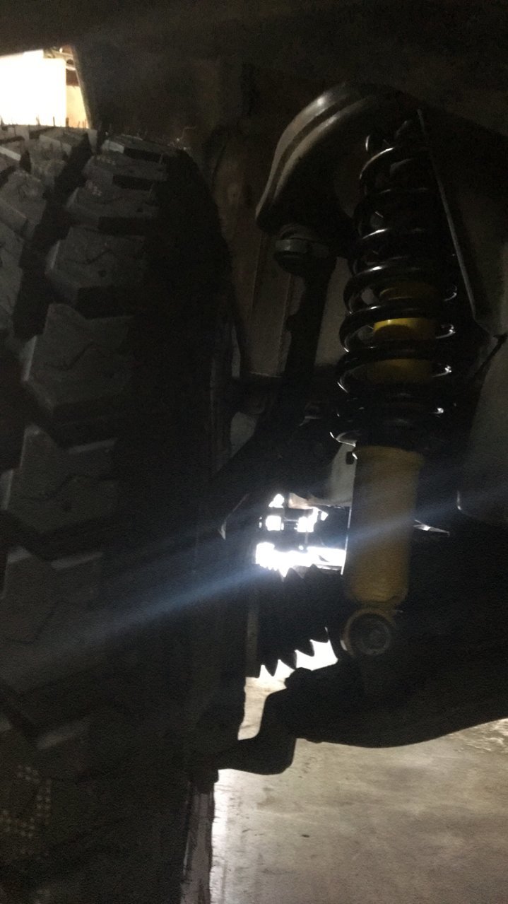

    The lift installed. Rear:
    Front Coils:
    BPV Bracket:

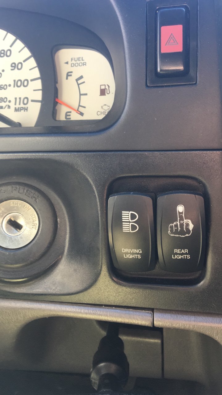

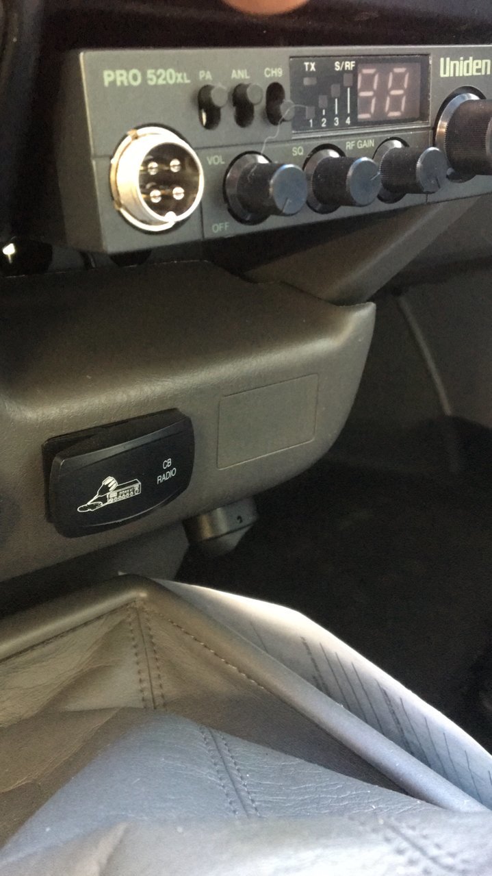

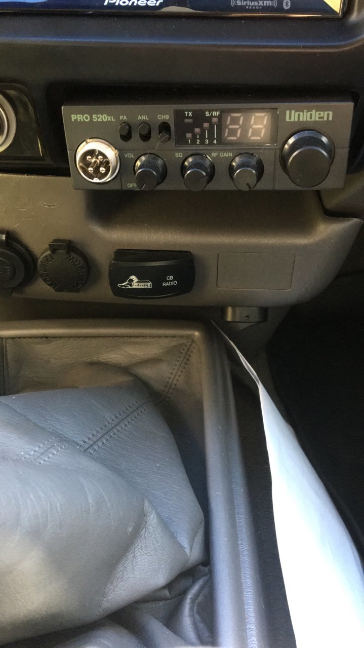

    Installed the OTRATTW CB switch and the fog light/rear lights switches near the ignition

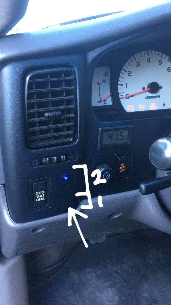

    - Blinker to corner light mod - 1 -
    Changing to depo corner lights so I moved the turn signal and had to cut into the corner lights
    But it turned out pretty well I’d say, oh and I painted the grill with rattle can bed liner

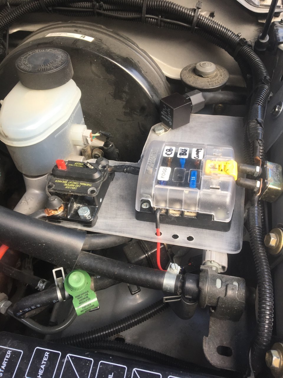

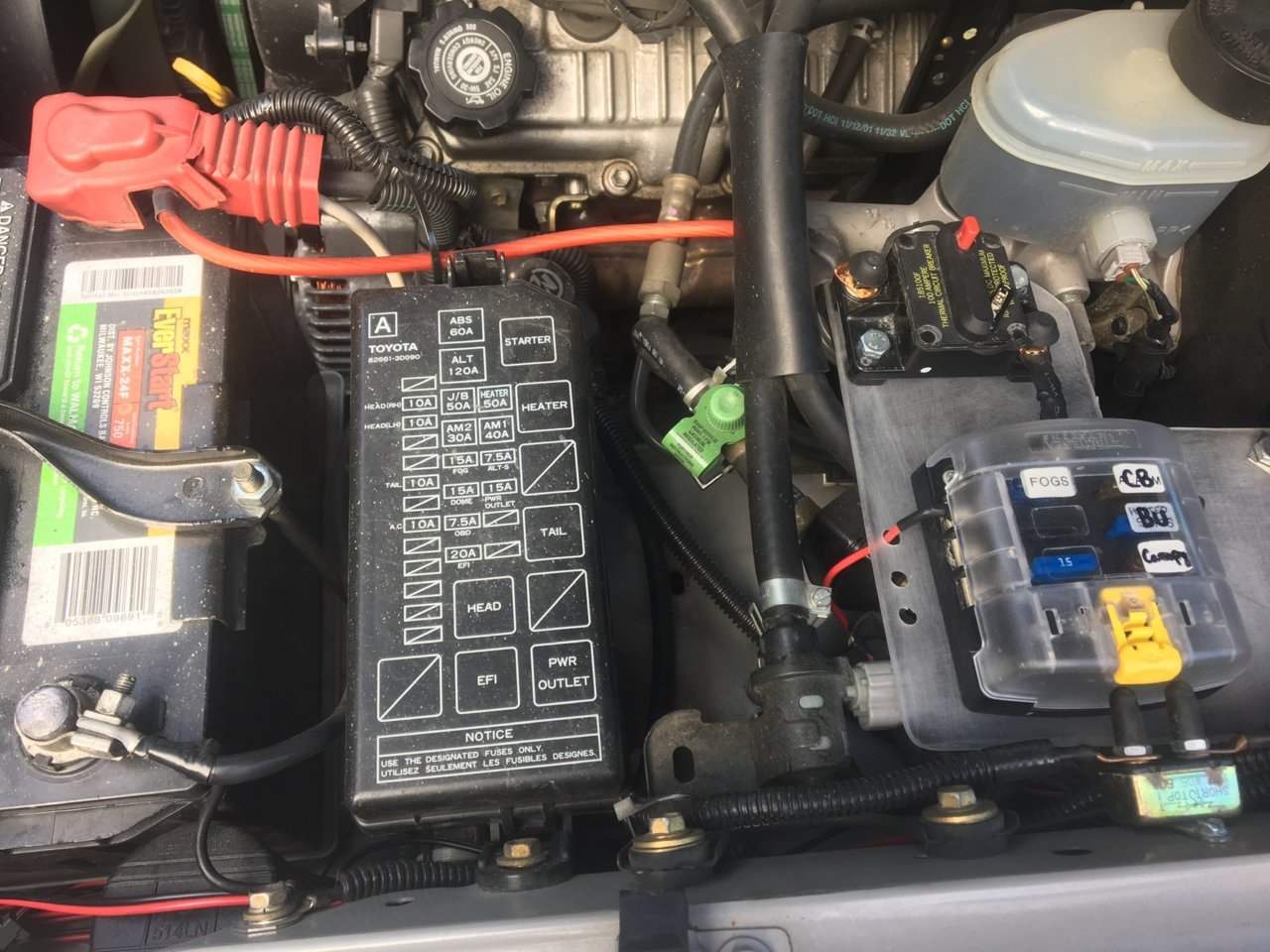

    Finished my relay and fuse block mount
    View of the wire from the battery to the mount
    From the firewall side
    View from the hood side

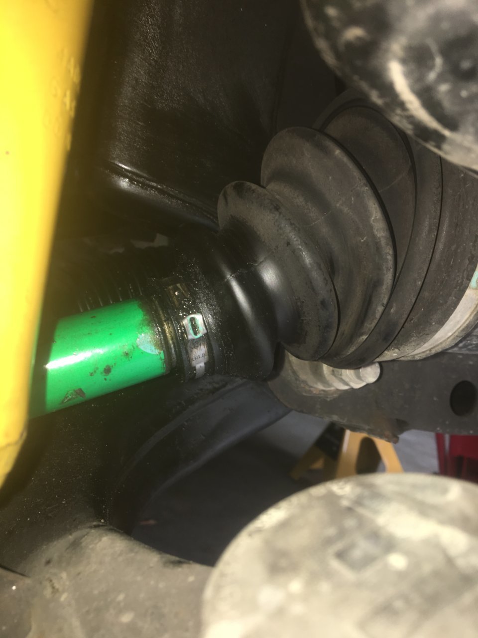

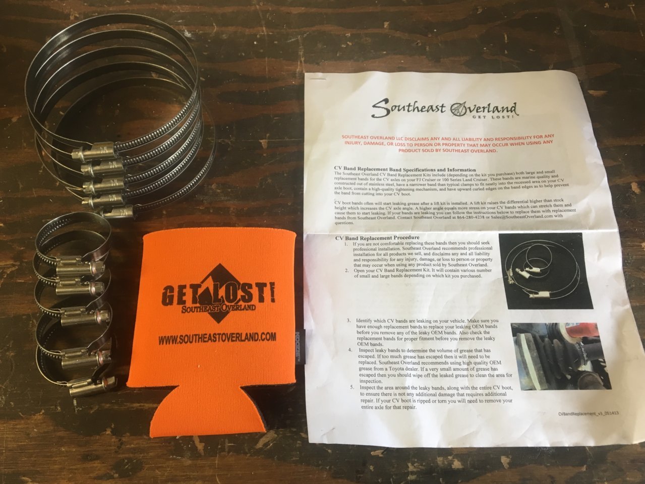

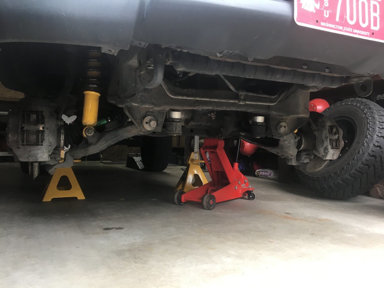

    Got some SouthEast Overland CV clips to replace the OEM ones that slid up and I lost some grease
    Jacked the truck up
    Here’s the passenger side
    Then here’s a before (bottom) and after (top) of the CV clips
    arifleman likes this.

    Nice work on the custom mount. Is there anything supporting the mount under the breaker? Or just the bolts on the fender?
  20. Apr 13, 2019 at 9:46 AM
    #40
    yote
    yote [OP] Washington State University
    Jul 25, 2012
    #83444
    4,634
    Mark
    Tacoma, WA
    2002 Ext Cab TRD Off-Road
    Just the fender. The relay side is resting on something although I don’t remember what (something that it won’t run through with vibrations). It seemed sturdy enough, I’m not worried about it since there isn’t much weight at all on the mount and the lexan is a strong material
