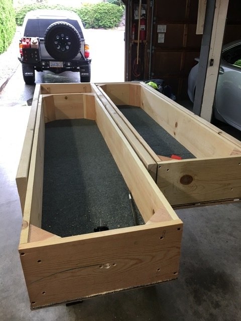

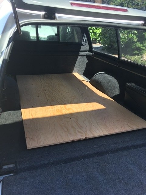

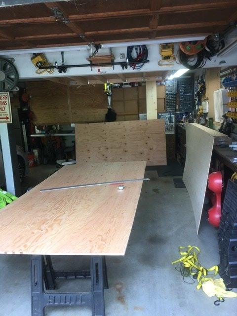

    Building a sleeping platform & drawer system. Mimicking Third Coast Craftsman's video off of Youtube - CLICK HERE -
    I'm building this in mind with dimensions from a 3rd Gen DCLB since that's likely what I'll be getting when this Tacoma is replaced years down the road.

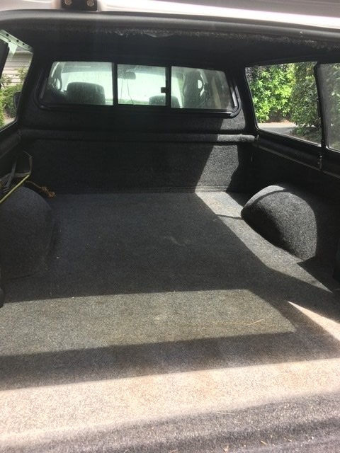

    The bed with everything taken out:
    All of the building materials:
    (2) 1/2" plywood for top and bottoms
    (1) 1/4" plywood for drawer bottoms + front face
    (4) 2x10 for back/outter/middle frame supports
    (2) 1x10 that I'll cut down for exact drawer sides
    Test fit for the bottom. Snug as a rug:

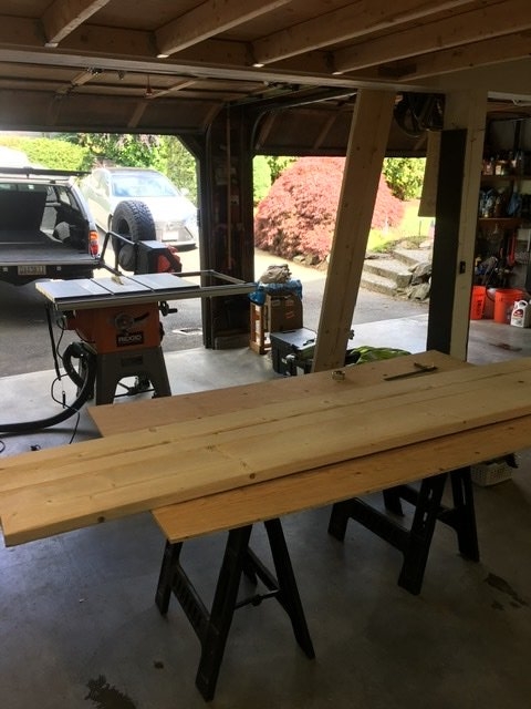

    Measuring & cutting the 2x8's for the back/outer/middle framing:
    The frame put together:
    Drawers will be built sometime next week.

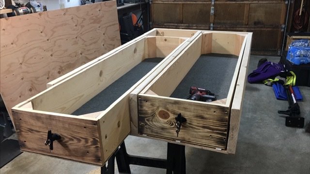

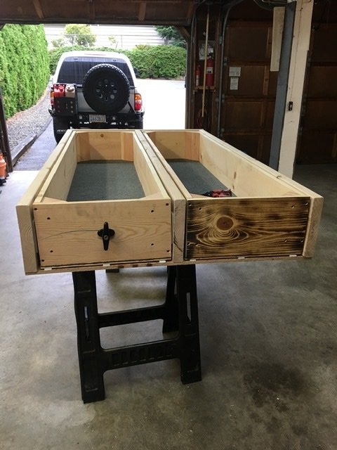

    An update on the bed drawers that I finished.
    I left off with the framing, but eventually built the drawers out of 1x10 board, cut to height. They have 4x4s that are cut in half diagonally to reinforce the sides and help with weight bearing when putting things on top of the platform:

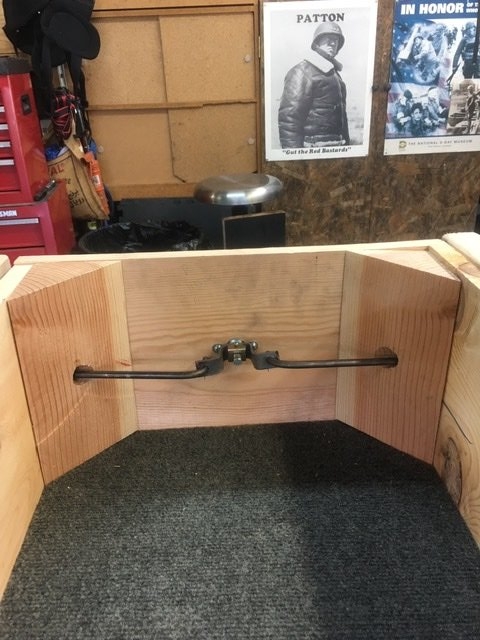

    Here's the locking mechanism. It's 1/4" steel flat bar that I bent to hold and turn the rolled steel that I cut and bent to fit on the square end of the handle:
    I wasn't sure how I wanted to do the drawer fronts, I ended up burning the wood with a torch and really like how that turned out:
    The drawers slide flawlessly on UHMW plastic that I cut into 1" strips for the outer edges, middle, and little blocks on either side to help guide each drawer
    The drawers done:

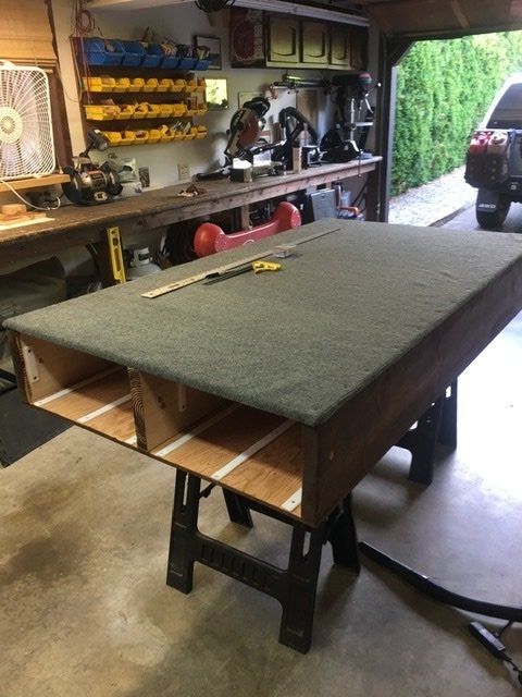

    Used 1/2" plywood and the same carpet on top that I used for the drawer bottoms. I also stained the sides with dark walnut finish:
    The platform all finished, time to put it into the bed:
    All in the bed and snug as a bug against the sides:

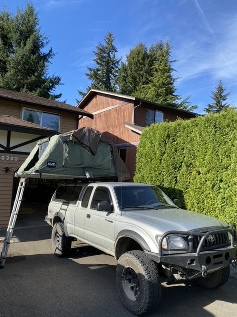

    Girlfriend got me a CVT Mt Rainier rooftop tent! Test fitting below:

    How's the RTT feel on top of the camper shell? Do you think you need to reinforce?
    Been wanting an RTT but also don't want to part ways with my camper shell just yet.

    I’m not sure. I only put it up there to open it up and set it up since there was more involved with the initial set up than I had anticipated. I didn’t bolt it to the roof racks so I didn’t climb up there

    you could look into a ladder rack. Not the sexiest option but it should be plenty strong for a RTT. the other thing is that Expedition Overland had an RTT on their 2nd gen and it only had a standard camper shell instead of the habitat system that their 3rd gen has. they might've had a special roof rack to distribute the load better than a standard Yakima or Thule rack might but it's certainly doable with a camper shell.
