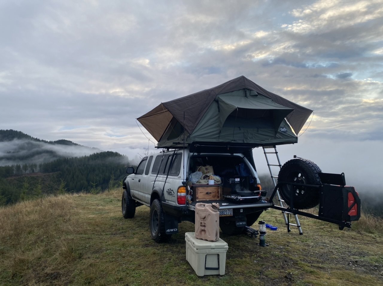

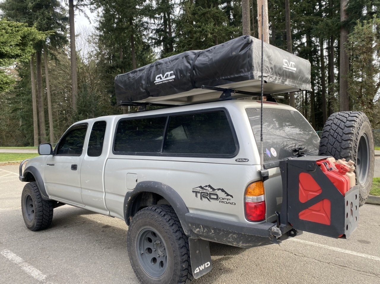

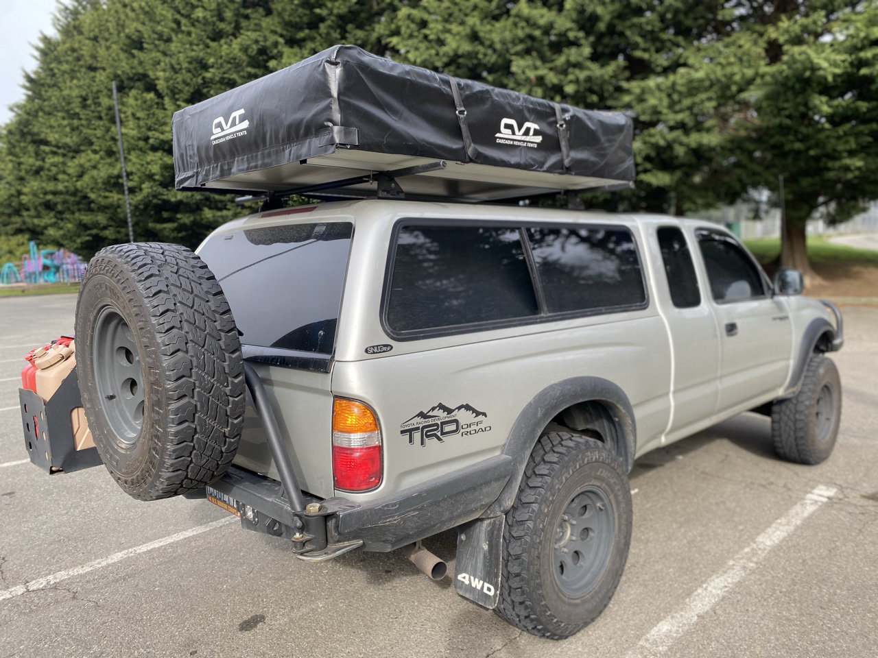

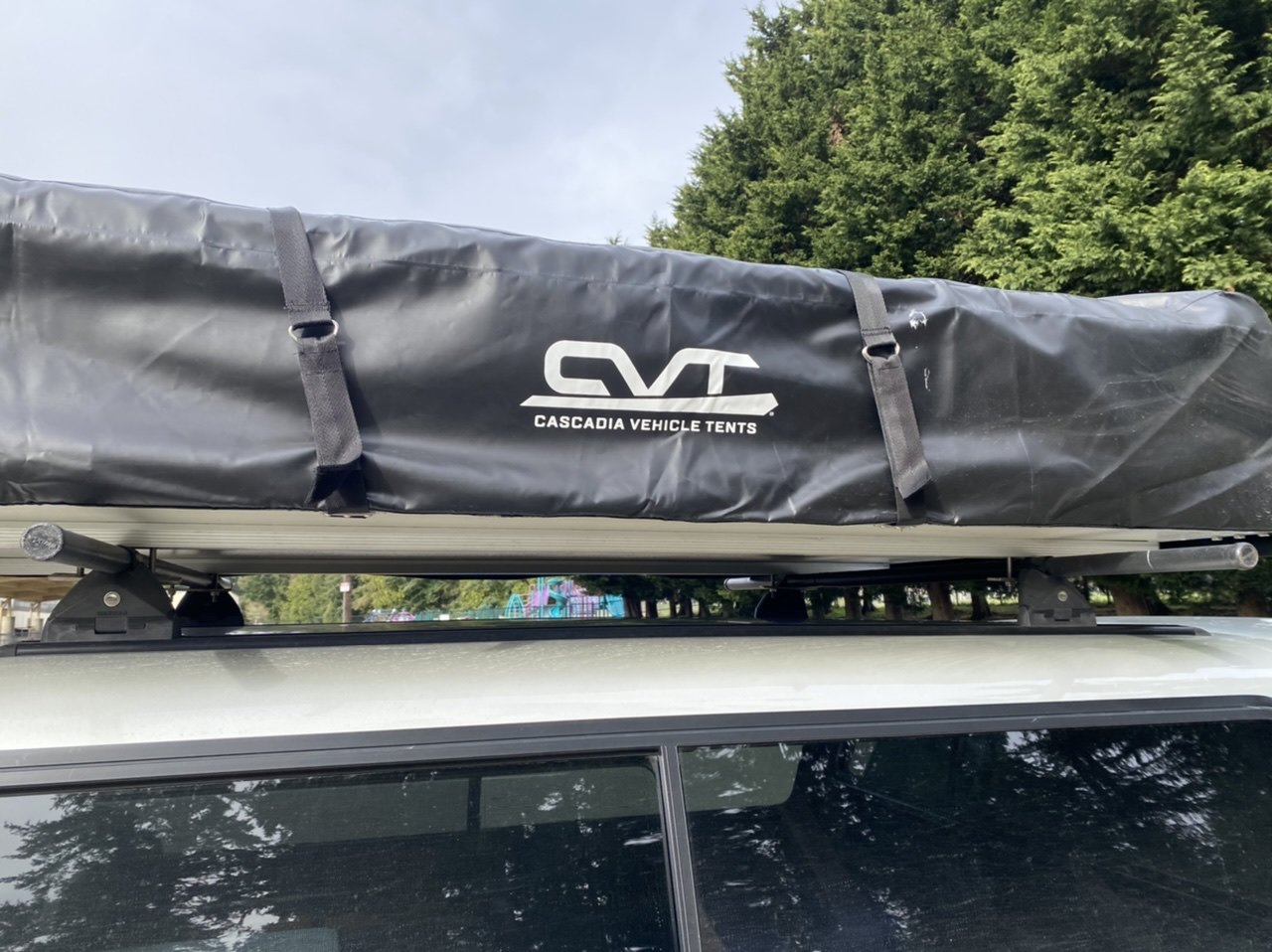

    We took it out last night on it’s maiden voyage and it felt really solid up on top of the camper shell with just the 2 Yakima rack bars. I don’t think it needs reinforcement, or the need to sell this canopy to buy one with reinforced honeycomb in the fiberglass or whatever
    Here’s the mounting setup with it up top:

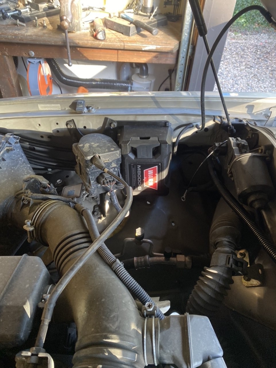

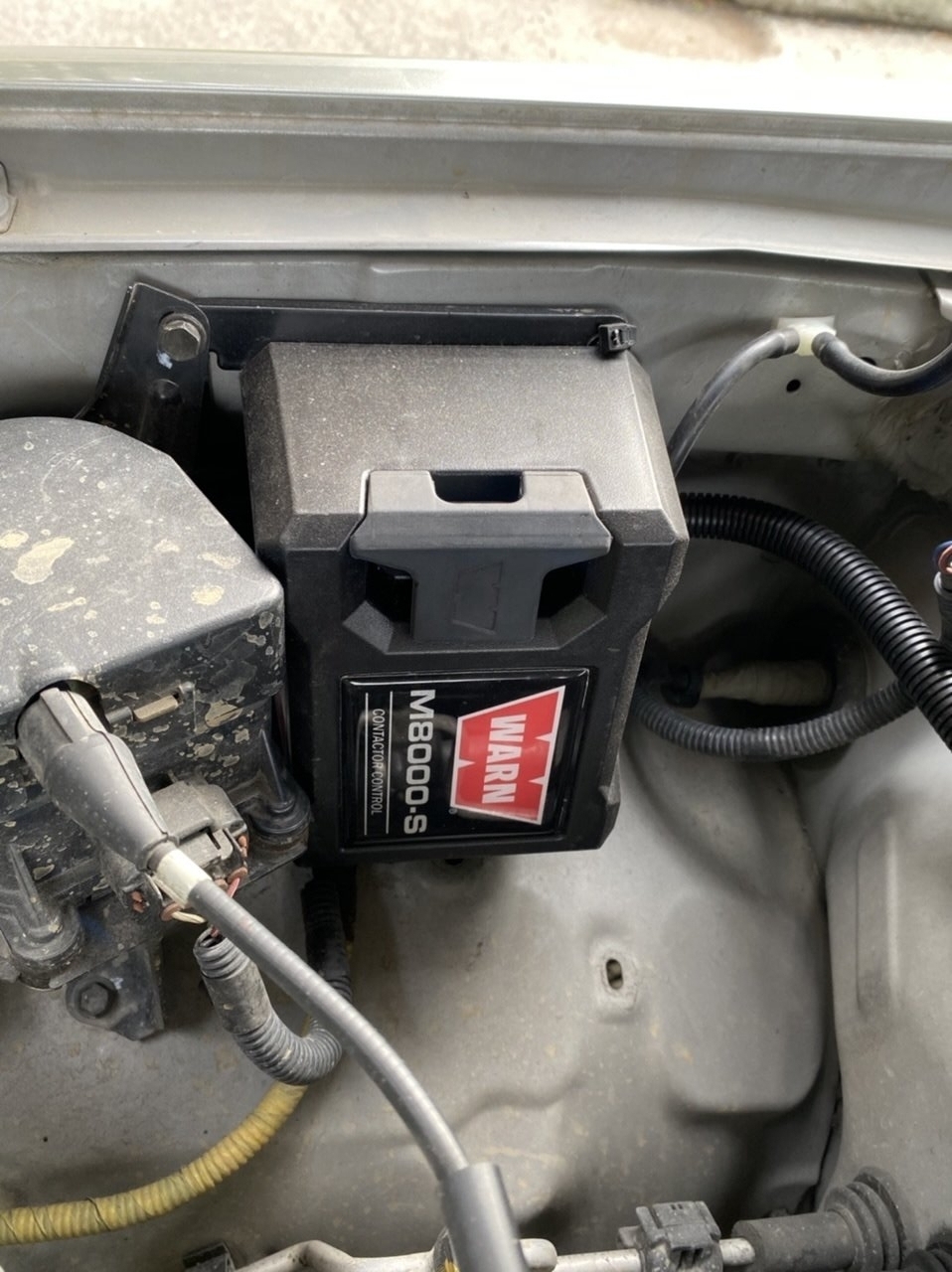

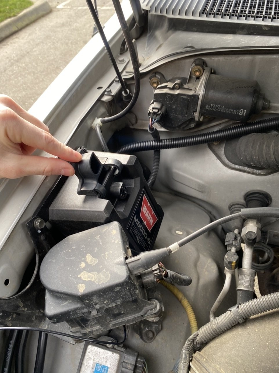

    Installed my Warn m8000-s. Mounting the solenoid was tricky, no room in the bumper so I had to order a relocation pack with extended cables (76”) to swap them out. I found a pre existing mounting location and the mounting bracket that came with the winch - you just need to flatten the ends of the bracket that are bent 90*

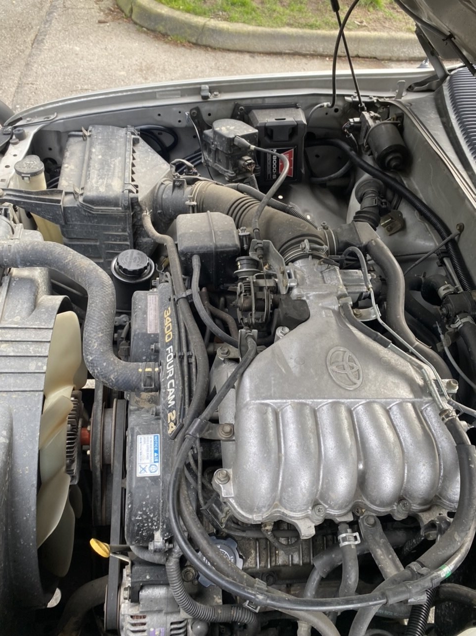

    Here's a few more pics of the solenoid location
    Here's some nasty wiring. I'm fine with it for now until I need to get a new battery cause this one is leaking a lot of corrosion out of the post(s)

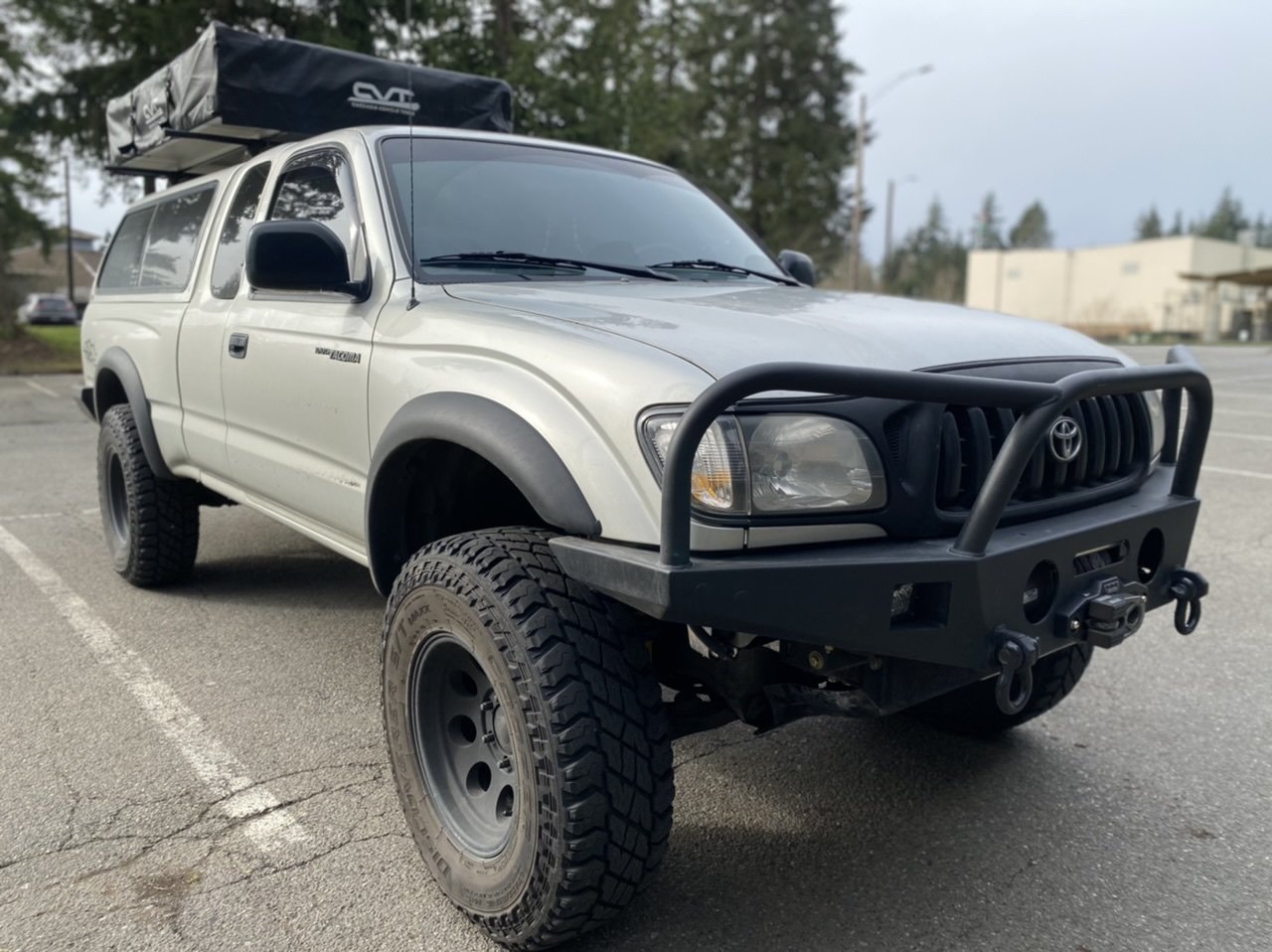

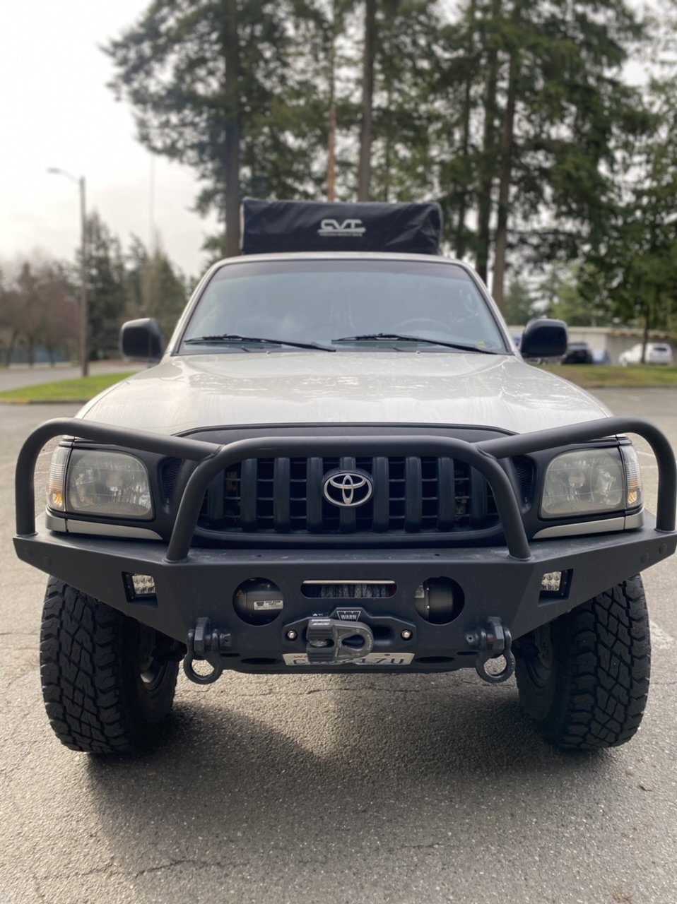

    Here's some exterior shots I took when at the dog park today:
