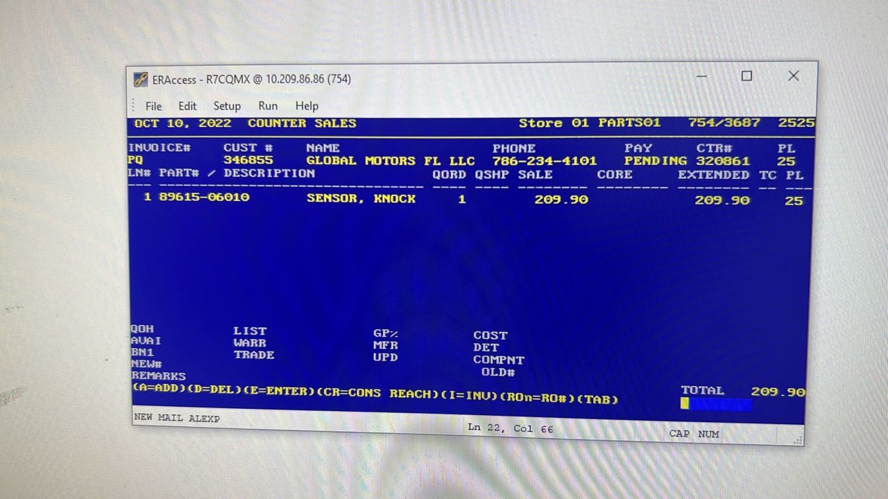

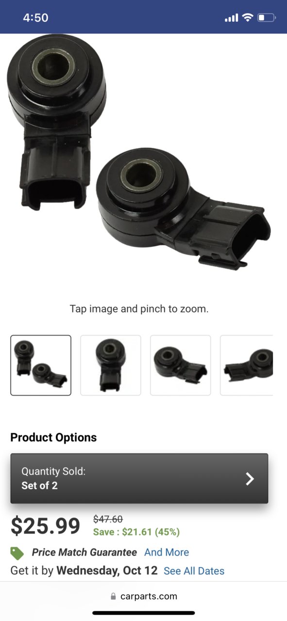

    So i decided to change the sensor, now question:
    Toyota $209after discount shop price.
    ot carparts $27?
    Huge difference

    Yes, i am going to replace it. Question is:
    Should i try carparts $27 or toyota $209?
    The idea is to determine if its a faulty sensor wich appears to be, or there is another reason the sensor is being triggered, hopefully not.
