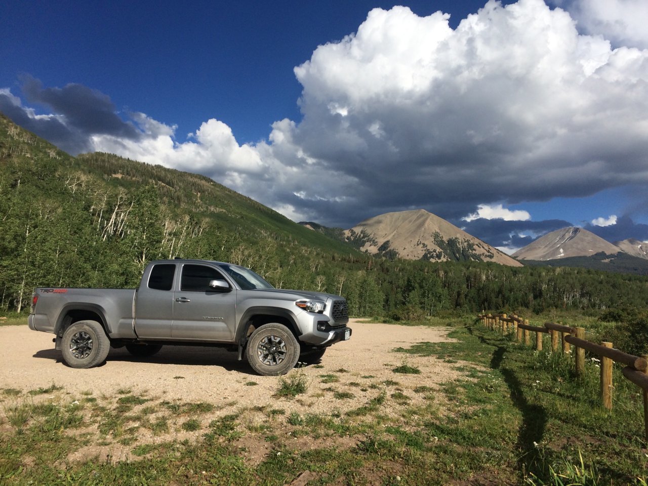

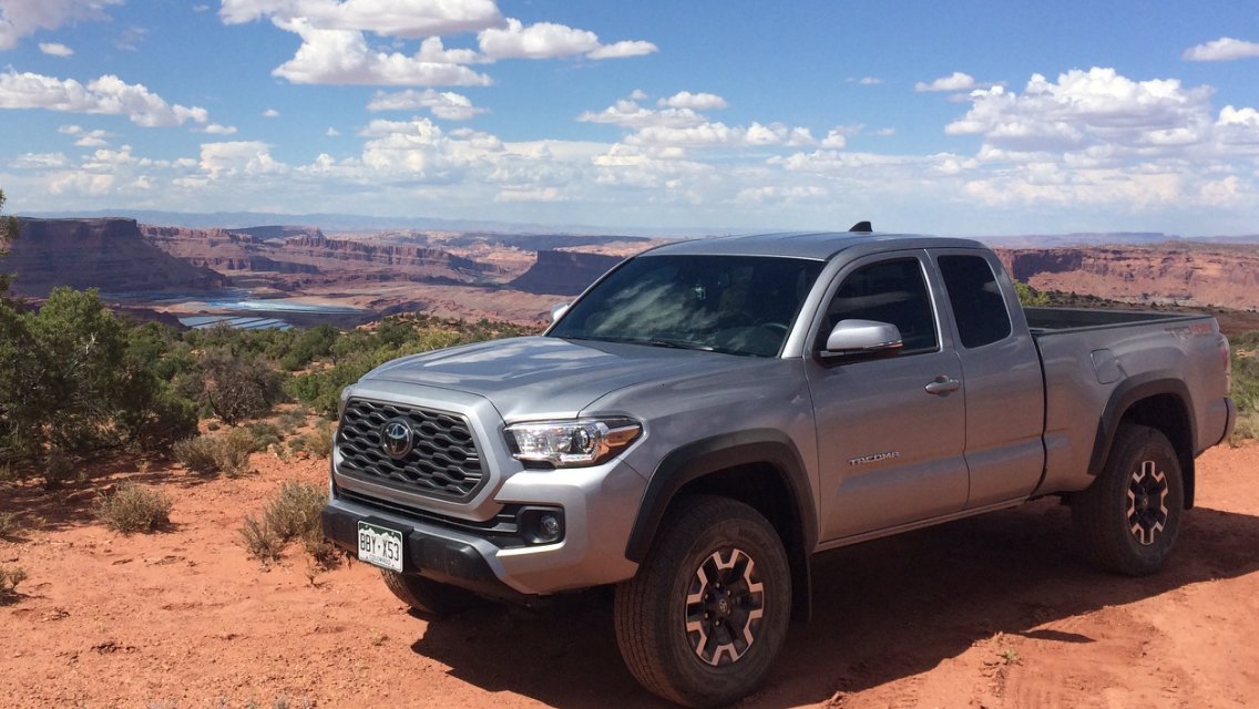

    Nice truck! But I'm liking the background just as much... :thumbsup: Where's this at? I'm just guessing, but looks like northern AZ or southern UT.??
    SloPoke and Paul466[QUOTED] like this.
  20. Oct 16, 2020 at 11:05 AM
    #400
    Paul466
    Paul466 Well-Known Member
    Oct 18, 2019
    #308349
    70
    Thanks, that is Utah,Moab area. Those are Potash evaporation ponds in the background , the other one is near Warner lake c.g.
