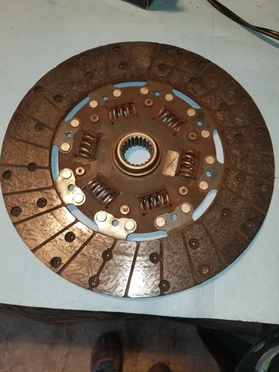

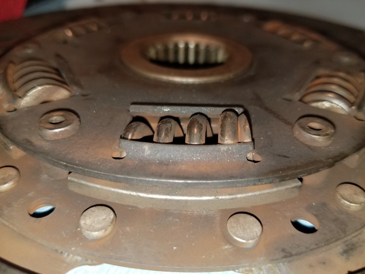

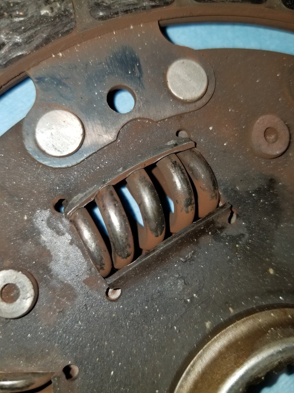

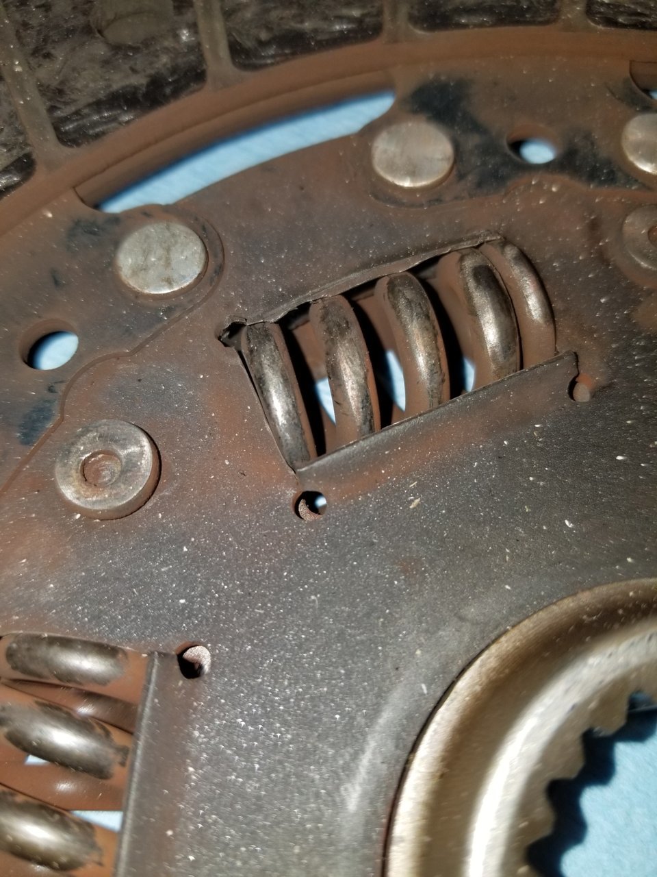

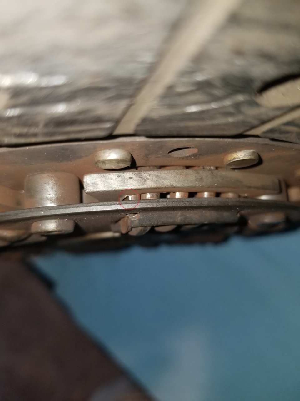

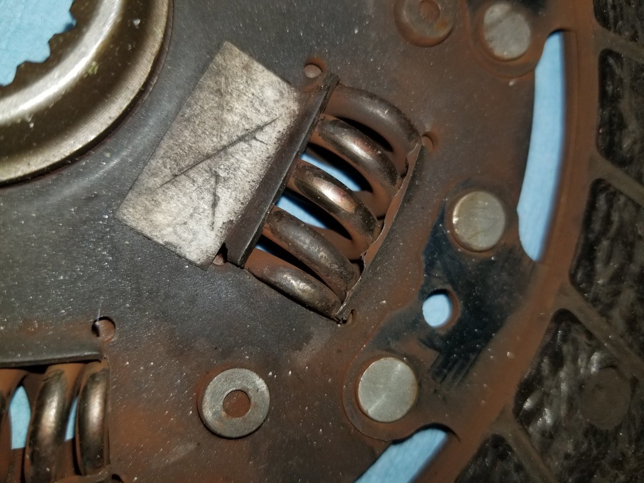

    All right... UPDATE.
    I lifted the ass end of the truck up and let it run in 4th idle speed. (I had no help to get it to the RPM while I am under it). BUT! The spider gears in the rear end sounded a bit loud which caught my attention. I did not re-create the sound I am referring to due to lack of help and I figured I just go ahead and pop the rear end out and take a look at the spider gears, bearings, and while I'm there swap out the rear bearings.
    I swapped out the Rear Wheel bearings.
    The rear end looks and feels solid. Bearings look good. Fluid drained was as clean as when it was changed a year ago.
    Driveshaft is in good shape, Spicer double cardan joint is in good shape.
    While I was under the truck with the driveshaft out, I spun the output shaft of the transfer case (flange) back and forth to see if there is any play. I heard a pretty loud clang when I rotated it left and right. It was coming from the bell housing. (Transmission in neutral). I stuck my borescope through the opening where my clutch fork goes through. I did it again and noticed the clutch was making noise.
    I had recently noticed as well (a few months ago) that when I turned my truck off, the truck sounded like a diesel. You know...the loud clank/clunk when the engine comes to rest.
    I said screw it and pulled my trans out (all same day) ...sigh.
    Good ol LCE Pro clutch less than a Year old had a lot of play in the splines where the input shaft slides through. (center)...what a piece of crap. The sound was just like the one I've been chasing!
    The springs are canted, the bent metal tabs holding them in are worn from the springs, and it's just plain loose. I don't know how much longer before it fell apart.
    This is what I though would cause all the noise as it sound JUST LIKE IT! The noise primarily started when i first got the truck and put an LCE clutch in. Then, a year later when I did the engine swap, I put a brand new one in again ( same one), so I didn't think that was the issue. If the center splines where the input shaft slides in to the shaft have play I can imagine the sound resonating through....Replaced the clutch with a Carquest brand (no choice) kit and it had NO play. Put it all back together....still making the noise I'm chasing, BUT the loud clunk/clang when you turn the truck off doesn't happen anymore.
    So, by trying to diagnose one problem, I found another I suppose. NEVER buying an LCE clutch again. The first one I got 2 years ago was also loose in the center, and I thought it was normal, but it gets MUCH worse as I found out. Their quality control is crap.
    Bottom line: I am back to square one of diagnosis. I will lift the truck back up this week, re-create the noise, then, take the driveshaft out and put it in 4x4 and spin the fronts to see if it does it when the driveshaft is out.
    As I have stated before....Transmission has been rebuilt....noise still there, new Xfer case......still there, new clutch...still there, new driveshaft....still there.
    Bare with me as I continue on this fun journey. I am including pictures of the LCE clutch and a video link for the clutch issue. I will upload a video with re-creating the noise.
