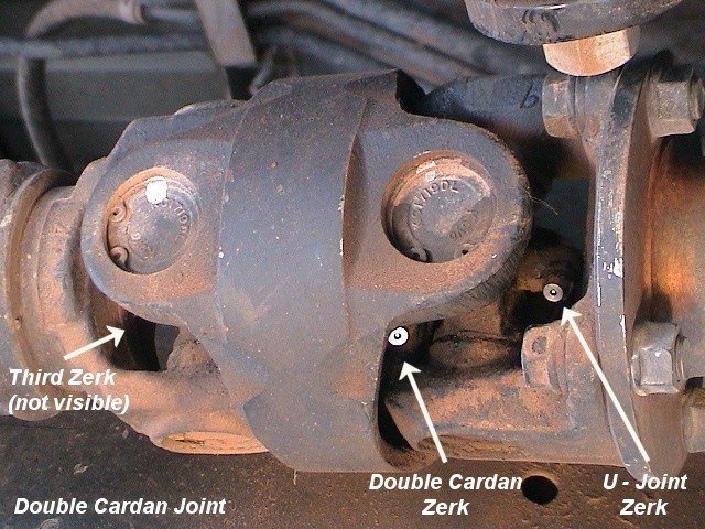

    UPDATE:
    SOLVED
    Bad double cardan CV joint IN the driveshaft. (driveshaft failed again essentially after 1.5 yrs).
    Bad double cardan joint in the driveshaft can cause a rattle sound reminiscent of a loose heat shield coming from the actual driveshaft.
    GREASE YOU DOUBLE CARDAN SHAFT EVERY OIL CHANGE.

    Update 2:
    Rattle came back. 2-3 months later. Getting worse week over week. Need to take it back to the driveline shop. I need to figure out WTF keeps eating my DC joint.
    I told them I want them to instead of just replacing the part (which is a lot of labor and not cheap for them) I would like for them to take the truck and actually measure the angles and make sure nothing strange is going on.
    The Double Cardan joint is there IF the angle is wrong between the axle and trans hence why it was installed from the factory. I only have a 1.5" lift and that is by adding a leaf and the driveline guy said it shouldn't have any effect.
    Well, regardless will update once I take it to them to measure everything out. :annoyed:

    For me it is the Driveshaft. The double Cardan joint inside is failing and the needle bearings inside were vibrating and resonating through the driveshaft with engine rpm. I have had it rebuilt twice and it came back over time. Essentially what is happening is my leaf springs are bad which is causing excess axle wrap which in turn makes the driveshaft double cardan joint to fail.
    Try to grease the double cardan joint itself. It is the grease fitting hidden in the joint. If the noise gets quieter or goes away it is most likely that. Then again if it does not go away it doesn't mean it isnt the culprit. mine was so gone that grease did nothing for the noise.

    I boldened that line because it is so often overlooked but super important. Folks that don't DIY definitely will need to grease this actual double cardan joint itself like you say as most shops don't even grease the u joints,.unless you specifically ask. U joints are important too but at least a u joint can be replaced a lot easier than the double cardan joint.
    GREASE THE DOUBLE CARDAN JOINT EVERY OIL CHANGE.

    Yup. You can't just replace it either. You have to take it to a specialty driveline shop that can undo the factory crimps and can source the parts. I ended up just having them weld on a Spicer double cardan unit that has ujoints that aren't crimped in and parts are easy to source. Toyota doesn't sell the ujoints only the entire shaft.
