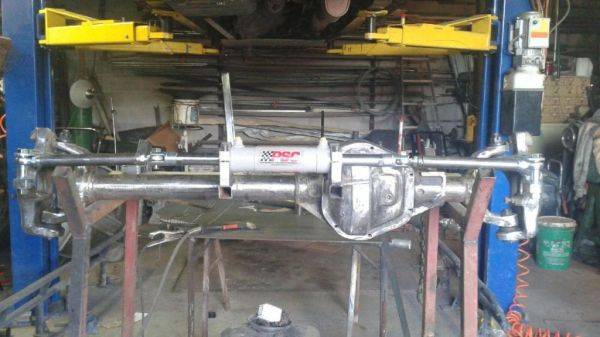

    Mean while I got some more 1/4" plate cut up for the front of the frame and got some more metal added to the front diff.

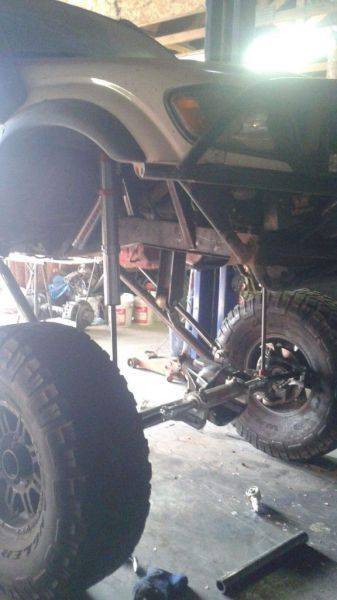

    full droop vrs. stuffed. and everyone thought I was gonna built a mall crawler..

    How much travel is that? You could about stuff a dead body in there at full droop.

    two dead bodies per side. 18.5" of travel.

    lol that's exactly twice the travel of my current rear end setup... :D
    btw pic looked bigger on my cell phone :boink:

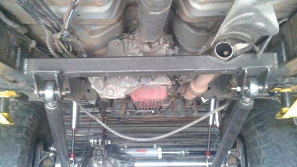

    this will hold the T case up and make the truck driveable untill i get an atlas and have to redo it all
    also just ordered gear for the 14 bolt.
