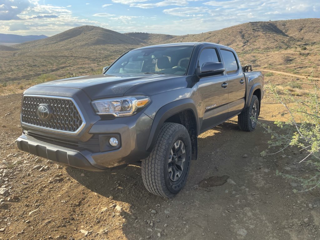

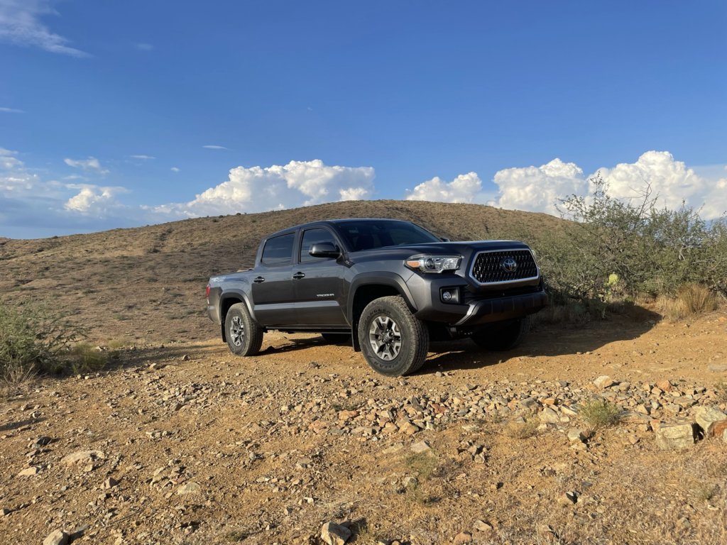

    First time out with the 2018. Had a lot of fun experimenting with the 4x4 and lockers. Bloody Basin is a hidden gem!
    Tonto National Forest to Sheep's Bridge (The Long Way!). Great trail to understand my stock suspension, lighting needs, and Arizona off-roading!

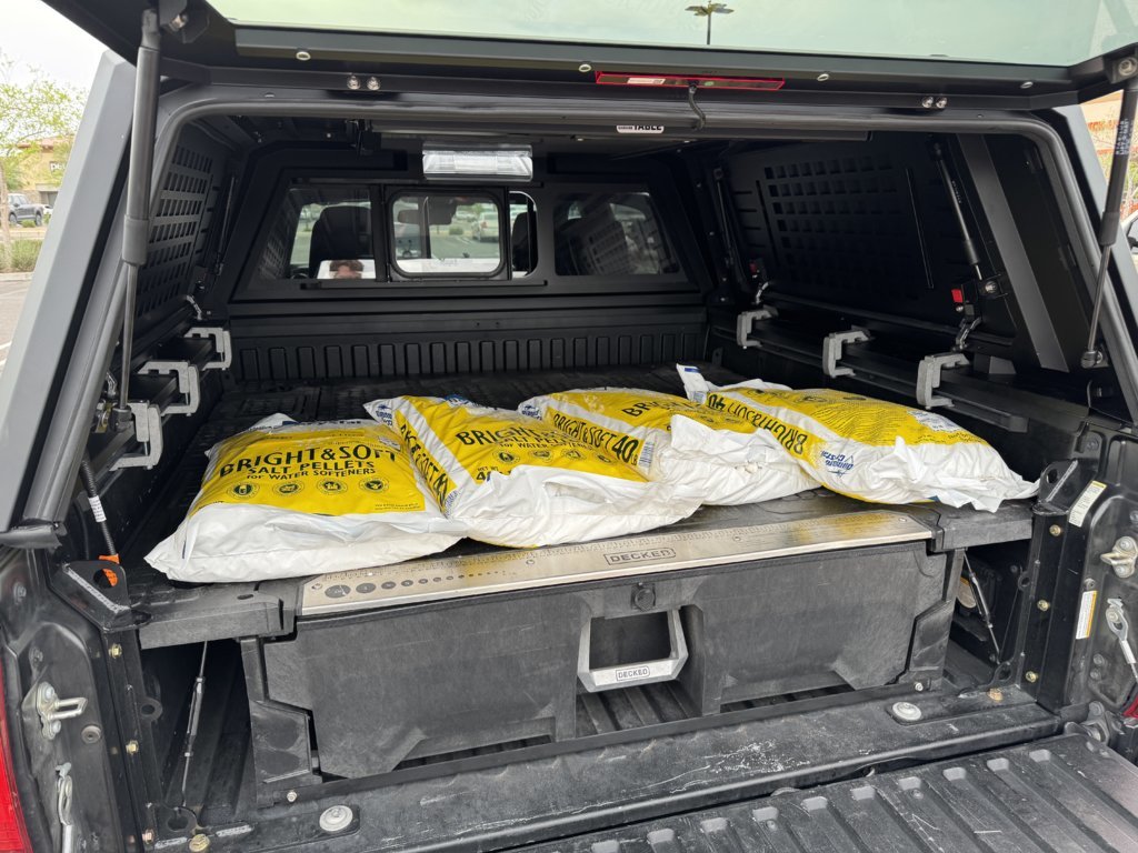

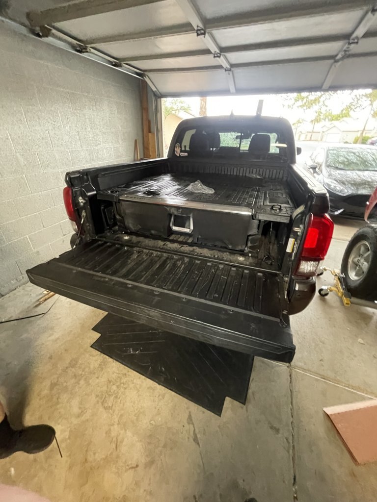

    Bought and installed a new Decked system. This is the single drawer design. Worth every penny.
    Whoever said you can't do truck stuff with a Decked and a Short Bed is a liar!

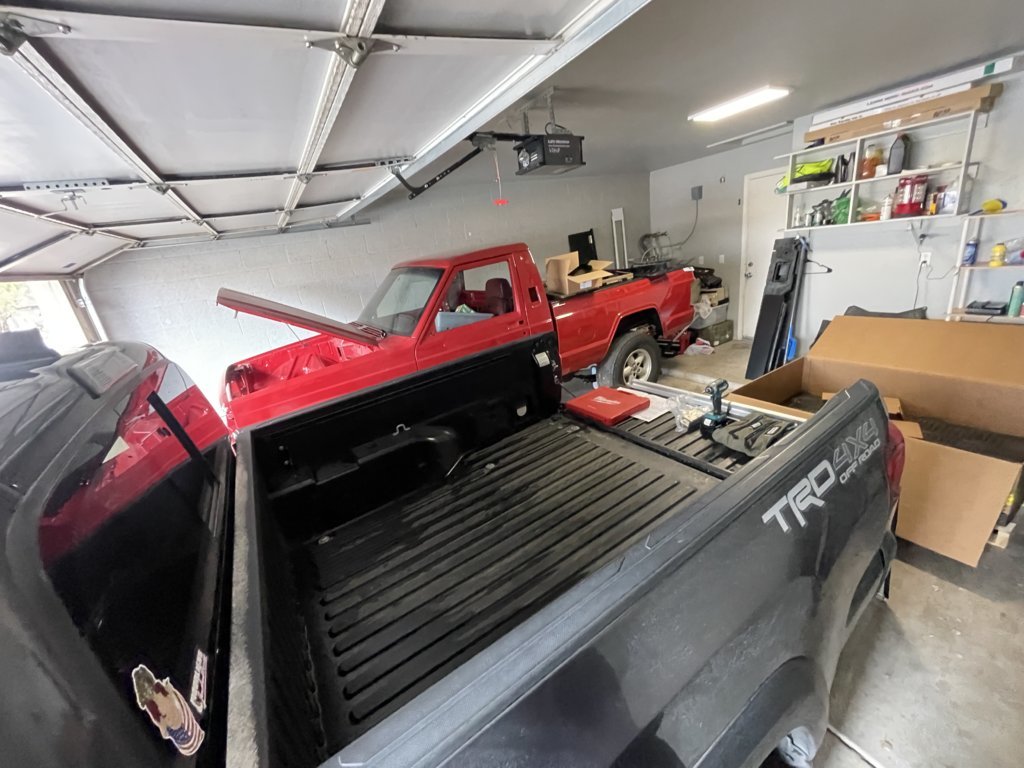

    Used my Tacoma to pick up a Wildernest Camper Shell for my buddies Comache build. Ended up scratching the hell outta my truck, but it made some good memories and that makes it all worth it.

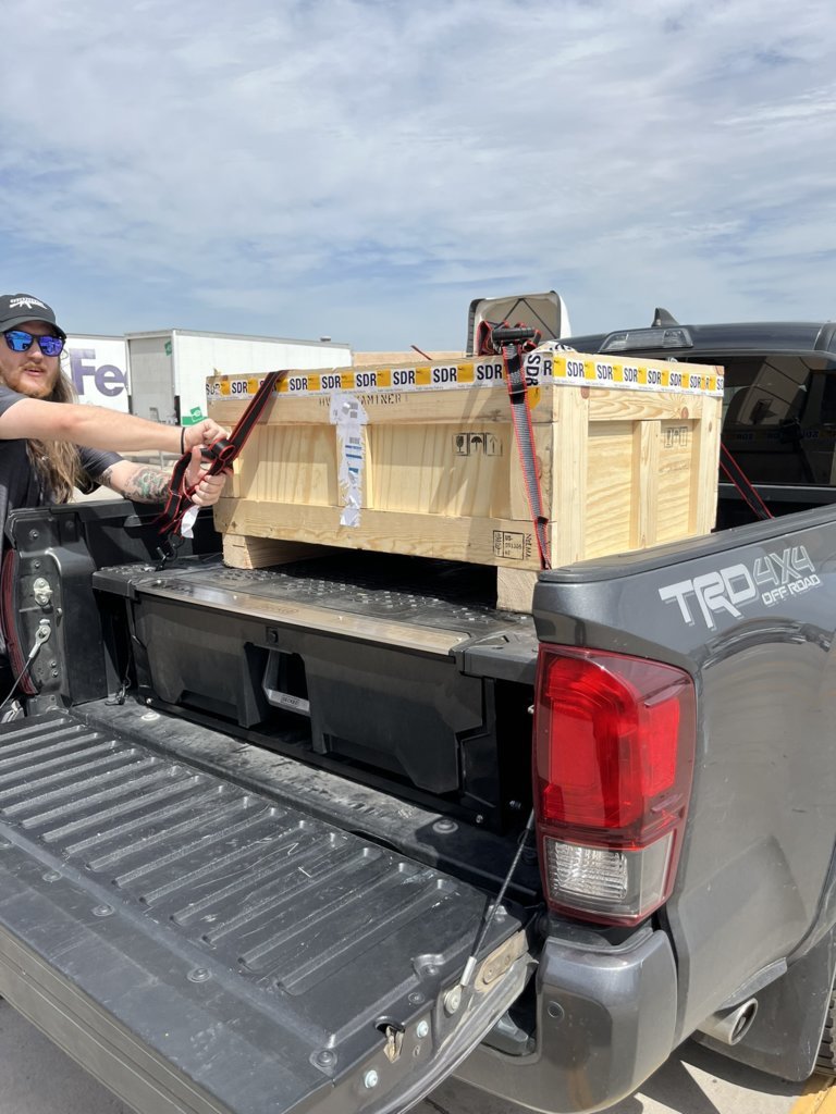

    Picking up my friend's Comanche. Towed it from Sacramento, CA to Phoenix, AZ. Very long drive but well worth the time.

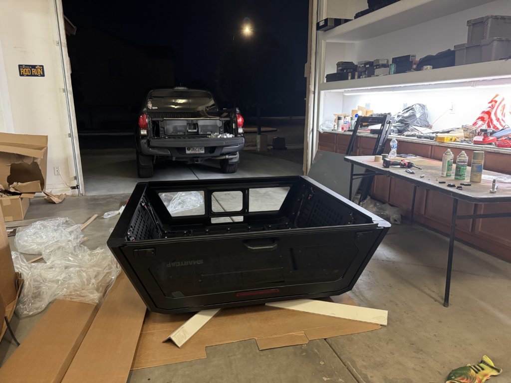

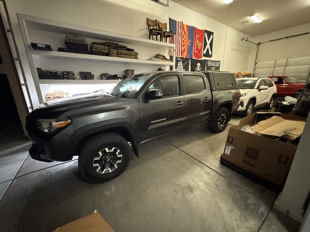

    Well last night, I was painting a rifle of mine and my roommate came down to the garage and said "I'm bored, let's put this cap together", so now I can update the thread!

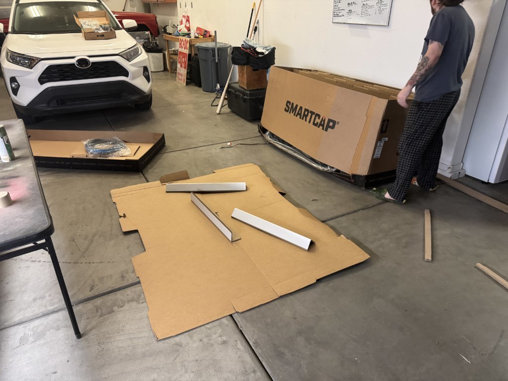

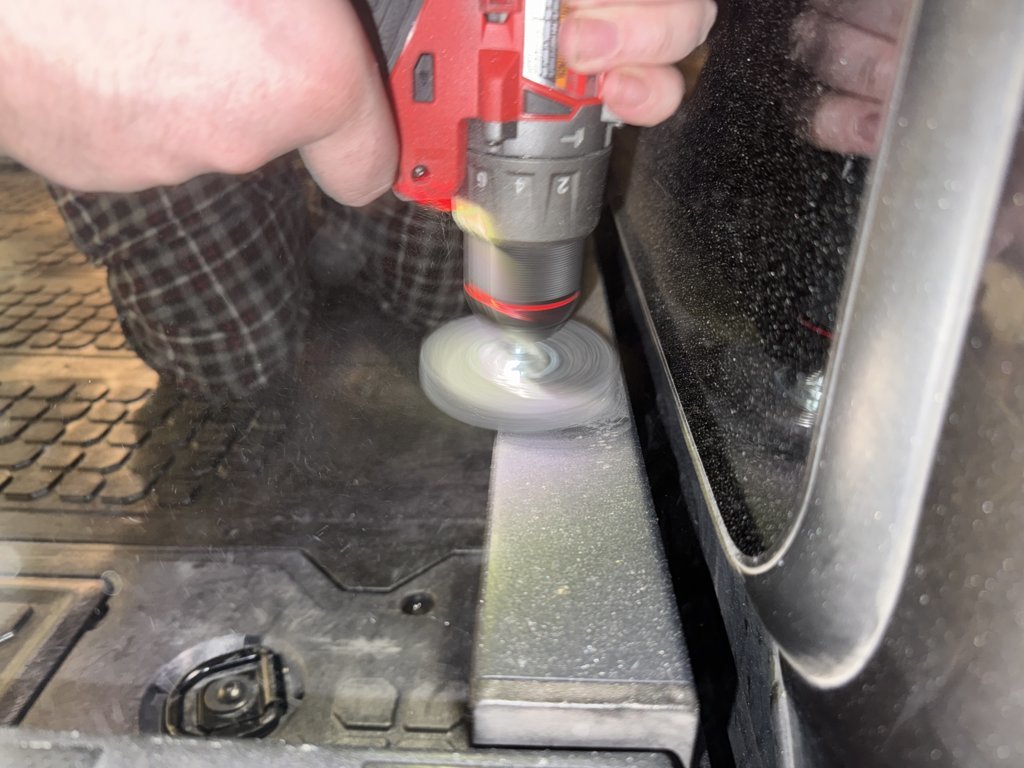

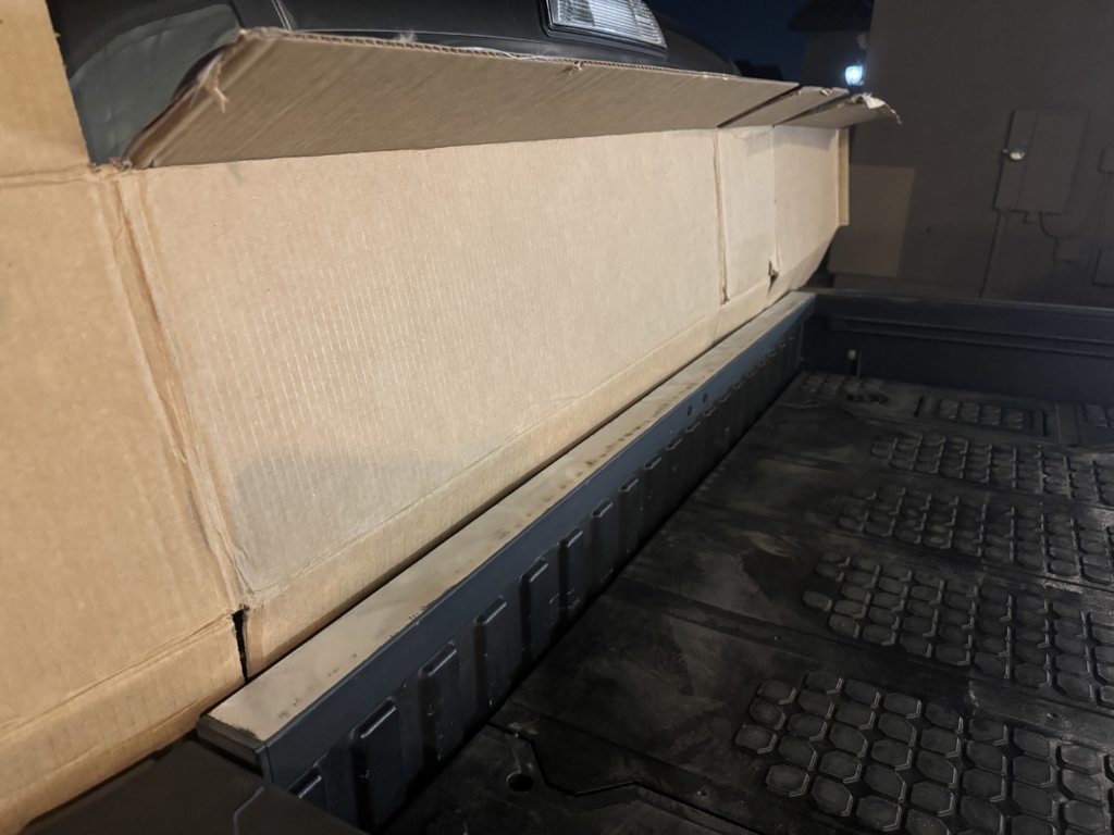

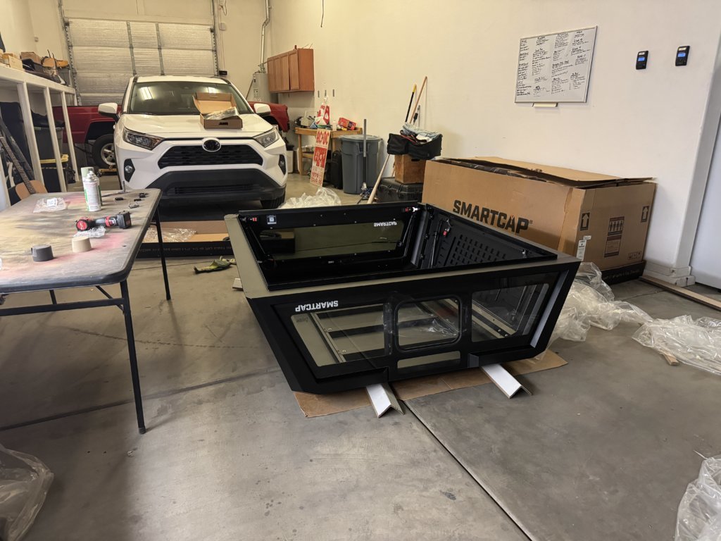

    The first step to putting my cap together had nothing to do with the cap. When I purchased the truck, the rail by the rear window had it's paint worn down. While this rail is aluminum and wouldn't have affected the function to the cap being in place, it would've bothered me if I didn't repaint it. So a little bit of work with a wire wheel and some Dupli-Color Rust Barrier paint. Again, the rail is aluminum but I had the paint left over from when I cleaned up my frame.

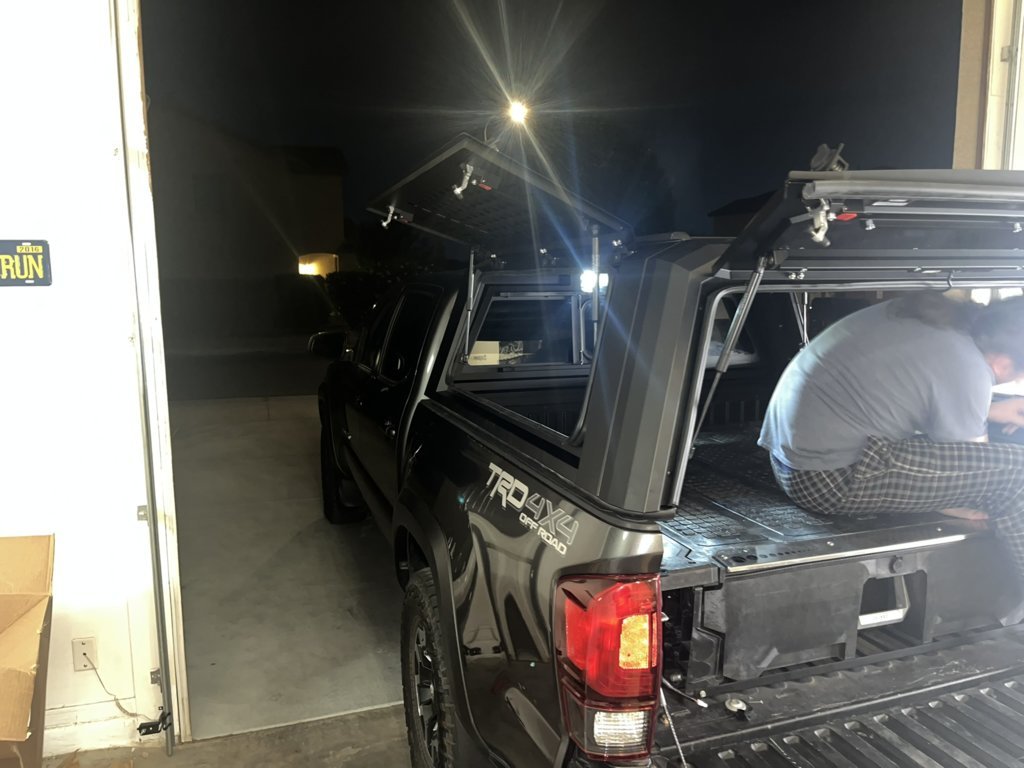

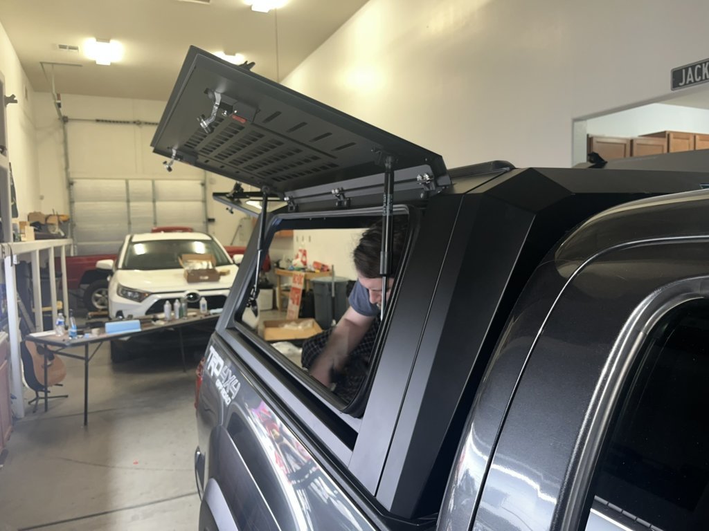

    Assembly was pretty straight forward. Using the packaging as protection for assembly is slick.

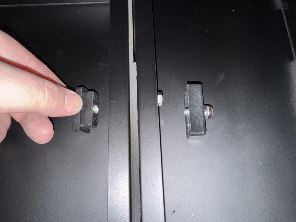

    One of the great designs I love are these blocks that are used to put the sections together. Love me some simple designs that just work.

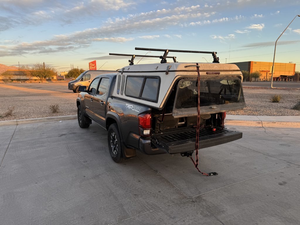

    Two people is definitely the minimum. RSI recommends four just for lifting, but two guys in their twenties was more than enough.
    Turns out that Rav4's make great tables!

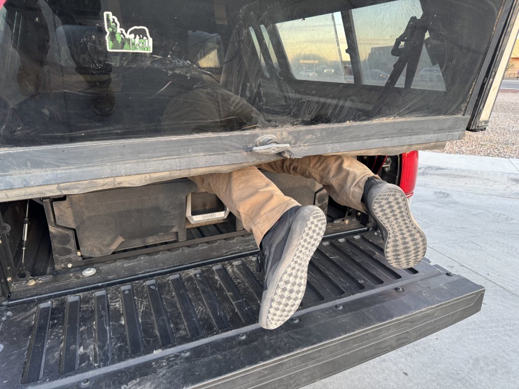

    It took a bit of muscling to manuever the cap with just two people, but a little bit of sucking it up and moving in slow bursts so we don't damage the cap or the truck made it easy work.

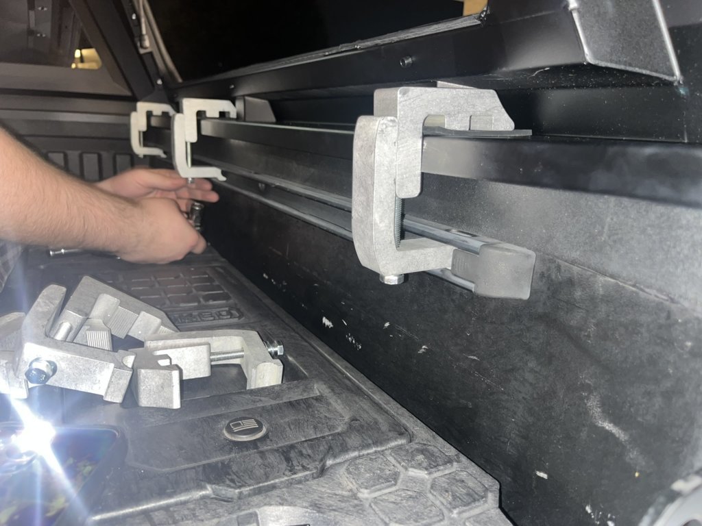

    Putting the clamps on the rails took us a few tries. When we first clamped them down, we clamped them in different spots from where we put the big rubber blocks that go on the under side of the clamp. We found that we were kinda of bending the rail a bit, so we backed them off and reapproached it. We decided to read the instructions (heresy!) and decided the most logical way to clamp them down was to clamp them onto the blocks. Once that was done, we once again reference the instructions (more heresy!) for the correct spacing. Measuring the outside of the cap to the bed for the correct height wasn't proving to be very consistent, so we measured based off the clamps. We decided on about 5/16th's on an inch on each clamp all the way around.
    Wired up the cap and we were done! Finished at roughly 2 AM and slept like a baby.

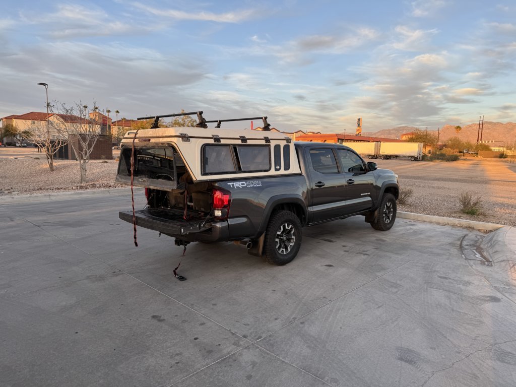

    Of course, no modification would be complete without a shakedown run and adding stickers. Hopped on down to Home Depot to get salt for my home's water softener system and added some spare stickers I had laying around.
    So far, I'm very happy with the cap. Very simple to put together, well designed, and looks great. Hard to ask for much more.

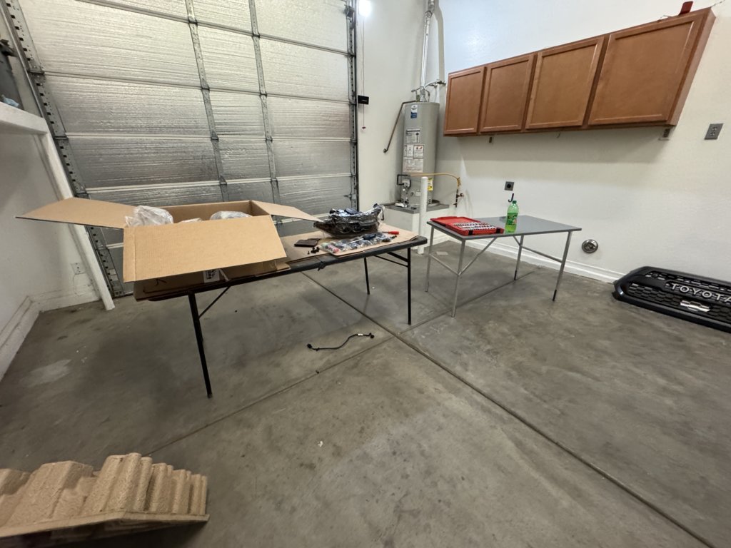

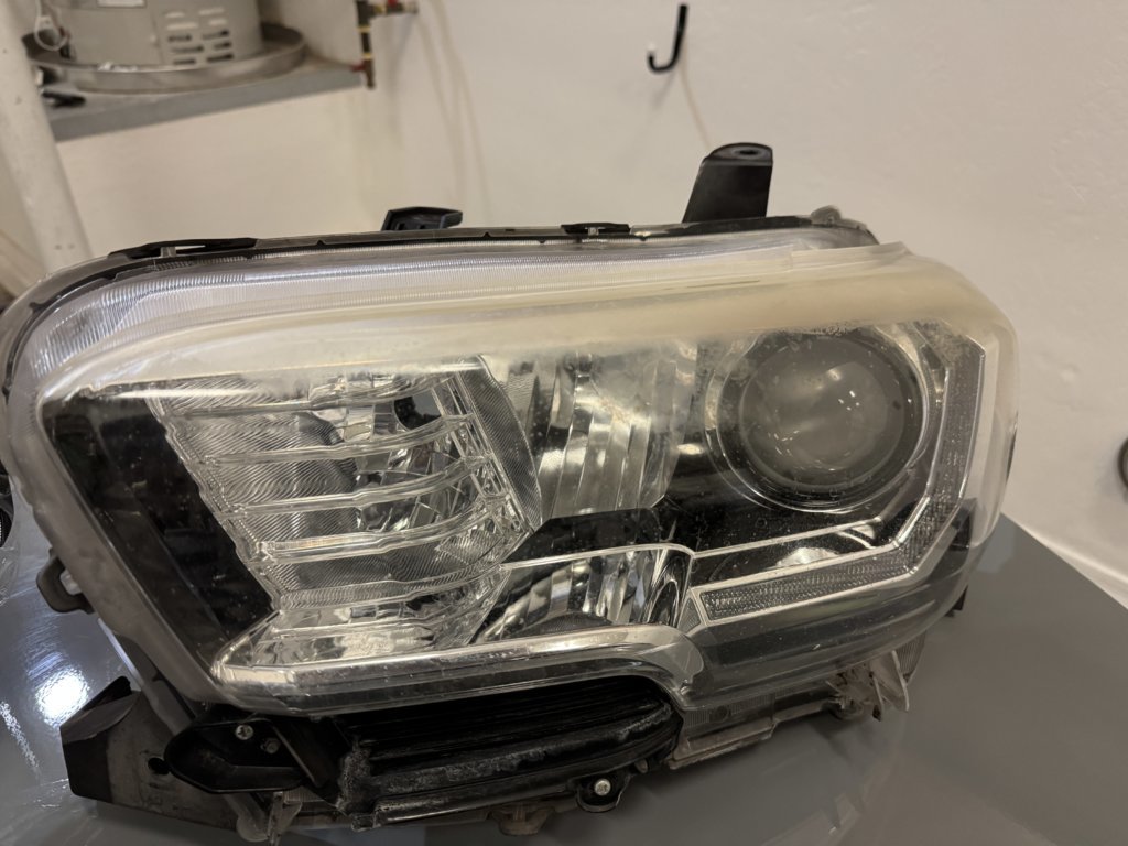

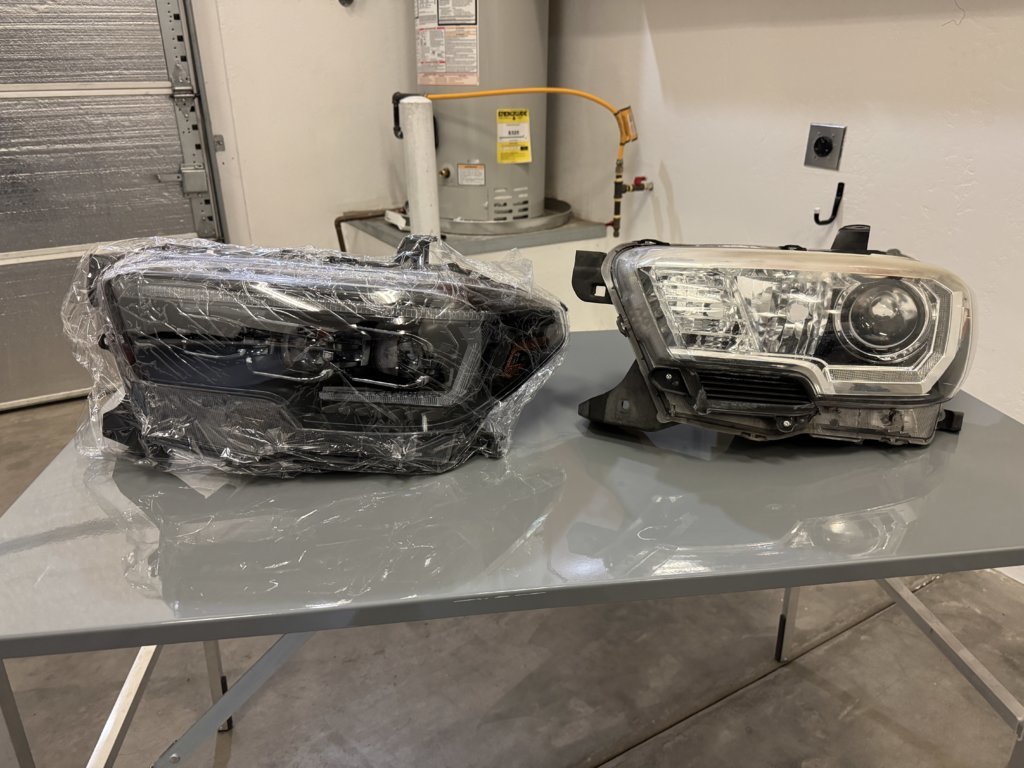

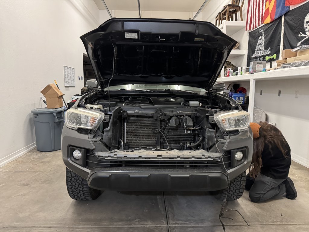

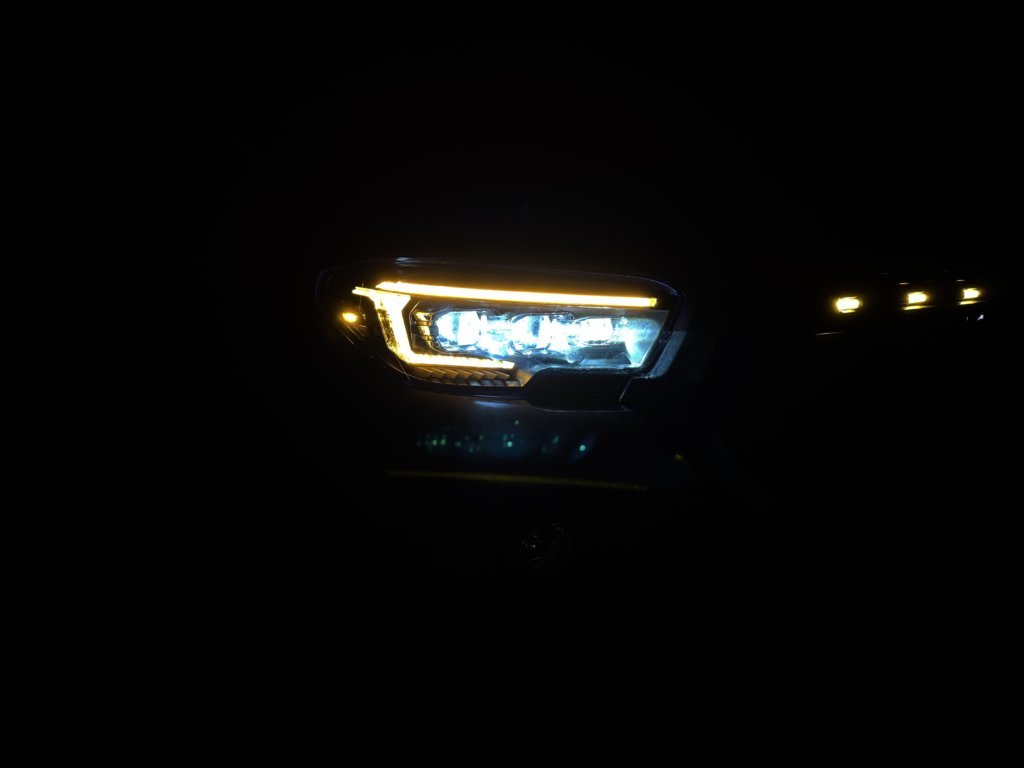

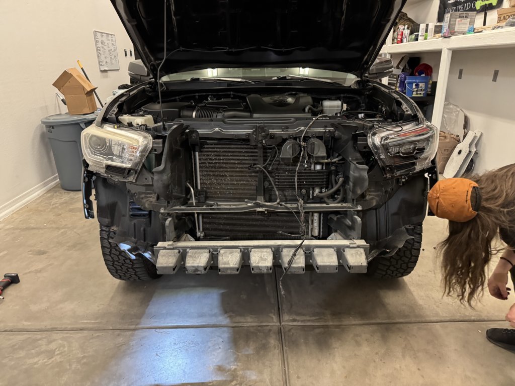

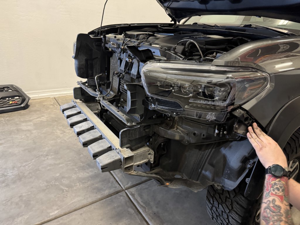

    First up was the Morimoto XB Evo Headlights. While my factory headlights were functional and serviceable, running halogens in an LED world was proving to be damn near dangerous. Other drivers running LEDs (turn yo damn brights off!) coming towards me basically negated the light output of my halogens. Even living in a city like Phoenix, it would be hard to see the lines in the road at times. If there was rain or a haboob, forget it. Easier to just pull over so I don't hurt someone.
    First part of installing was using something completely unrelated to the headlights:
    Tables! I definitely overpaid for the StowAway table, but it is worth it having a table in my truck permanently. The mount for the table is a genius way of using space. While I understand that most of the cost is in the mount, and the table is very high quality, $525 is still a hard pill to swallow. Oh well, having a table I can use for installs on the truck or while in the desert makes the table pay for itself.
    Big difference in the two headlights. I went with the XB Evo's for two reasons. First, the LED's were a massive upgrade. Second, I could choose between fade on/off and sequential for the turn signals. I do not like sequential turn signals, so being able to choose fade on/off was a major bonus for me. It's a bit of a bummer that you have to buy their high end XB Evo's to get that feature. The price point of the XB Evo Hybrids are much more agreeable to my wallet, but the ability to have the choice is better. I'm the type of guy who can change his mind on something over the years, so if I feel like I like sequentials down the road, I can go to them.
    A much cleaner and meaner look.
    My roommate and I ended up breaking some bumper clips while doing the install. Unfortunately, Morimoto's instructions don't account for factory flares, so a bit more time was spent figuring out how to take them off. Broken clips and plastic pieces are no worries, Rock Auto is to the rescue!
    Post install test drive. These are worth every penny! Despite my truck having a bit of a lean back due to the SmartCap and Decked system, they are adjusted pretty well. Actually being able to see the road is such a breath of fresh air that I can't believe I didn't do it sooner.
    I did not buy the Super Chargers with these headlights. I wasn't sure if I wanted them, especially for lights on the road. I'm still not sure I want them, given the task of installation, but I can only imagine how powerful they are.

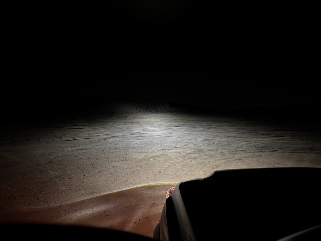

    Last night, I ended up using the truck as my work lights while doing some night shooting. Absolutely fantastic. Although, some traditional work lights hooked up to a portable battery system seems like the better solution.
    Low beams on a moonless night in the middle of the desert
    High beams under the same conditions
    Can be a little hard to pick up via camera just due to the nature of how our eyes perceive light vs. the sensors on a camera. In previous night shoots, I'd barely be able to see if front of me, let alone the sides. Now, I can see nearly everything.
    Overall, these are well worth the upgrade. Expensive, yes, but worth it. Not pictures are the Morimoto tail lights that I went with a few days after this. I figured the same reasons for buying LED's up front should apply to LED's in the back. Those are a very simple install with only three bolts and a bit of force.

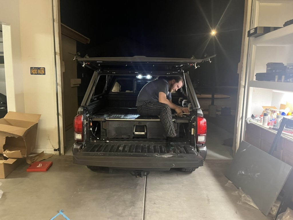

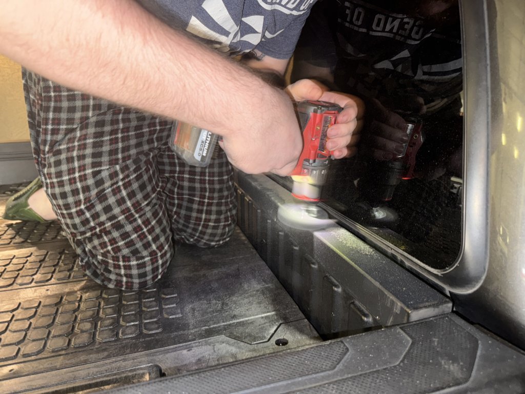

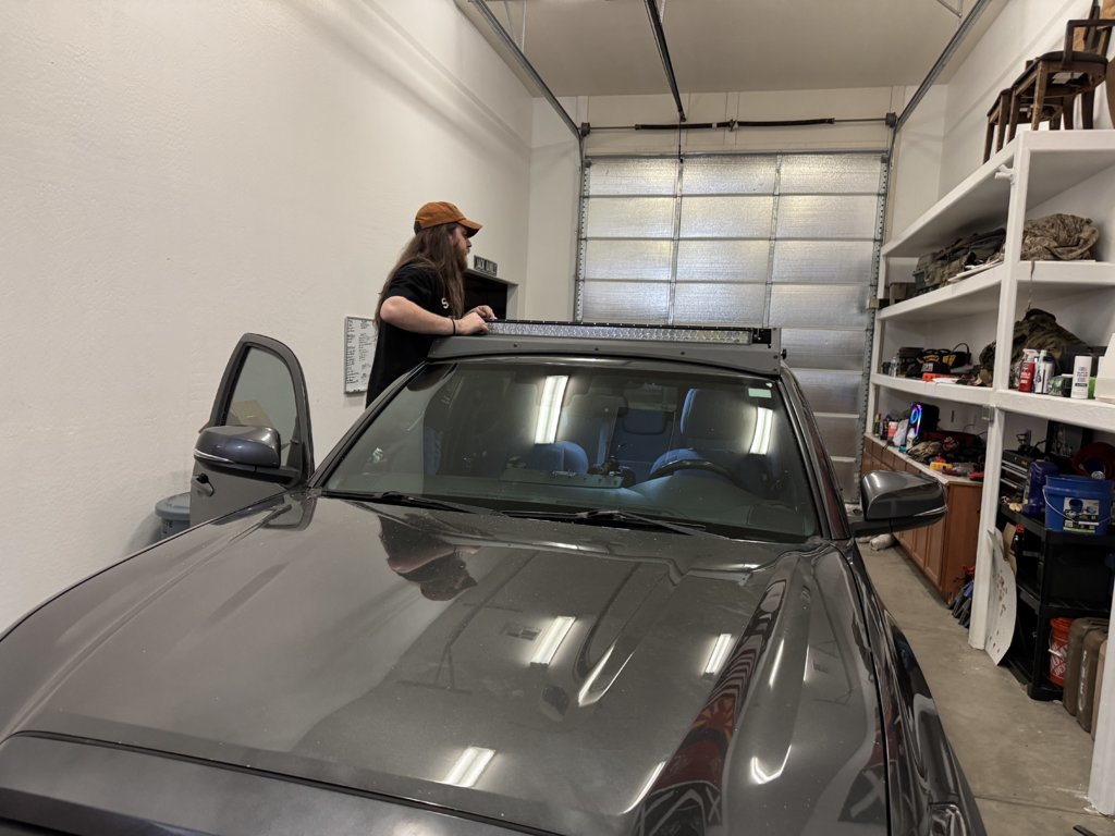

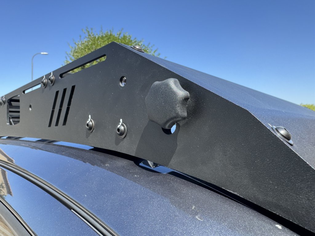

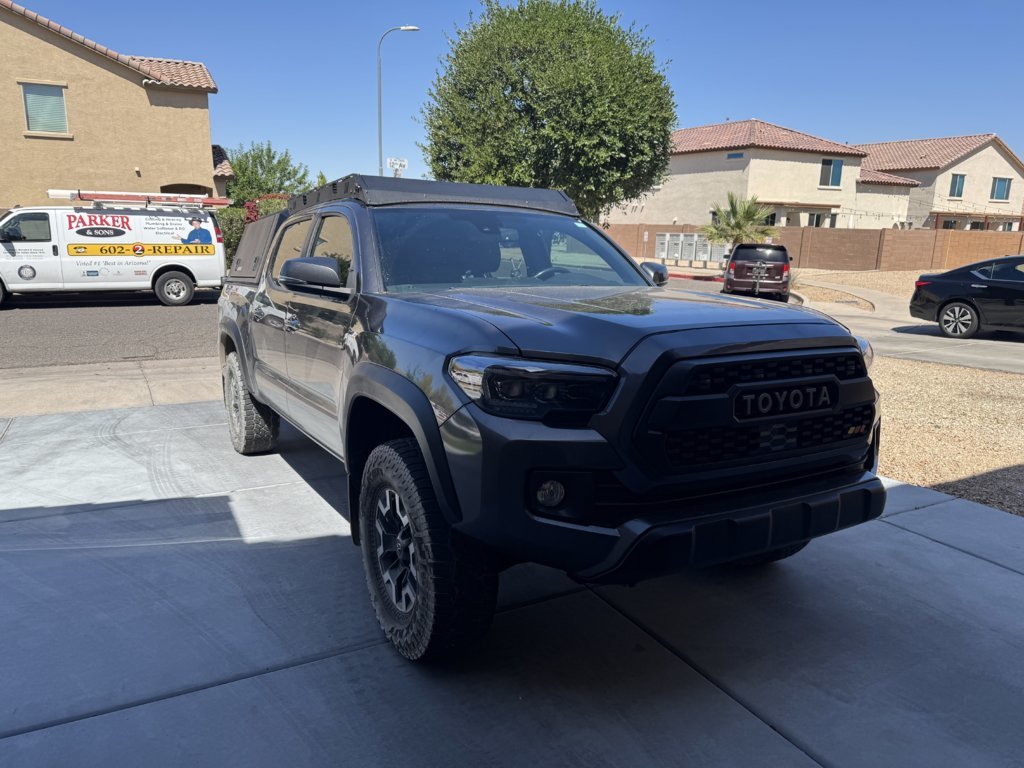

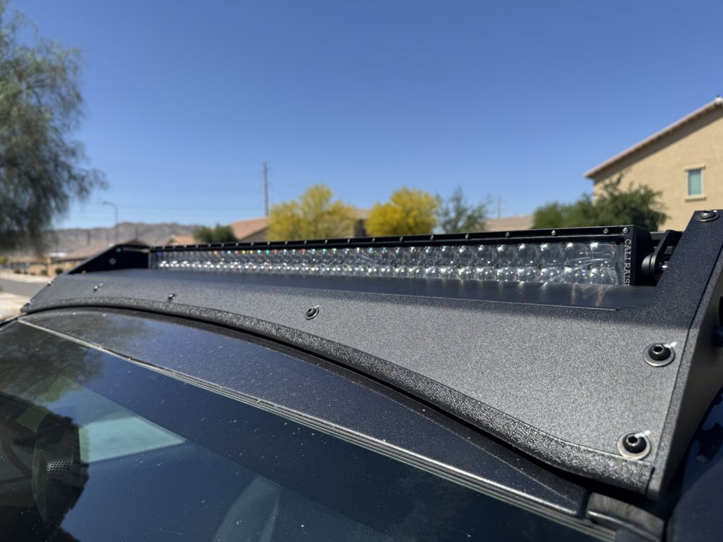

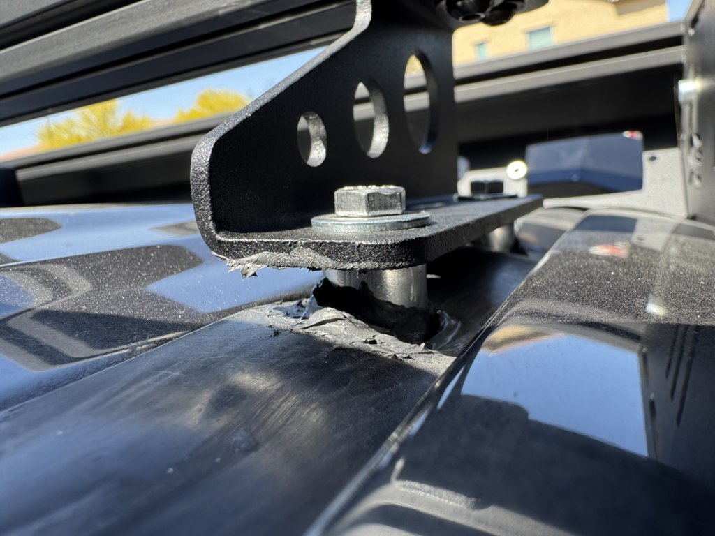

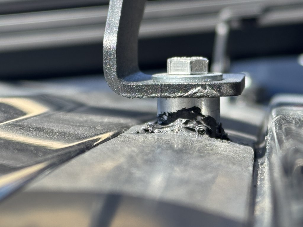

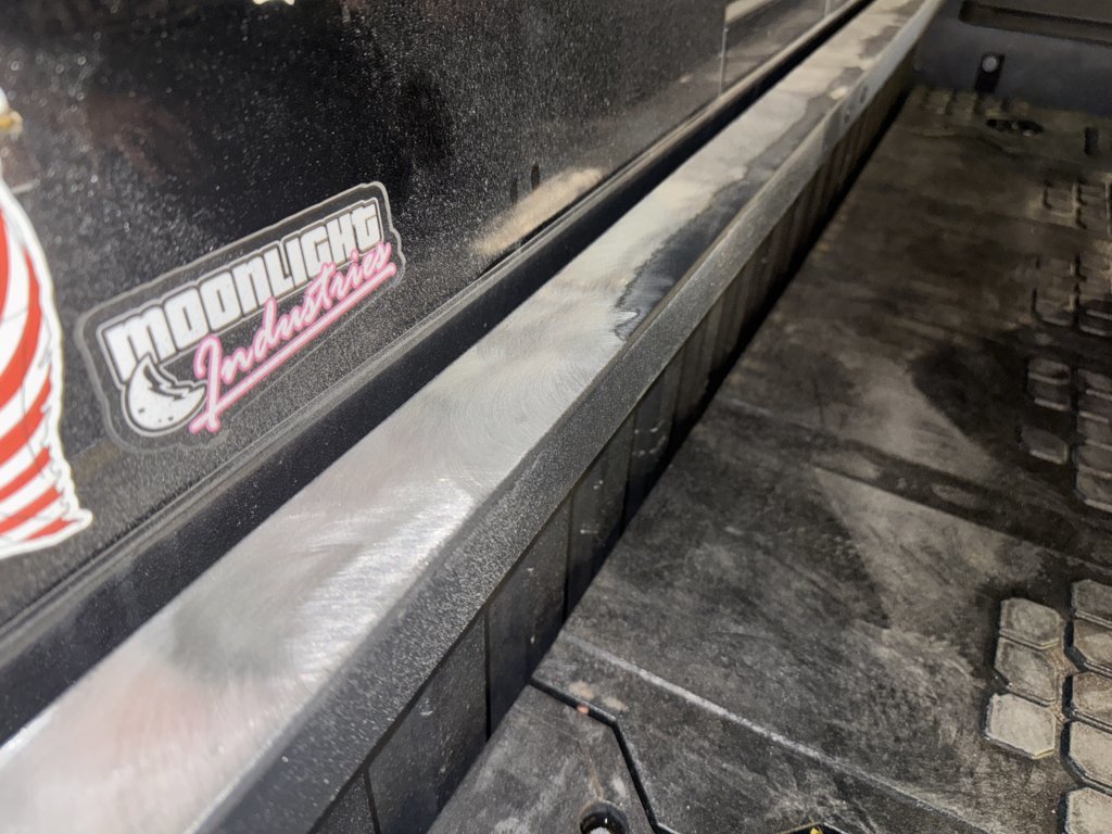

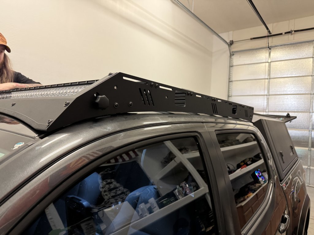

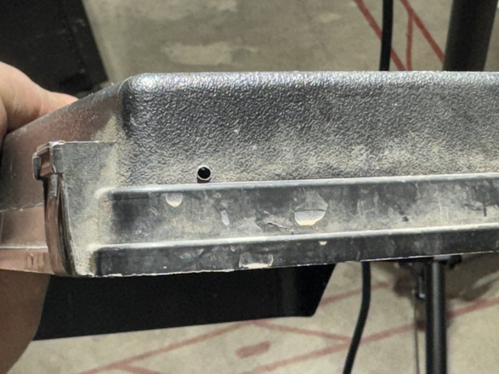

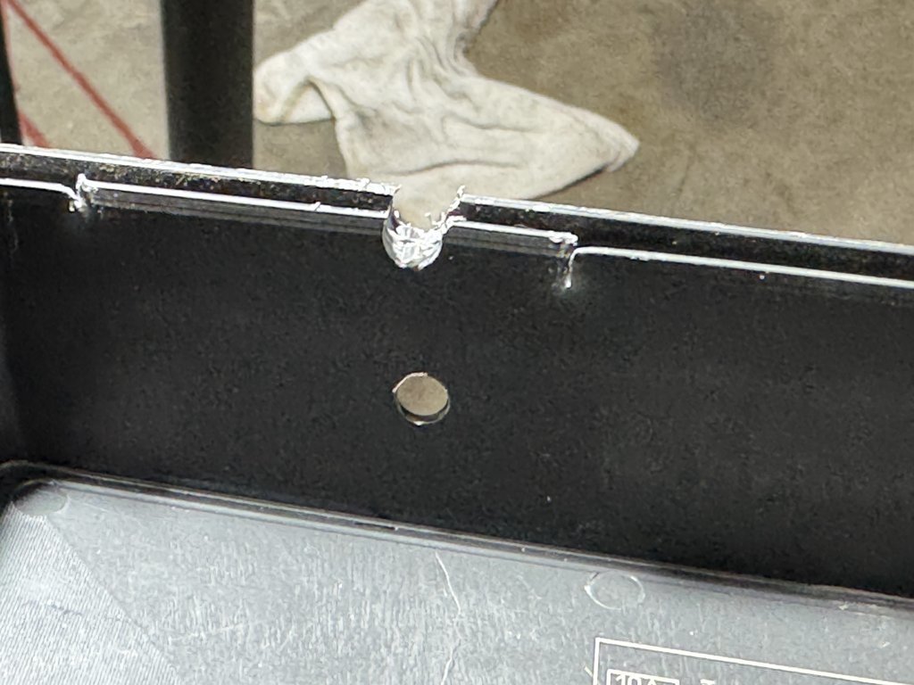

    The same night that we installed the Morimoto's, we also installed the Cali Raised LED Premium Roof Rack. I've always known that I wanted a roof rack because I do plan on mounting a 270 degree awning. I was originally going to go with a Prinsu, but decided on the Cali Raised for the adjustable wind deflector.
    The adjustable wind deflector absolutely cuts any excessive wind noise you would get if you didn't have it. It can easily be unscrewed and pushed down from the seat, but you will need to have a passenger to do the passenger side. Otherwise you gotta get out. My advice so far would be making sure they are tight whenever you mess with them. The knobs are kinda short so if you leave them loose, I can easily see them falling off while on the trail or the pavement (depending on the conditions of the roads).

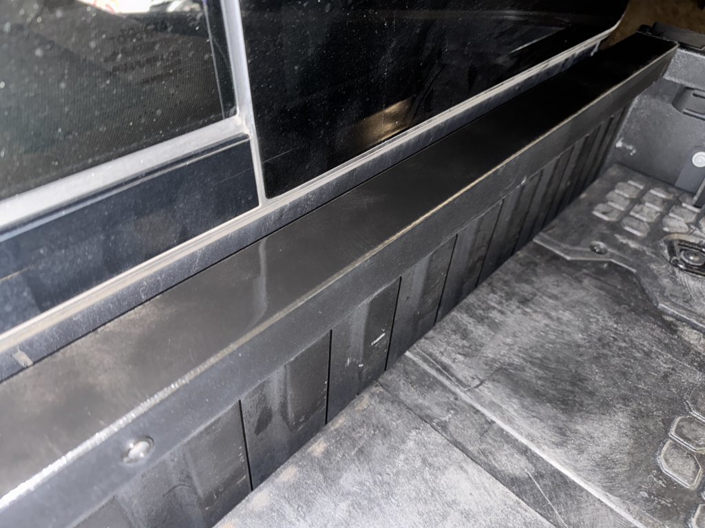

    One thing I wouldn't recommend doing is cutting through your weather stripping. As you can see, I totally whiffed cutting up the weather stripping. I tried to make it up by filling the gaps with RTV, but it is most definitely not pretty. I would suggest just using RTV on the spacers and using black 100 MPH tape in the gutter. Even though I used a step bit, a razor blade, and a paint pen to mark and cut in the correct space, it never really cut very well. Even with a very generous application of 3M double sided automotive tape in the gutter to secure the weather stripping, it just never went back in place as well as factory.
    Lastly, I purchased the 42 inch light bar (and ditch lights) from Cali Raised LED. Since I was making a large order with them, I figured I'd add the lights just to simplify everything. After paying $350+ for the light bar, I'm quite disappointed. The light bar is made in China and is essentially upbadged with Cali Raised LED's logo's on it. If I wanted a cheap light bar, I could've spent a lot less money. That being said, it is cheaper than a Baja Designs, and I have yet to wire it and test it. However, nowhere on the product page does it say the lights are made in China. I would not call it dishonest, just disingenuous.

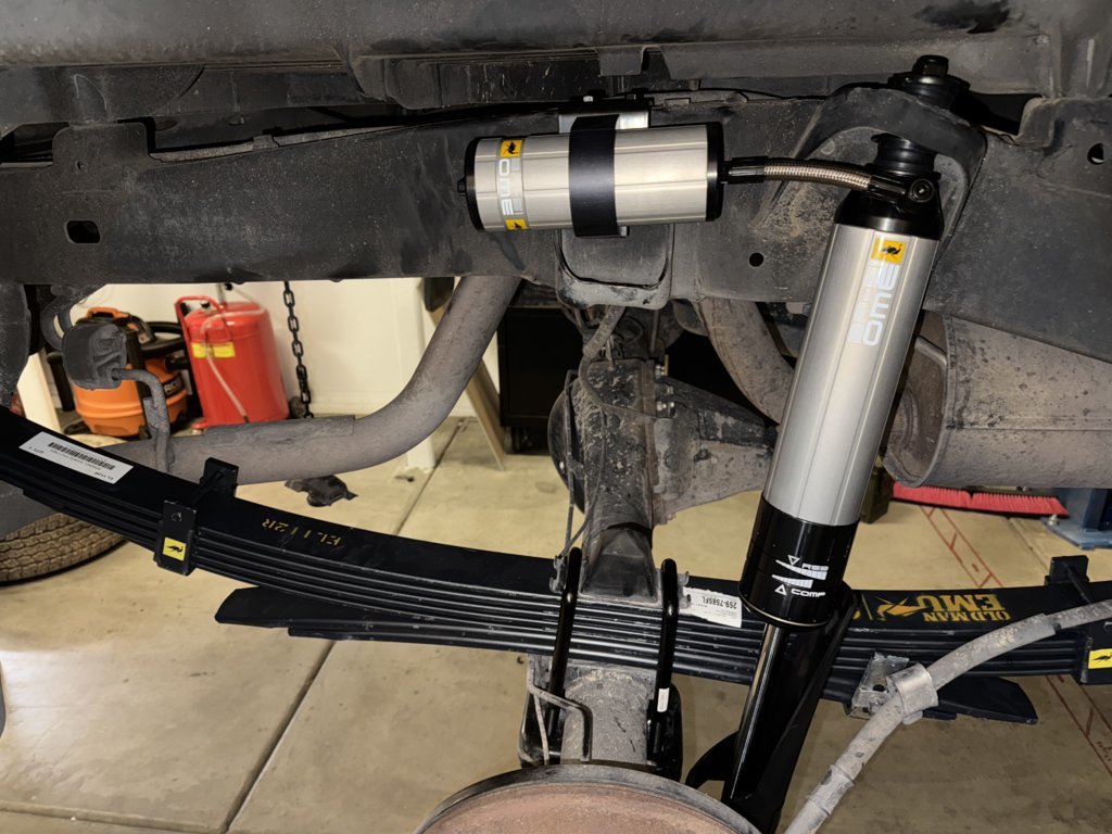

    Install of Old Man Emu BP-51 lift
    Install of Icon Rebound Wheels

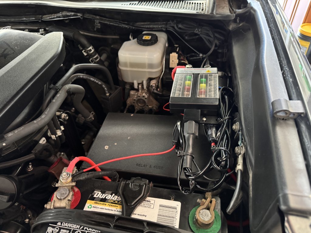

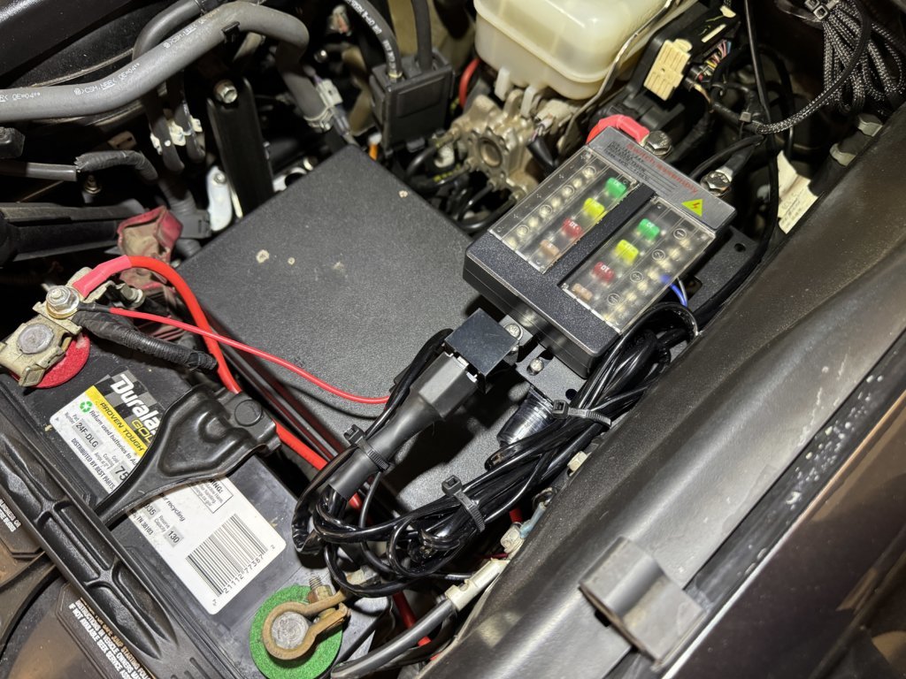

    Oh man, this is not an update I have been looking forward to writing.
    After a long 10 days of my buddy and I driving parts from Rhode Island back to Arizona for his 1989 Jeep Comanche, and another long four days of work, I decided to dive back into my Tacoma and knock out some things that needed to be done.

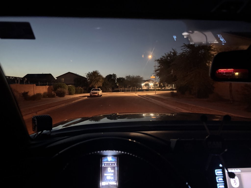

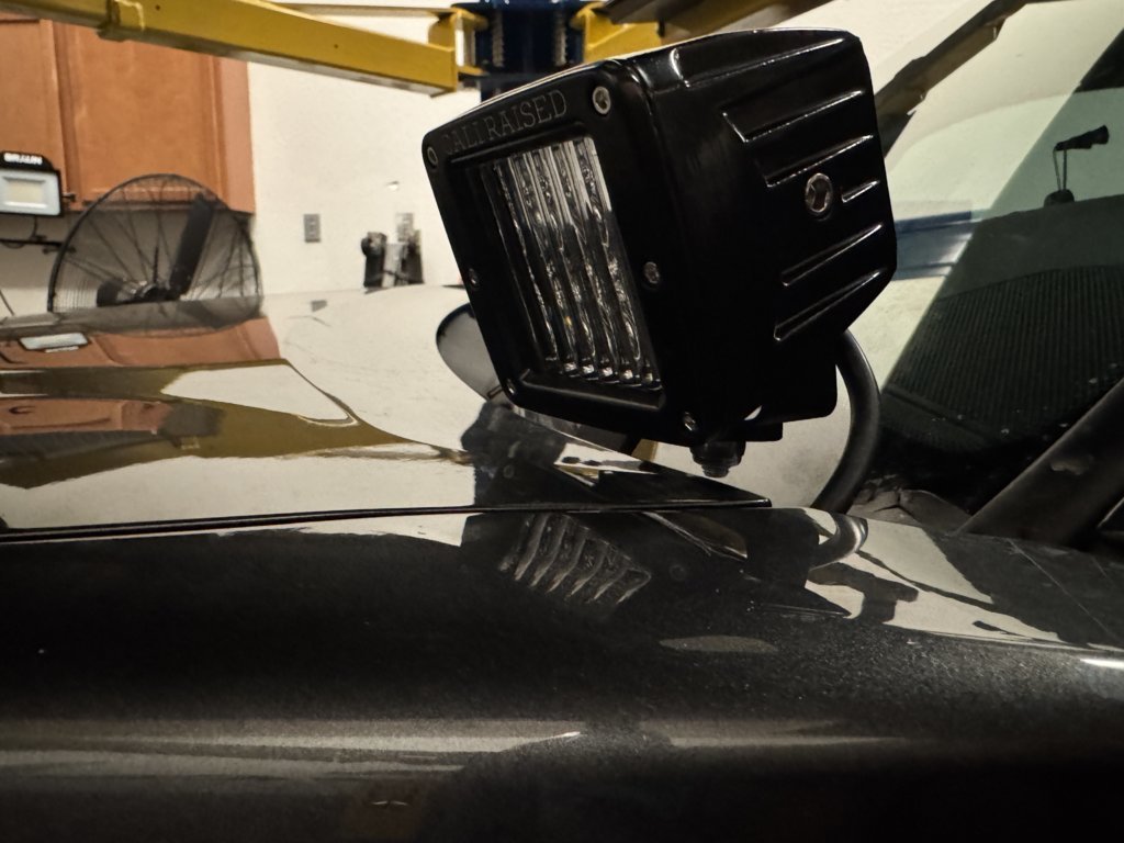

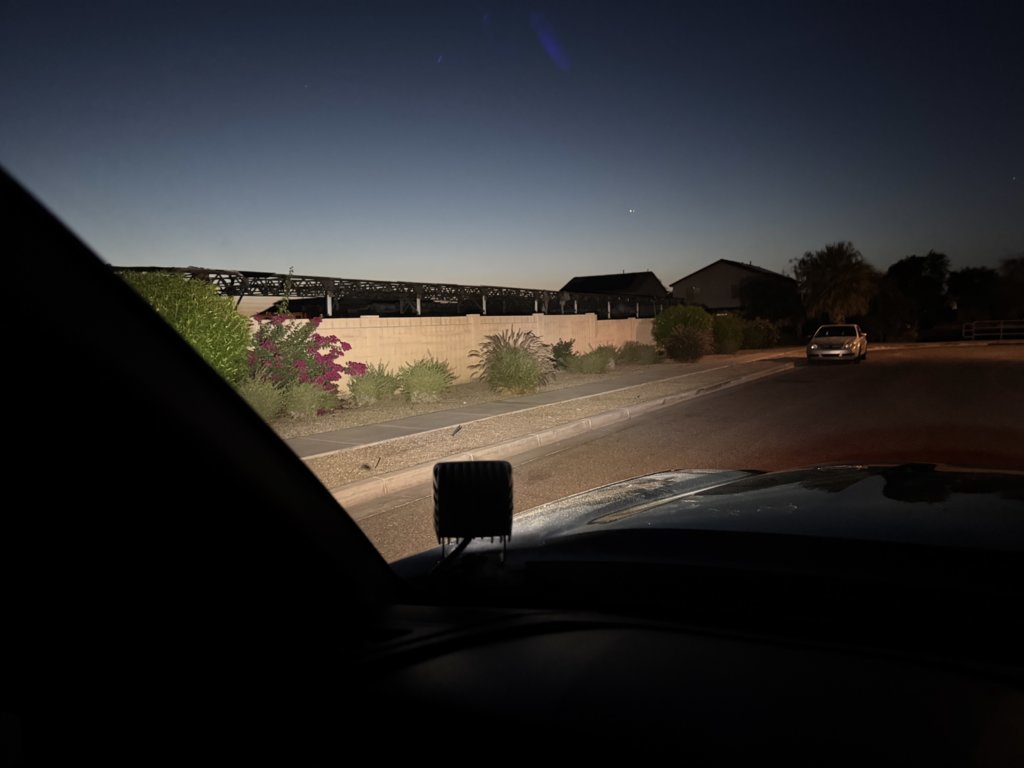

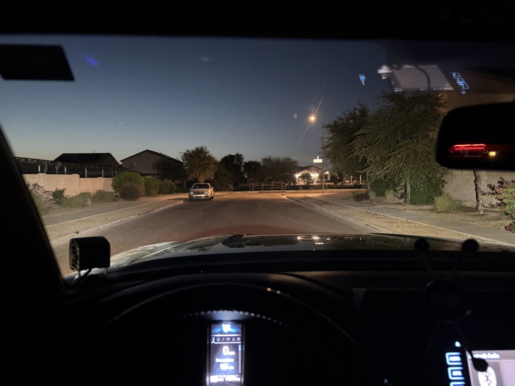

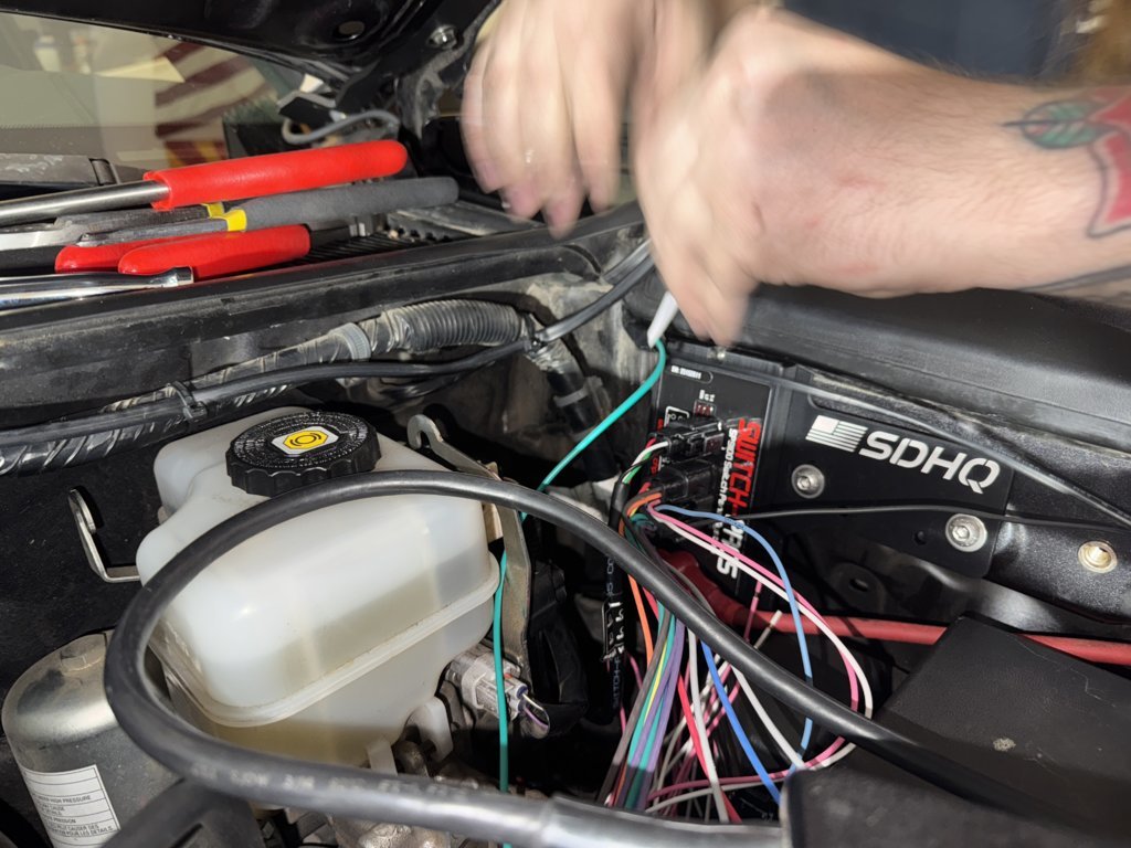

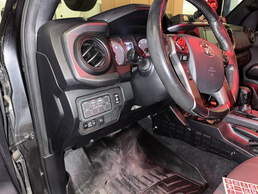

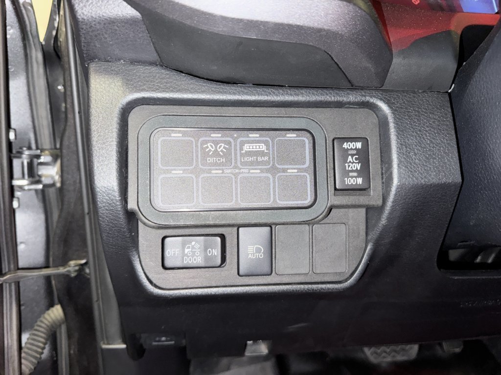

    One of the things I've really struggled with on this truck has been lighting. It gets very, very dark out here in the desert and this specific era of Tacoma was trapped between old school Halogens and new and improved LED's. After replacing the headlights with Morimoto's, I was still not content with the lighting. Given that everything was just sitting on my shelf, I decided to get my solid state switch set up so that the rest of my lighting and wiring needs would be simple. Better to tackle to the most complicated task first so it's all downhill from there, right? Unfortunately, I ended up very disappointed and extremely frustrated.
    Now before I throw anybody else under the bus, I'm going to out myself first. In my haste to happily purchase truck parts, I did not do as much research as I should have (do not read that as I did no research, just not as much as I should have). I totally fell for marketing and trusting others at face value instead of fully investigating my needs. Weirdly, this isn't something I did when it came to suspension, wheels, tires, the SmartCap, or the Decked system. Maybe because I don't have as much experience with wiring as I wish I did, but I kind of just closed my eyes and hoped for the best. Regardless, half of the problems I will list down below have at least something to do with me.
    That being said, I am not solely to blame.

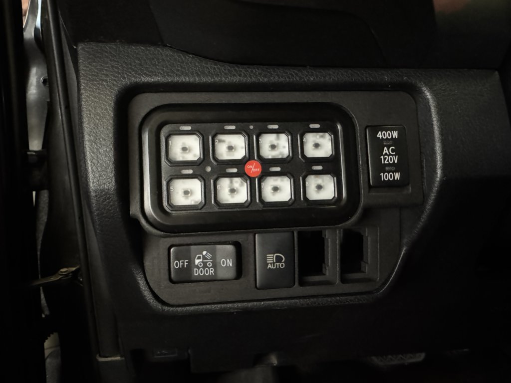

    As previously stated in this thread, I purchased my roof rack from Cali Raised LED. I purchased that rack in a combo deal with a 42" Spot Beam. I also purchased the Cali Raised LED Ditch Light Brackets with 3X2 18W LED pods. All of this was to be wired into the 8 gang switch control system that they sell on their website. I have seen all of these on several Tacoma builds, and all of the reviews I watched and read led me to believe that these parts were quality, well designed, and could handle the load of a light bar, ditch lights, and anything else I could throw at it. I was wrong. The switch control system that is sold on their website seems to be a knock off of the Auxbeam 8 Gang switch system. From what I can see from handling it and looking at Auxbeam's website, it seems to be the exact same product without any of the Auxbeam branding. What I didn't know, again from my lack of reading, is that this switch system is limited to a maximum of 60 Amps. Now, I cannot find the Amp draw for the 42" light bar or the 3x2 pods on Cali Raised LED's website. However, when you consider that Baja Designs OnX6+ draws a max 26.8 Amps and is of a much high quality, the Chinese rebranded light bar that Cali Raised LED sells for $1100 less has to be pushing closer to the 30 Amp max that is on the first line of the switch control. While ditch lights will pull less amps (Baja Designs crazy expensive LP9's only pull 9 amps), we are not exactly dealing with quality hardware here. If I wanted to add an ARB Dual Compressor to my rig, that has a max amp draw of 50.4 amps while under load. Now I may be under experienced or I might be missing a few brain cells from my time in the Marine Corps, but I don't think it is an unreasonable scenario to be running a light bar, ditch lights, and a compressor, let alone anything else.
    That's a long winded way of saying that this clone (see: same OEM) of the Auxbeam switch control system that Cali Raised sells is junk and is basically dead weight. The best way to run this switch system is to add a separate relay box that then feeds into the switch system. If you ask me, that totally defeats the purpose of the switch system. The only caveat I have to that is that it does simplify running cables to the cab. Instead of a bunch of wires running to individual switches, you have one wire running to one switch panel in the cab, which then hooks up to the control system.
    This is something that makes me feel like a total idiot and, if I'm being honest, I feel somewhat swindled out of my money.
    My solution is to totally ditch this control system from Cali Raised LED. As of a few hours ago, I ordered a Switch Pros SP-9100 system. I also ordered an SDHQ power module mount to keep everything much more organized and clean looking than it is now. The Switch Pros system is capable of handling 125 Amps with 4 outputs rated at 35A and 4 outputs rated at 20A. In my mind, this is a much more reasonable power usage and gives plenty of overhead. That being said, I will probably still wire a compressor on it's own relay, but that is something I see as totally acceptable and reasonable.

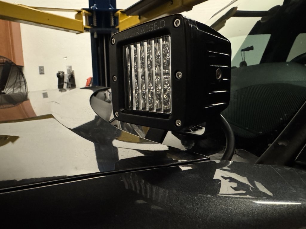

    Now, for these light bars and light pods. What an utter disappointment. While I know I was paying for cheaper lights, and they wouldn't be anywhere near the quality of the expensive stuff, they are so laughably underpowered, cheap, and poorly designed that I seriously have to question the intentions and integrity of the guys over at Cali Raised LED. I don't know how you can create genuinely good products like your Premium roof rack and rock sliders and then turn around and sell Chinese e-waste, let alone advertising them on the same page. I guess idiots like me will buy shit like this and learn a lesson, but it is utterly baffling.
    While these photos I post might seem like they are of acceptable brightness, remember that camera sensors and the human eye perceive light differently. I hate to be that guy rambling on a forum saying "trust me bro", but trust me bro, these suck and aren't worth the postage.
    Not to mention that the brackets the lights sit on make them extremely low to the hood. If the brackets sat higher (the light bracket, not the Cali Raised mounting bracket), then I could get a bit more peripheral vision in the dark and a little bit more spill downwards. That downwards spill can be extremely important here in the desert where things can be perceived weird when white light is shined. Given that these are definitely bargain bin universal garbage, it's hard to be too mad about it. Again, mainly disappointed after putting in a few hours getting this set up. The juice is not worth the squeeze in this case.
    Compound all of this with the fact that I'm still waiting on grab handles for my roof rack after a month of ordering and contact with customer service, I cannot recommend Cali Raised LED for just about anything. As good as their sliders and roof rack might be, their competitors do the same thing with better customer service. The things that their competitors don't have and that they do provide are of such low quality that it's questionable why they would even have it on their website.
    All this negativity set aside, massive shoutout to the guys at Guild Outfitters. Their base switch panel (4 short switches for a Double Cab) has been absolutely fantastic and creates an extremely clean look. Not to mention that when I decided to go to a different switch system, they have a insert that will work with no change at all. What a refresher it is to have people making some stellar products that have multiple options.
    I will take some more photos over the next few days as I take out the garbage switch system and add them to this thread. I won't waste my time with trying to return any of it to Cali Raised. I'll throw up on on the BST here or on Facebook marketplace and give 'em away for few cases of beer to some kid that needs lights on the cheap.
    Today's lesson: the expensive stuff is expensive for a reason. Sometimes, it's just better to just go with it.

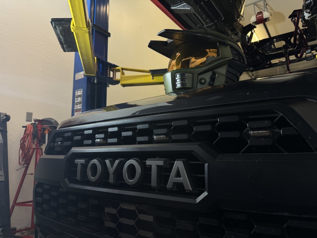

    Update:
    HALO. THE COMBAT HAS EVOLVED.

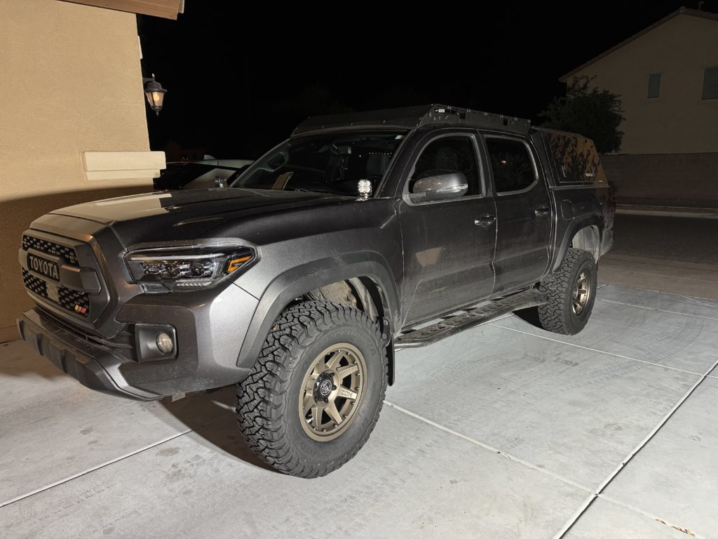

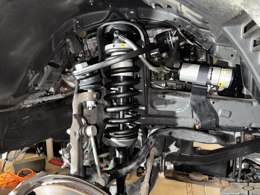

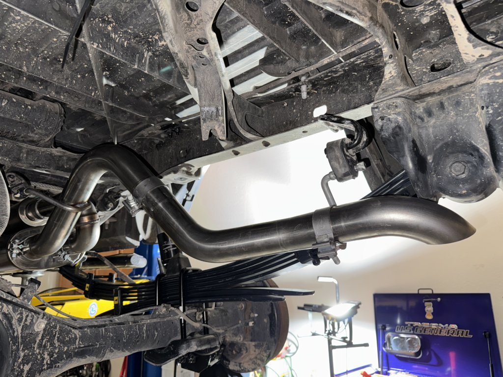

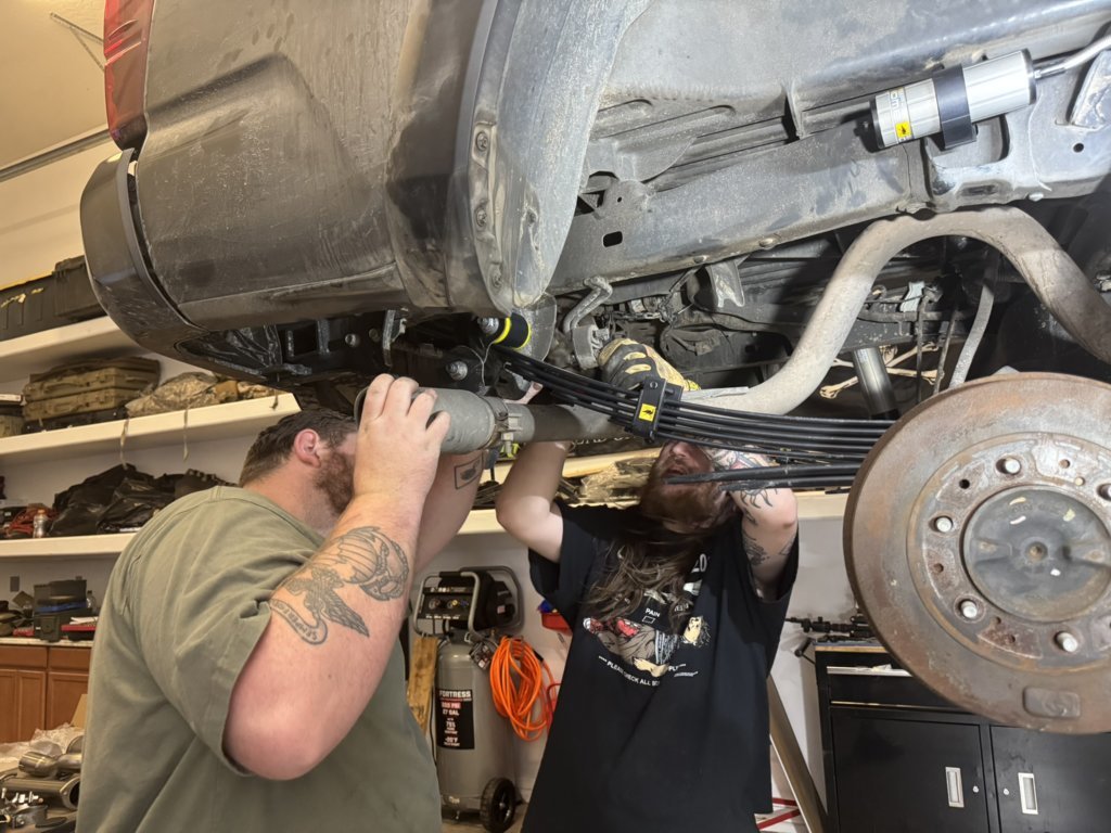

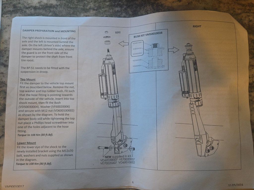

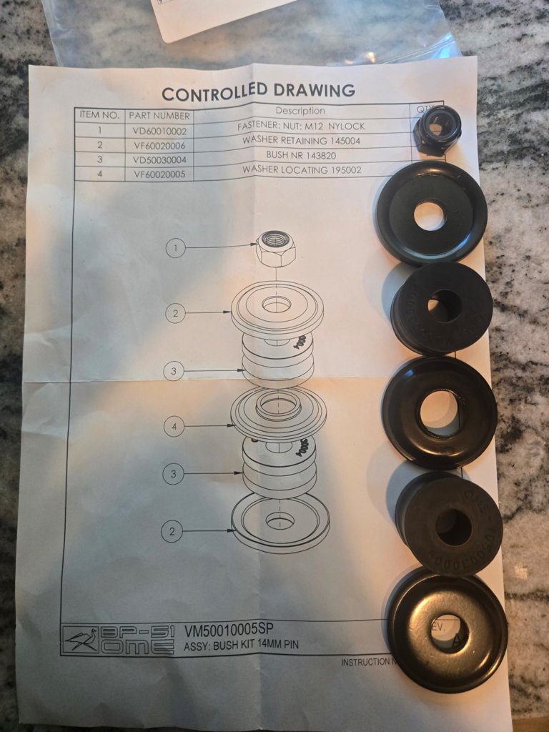

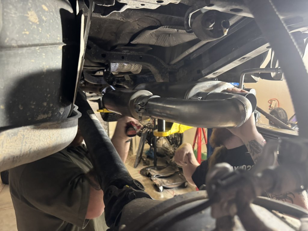

    Woah, big stuff happened over the past three days!

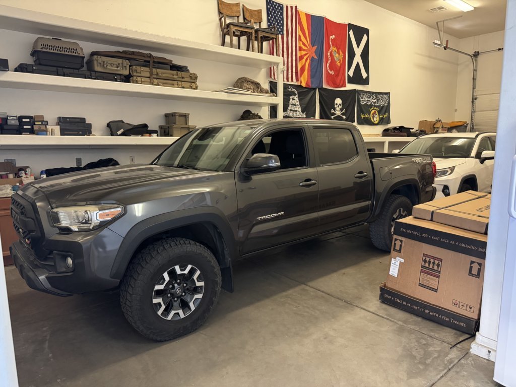

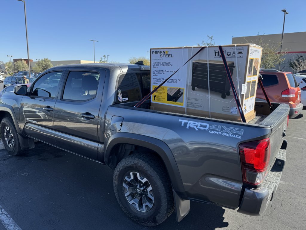

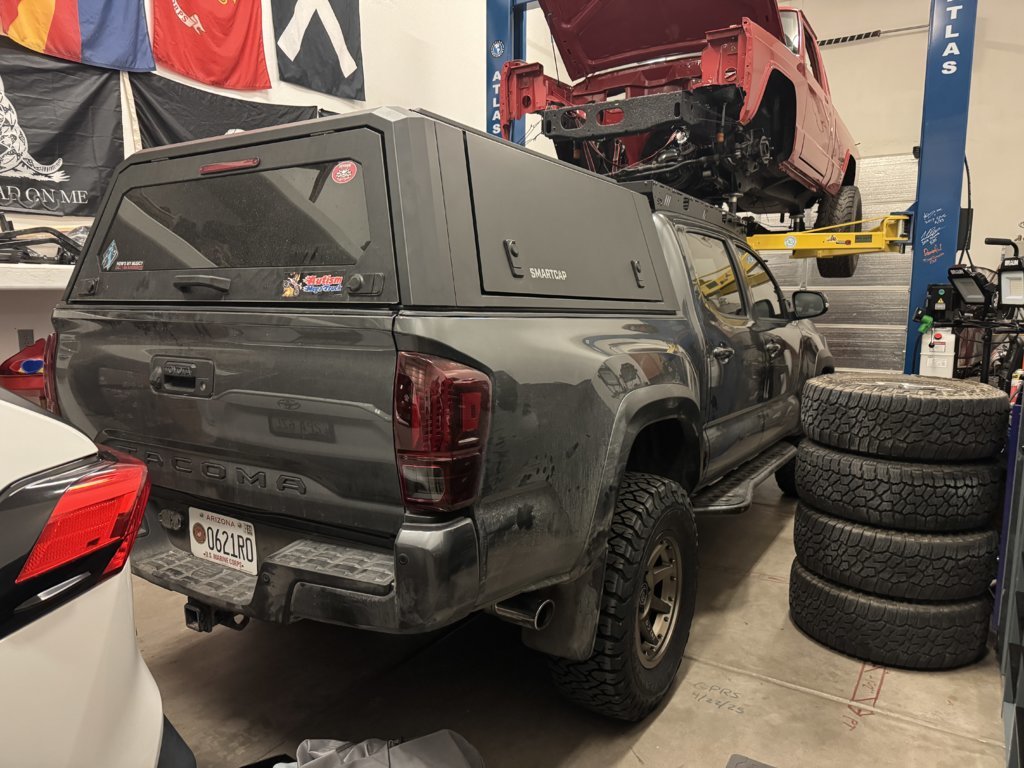

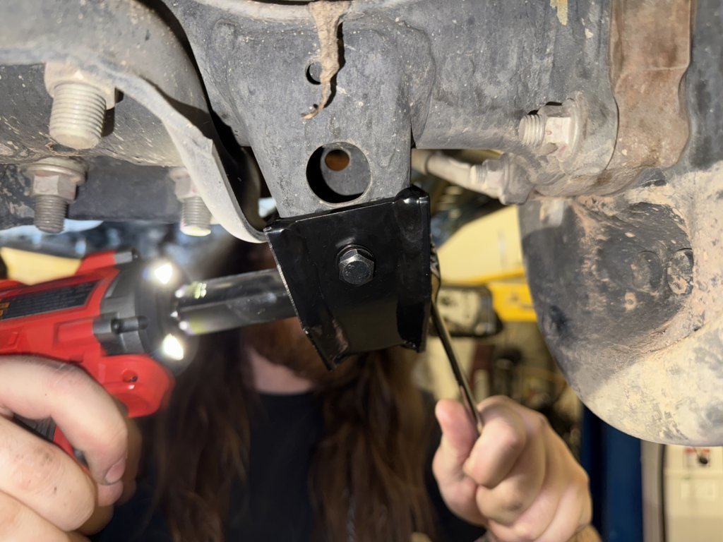

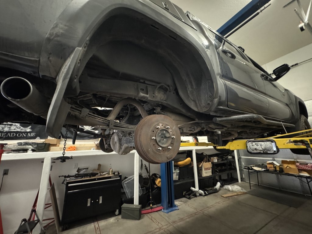

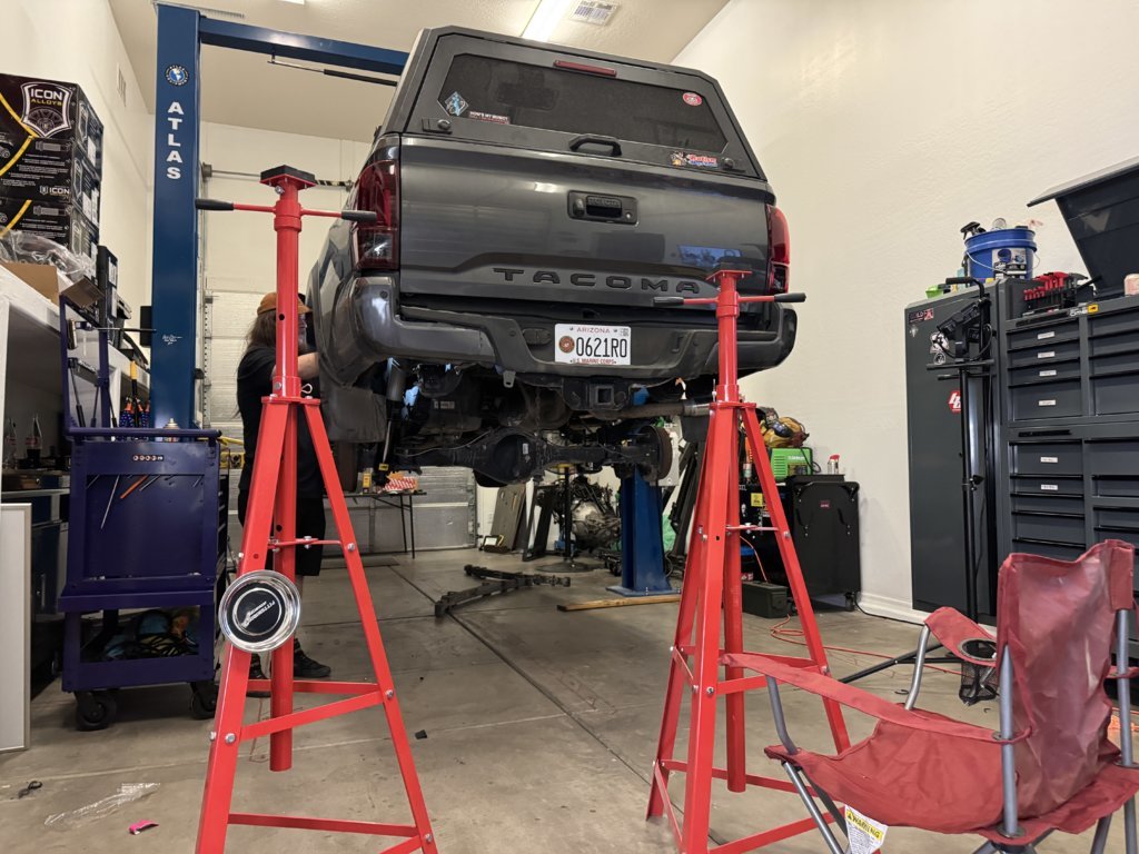

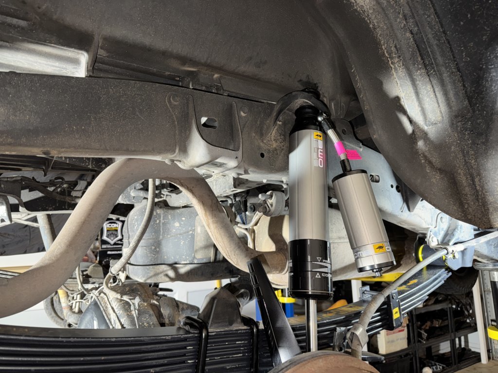

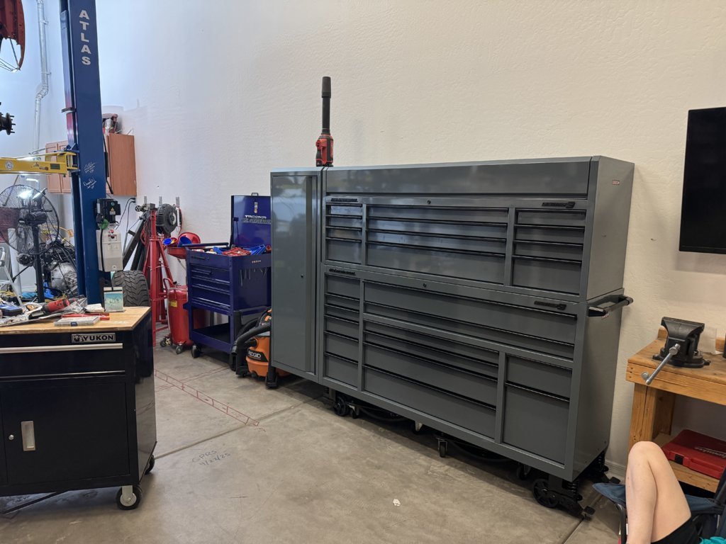

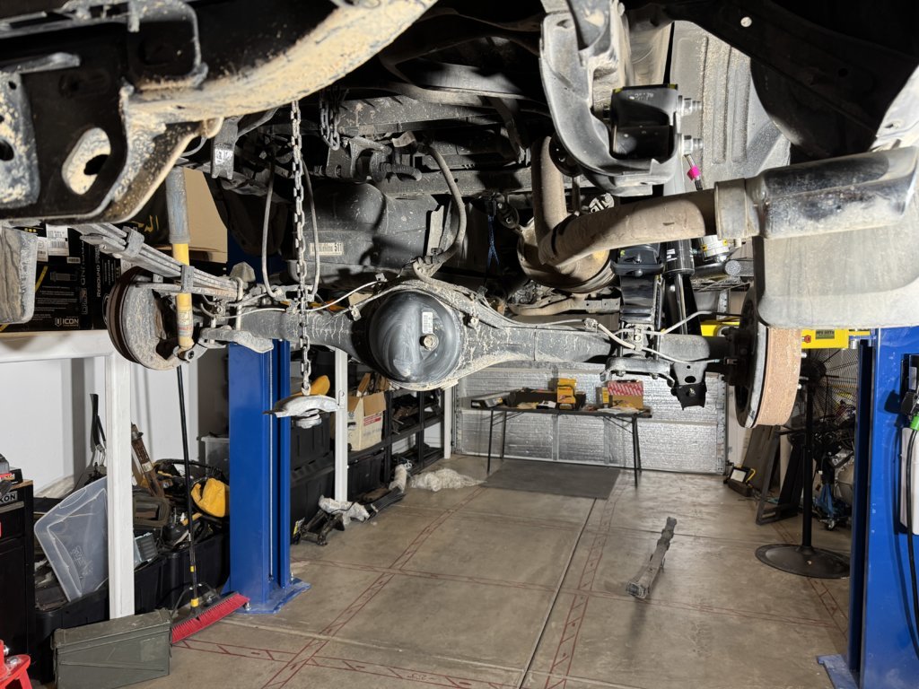

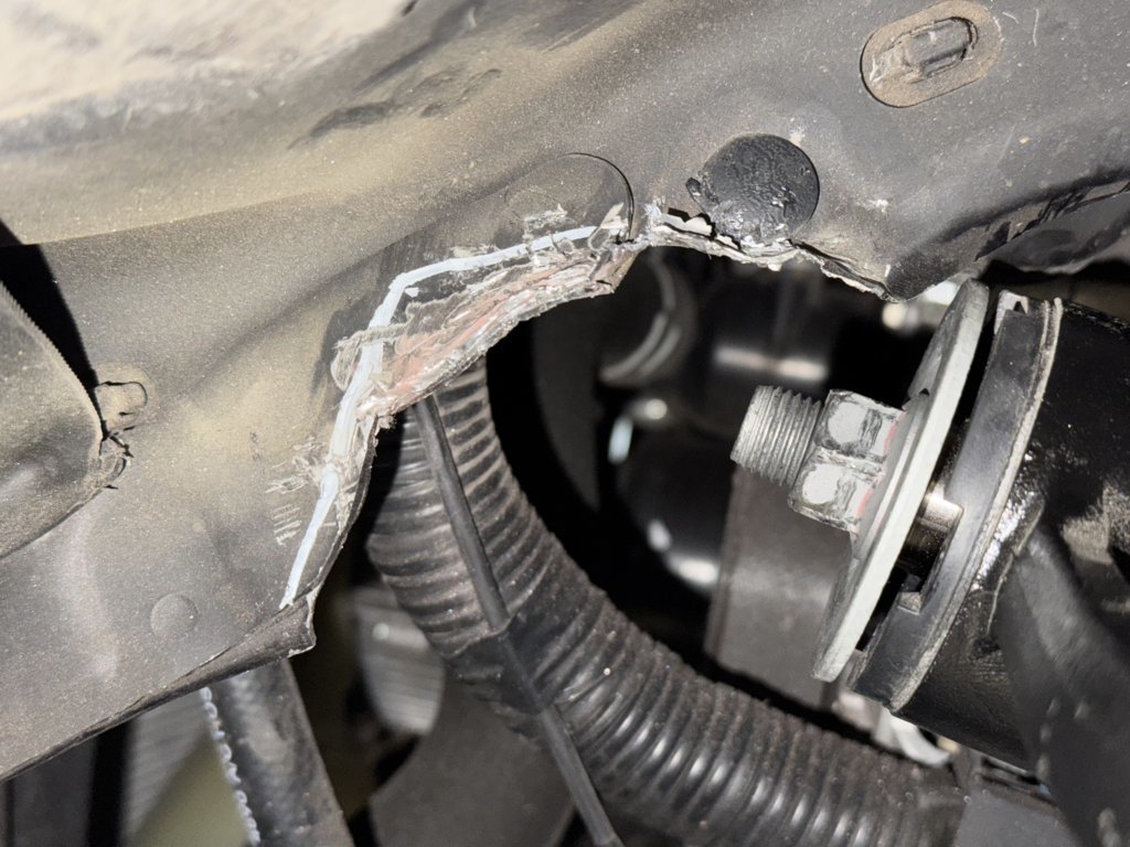

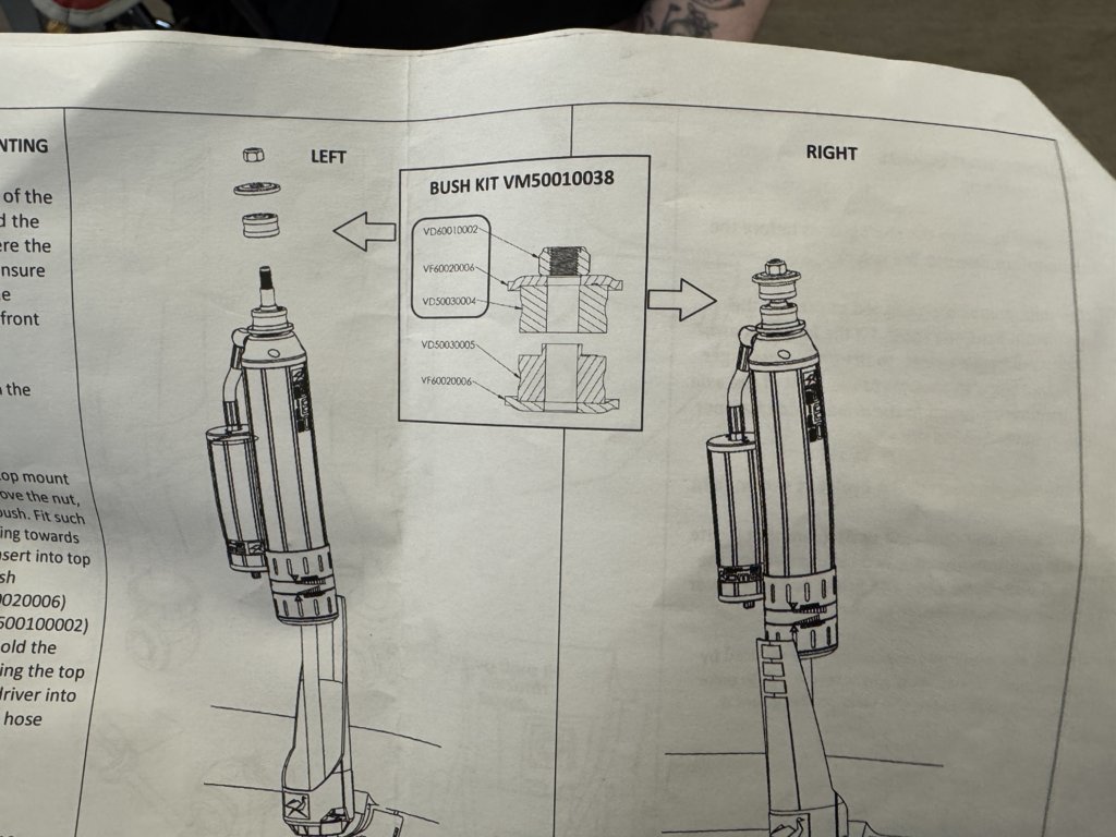

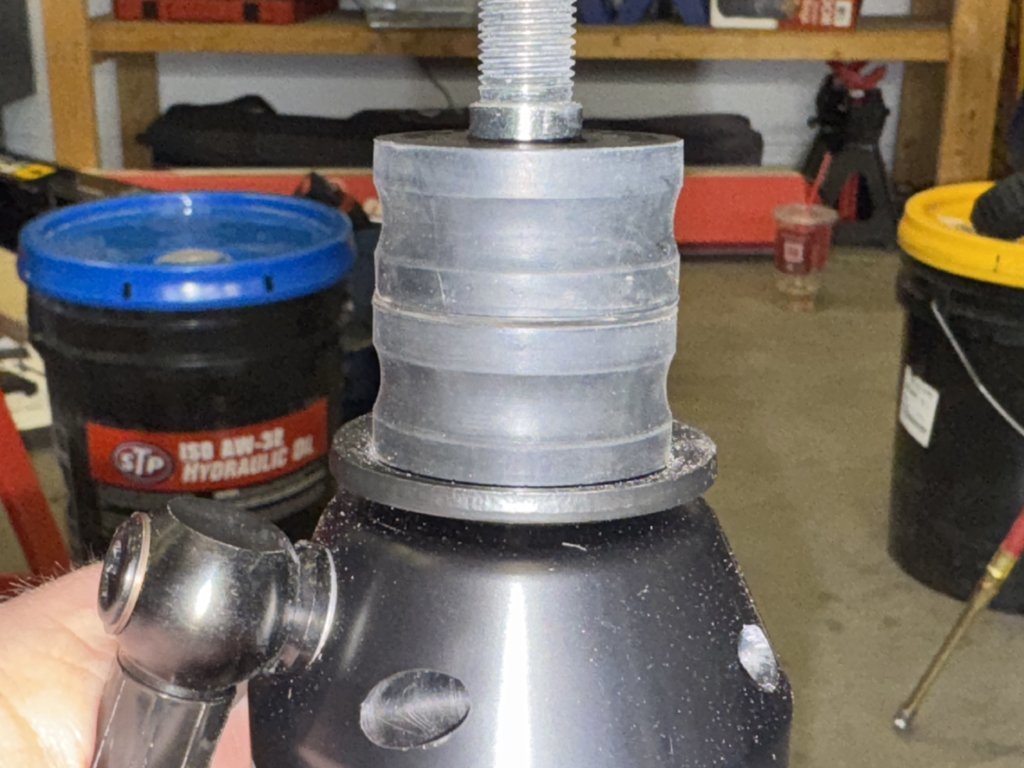

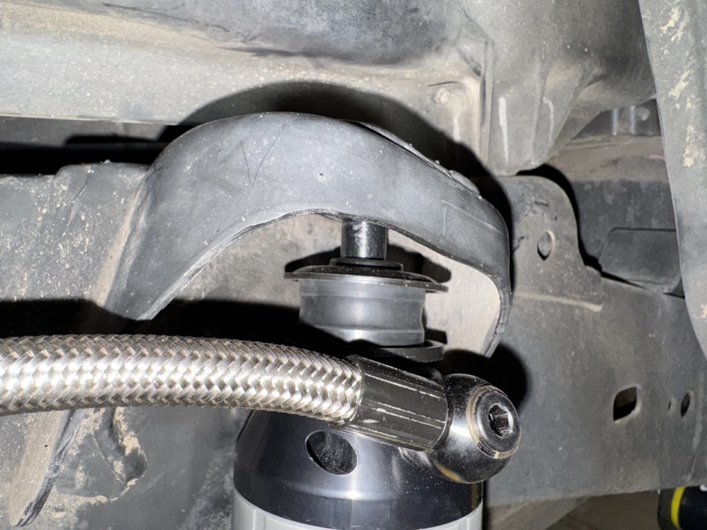

    A few weeks ago, I forked over my credit card at Harbor Freight and bought a 72 inch toolbox complete with a top tool chest and side cabinet. It wasn't supposed to be ready until mid June, but I got an email on the 31st that it was ready so I decided to pick it up on the 1st. For some reason, Harbor Freight doesn't do delivery. So that meant I was renting a trailer from U-Haul, grabbing my Tacoma keys, and making a little trip.
    The 1st of June this year ended up being the first time Phoenix has gotten rain on June 1st since 1914. Guess my luck paid off because my roommate and I pulled the toolbox in just as the rain started to pick up.
    Of course, I had to Praise Dale before I raise a little hell. Added some pictures of my dad on the toolbox so he's always wrenching with me (he's not dead, just on the other side of the country!).
    Now I realize that my home garage set up is a little better than most, but I gotta say that even if I was on the ground and in the Phoenix heat, I'd still love working on my truck. Especially if you got good company like my best friend and my wife. That being said, I'm not regretting putting a lift in my garage.

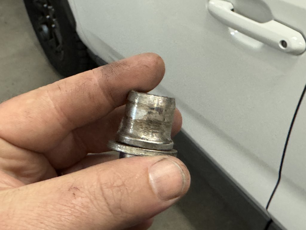

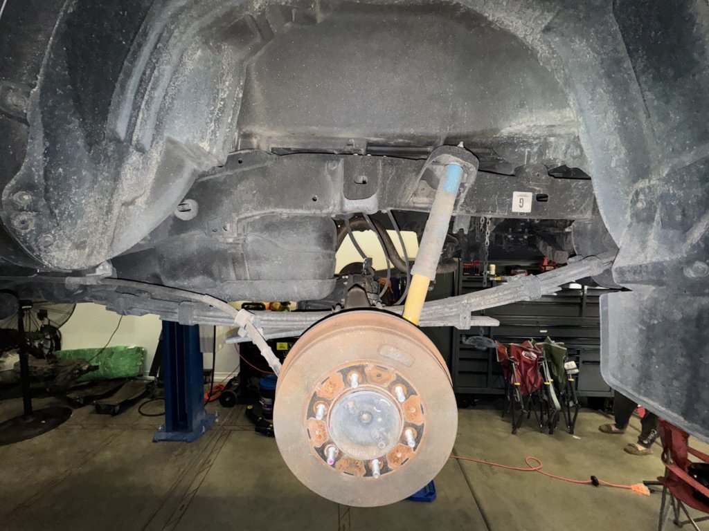

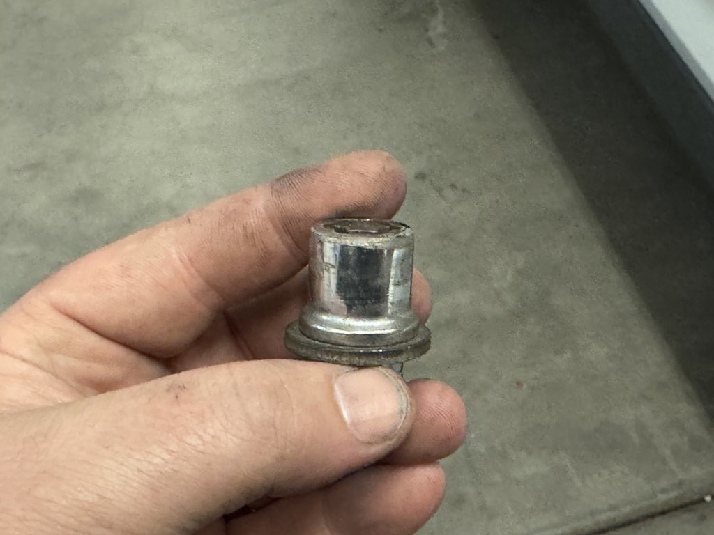

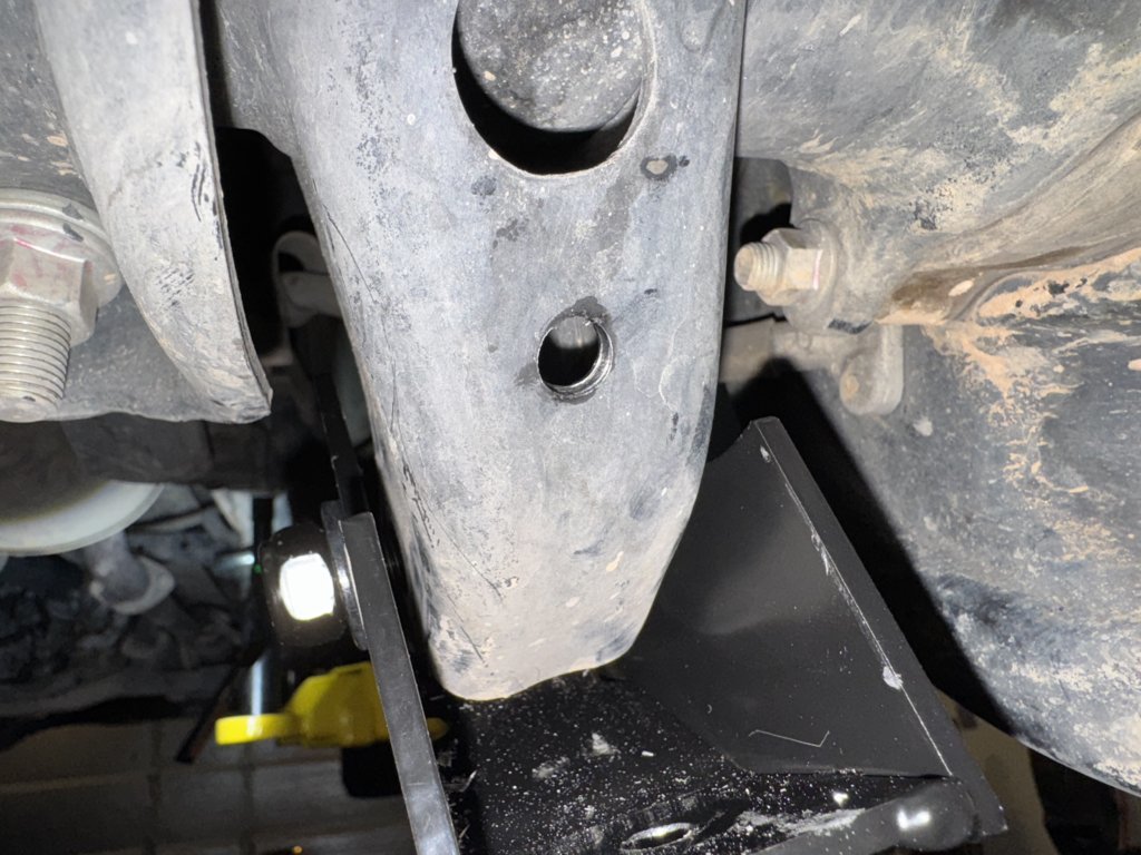

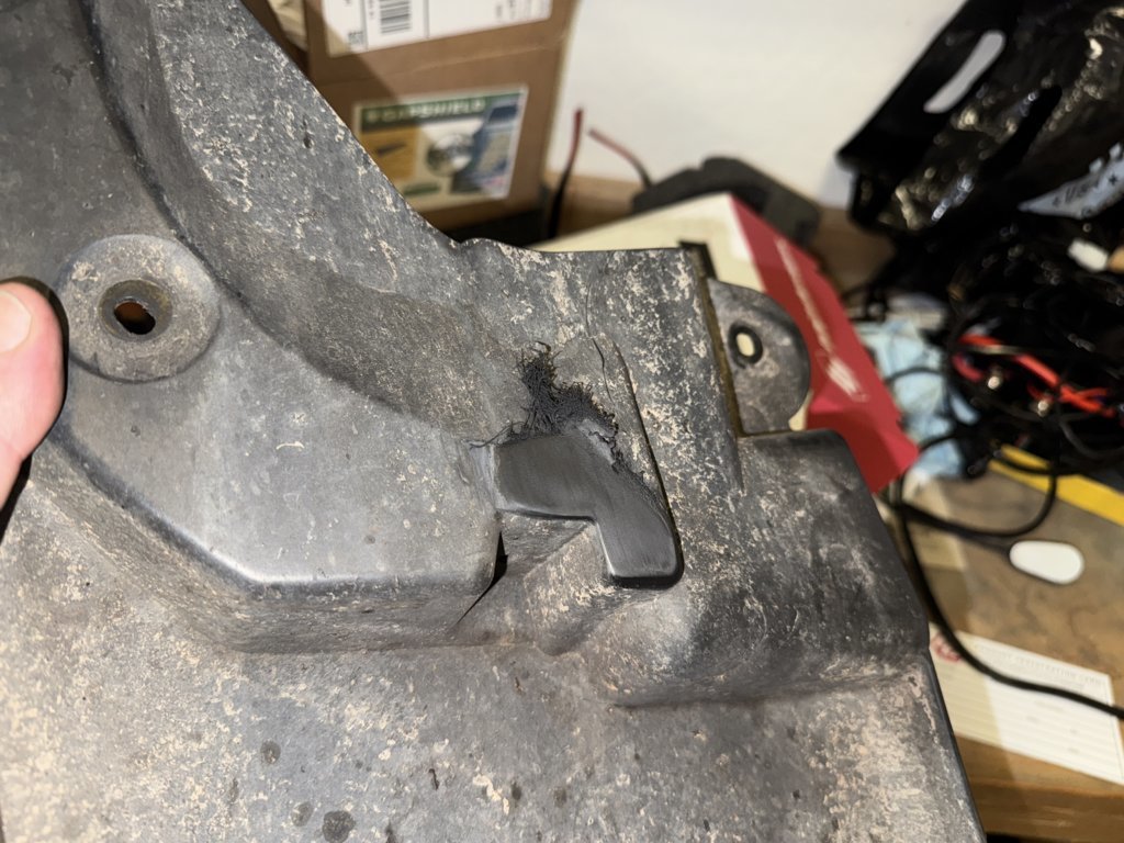

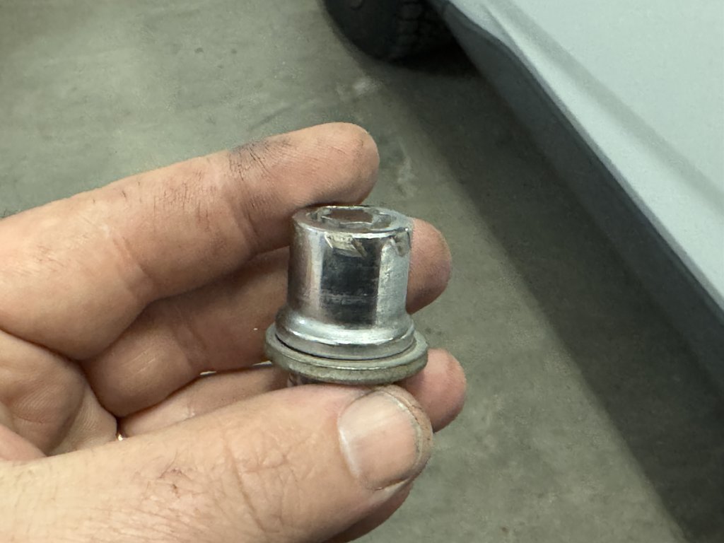

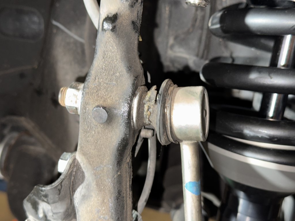

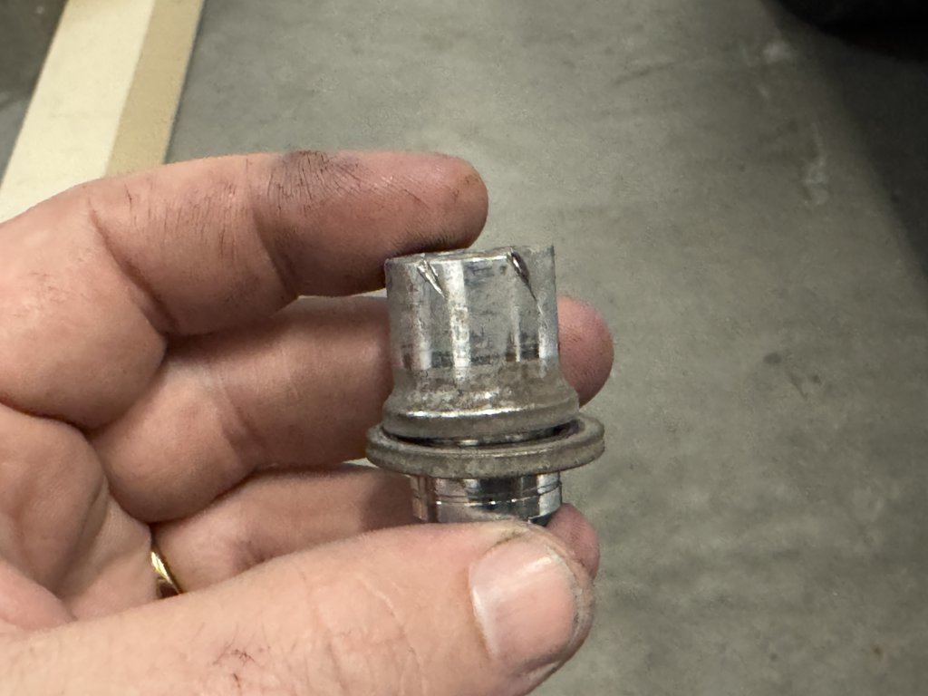

    Like all installs, we had some problems. In my opinion, other than rusted bolts that can't be busted without heat and air tools, this was the worst kind of problem. When I got new tires put on by Discount Tire about a year ago, they didn't give me my key for my locking lug nuts. While I can blame them, I really blame myself for not checking my truck the day of. Luckily, I didn't had any blowouts or flats in that time or I would've been screwed. Even more luckily, I was screwed trying to installing my lift until I got those lug nuts off! After overturning my freshly organized garage, I came to the conclusion that I was doubly screwed. Called around to Toyota dealerships in the Valley and was told that I could take the truck in and they could match it to a master kit. Instead of killing a few hours at a dealership, I decided to try my luck with a lug nut extraction tool. These are generally a last resort overkill kind of option, but in my opinion overkill is underrated and if you're gonna ugga dugga something, you might as well do it. One trip to Harbor Freight later and I was ready to give it a shot.
    To my surprise, the lug nut extractor worked. Even for a bottom of the barrel one time use tool from Harbor Freight, is worked exceptionally well!
    Until the very last lug nut.
    Clowned on by cheap tools again, I'm afraid. No matter how much we banged the adapter on with a sledgehammer, angled the tool, or hit it with the impact, the socket extractor was so worn out after three lug nuts that it was just rounding off lug nut. 525 ft lbs of break away "nut busting" torque on my Milwaukee impact just wasn't good enough in this case. That left me with one, dreadful option: the dealership. Thankfully, all I had to do was just take a lug nut. The next morning, I zipped over to Camelback Toyota and...they were unable to help me. They did not have a master set of keys for lug nuts. Strange to me, considering they sell vehicles with lug nut locks but whatever. Zipped even farther up to Bell Road Toyota and they did have a master set! The tech verified what key I'd need and sold me one for $23 and change. The tech told me that not every dealership will have a master set and that it was actually quite rare for them too. Didn't matter much to me because I had the most dangerous thing someone with a wrench in their hands could have: hope.
    Eh, I'm getting the timelines a little mixed up here.
    We popped the rear wheels and driver front off, but that passenger front stayed on until I was able to get that key. Instead of letting a bad time get in the way of a possibly worse time, we pushed on with installing what we could. Starting, as all good times do, with the rear.

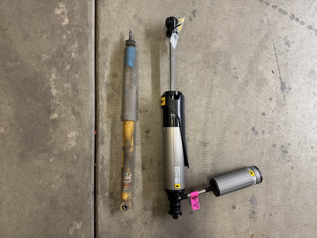

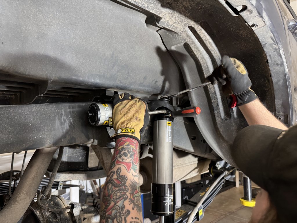

    Shock came out easily. Honestly, probably too easily. They had about 112,000 miles on them and based on the date code, they've never been changed. Worn in and soft, but fell apart nearly as soon as they came out.
    Bigger is better, right?

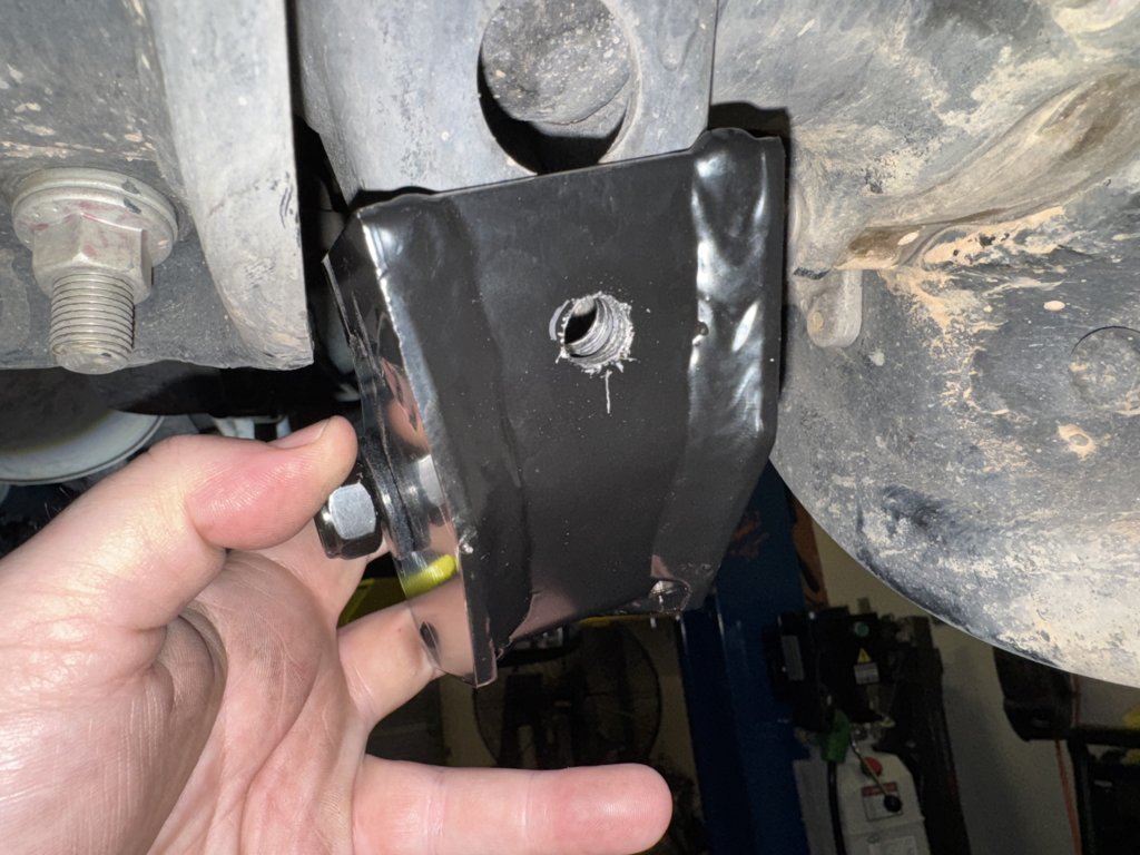

    Once that shock was out, it was time to install the shock bracket. Two bolts, a quick drill, and another bolt. Easy enough.
    After that, we took out the leaf springs. Honestly, it's just three bolts. I'm sure you, the dignified reader, don't want me to waste your time with that (I forgot to take photos. Sue me.).
    Once the leaf's were in, it was time to mount the shock.
    One thing I love about the BP51 is the protective cover that goes around the front of each shock. Another part to break? Sure. But a little forethought can go a long way.
    Mounting the reservoir was easy work.
    And fully installed. These things are beefy and look great. The drum brakes not so much, but that's a project for a different day.

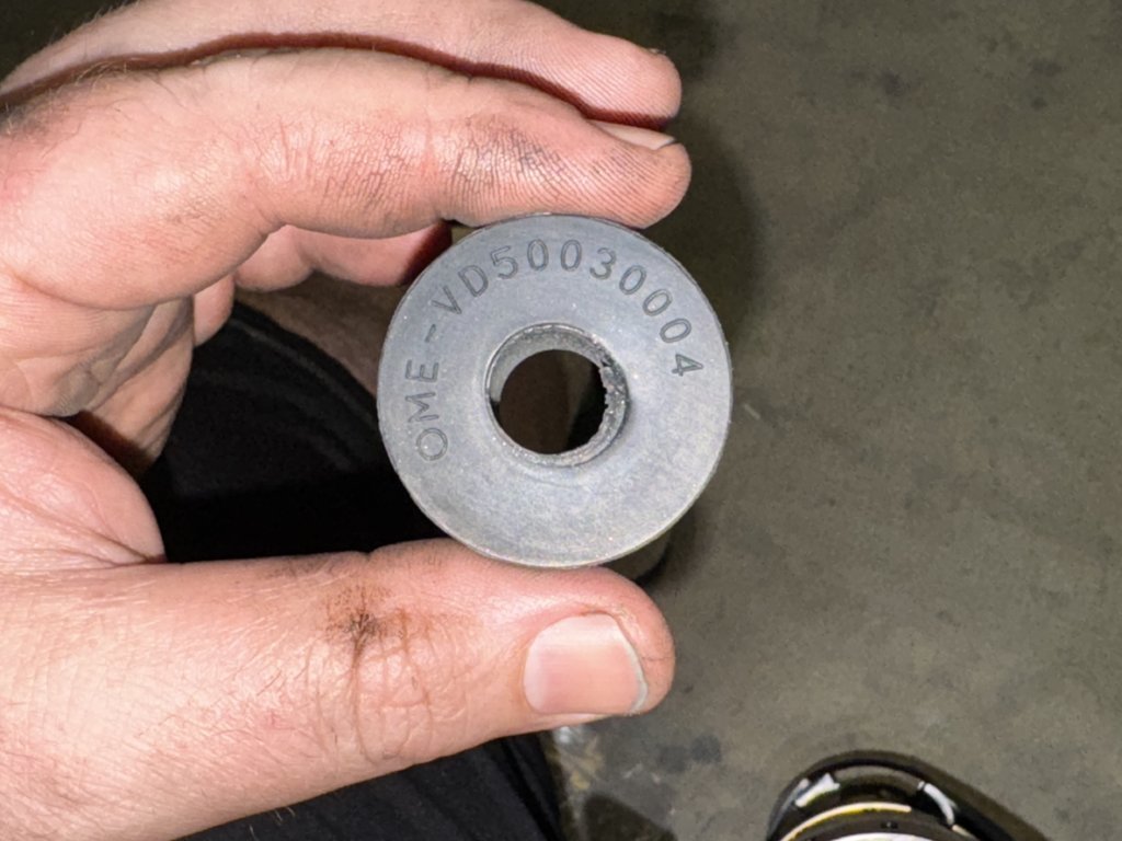

    Unfortunately, the lug nuts weren't the only problem. Old Man Emu gave me the wrong bushings for this specific shock. While I'm sure it would be fine, I reached out to ARB. They confirmed the issue and corrected it by sending out a new bushing set. It hasn't arrived yet, so I completed the install with incorrect bushing until I can get it corrected.
    With my RSI SmartCap and Decked drawer system, the added weight really flattened the factory leaf springs. It was extremely noticeable, at least to me.
    Factory vs. OME.
    Next was the front. Forgot to take a lot of photos, but I'll show y'all my screw ups.
    For example, my sway bar links have seen better days.

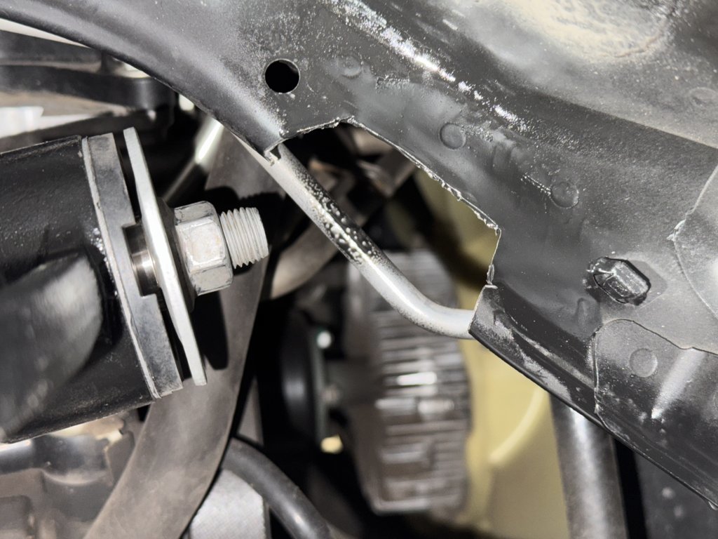

    And I had to cut out some of this non structural area around the UCA bolt. It took us forever to get the bolt out because we had to move it around some harnesses and this sheet metal. According to some install videos I watched, this sheet metal area was supposed to be easily bendable to help with the clearance. This was not the case for me. We ended up mangling it a bit before taking the rotary tool to it. Careful to not destroy the harnesses behind it, we were able to clear. Not my proudest work, but I can clean it up later during some other installs. For now, it's painted up with some Dupli-Color Rust Barrier.
    My roommate ended up cutting the passenger front side while I was out getting wheels balanced and buying furniture. He had the hindsite of a clean work surface to cut, so it looks at lot better. At least, that's what I keep telling myself.
    Other than that small hiccup, the front install came together really smoothly. Man, don't these things look good?

    I threw them in my wife's Rav4. I fit five 285/70R17 BF Goodrich KO3's with the seats folded down. She found it funny, but now her car smells like fresh tires.
    After buttoning up some things on the lift, we mounted the tired, set the truck on the ground, torqued down the items that required full vehicle weight (shock shackles, leaf springs) and rolled around the block for a test drive. I was careful as my camber was a little wonky but I went full lock to see if there was any rubbing.

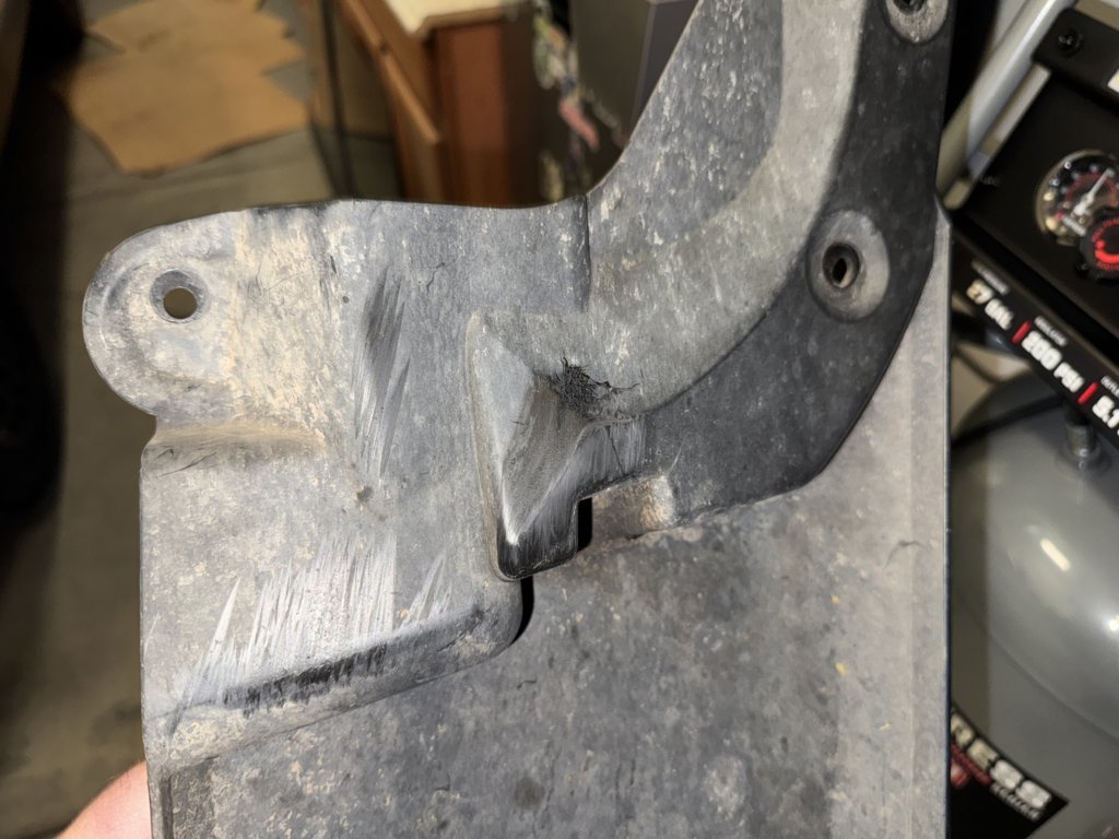

    Only rubbing I could hear and see was on the front mud flaps. Pulled them off, parked the truck, booked a tow truck and alignment appointment for next Monday, and cracked a beer.

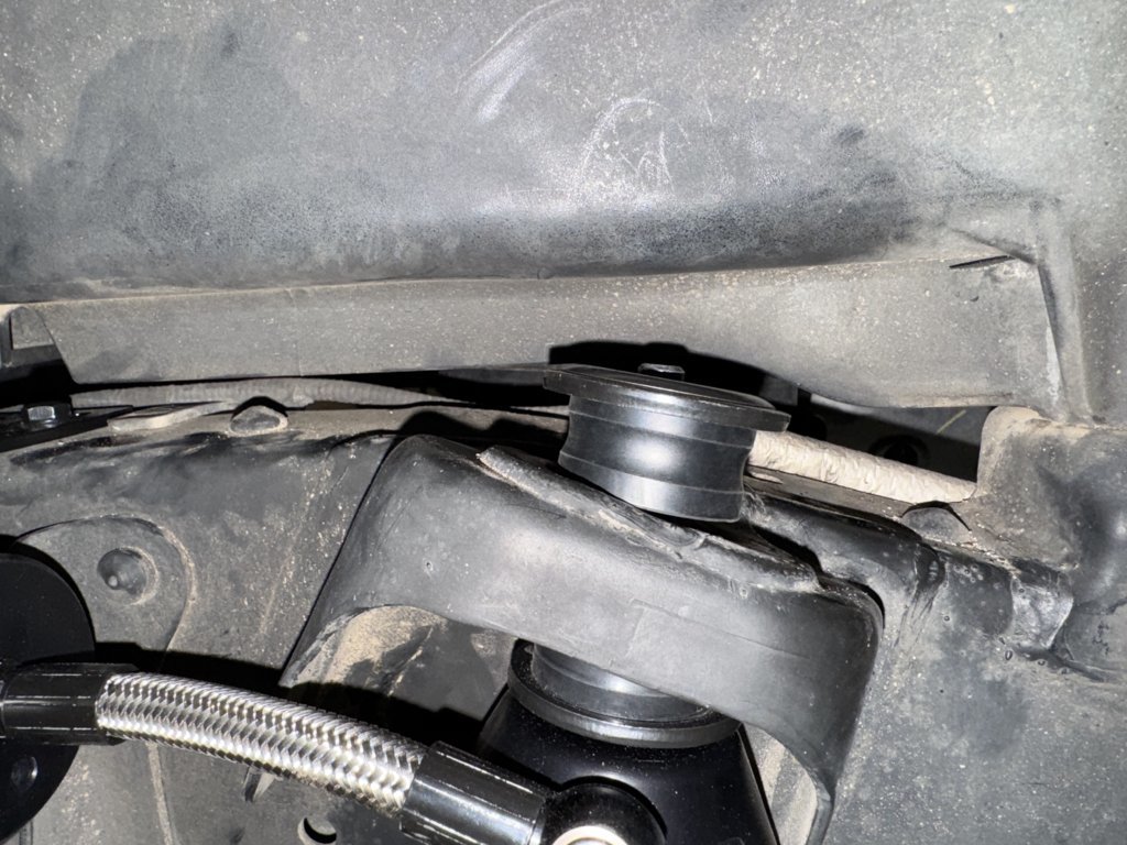

    On the last update, I had mentioned that OME/ARB had included the wrong set up for bushings on the rear shocks. After some further investigation between myself, my friend, and the ARB rep I talked to, it turns out that one shock was set up correctly, and one was set up incorrectly.
    The driver side shock was set up per this diagram. This diagram is dated 2024. Essentially, from what I can see and understand, this set up doesn't provide the correct stability for the shock in the the shock tower.
    Upon contacting ARB, they confirmed that the picture above is how it is supposed to installed. They sent me over a kit to get it installed correctly, and it looks much more secure in the tower than before. Now, that's all well and good, but the instructions in that photo are dated 2016. So the older information is correct and the newer information is incorrect? I may be a simple Jarhead, but my brain hurty from trying to unravel this mess. I understand that some things can get mixed up over the years, but I believe ARB should update and clarify this for their customers. Luckily, this truck is not my daily, but if it was I would've been screwed for about a week.
    Oh well. It's fixed. A bit annoying, but it's fixed and torque.
    Moving on...the SmartCap load bars.
    Alright, I didn't take photos of this install. They're load bars. It's a few bolts going into a few t-nuts. If anybody really needs to see that, I'll abide, but it feels a bit like a waste a time. Imagine, people! Imagine!

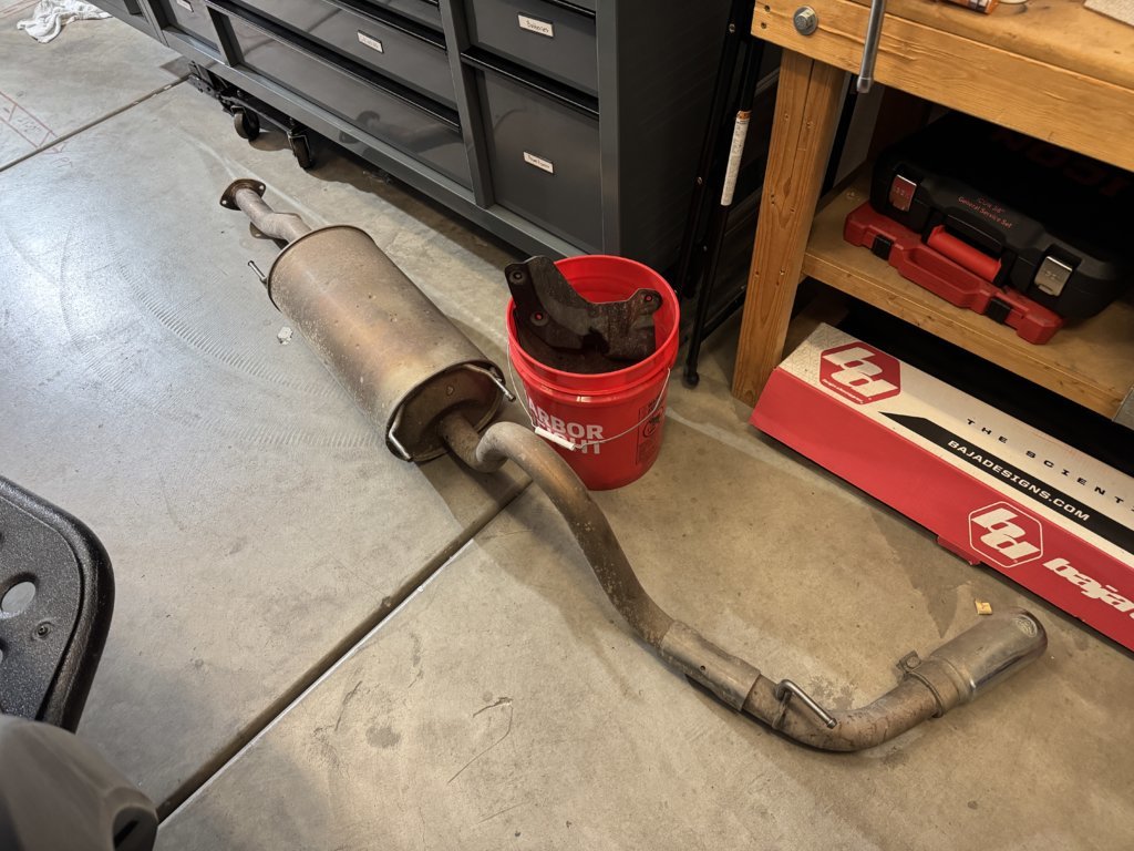

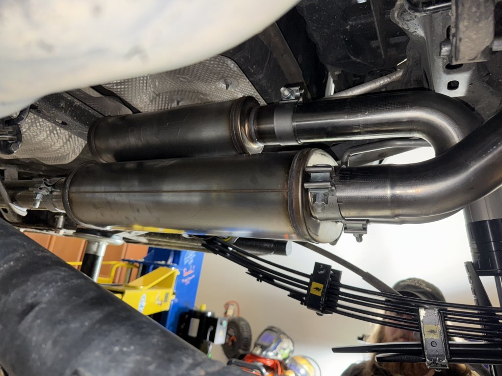

    Ah, Tacoma exhaust. Something that is totally serviceable from the factory and has no reason to be replaced...
    So I replaced the exhaust!

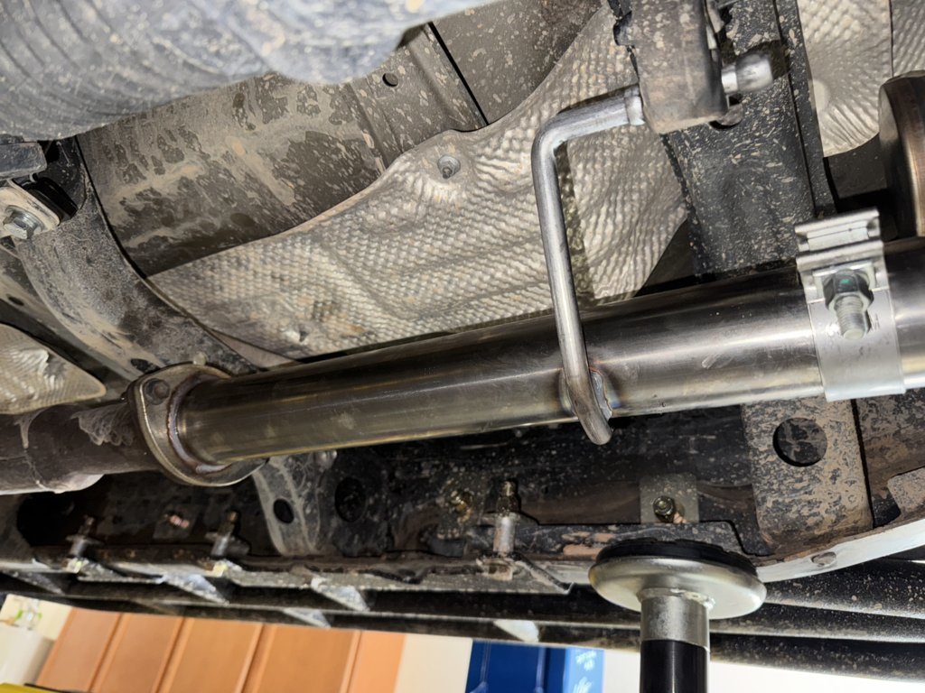

    The Magnaflow Overland Catback Exhaust is something I've been looking forward to for a while now. The factory muffler is quite large and the factory exhaust dump, while fine when it rolls off the lot, is a little dookie when it comes to 'Froadin'. Now, if I'm being totally honest, I bought it for a few reason. First and foremost, sound profile. There is no way to make a V6 sound like a V8 with a hog ass cam. Sorry to burst your bubble, but that's just how it is. However, the exhaust note of the 2GR is fairly pleasurable. Not the worst, but not the best. All I wanted was for it to be a little louder and a little more grumbly. The Magnaflow fit this need perfectly. The adjustability of configuring it with or without the resonator to pick between less drone or a more aggressive sound fit my needs just right. Secondly, the Magnaflow is a much lower profile than the factory exhaust. No way about it. The exhaust dumps in a location that I like better. Unlike it's competitors (mainly MBRP), the exhaust doesn't dump right onto the axle and the brake lines.
    On the last photo, you can see that the dump pipe is actually split just over the axle. Having the option to end the pipe just past the exhaust or just a bit farther is such a nice option. I hate being backed into a corner, so if I can have the option to change things based on different needs or scenarios, that's a plus for me.
    Sound wise, it's good. Not as loud as youtube videos might make it seem, but just loud enough for me to notice in the cab. No real drone past what you get with the factory configuration. Drone seems to bother some people, but it's never really been that noticeable to me unless I'm towing. Don't tow with this truck super often (seriously, maybe once every few years), so it's a shoulder shrug from me.

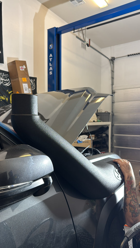

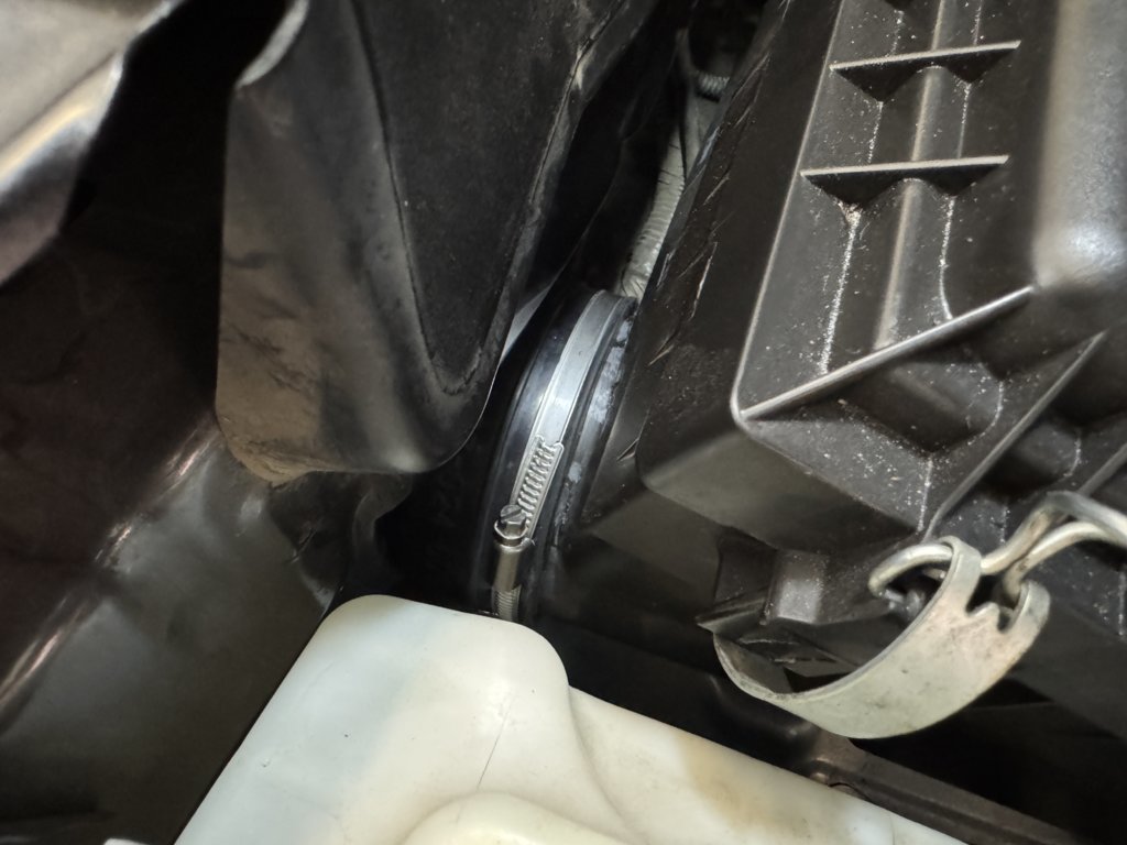

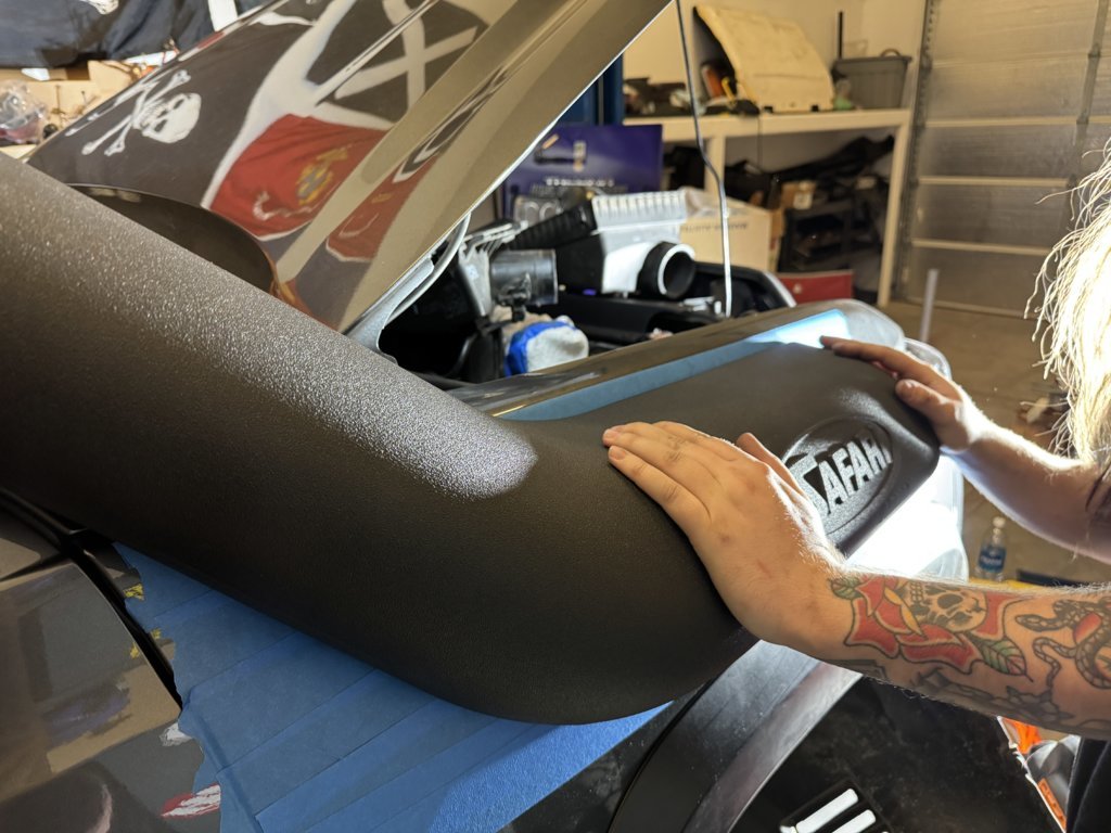

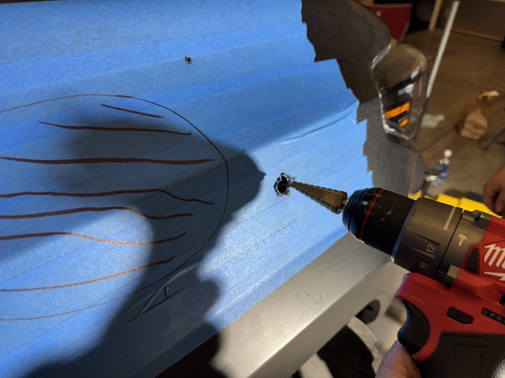

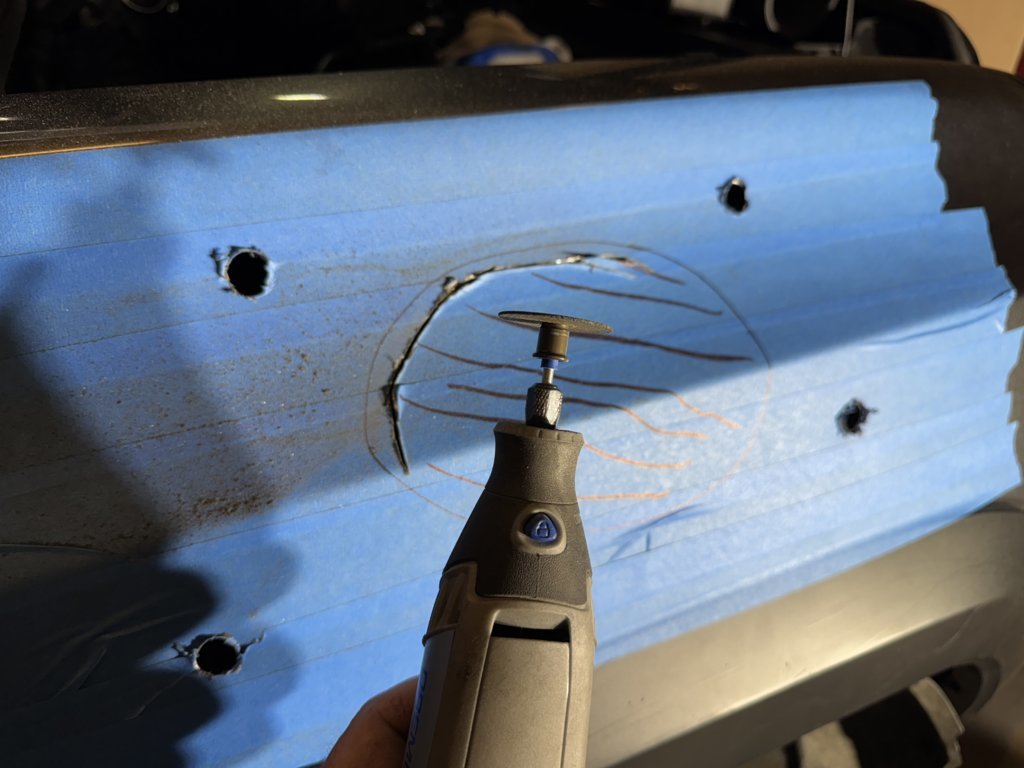

    Next up, a snorkel.
    Snorkels seem pretty contentious across all of the offroad community. Some people think it's necessary, some think it's a waste of money. Personally, I believe they're totally dependent on your needs. Now, during my time in the Marine Corps, I forded plenty of water in HMMWV's and 7Tons. Growing up with my dad being a mechanic in the Marine Corps, I'm pretty familiar what is required for fording water. A snorkel above the water line is absolutely required, but it goes much further than that. Military vehicles, like the HMMWV, are extremely barebones and are specifically set up for that task. Off the top of my head you need both your air intake and exhaust above the water line, breathers for your engine, differentials, transfer case, and transmission above the water line, your electronics need to be extremely water proof, and your gaskets for everything better be in good condition. On top of that, you need to know you weight dry, wet, and loaded. You need to know how deep you can ford water. A HMMWV without a fording kit can go into 2.5 feet of water. With a fording kit, it's 5 feet deep.
    Very few modern vehicles are capable of doing this, especially when you consider that electrical components like the ECU are not design to be water that deep. So that really begs the question...why the hell would I cut up my fender to add a snorkel for something my truck isn't design to do?

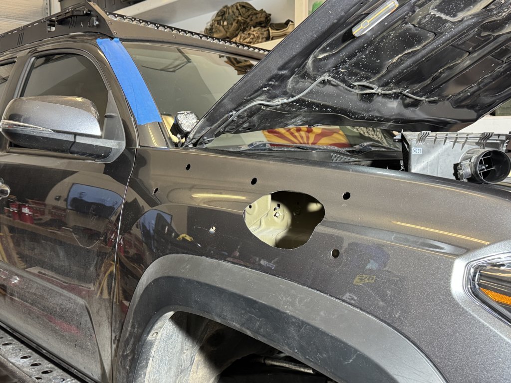

    For my needs, the snorkel is not specifically for fording water. With the addition of a pre-filter (still waiting for that to ship), it is primarily for getting cleaner and colder air in a dusty environment. Pulling that intake out of my inner fender and near my windshield accomplishes this task. Keeping that intake a little dryer if I do cross some water (which does happen for me from time to time. I was once up to the top of my 265/70r16's in a monsoon) is an added benefit.

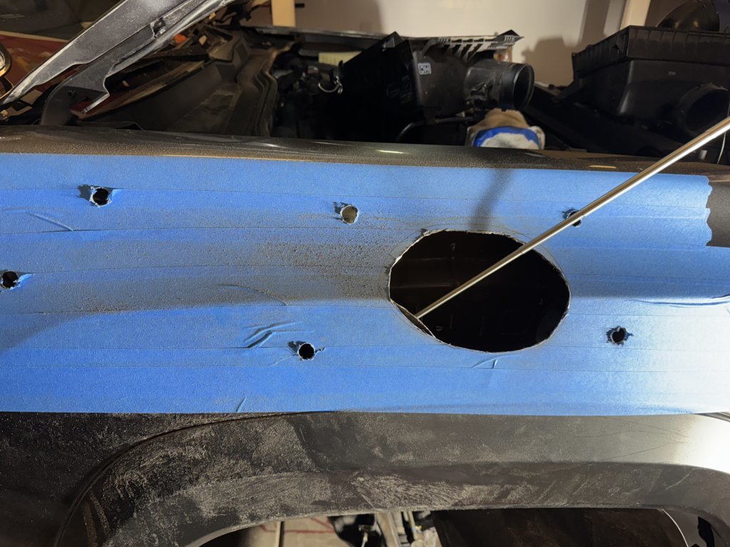

    Some people cringe at cutting into their truck. I didn't bat an eye. It's paid off with title in hand and if I'm seeking certain capabilities, there's no other way I can do it. "Nothin' to it but to do it!" as my buddy says.
    The cuts came out pretty well. Honestly, pulling the fender liner out was a bigger pain than marking and cutting. I used my rotary tool to get a rough shape for the intake and then used an pneumatic belt sander with a 60 grit belt to finish it up. Having the right tools helps!

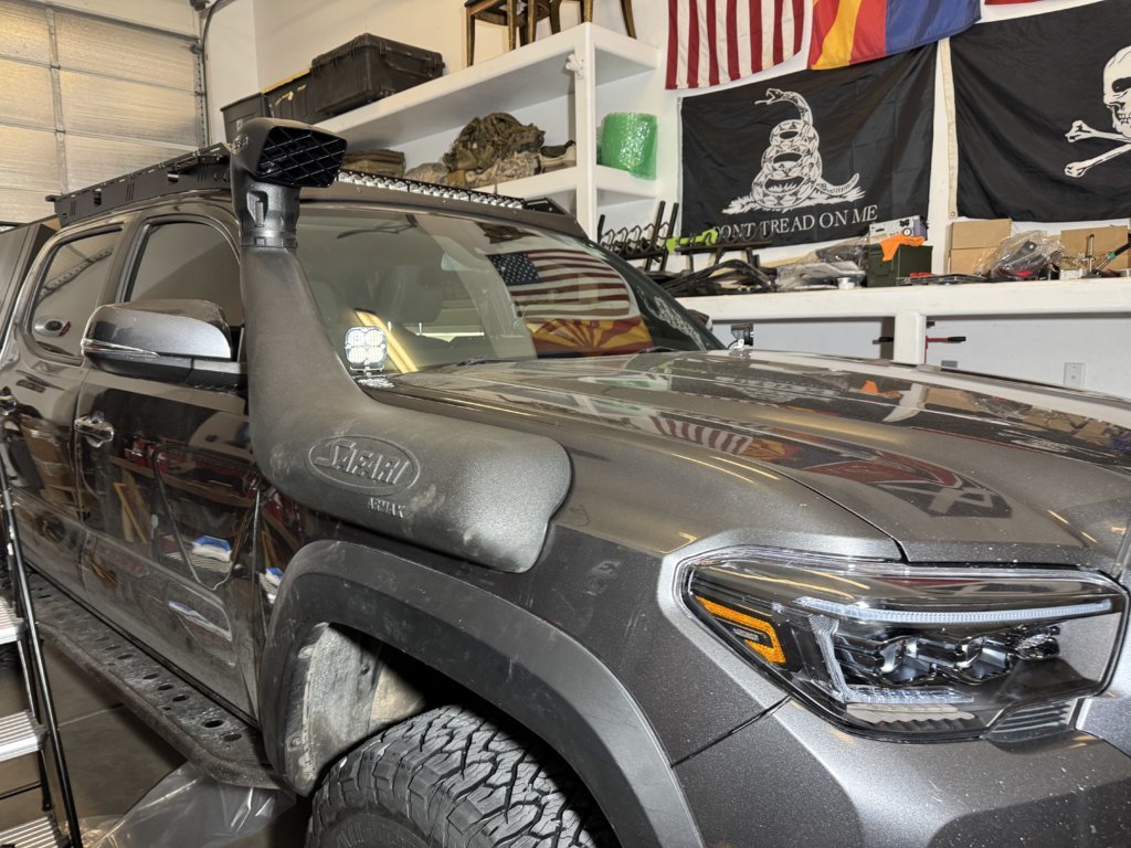

    Test fit it, drilled into the A pillar to secure the upper portion of the snorkel, tightened everything up and took a look.
    Good 'nuff for Government work!

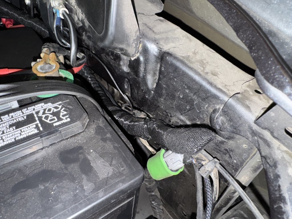

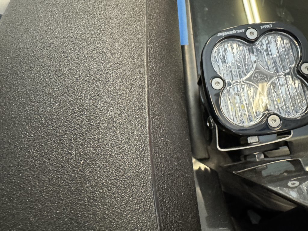

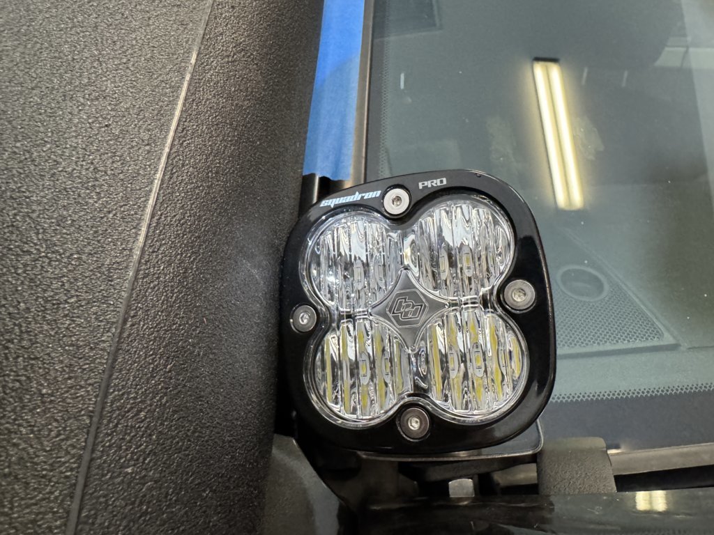

    One thing to mention is the clearance for the passenger side ditch light. I am running my Baja Squadron Pro's on Cali Raised LED mounts. Where I had the light set up for throw before the snorkel had it bumping into the light.
    Not a big deal. Simply adjust and don't worry.

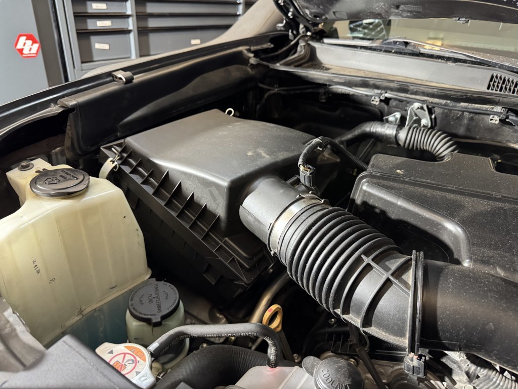

    Replaced the paper filter with a K&N Lifetime air filter and Lord help me, I got a race car!

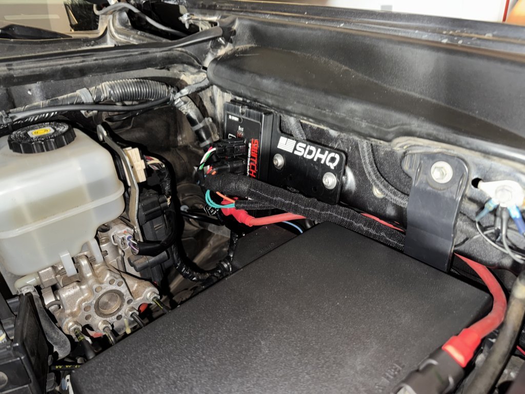

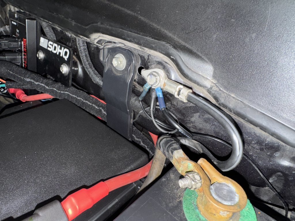

    In a previous post, I talked about my dissapointment with the Cali Raised LED light bar, light pods, and their knock off Auxbeam system. What I didn't post was that the day after I made that write up, I went online and ordered a Switch Pro 9100 Switch Panel system and a SDHQ mount. I totally spaced that SDHQ was local so while I was waiting on the mount to ship from them (and the Switch Pro 9100 to ship on Amazon), I went to their store and picked up new lights. I figured if I was gonna throw a fit about the piss poor performance, I should put my money where my mouth is. I ended up grabbing a pair of Baja Designs Squadron Pro's with the wide/cornering beam pattern and a Baja Designs OnX6+ 40 inch light bar with a driving/combo beam pattern.
    Mounted the pods and bar, did some testing with a quick wiring with the fake Auxbeam and was extremely happy. What I really wanted to do was rip that garbage set up out and throw that primo Switch Pro system in.
    As you can see, just not a very clean set up.

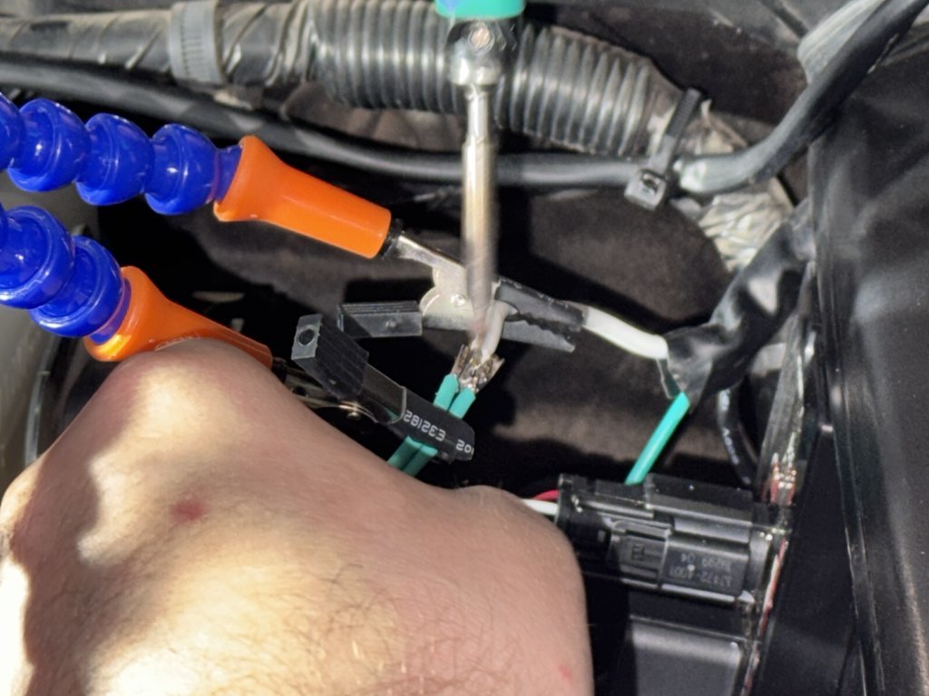

    So we ripped out that garbage and started mounting the SDHQ mount and Switch Pro.
    A bit annoying to solder two wires to one but once it's on, it's good.
    Given that I'm currently only using two of the available eight switches (much more to come!), I have a lot of left over wire coming out of the accessory plug. I wanted to tuck these wires away, but not leave them out to corrode or possibly create issues. Some wiring loom, loom tape, and some electrical tape later, it was tucked behind the battery.
    And that's it! A much cleaner look with full access to my fuse and relay box.
    I did also replaced my fuse box cover. I had made a few cuts to fit wire taps before and was just really not happy with it. Given that I am chasing a cleaner wiring look, a couple holes in my fuse box cover seemed like something that shouldn't be overlooked. We cut and shortened some of the wire taps, rerouted them to follow some factory wires into the box, and put the new cover on. Now it's just a bit more water proof than before and gives me the warm and fuzzies.
    Onto the next thing...

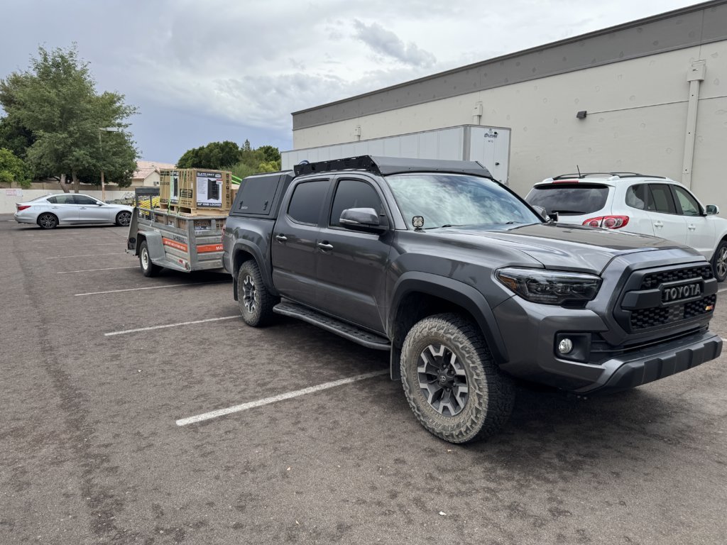

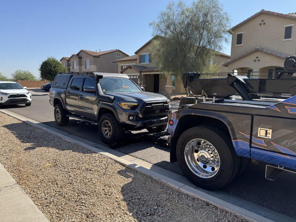

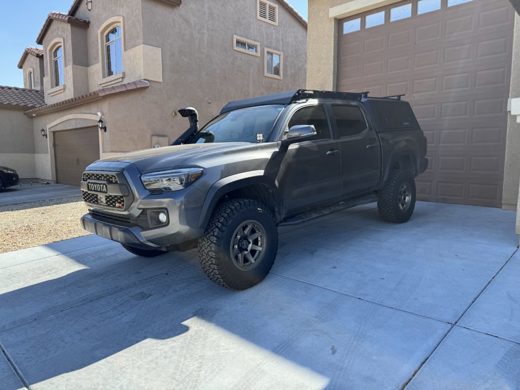

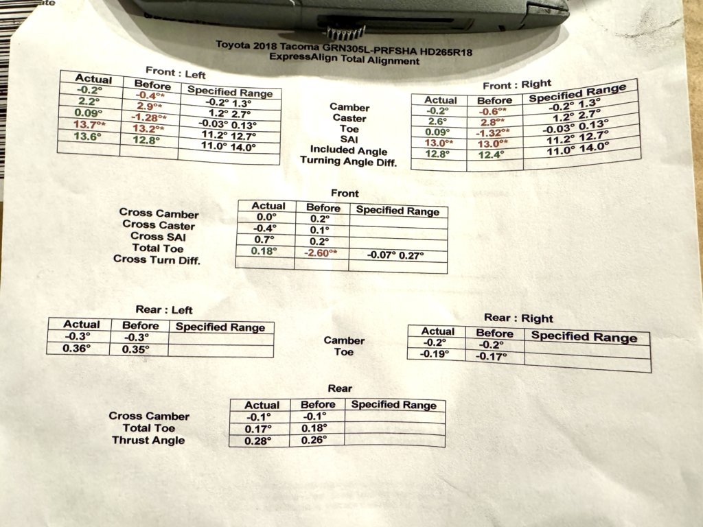

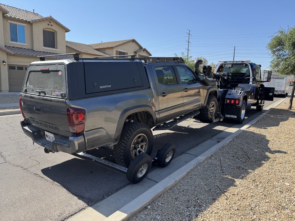

    Alignment!
    Now, some of you here (my roommate included), might think I'm stupid for towing my truck to get an alignment. I don't care. Doesn't matter how straight my tires look, I didn't really want to play around and hope it was good enough to go down the freeway at 65.
    Alright...it probably woulda been fine...
    But man, what a dream! This truck is great to drive! It's extreme rake looks a bit goofy (waiting to get my armor from DRT so I can adjust my front shocks and the leaf springs need to settle a bit), it does give me a little bit more visibility. The exhaust sounds great, the tires aren't loud, and all I can do is smile when I'm driving. Not to mention how many times I've had people compliment it. Really feeds the old ego! This past Tuesday, I went down to Copper State Tuning and got a OTT tune slapped on the truck. Not the night and day difference that some people say it is, but definitely worth the money.
    I know there are better trucks out there on the market. There are trucks, like the Ranger Raptor or the ZR2 Bison, that are better spec'd from the factory and would be a "better" choice. I don't care. The way these 3rd Gen Tacoma's look and feel when driving just scratches my brain in the right way. Even in a stock configuration, I loved just about everything on the truck. As I start bolting a bunch of crap on, I have had zero regret. Toyota was really cookin' with some gas when they designed these trucks.

    Enjoying the thread so far. Figured I'd mention those K&N lifetime filters have been known to cause issues with 3rd gen throttle bodies and MAFs tho.
