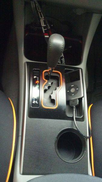

    Heres a pic i sent to TW awhile back but its my new center consul :D soooo much better than gray!!!!!

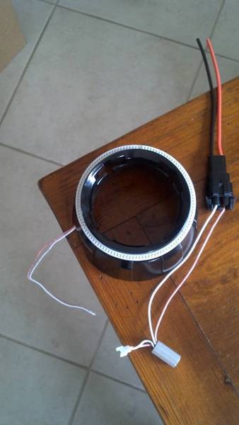

    MODS MODS MODS!!! okay actually some repairs and maitenance is what i mean, but for those that enjoy updates, heres whats upcomming for my sexy beast!
    Morimoto xB LED Angel Eyes from TRS!
    Theres alot in store in the next couple weeks since one of my ballasts stopped working and i need to replace the OEM headlight front lense since my wonderful lil FX-Rs melted them....:rolleyes: But since im pulling them apart why not add in a lil somethin extra and unique!!

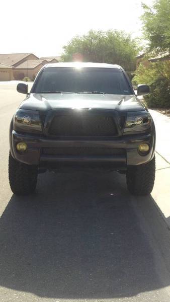

    Sick truck dude. How did you stain the fogs yellow? I have a black TRD Sport 4x4 and I am going the all black route as well but I love those yellow fogs.
  8. Jul 26, 2012 at 4:17 AM
    #188
    XPOTRON
    XPOTRON [OP] Is LIVE on the GRID.
    Feb 1, 2011
    #50358
    6,808
    Stefen
    Chandler, Arizona
    IG: @ST3F3NS
    DUROBUMPS Use TRON10 for 10% Off & Free Shipping
    Thanks bro! I used a Krylon Glass Stainer. I dont know if you have a Michael's where you live, but its like a arts and crafts type of store where I got it. It comes in a smaller sized spraypaint can. The yellow fogs definitely added a cool look and then i went further and got some hyper yellow fog light bulbs. Good luck and welcome to TW! Be prepared to spend a ton of $$$!!

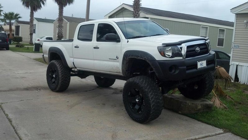

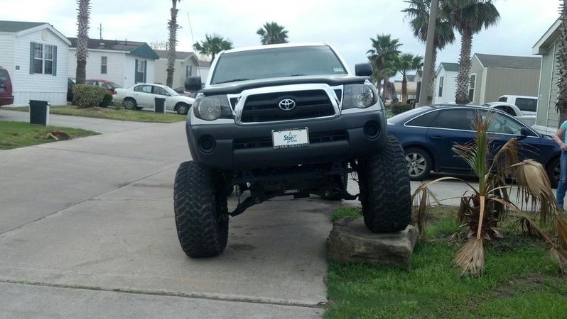

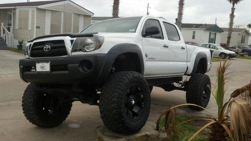

    1.5 inch spider track wheel spacers ebc rotors and ebc green stuff pads tundra racing brake disc conversion with disc ebrake 4.88 rear end gears with detroit locker true track toy tech add a leaf 4 inch blocks on the rear u bolt flip kit 6 inch fab tech lift fab tech drop down brackets 3 inch bilstein 5100 adjustable coilover lift bilstein 28 inch shocks in the rear old man emu 885 coils toytech strut spacer 1/2 inch on the driver side and 1/4 on the pass side to level out due to the gas tank weight total chaos upper control arms (custom specs just for my lift) performance accessories 3 inch body lift pro comp limit strap k&n intake throttle body spacer aftertmarket head lights and tail lights (forgot brand) borla cat back
    what are yall measuring from ?? ground to what ?? from the ground to the bottom of my side mirrors is 6 foot lol
    14inch lift on 38x15.5x20s 4.88gears 2wd prerunner :) :burnrubber:

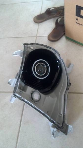

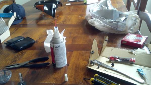

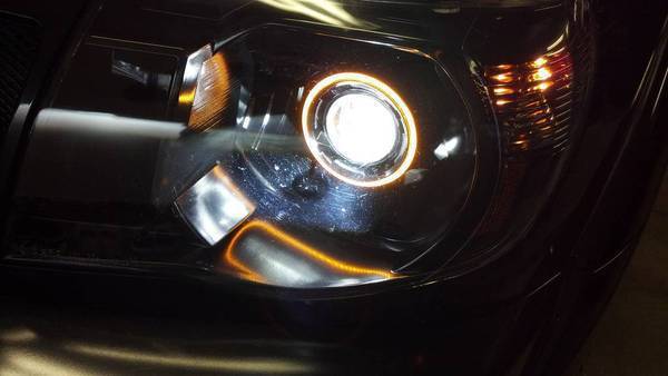

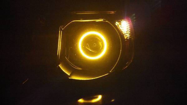

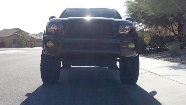

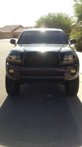

    Workstation....
    Just took apart retrofit, used some jb weld and mounted them righ to the gatling gun shroud
    Shroud back on, time for the oven and resealing....and this time i was not shy in using a $H!T LOAD of silicone and resealer
    Pic with them off....wish i had painted the actual ring black but oh well it still looks good :cool:
    clearly visible in daylight! these things are bright although the sun in the pic takes away from its true color
    Night pic with FX-R 5000K on
    These look more yellow in the pics but they are a true orange. hooked em into the clearance lights
    Hope you guys like! :D
