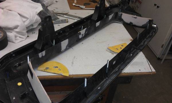

    I have the M4 (IIRC) and mounted using threaded studs epoxied to the inside of the inner lip. Just bought like a foot of threaded stock, then cut to length and used lock nuts. Haven't had an issue since I made it over a year ago.
