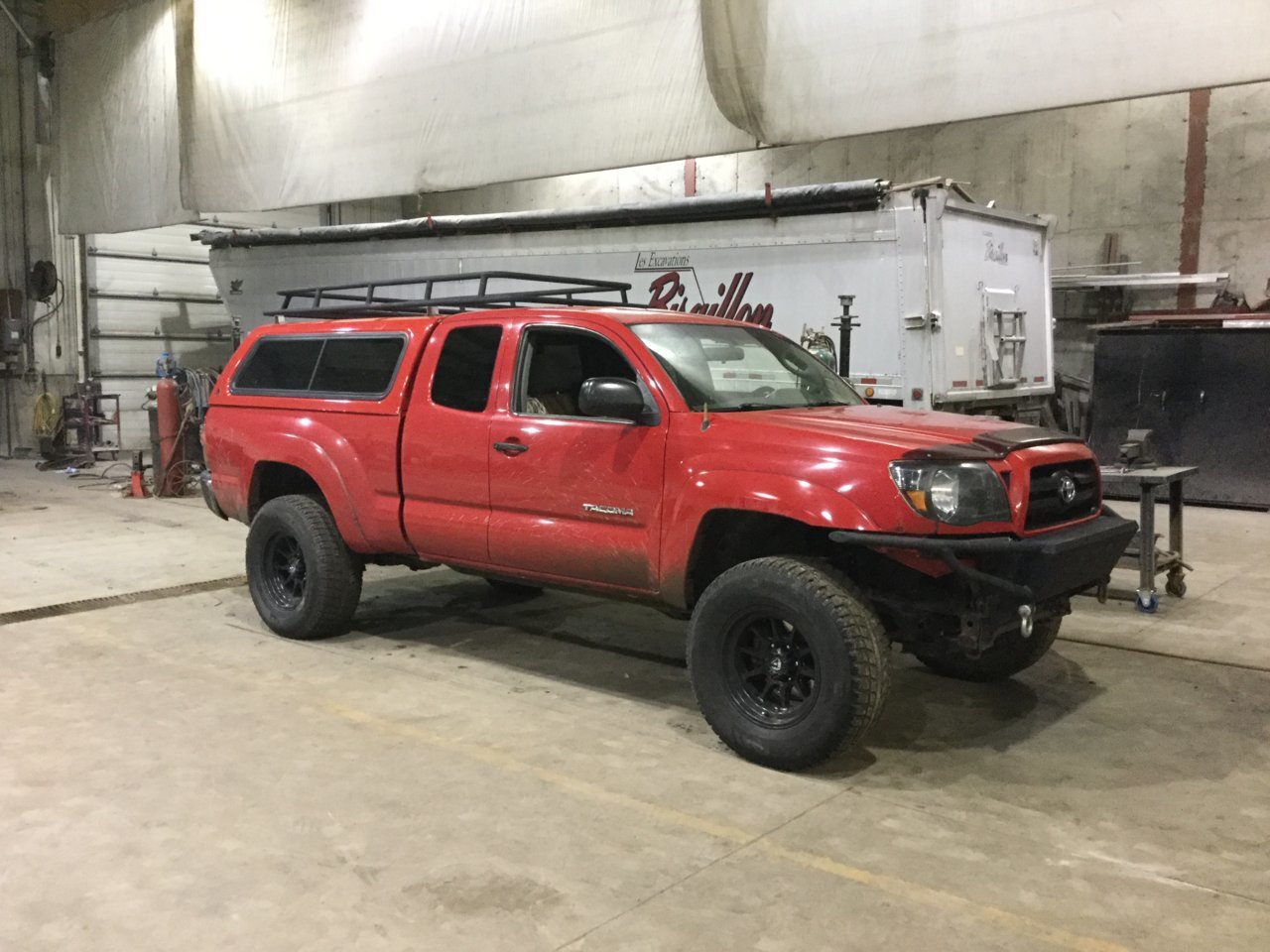

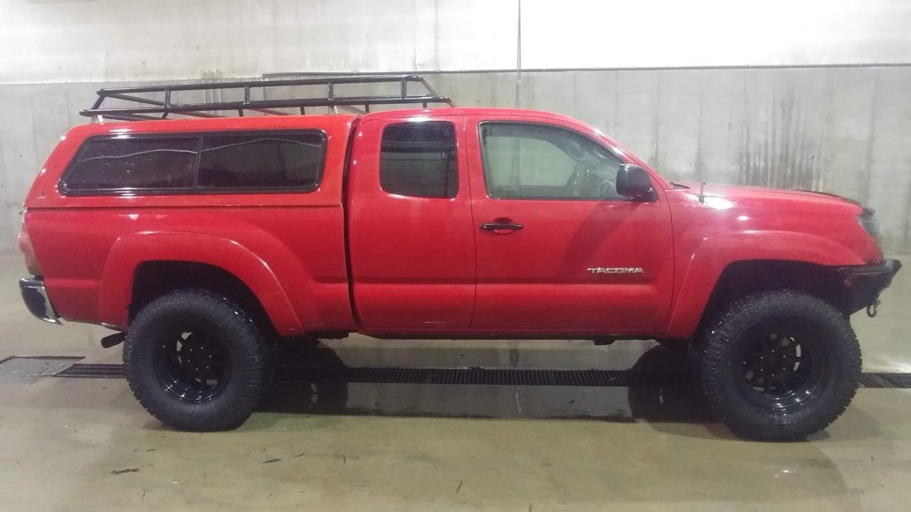

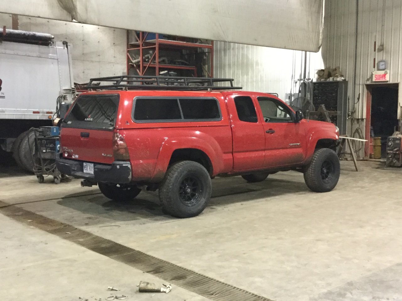

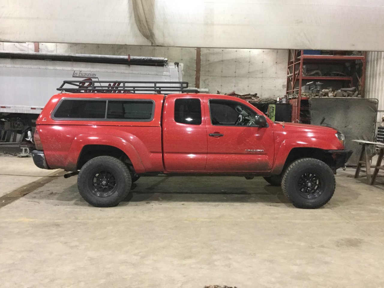

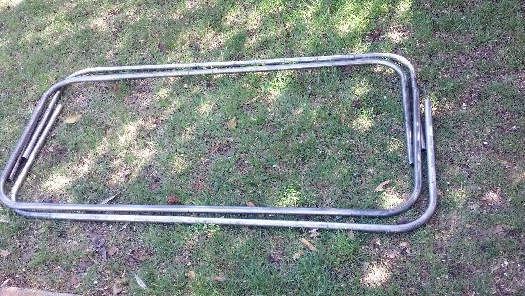

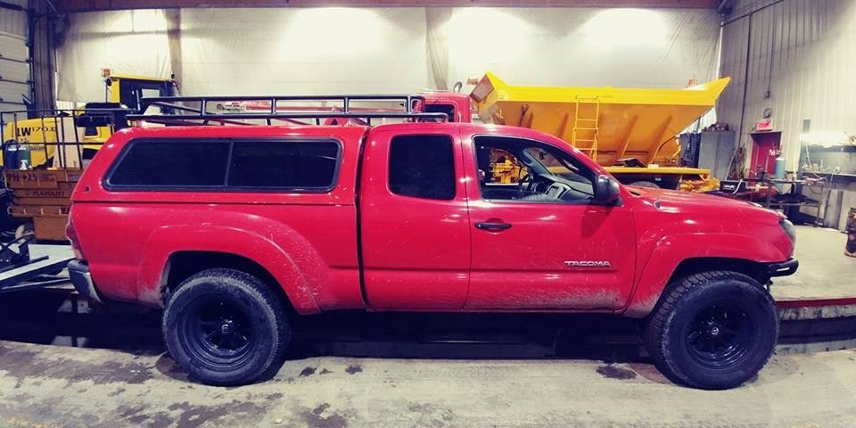

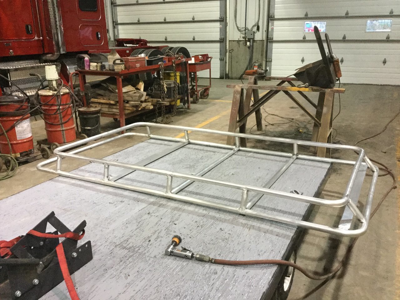

    There are not alot of roofrack options for access cab tacomas. So i decided to make my own out of aluminum. Mounting it to the tabs already fitted to my leer shell was the obvious choice, no drilling to thrue the cab’s roof. I decided to make it overhang over the cab a bit to gain some space and for looks also i think it blends in great with the truck.
    Got some lengh of aluminum 1 inch pipe ( 1 5/16 ” OD) bent and fired up the welder
    Got the basic shape i wanted
    Cleand, primed and painted it with bedliner then mounted it for some testing in every day situation, wind noise, It sits 3/4 ” from the top of the cab so will be flexin the truck in some local trails to make sure it doesnt hit the cab
    If I feel the rack is ok the way it is i’ll be finding the lights I want up there and build mounts, will also make tie downs gussets for cargo. Im planning on putting a 42 inch plano case, a 100 watt solar panel, axe/shovel and maxtraxx up there.

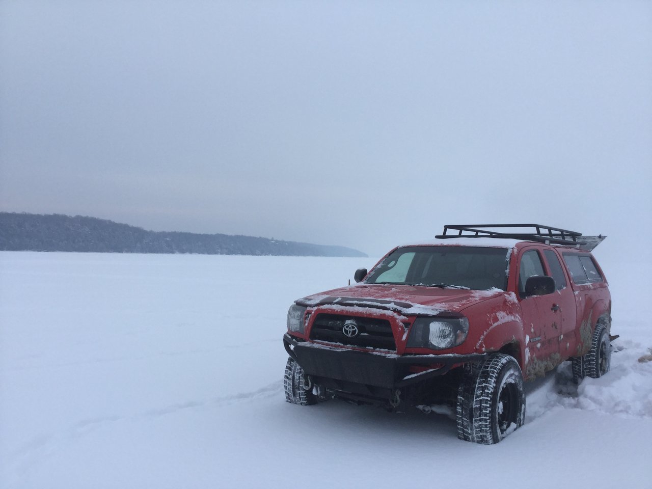

    Went to the lake last weekend, about a 8 inch of fresh powder on the ice, no trouble for the Tacoma. Cooked a nice breakfest and played freesbee with Blue then we drove all the way to the border between Canada and the USA on lake Champlin.

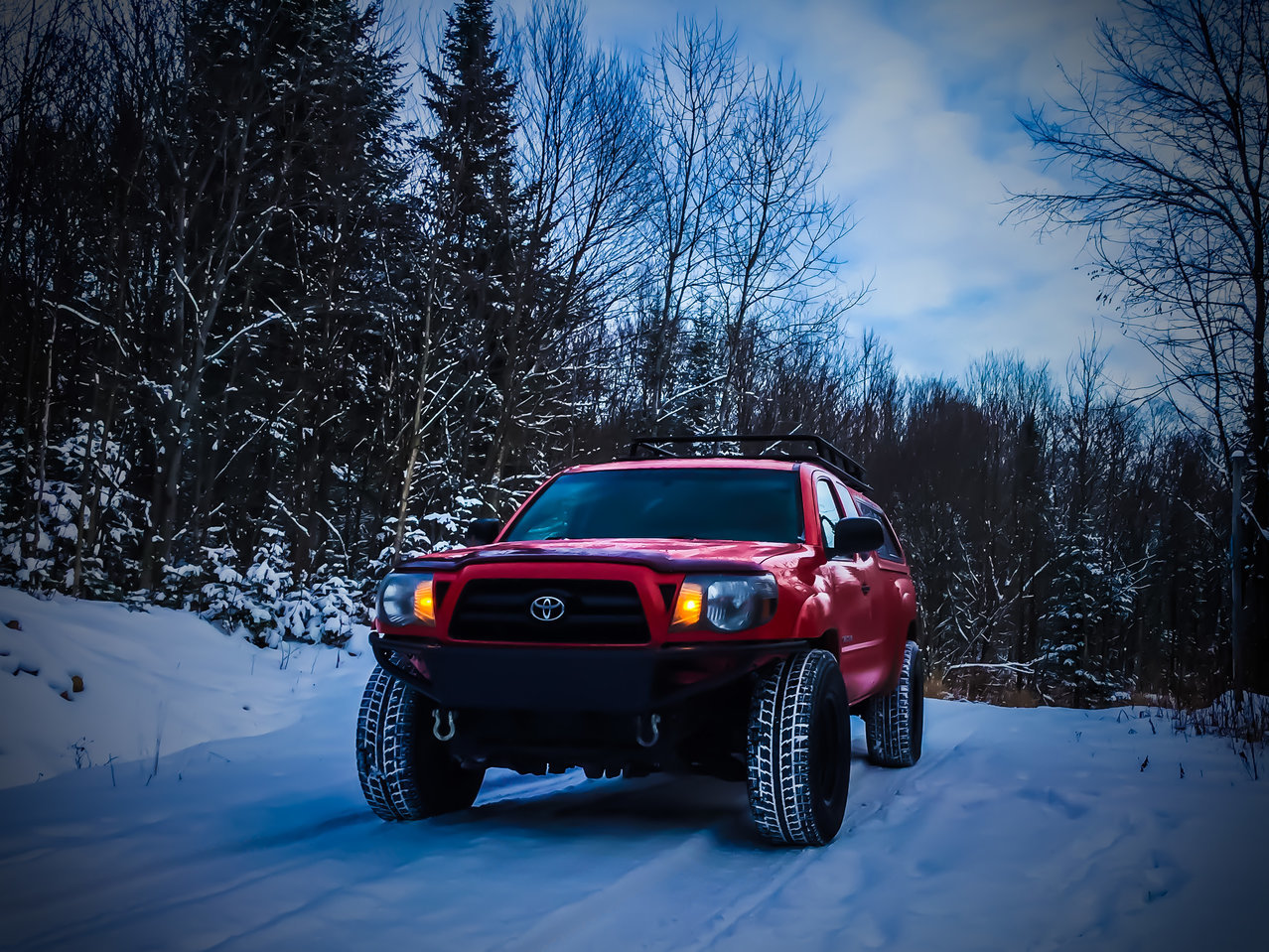

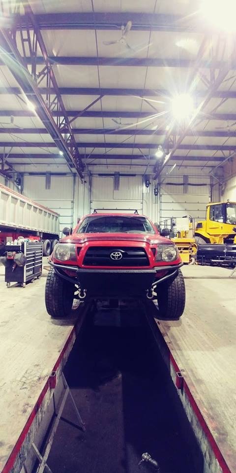

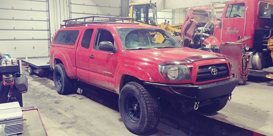

    Little update,

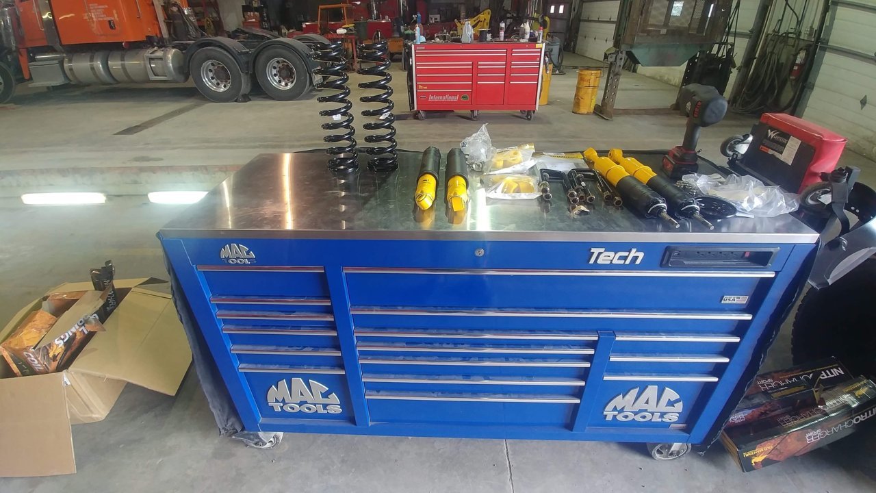

    After 7 years with the truck on 33s and no lift, 2 sets of broken rear leafs, 2 leacking shocks and really tired springs I finally pulled the triger on a OME suspension kit. Went with 886 coils and dakar leafs.
    Also upgraded the tires to 305/70/17 toyo open country at II.
    Install was very easy, took about 5 hours to install. So far im very pleased with the stance and ride comfort.
    This is before the new tires
    This is with the new toyos
    Hope to get some lights on the roof rack soon and currently shopping for an awning, might get the new batwing from rhino rack. Also trying to finish my sliders but work keeps getting in my way .
