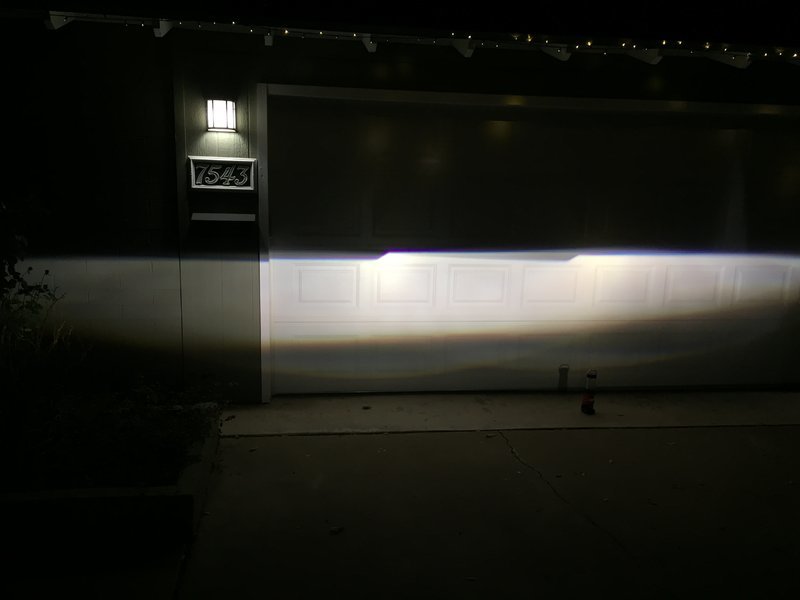

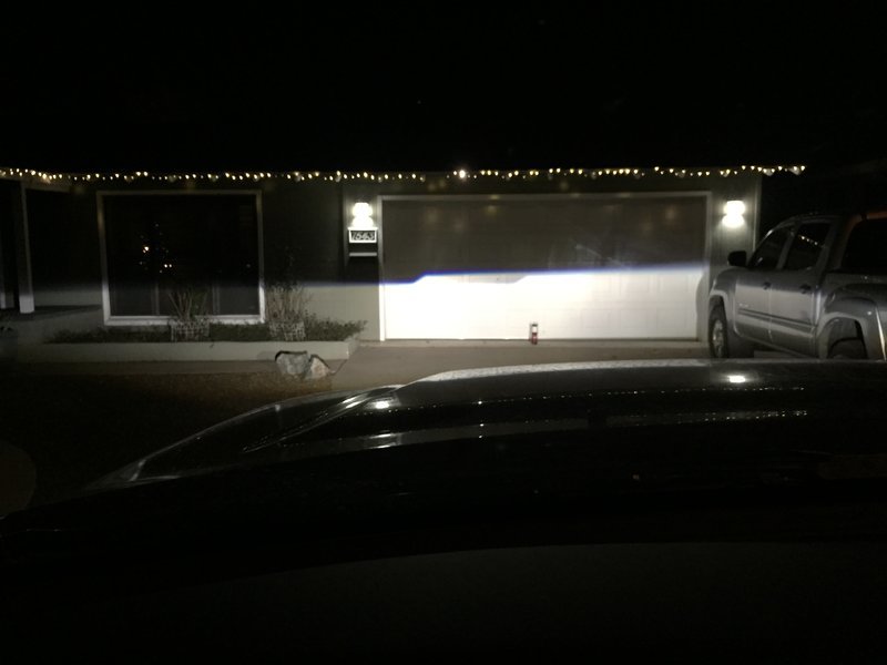

    So... I made some centric rings but I'm going to wait until TRS sends me the real ones just to be safe! I don't want to F it up and have to re-do it. I did test mount the projectors to do some aligning. The H4 adapter plate is way off and does not provide a horizontal line. I ended up dremeling out the tooth on the inside of the H4 plate/washer so I could adjust the line manually. Still have some alignment to do before final install but thought I'd share.
    ACME H1 Standard output shots .....

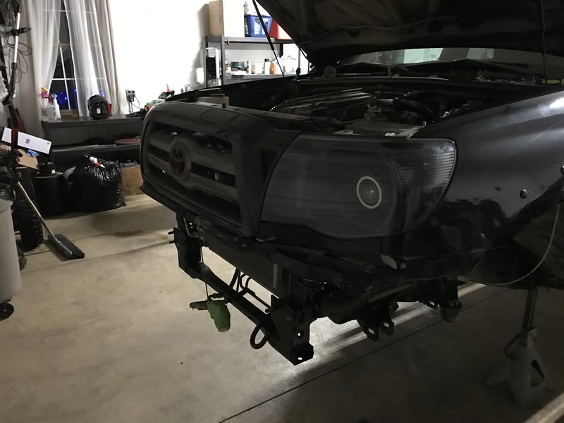

    Completed my retrofit a few days ago. I ended up using the 110 halos with the Apollo 3.0 and have no issues. I spoke with TRS multiple times regarding the appropriate sizing and apparently 100 and 110 are slightly off but will both work.
    From what I understand, it is now safe to run the new halos in amber as a DRL without risk of a burnout?
