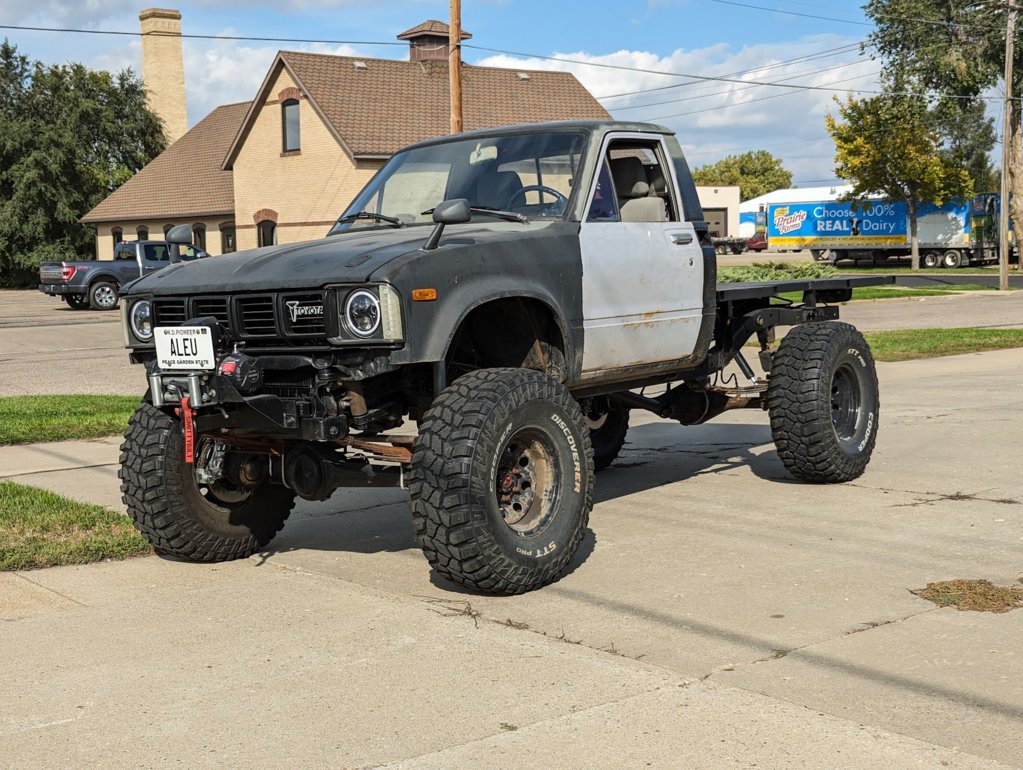

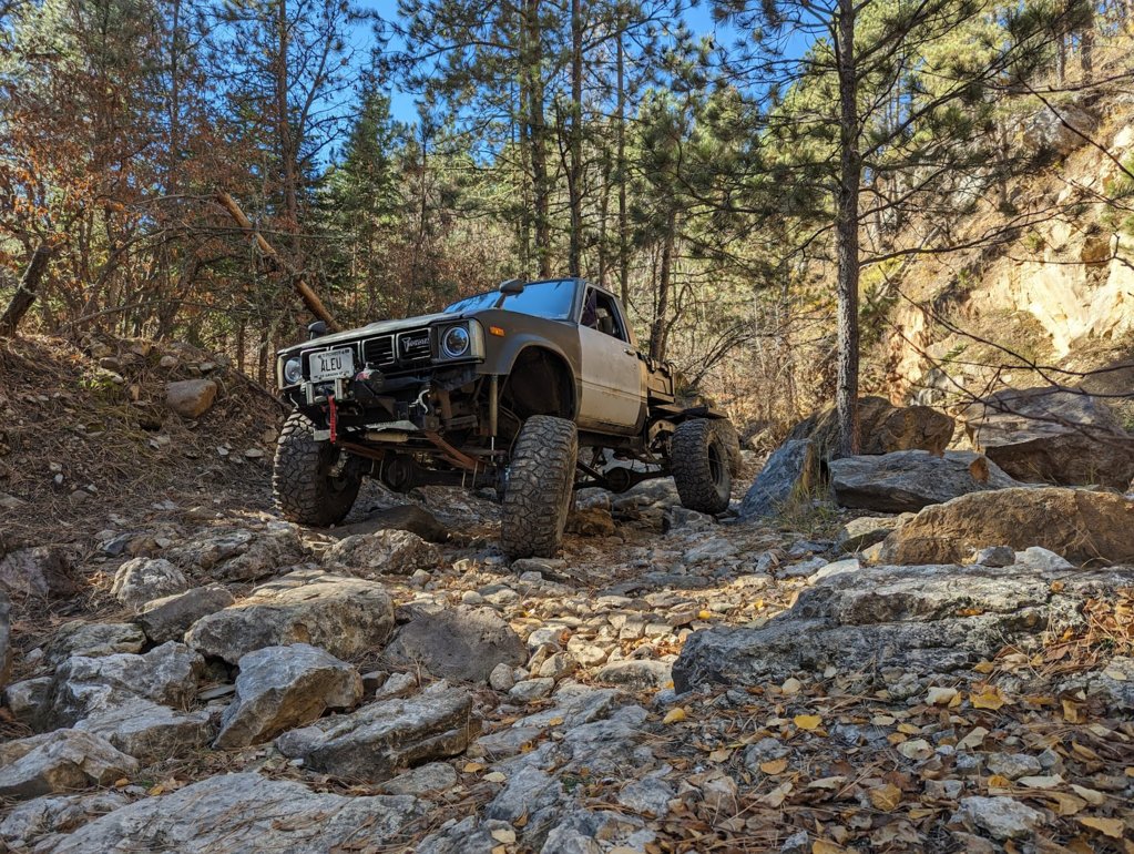

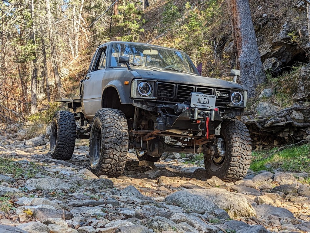

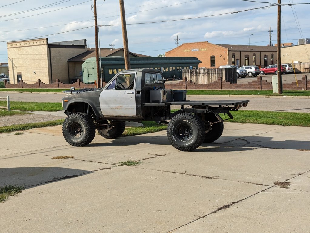

    How she sits now (2024)
    AP1GczNuBXqmgLIjB2Dr5Mvaawdi-36mzYOGJQnqK7hUczHYzs-G4P5O4fq4rww1699-h1279-s-no-gm.png
    AP1GczNcoJ-P0dv2Q5ex2uWuJUw-Wldoi8xMB2mqbzK4DlG86XSWxkgYrIlZTgw1699-h1279-s-no-gm.png
    AP1GczO5Biu98EygMX3usOPUdpicVmPD4BS2M1jCyezjjQlbgRie8fpHhcs22ww1699-h1279-s-no-gm.png
    AP1GczMZh6KBF1I3Ly78jrMa_KE6IxY2zjpZZ-m9ayCXwoSfzjIJVs2Wx7Cqcww1699-h1279-s-no-gm.png

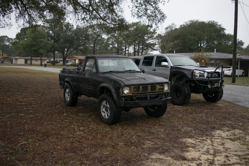

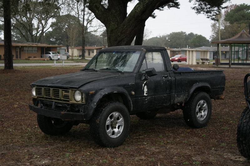

    How This All Began:
    Well, one of my buddies on an offroading facebook page for the local area said that they were looking at expanding, but a lot of the trails they run REQUIRE 4x4....so my prerunner was automatically out of the picture. Even though I am fairly good at wheeling my 2wd and have a winch (ive proved A LOT of people wrong, but Laylah cant go EVERYWHERE, and she doesnt even have gears and a locker yet). So I just randomly decided to check on Craigslist for cheap 4x4s and guess what....the first post I see....this 1980 pickup for $1,000, only been up for 45 minutes. So I REALLY thought hard about it and ended up bringing the truck home 4 days later
    November 13th I brought home my very own 1980 Toyota Pickup 4x4, I paid $1,000 for her, I am so happy I did not pass this opportunity up for a 3rd time. Even though the truck is in a semi state of distress, it is in pretty ok condition. The frame seems pretty good and that 20r motor is running like a charm. I have a lot planned for this truck to get it back up and running to be street legal and give it a better life than she previously had with her previous owner that used her as just a woods truck and nothing else really. I want to get this thing back up and running and eventually turn it into a crawler at some point....which is so far down the road im not even thinking about it right now lol.
    Im excited to get this build started, I havent been this excited about anything in a long time and im looking forward to working on this truck and slowly bringing her back to life. and just to add, that I am very inexperienced with a lot of things, so I'll be learning as I go!
    Previous Specs:
    - 1980 Pickup
    - 2.2L 20r Motor
    - Manual Transmission (L43 currently, G52/G54 to be installed)
    - 4x4 Solid Axle
    - mostly bald and cracking 33x15.50r15 Super Swampers on 15x10 steelies
    The only major thing wrong with the truck was that the trans can't find reverse and just grinds, so the trucks price came with an either G52 or G54 transmission to swap in, but some modifications are going to need to be made to the driveshaft to get it to fit
    the night I brought her home, the taco towed her very nicely, was my first time towing anything this big, not bad at all!

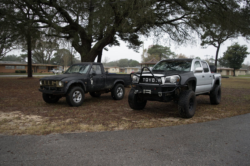

    since we found out about the trans and we weren't able to bolt it up today, decided to rip the seats out and start cleaning up the mess the previous owner had in it and all the jerry rigged wiring that just looked like a hazard waiting to happen. The floor boards aren't in the best condition either from rust, so Ill have to figure out some way to patch up the holes and throw in some bucket seats. So much junk lol
    Plans as of right now:
    - shifter for the new trans
    - modification to the driveshaft to fit the trans
    - new wiring harness to start from scratch
    - mount my old 265 nittos on my TRD OR wheels to replace the crappy super swampers that are on now
