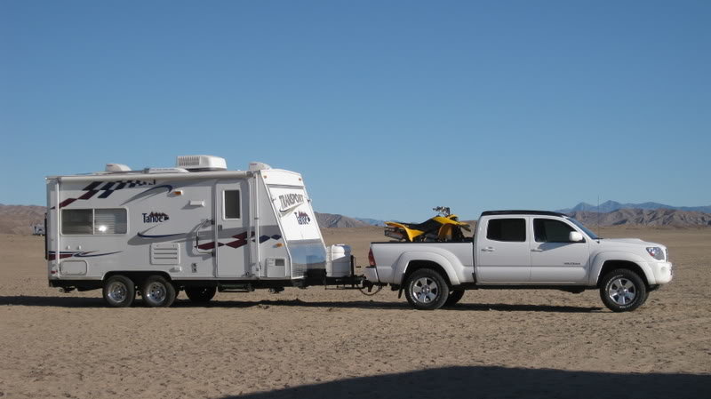

    Like others said, you will be no speed demon, and you will have horrible gas mileage. I got 170 miles per one tank. Hills are 3-4, and 4th on flats. 5th gear is useless. I found that going up a large long grade, as long as you kept the engine at 3500 to 3800 while in third, you can go 50-55. The truck seems happy there.
    I towed this last weekend, to Dumont Dunes. Its about 225 miles from my house. On the way up to Dumont, I did get 7.5 mpg, and 10mpg comming home. It was windy when i was going there.
    My GVCWR (truck and trailer loaded) was 10500. The max is 11100. I had it weighed at the dump locally. I normally dont bring the second quad with me though.

    What's the length of that trailer?

    its 18ft.
    I used to tow it with a 4runner, but it was not stable.
