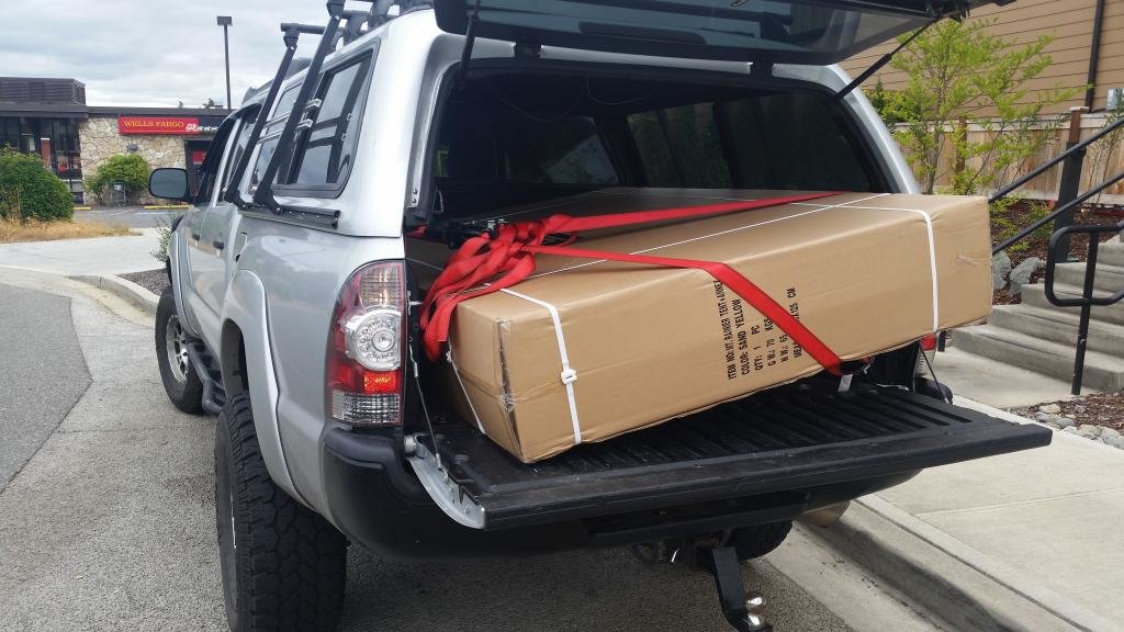

    I just joined the club. I am now the proud owner of a CVT Mt. Rainier.
    I bought mine through venture-pod.com. Great guy to work with and got it two days after the ship landed.

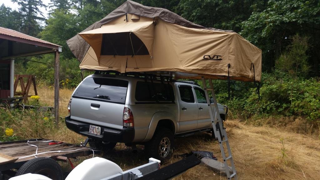

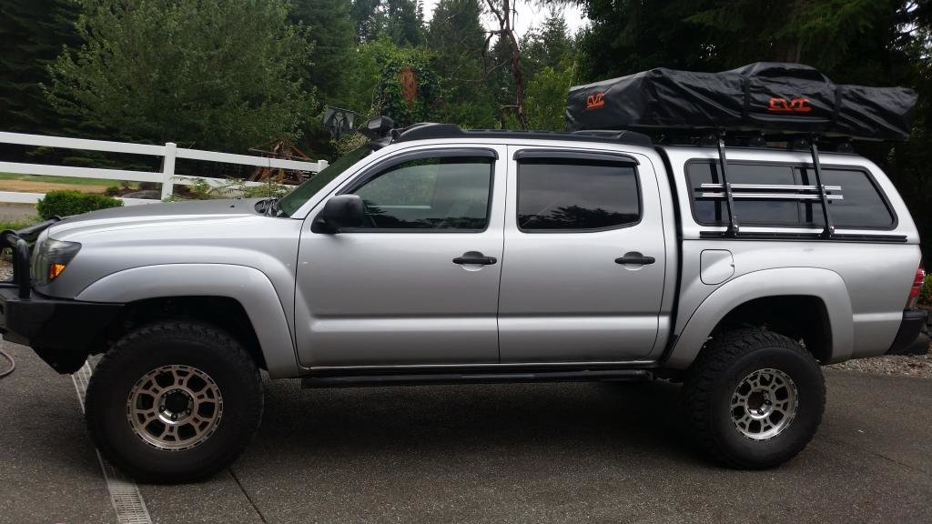

    I picked up a CVT Mt. Rainier this morning. Here it is:

    looks good! congrats

    :woot: very nice. what rack system is that? don't think I've seen that one before...

    Thanks guys. I am lookong forward to using it next weekend.
    The rack is a modified yakima control tower set. There are 4 bars to distribute the weight. The side bars I am building to hold rotopax tanks, shovel, etc.

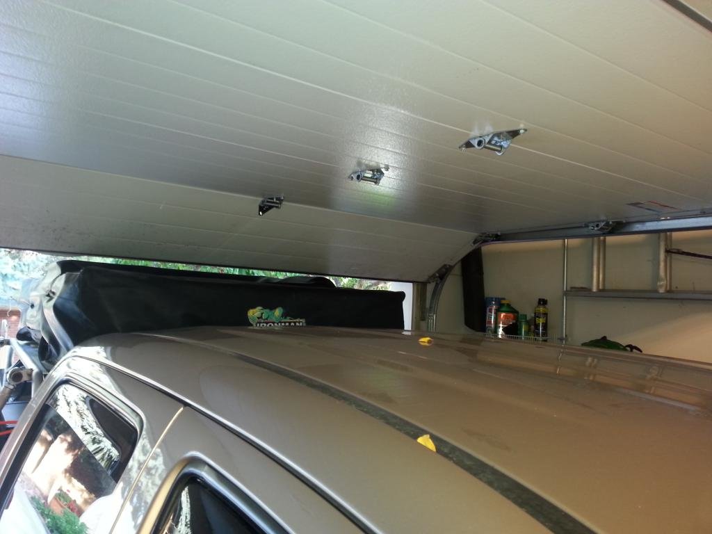

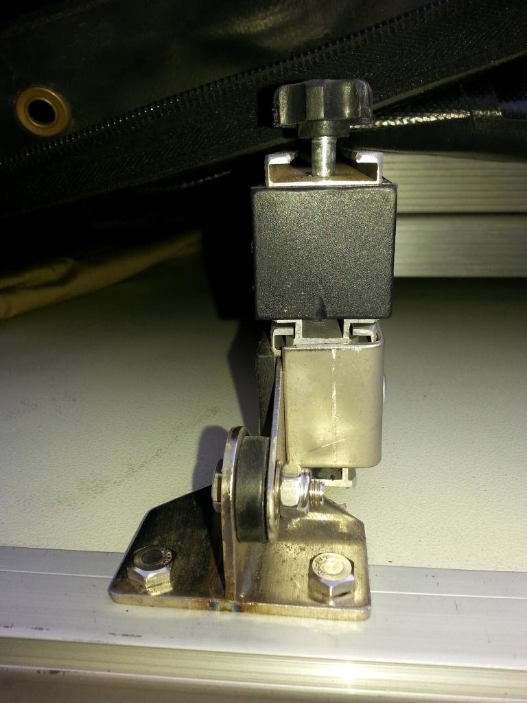

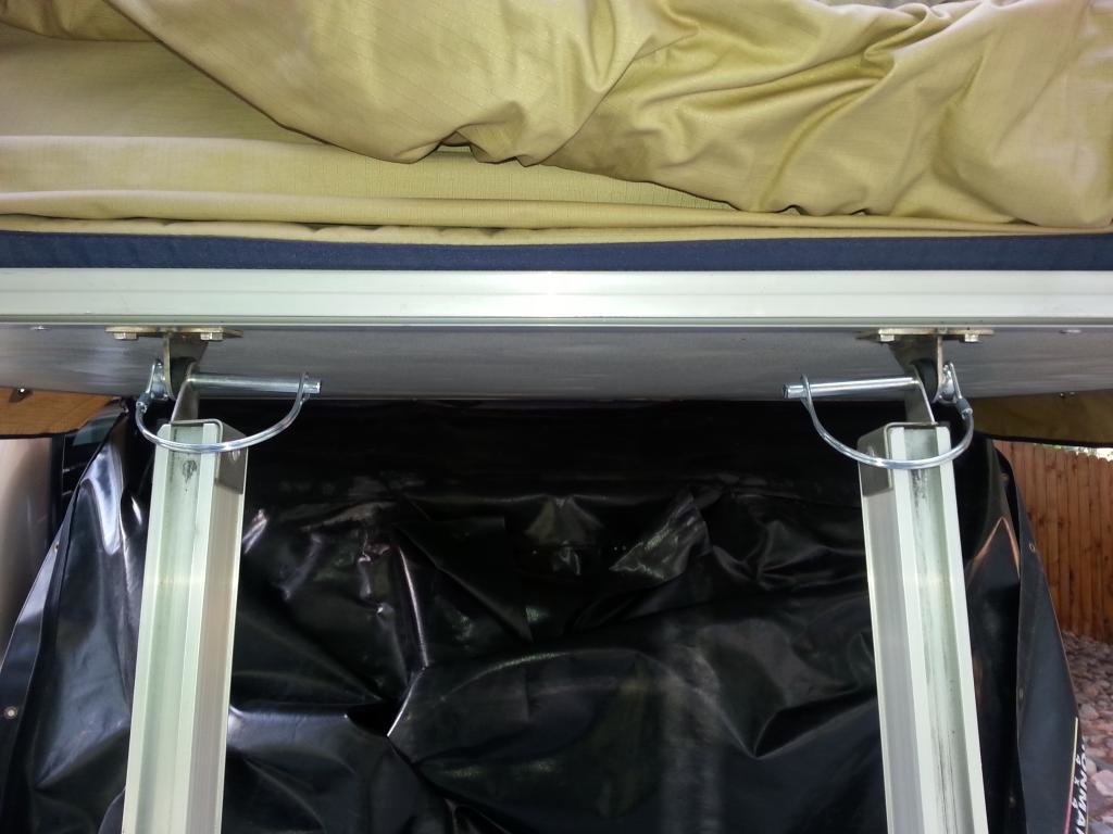

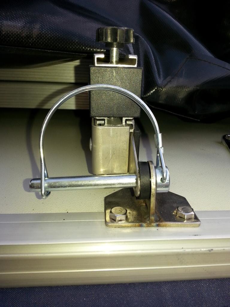

    Just a small thing I did this morning but some of you might find it handy. My truck would not fit in my garage simply because of the ladder stored on my RTT. So I started the season with removing the tent after each trip and reinstalling before the next trip so I could still keep my truck in the garage. Then it finally dawned on me this last trip why not make the ladder easy to remove instead. A ton less work then trying to load the tent each time. I finally got around to it this morning. All it took was to remove 2-10mm bolts that held the ladder on. Turns out they were not even the right bolts (I got the tent used) as they were in 5/16" holes. So I got 2-Hillman 5/16" pins and completed the task in just under 10 minutes. And now I fit in the garage. :)

    You'd have been better off building the correct size garage. Priorities are out of line on this one. ;)
    J/K. Honestly though you might just fit if you had a telescoping ladder instead of the sliding one. Measure the width of you ladder brackets and I'll see if the telescoping ladders I have will fit. I bet they're the same width. That would save you a couple inches at least.

    Yeah if the garage door wasn't just a year old and super expensive (due to R rating for insulation) I considered having someone come in and just put in an 8' door.
    The current ladder brackets on my tent have a span of 14"s between them. The ladder stack is 3.25"s high. I need to be about 1.5"s of less ladder thickness to squeeze under the door. You think a telescoping ladder might help me achieve that? Honestly I hate having to bring the drill with me to set up this ladder each time if we are different ground levels then the holes I already have in it.

    Yeah dude. Let me measure the height of the ladder on mine and see how close we can get. I bet we can get it 1.5" lower then you'd be set. I'll get back to you.
