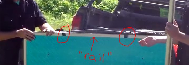

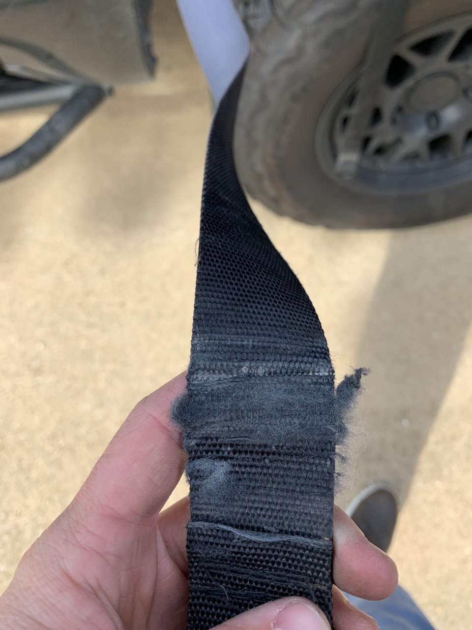

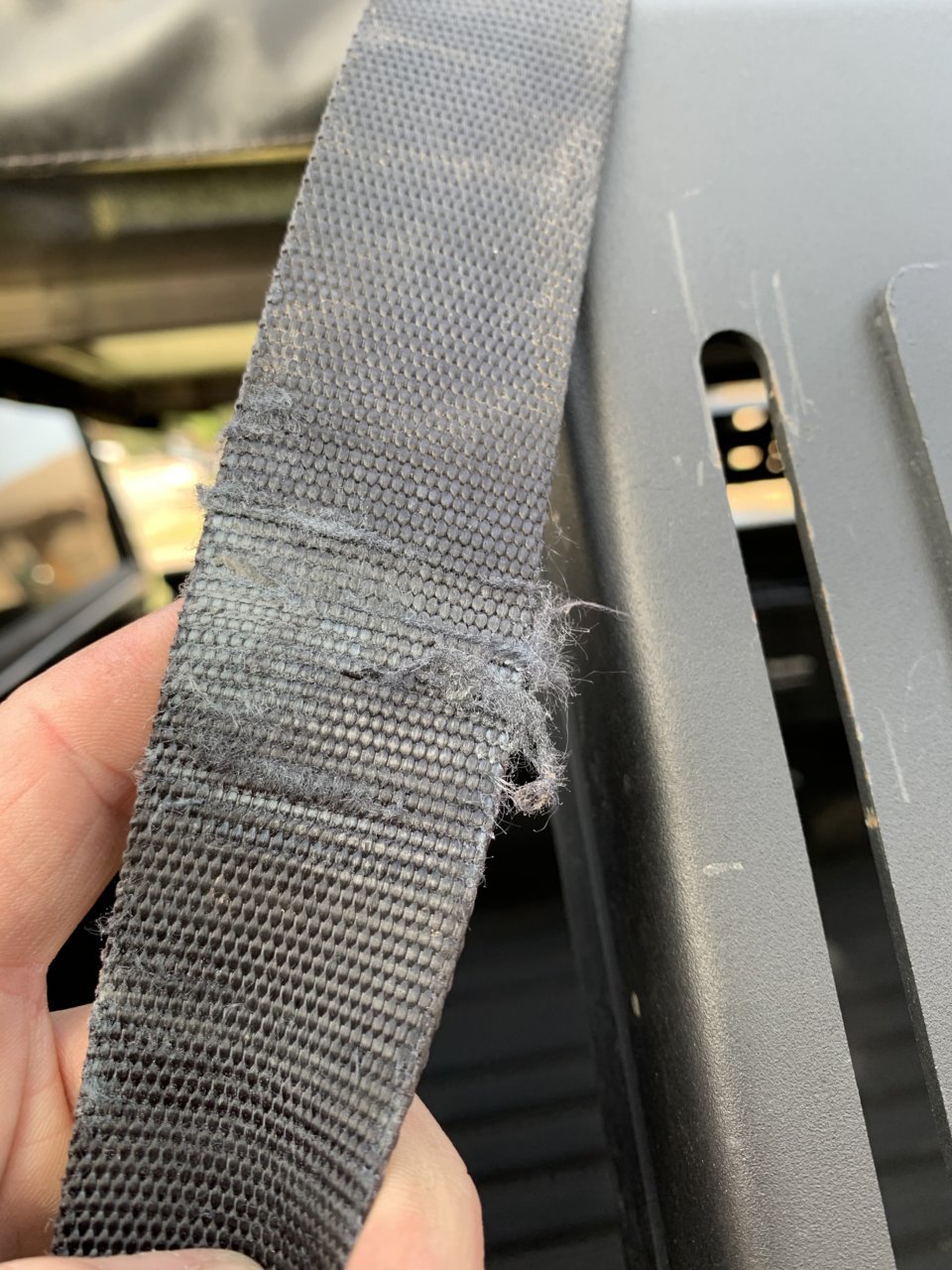

    I recently bought all new straps. All like the style you show. The 4 Velcro straps that hold the folded tent close and the 2 outside straps that hold the cover down are all getting replace. All my velcro straps are getting weaker every use and I ended up breaking one of my outside straps!
    ANYONE know how to take the tent apart?!?! I know there will be lots of rivets drilled out.

    What are you trying to take apart exactly?

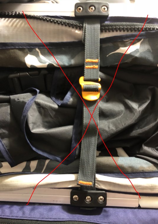

    I need to replace the straps. So I think I need to separate the tent "rail" that holds the floor together and what your tent sides and cover slips into. You know what I mean?
    Here are when my straps look like. They are like pinched between the "rail" and floor.
    My straps ARE NOT LIKE THIS:

    oooh, I see. Yeah idk about that one.
    You could add the other style if you wanted I suppose. Some sheet metal screws, a pilot drill, and the plastic or aluminum cap things. Then cut the old ones off flush. May be easier than trying to unrivet the entire thing

    Hopefully I don't need to take out tooooo many rivets haha
    I think I will be able to loosen the rail a little and shove the new trap in there.
    Looking forward to the challenge haha. I'll do it in the spring so I don't freeze my fingers off.
