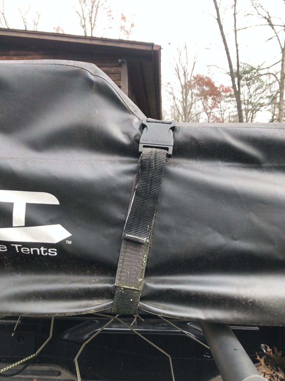

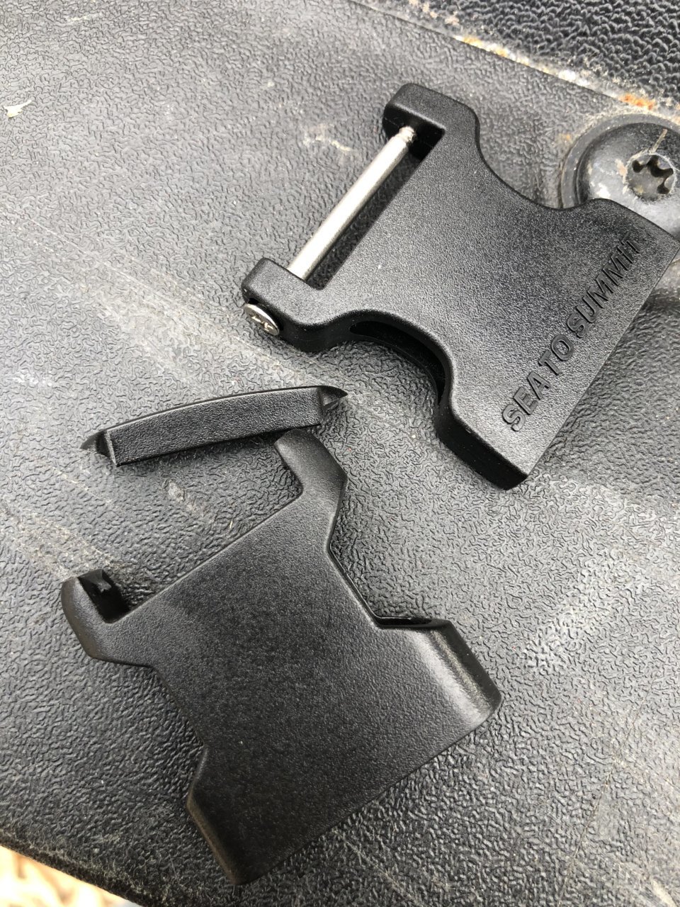

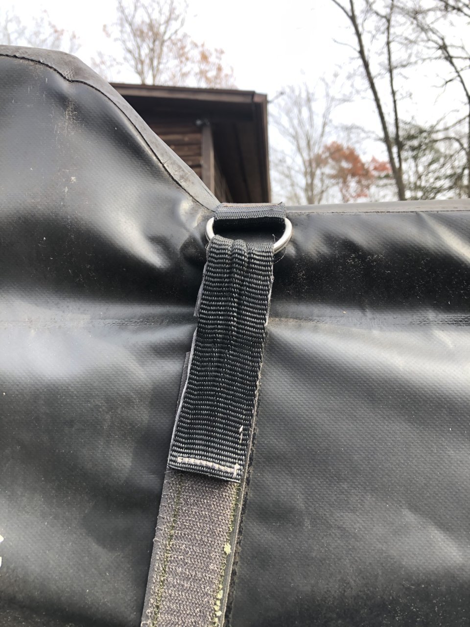

    Never liked these D rings as they were a PITA to undo after the straps get weathered and stiff. Then one of the side buckles broke and I remembered these no sew replacement fastex style buckles. So replaced the broken buckle and the D rings.

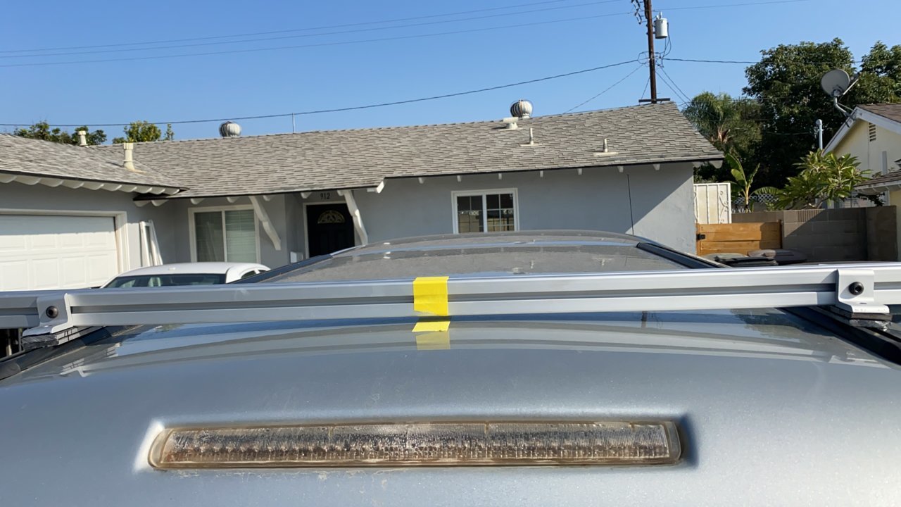

    still working on it. Got all the parts. I took 1/4” flat iron bar and cut them down to 4.5 in rectangles to run as spacers. Have to double stack them to lift the extrusion high up enough off the camper shell. So 1/2” of spacers barely clears the camper shell. Maybe about 1/4 inch off the shell.
    The t-slot slider I got for the Thule track felt too skinny. For me. The A squares that come with the track are 19mm. The 80/20 t-slots are like 16mm wide. So I ordered some new slider in squares for the Thule track that are M8 instead of the current M6 size. Since I’m running spacers I wanted to make sure that I’m running the strongest possible nuts and bolts.
    In hindsight, I should have just ordered 1x2 extrusion and the prinsu feet.
    hopefully it all works out. Pic below of how much clearance lll have.

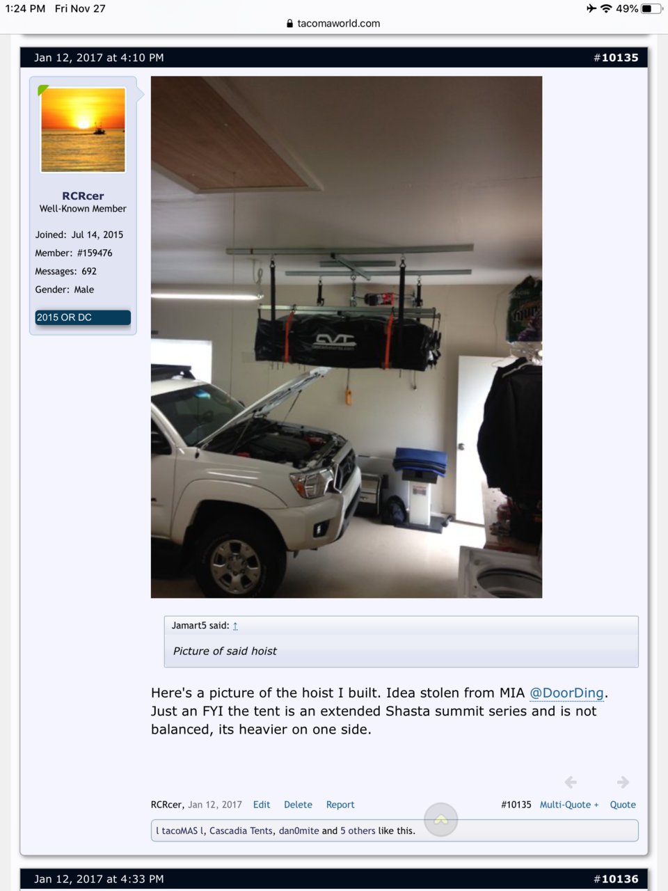

    How big and what’s the weight of your tent?
    I did mine like this. It would work better with (slightly modified) a RTT and bed rack IMO

    Thanks. I have a Tepui Kukenam 3 which is like 130 lbs and an RCI SB low profile rack which might be 100 lbs so it would be safe to call it 250 lbs. I can't quite tell how your set up works from the pic.
