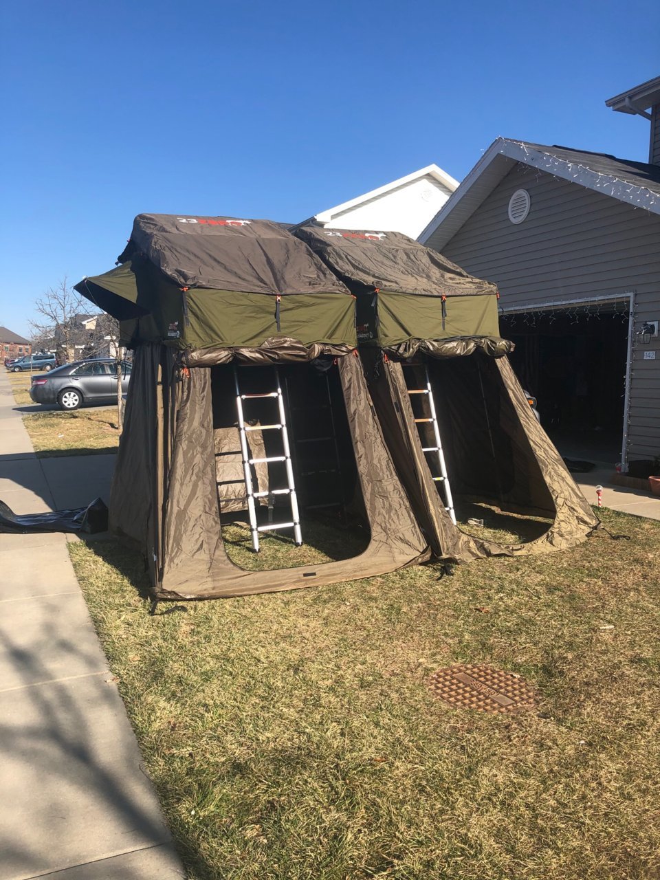

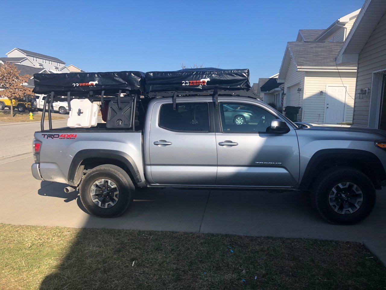

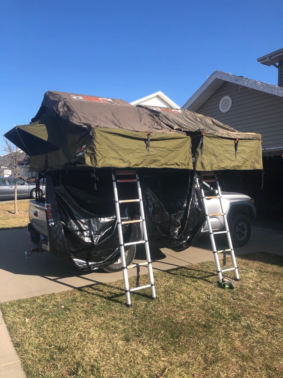

    Sure do. 23zero Walkabout 56 and 62. The 62 is on a Leitner ACS over the bed and the 56 is on a Prinsu Cab Rack. No issues at all with mounting. Only issue is unzipping but honestly the sliders with the kickout really helped that out. Just took some practice and the setup works great. Any other questions just let me know.

    The ACS is very easy to install. Only wrinkle is getting the 2x bed bolts out. Get a quality Torx 55 bit with some good penetrator and you will be fine. Prinsu was even easier - except I had to get the OEM roof rails off and the moron at the dealer that installed it used an impact driver to tighten the bolts up. I literally had to cut bolts out.....

    Yeah the ACS is very stout but still lightweight! So the walkabout 62 is pretty big and it clears the prinsu just fine and leaves the 56 with plenty of room. For the ACS get the RTT brackets - they make life so much easier. Form the Prinsu I did not get the mountain feet as I wanted to distribute the weight more.
    For the Prinsu you could use the feet easy enough or do what is did. Mount it directly to the crossbars. My sunroof helped a lot to get the front mounts on and simply took off the rear most crossbar to tighten up rear mounts. The prinsu is well built so it will not ice around with the rear bar out. Recommend some rubber to put between the prinsu crossbars and the RTT mounting rails as it will squeak!

    Wow. Quite the set up! I dig it.

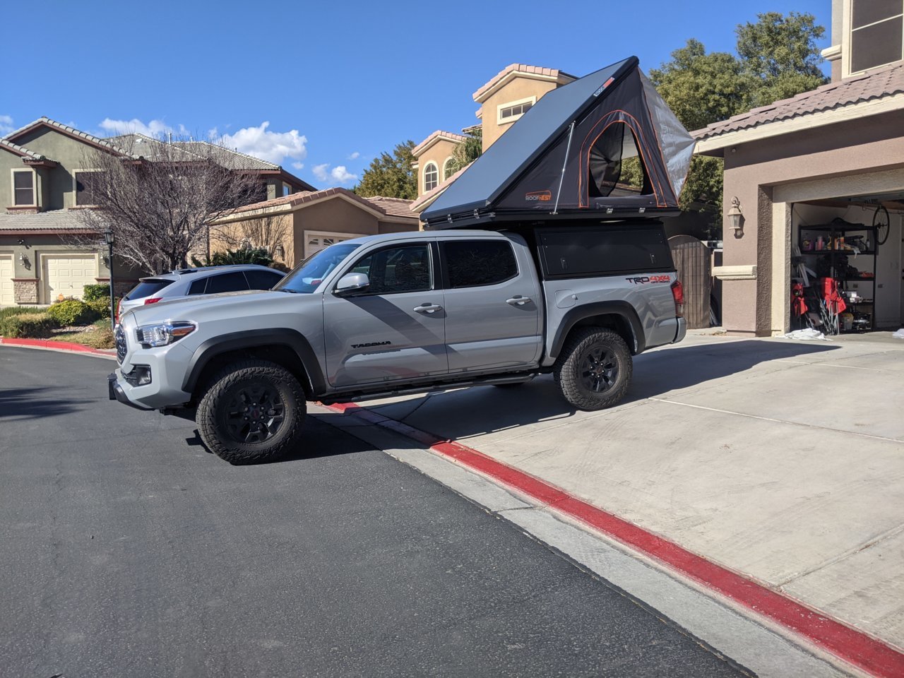

    I just switched from a soft shell tepui to this roofnest Falcon XL so I could have a shell and still fit a RTT in the garage. I haven't had a chance to use it yet, but I'm loving how quick it is to set up and take down.

    What did you do with the shark fin?

    It fits. With about 3/4" to spare. I thought I'd have to order the aftermarket flat antenna cover, but it worked. I never listen to radio so I can't comment on reception, but it fits with room to spare. This is with the low profile alu-cab bars.
