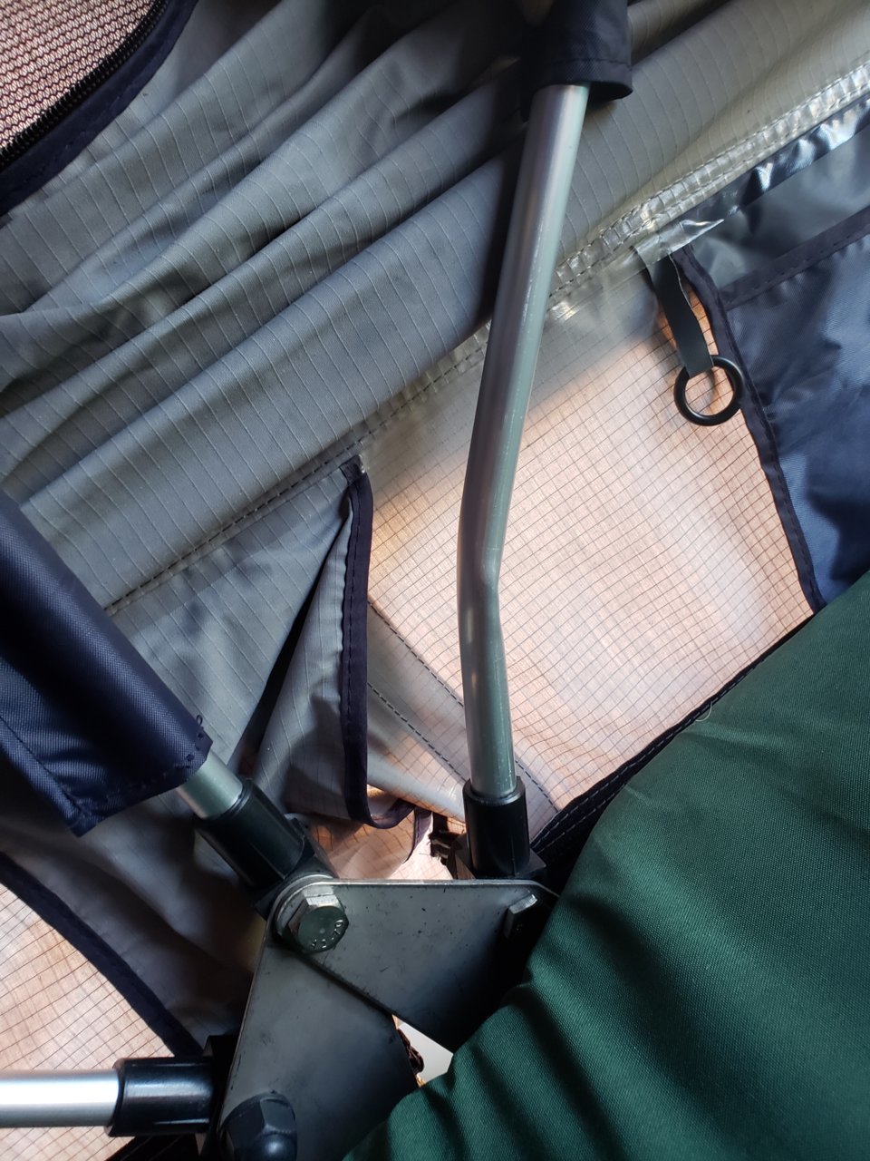

    Anyone have to deal with a bent pole in their tepui? Not sure when this happened, it's the pole that comes out over the ladder, so the top pole when I close it. Noticed it when I was airing out my tent after a rainy camping trip earlier this week. Haven't reached out to tepui yet, will be sending an email soon

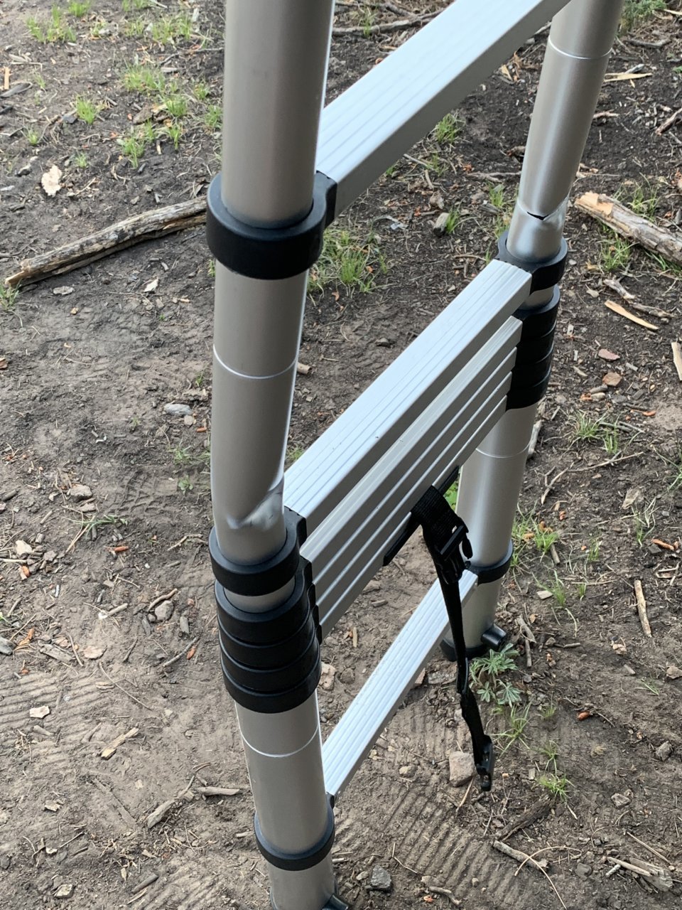

    Welp. I messed up.
    Anyone know if the harbor freight ladder can be rigged to work in this scenario? It’s looking to be my only local option :facepalm: 1363FC32-A4CE-47A4-9988-941DB1674052.jpg

    Ouch, that sucks.

    Not much stock left.
    Had the same problem. Ordered a new one from CVT.

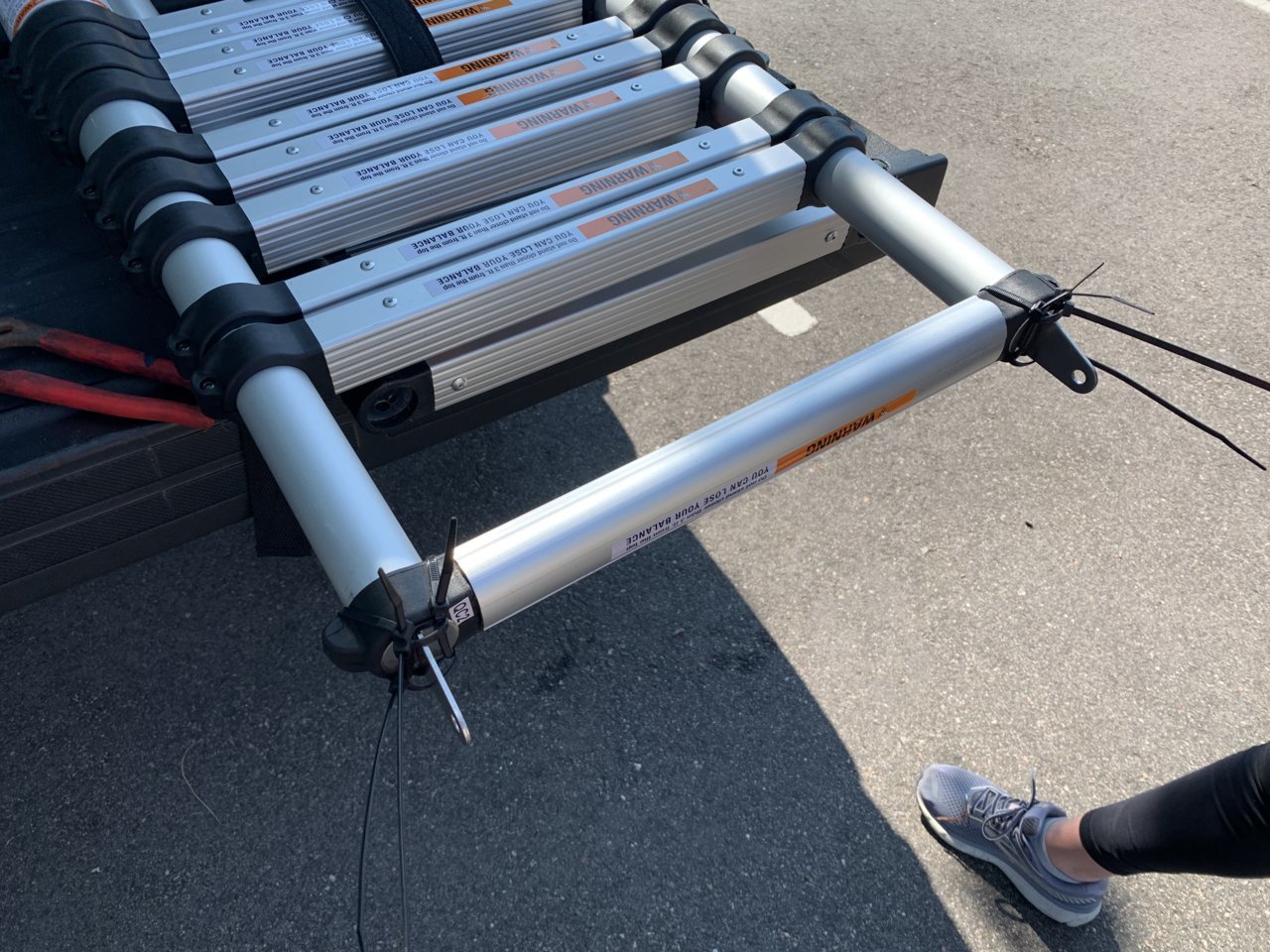

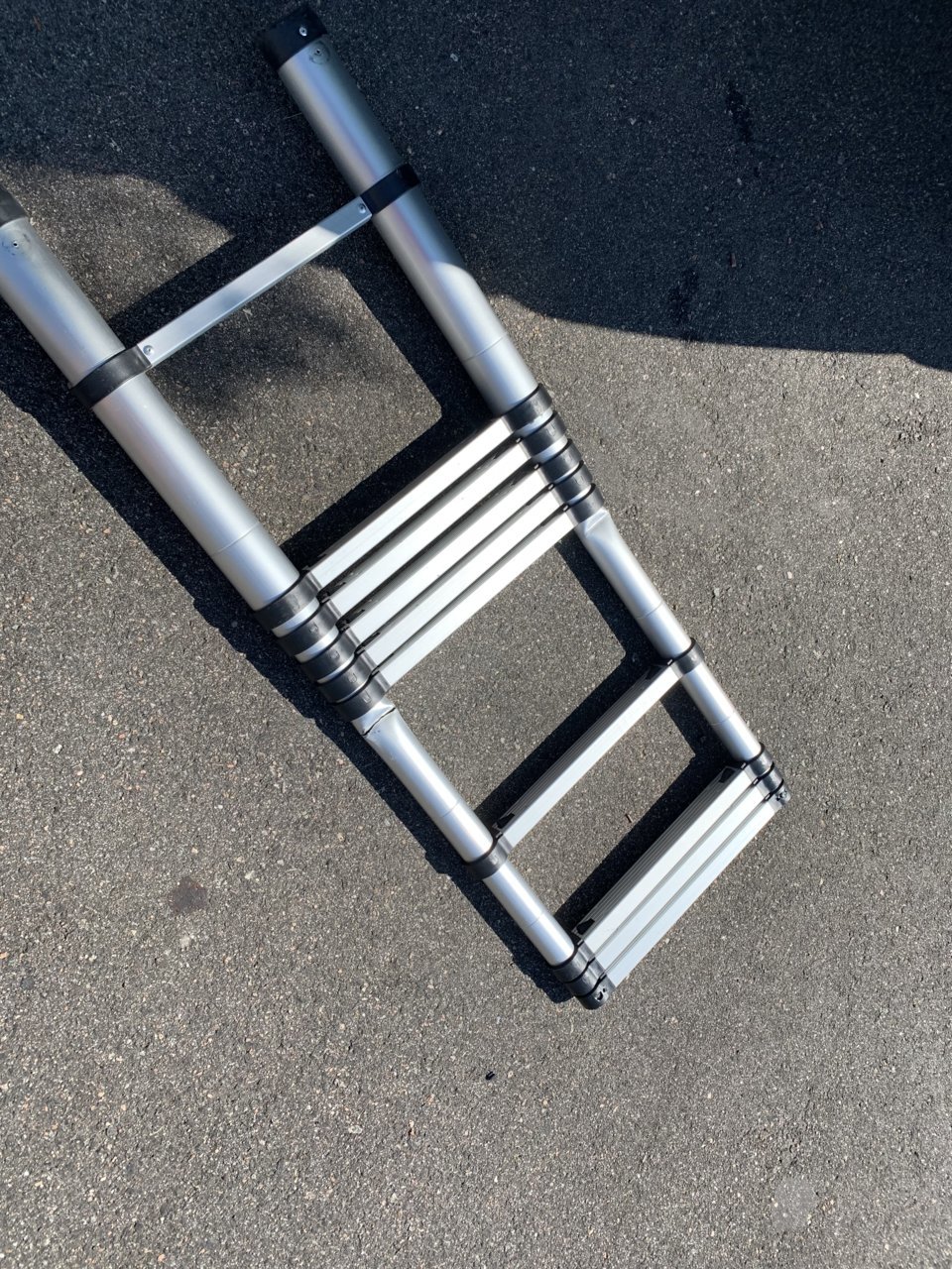

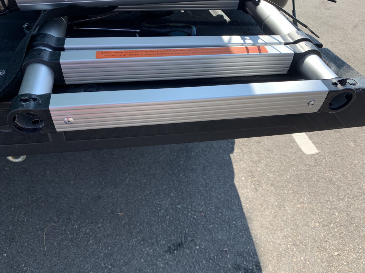

    Got the Harbor Freight ladder to work with some good ole hotel parking lot engineering. The mounting eyes on the 23zero ladder slide into the top of the ladder tubes and are held in by rivets. Luckily I could hammer the rivets out, but I don’t have a drill so I couldnt screw in anything to hold the caps in the new ladder. So four zip ties on each side are gonna have to work until I get home to my tools.
    RIP to the little ladder that couldn’t.
    3D667A50-5007-4FDE-870D-376A684768C9.jpg F926BC2A-9600-4F51-944A-8DD0BD9D74DA.jpg

    I dont know if I'd trust the zip ties.

    All the stress will be downward, so fingers crossed they hold for the three nights I need them to.
