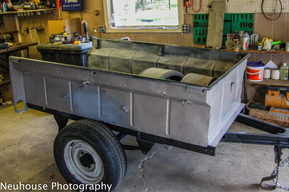

    Trailer "restoration" is nearing completion. Next is to build the lid and then it will be set to mount the tent. I won't be building a rack or slider steps this fall, that will be a next summer or winter break project lol. So stoked!

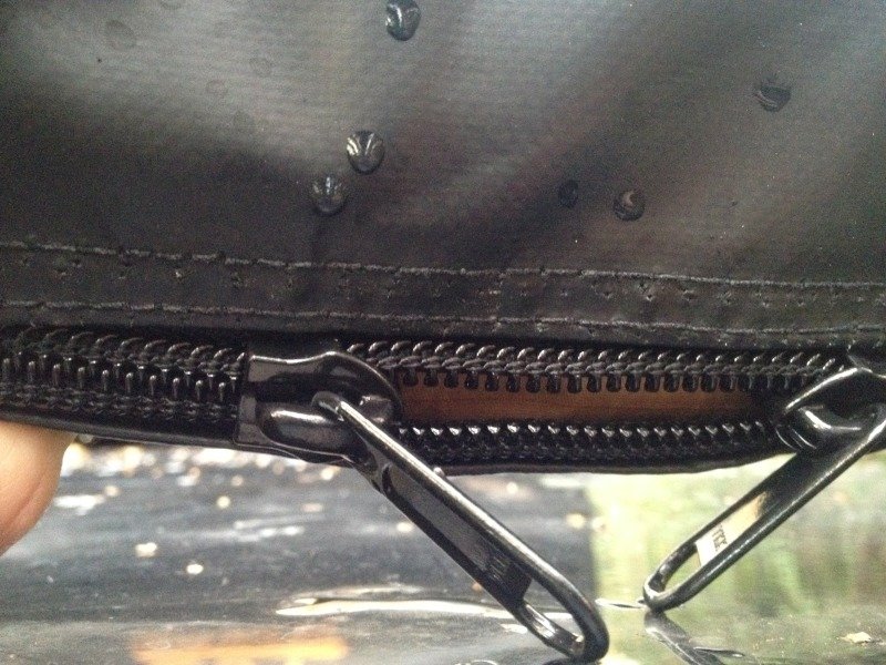

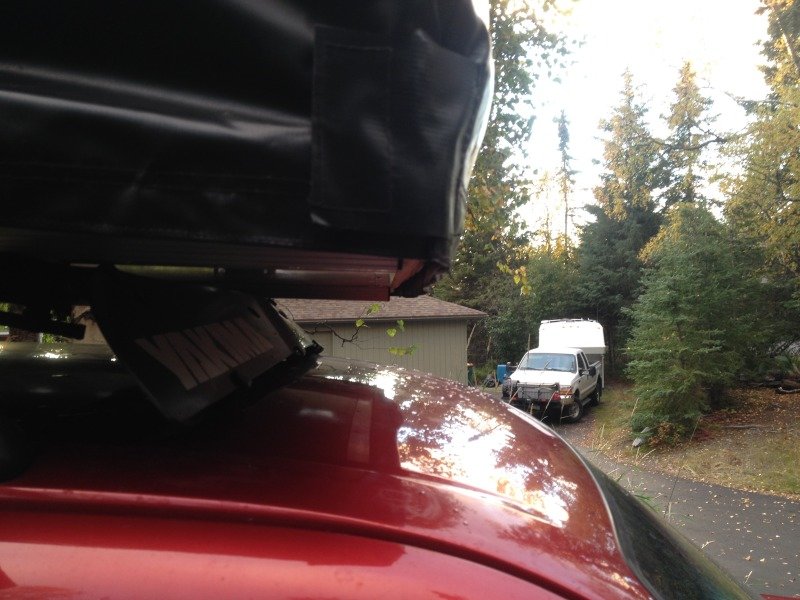

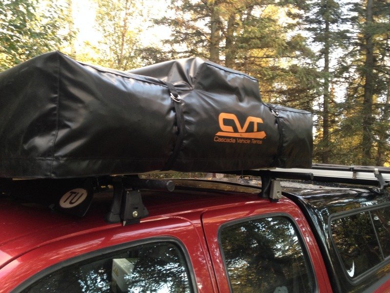

    Anyone have issues with the tent getting wet while driving in the rain? Went to air out the tent today and half the mattress was pretty wet. I can't figure out what's going on here. The hinge is the only place I can see it coming through, but the cover does a pretty damn good job of covering it up. Both leading corners are wet but i think it's all coming from the hinged side and moving across the other corner.

    do the edges of the travel cover hang down past the bottom edge of the tent when you have it all closed up? If the fabric parts of the zipper are even a little exposed and get wet it would be really easy for the moisture to wick into the rest of the tent. when you cinch down the two straps over the top of the tent do you make sure that the edges aren't turned up?
    i know one other person complained about the tent getting wet inside and it turned out that he had the wrong cover - it was so tight that the very edge of the zippers were exposed and it was enough to let moisture in. post a few pics if you could...

    This was exactly my issue.
    If your cover looks like this, you have the wrong one... Haha
    You can see the tan fabric that the zipper is attached to, which was letting water into the tent.

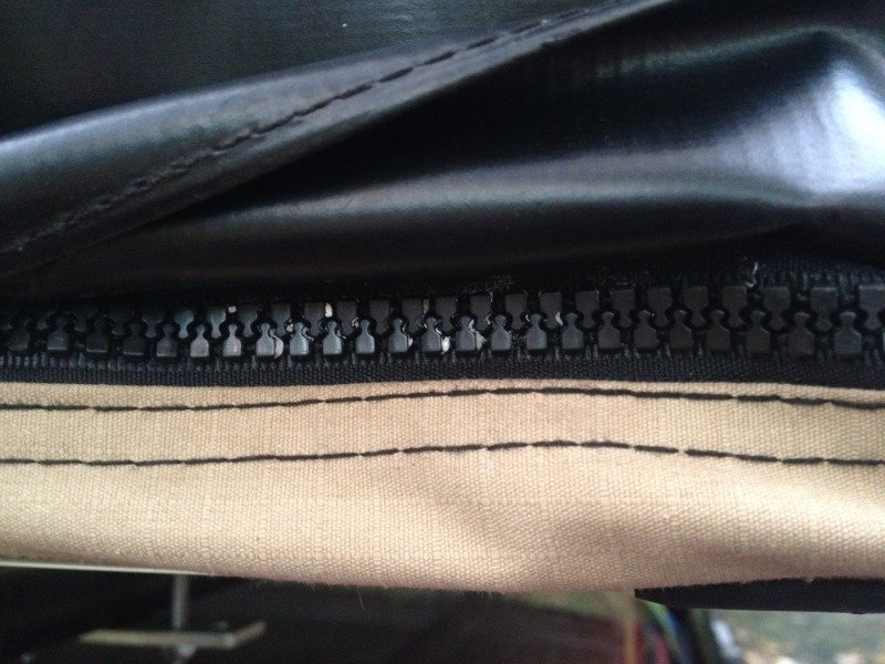

    Hinged side.
    Non hinged side.
    This is the zipper on the cover. Cheap IMO. One tooth fell out (on the side, not front. Not where it's getting wet)
    Is that the same zipper you guys have?
    Or do you have one like the zipper of my CVT awning? MUCH higher quality YKK zipper. I have no idea why the tent cover zipper would be different and cheaper than the awning...
