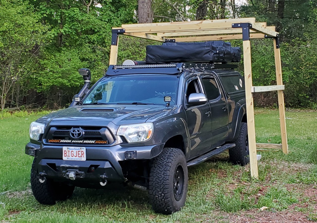

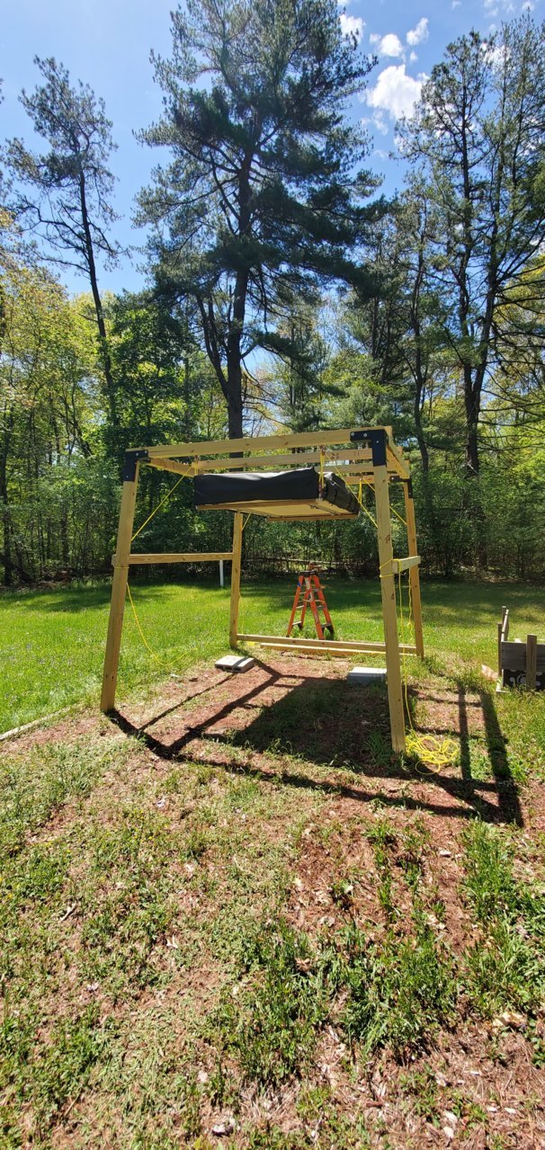

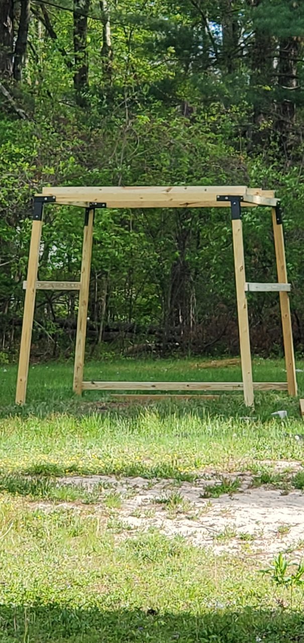

    I don't have a garage so I can't offer any advice on any of these options but I built my own for less then $150. I used 4 "deer hoists" from harbor frieght.

    That’s cool, you can even build that into a shed to keep more of the elements off the tent.

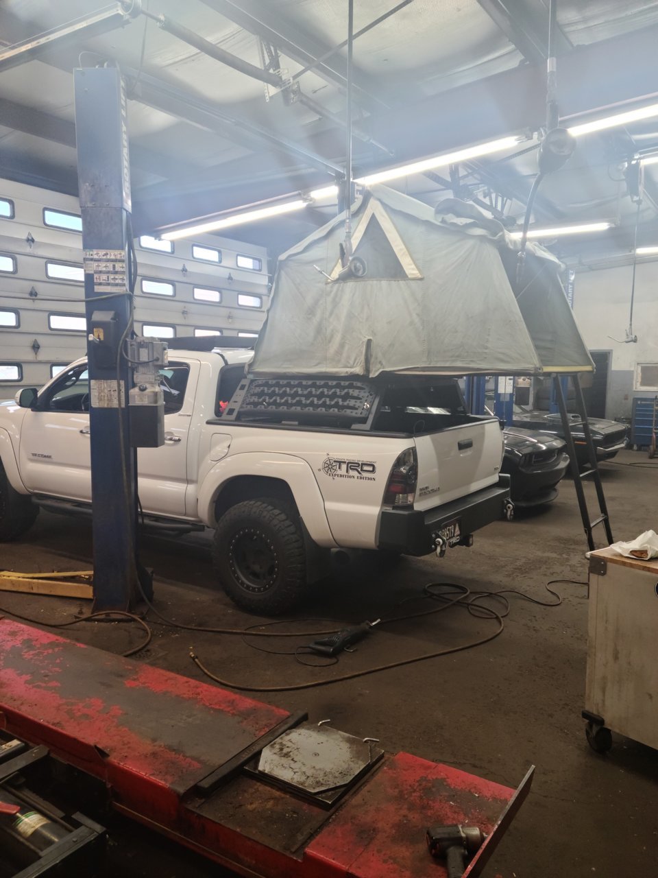

    Picked up the Roofnest Condor Overland earlier today. Hoping to install it later tonight. So far, it looks like a good fit for the current bed rack setup. Thank you Tepui Ayer II for your service. I hope the next users enjoy you as much as we did or more. :)

    That is awesome. Would you have a link to this build? I'm over a year away from finishing my shop and need something like this to hold me over.

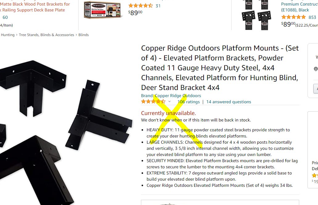

    I don't have a link to the build, unfortunately, but I basically used these as the corner brackets:
    https://www.amazon.com/gp/product/B07CKL93B9?ie=UTF8
    and I used 8 4x4's for the top and the legs, then attached the 2 sides with pressure treated 2x4's and the back with another 2x4 to give it some rigidity. Then I attached 4 Harbor freight "deer hoists" from the top and with eye bolts, I hooked 2 2x4's to slide underneath the front and the back of the RTT to hold it up. I also used the front runner sliding quick release RTT mounts to quickly attach and detach them onto the truck.

    Thank you Sir! Exactly what I needed - the parts list above. Those brackets were throwing me. Saw your post the other day and stopped by Home Depot and Lowes but couldn't find them there.
    Edit: Currently unavailable...Like everything else!! Sheesh. I'll search more. And thanks again! :thumbsup:
