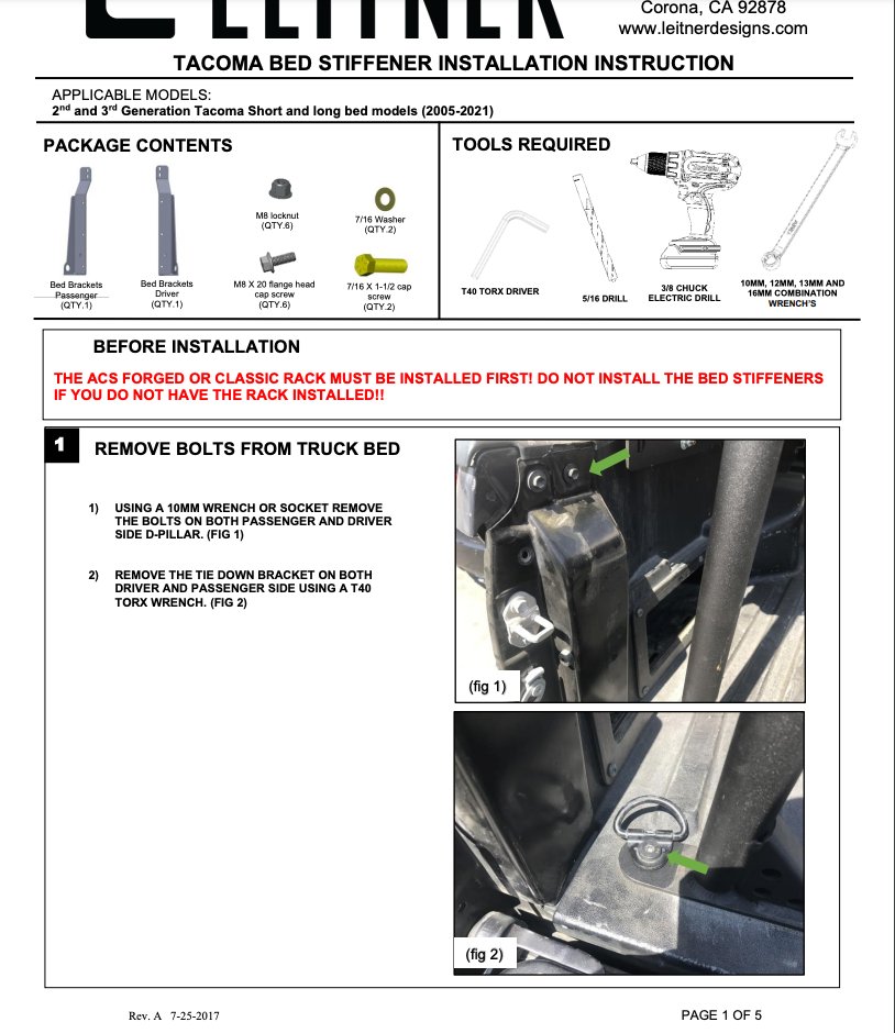

    Is that directly on top of a RTT rack? I ordered the @TOTAL CHAOS ones earlier this afternoon.

    Yes. The install instructions call for the ACS forged rack to be on the bottom and the bed stiffener to sit on top if you are using both, since they both share the same factory bolt hole. Note: you lose the factory tie down but the Leitner bed stiffeners have a tie down that is stronger.

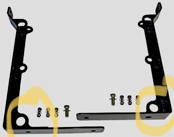

    The TC stiffener has another option for the tie down.208DB4CF-70F3-4668-8A71-B261A6FD8083.jpg

    I use this feature a lot. Granted, the D-rings are there stock, but at least putting the bed stiffeners in doesn't take away the tie down option.

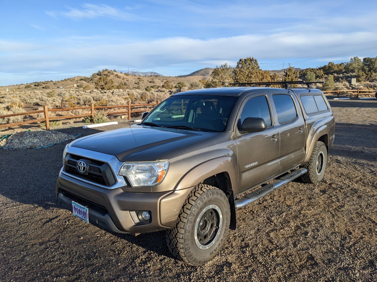

    Don't know if this is *strictly* the right place to ask this, but here goes:
    I have a Leer 100 Shell with Thule Roof Racks. Looking to get a roof rack above the cab of my truck that will be at the same height so I can do a RTT longer than my 5' bed. Does anyone have any suggestions on where I can find a cab rack how that will match the heights of the roof rails?

    When you have a tent that spans from the bed to the cab, you don’t connect it to both. The cab and bed flex independently of one another so you want a gap between the tent and cab rack. So if you wanted a longer tent you could run it as-is, assuming your cap rack is up to the task.
