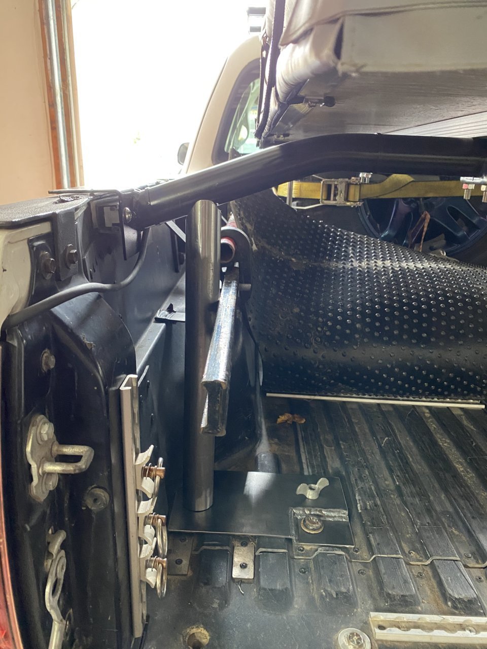

    Best solution I could come up with was tying the rear of my bed rack into the bed mounting bolts, aka the frame, to relieve the bedside stress.

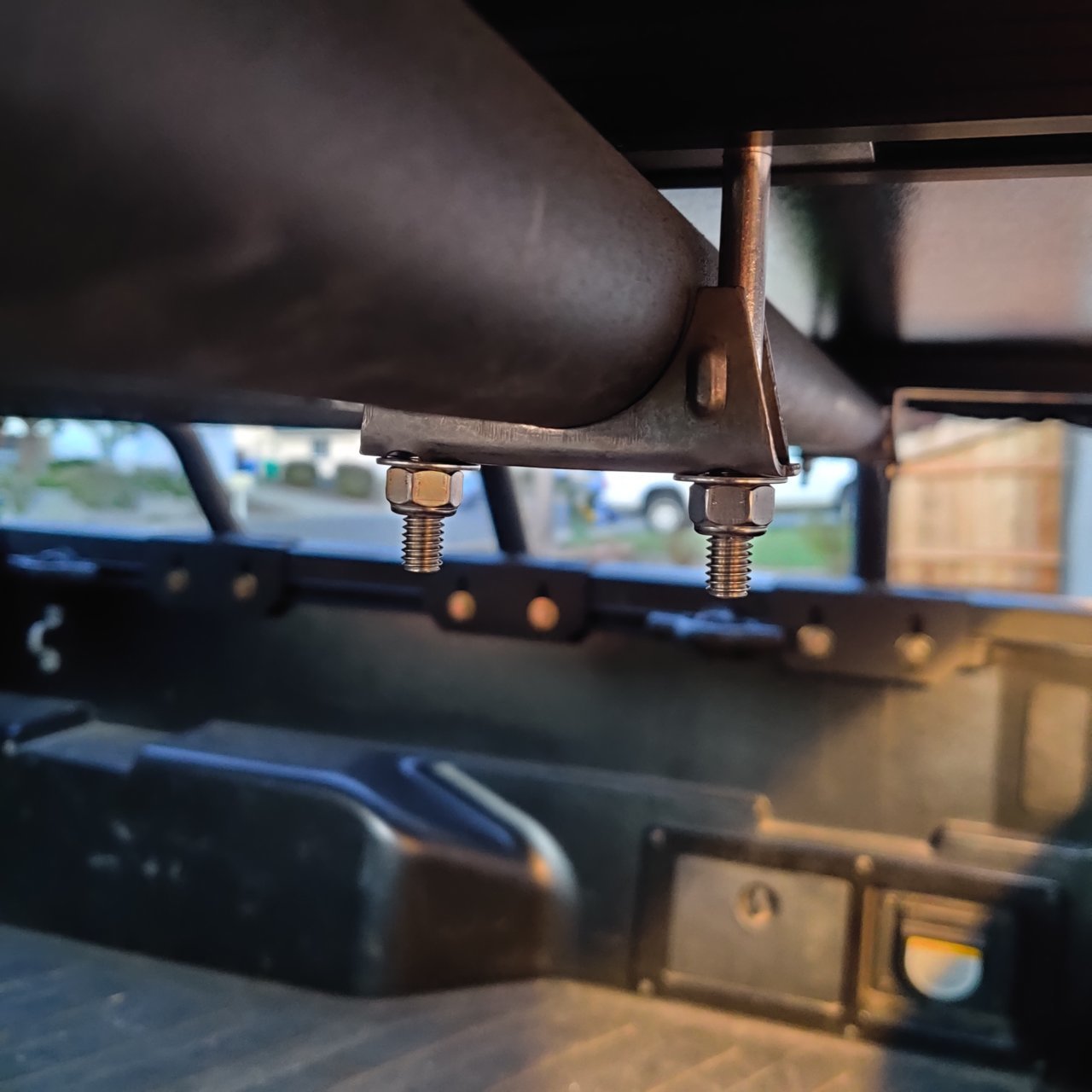

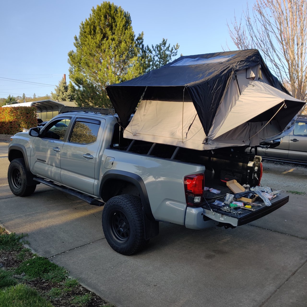

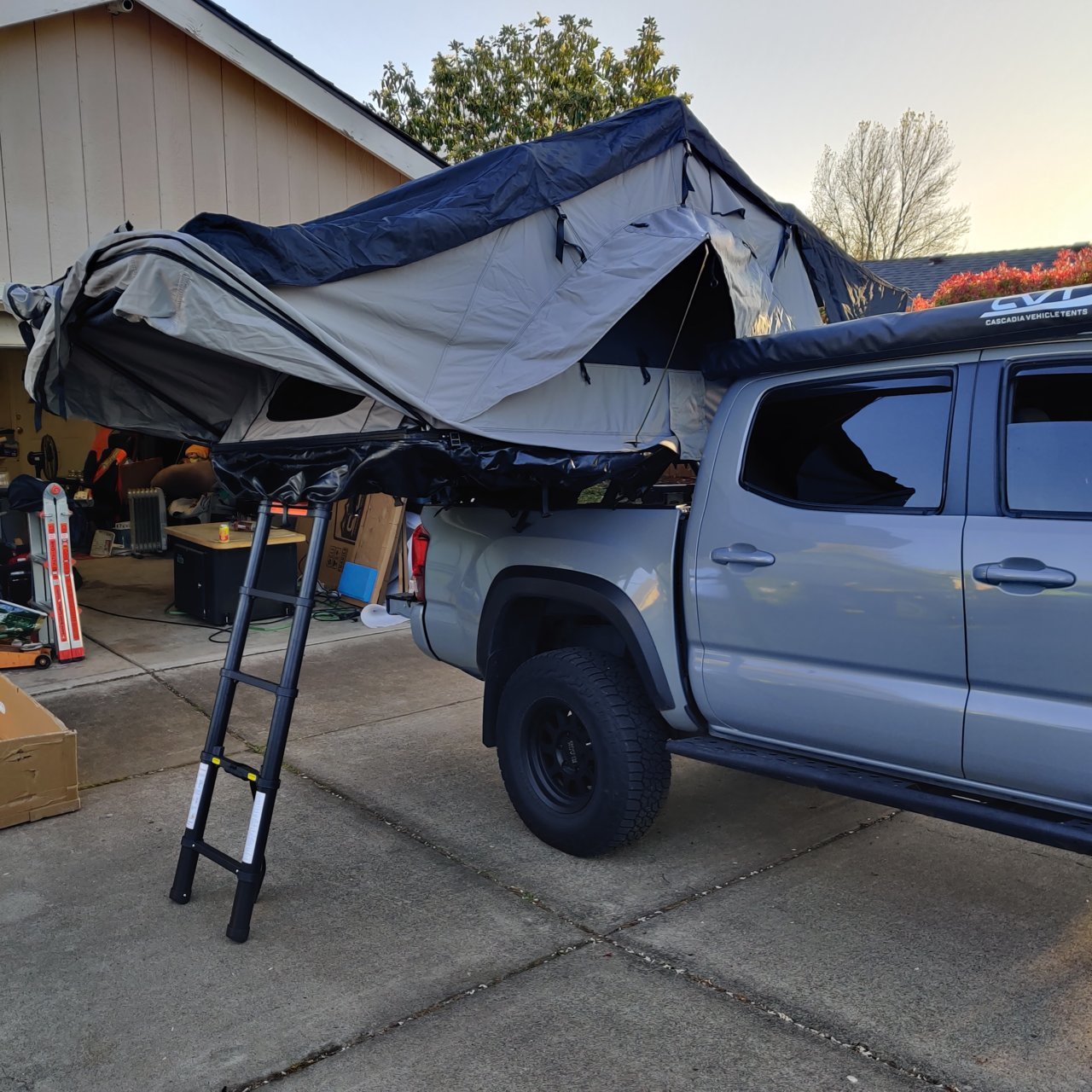

    Well I got it mounted..I used 1-3/4" exhaust clamps and 3" bolts. I also got 2-1/2" bolts but they just weren't gonna make it since the exhaust clamps don't rly flex. I added a pic to show how much bolt is left. I don't rly care for it but it will do for now. I'm going to prolly look for some button cap bolts and put nuts in the rail slide inserts. That way there's nothing rly hanging down.
    All in all I'm quite pleased with the tent itself and feel it was worth the upgrade for sure. I can already tell the bed pad it far better than my last tent. Also I wasn't aware it came with the USB led light strip! I'll be opening it back up in the next couple days if anyone is interested in specific pics lmk.
