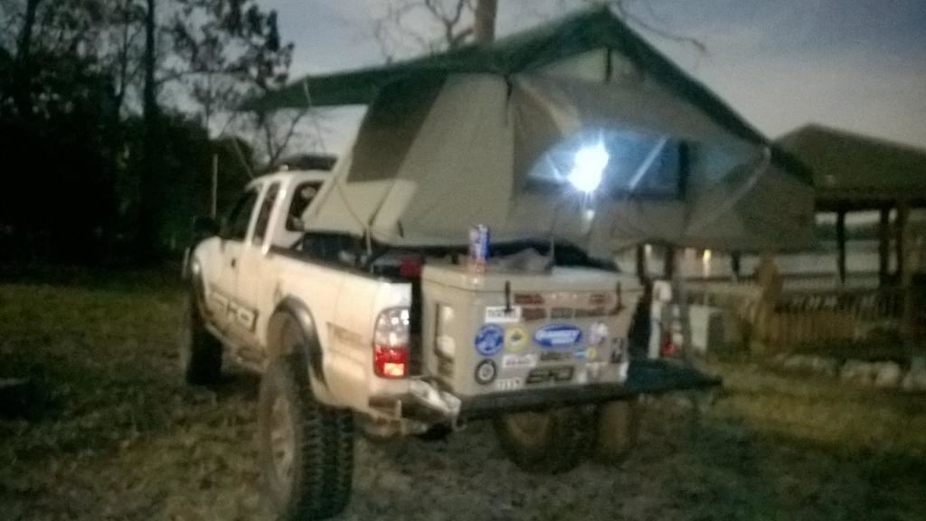

    Look at build!
    Used mine at the lake last night and will be tonight as well..
    blurry but eh

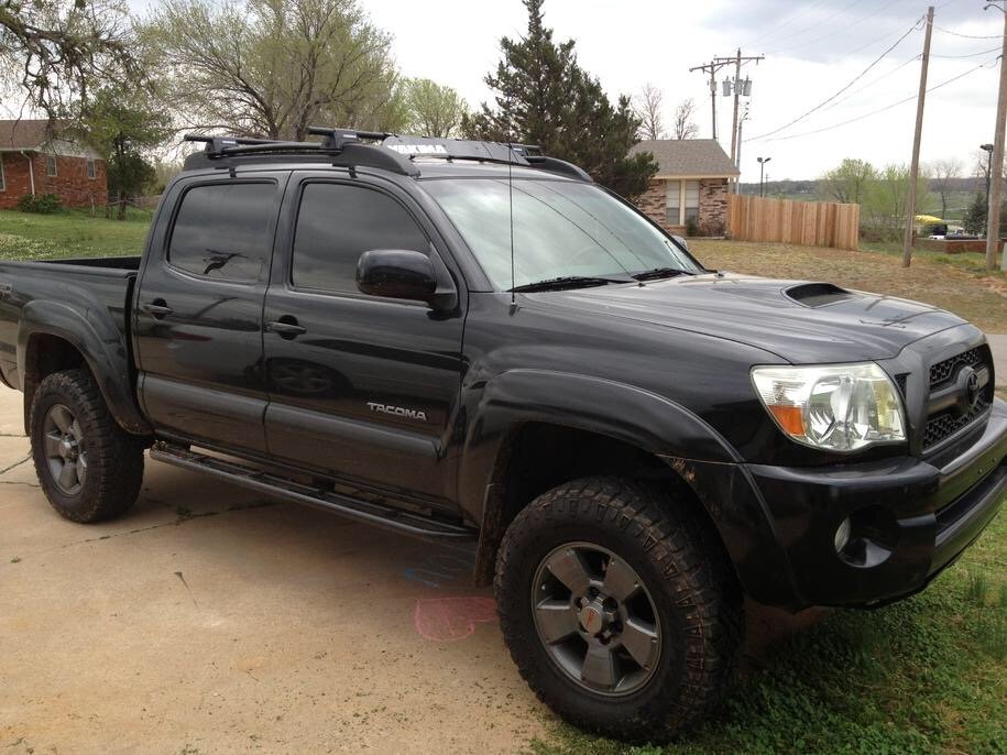

    Can I use a the regular Tacoma roof rack? I've seen only one person that used it but I haven't heard anything good or bad, I've read thru most. Can anyone chime in? Thanks

    You can use the OEM side rails but not the cross bars. The cross bars are rated at 80 or 90lbs, if you get yakima/Thule clamps to clamp on to the side rails with according cross bars, then yes.

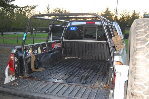

    Oh okay, but still you will have no problems. I know many people that have bed racks with RTT's with zero problems. One of my friends on here keeps his tent and bed rack on his truck full time (Im sure others too) and commutes in it, been on for a year and a half now with no troubles. Im sure people on here can back me up in saying you will not have any troubles with bed side cracks if you go with a quality bed rack (ie All Pro, Pelfreybilt, SOS concepts and many more companies).
    OR have one custom fabbed that mounts to your bed rings and not your bed rails. Like this, this is JEVERICH's (I think thats how you spell his username):
