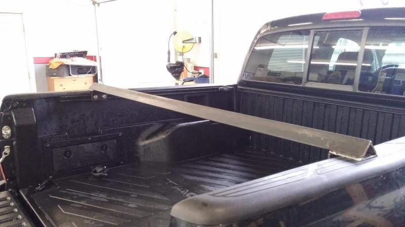

    Just had another, more simple idea. My buddy has some angle iron and can weld a little. We might see what we can come up with on Sunday.

    Dont think you need angle iron. Just flat stock to get done what they were talking about.
    Although you could weld them together with angle iron giving a longer foot on the bed rail.

    In the pic, I painted on some yellow where I'd place the angle iron. I think it'll stiffen up and reinforce the upper part of the bracket, and rest the weight on the bedside, and hten the bedrails will just be used to slide it around and lock it into place.

    The bed rail cap isn't exactly the strongest thing. If you want to add some stability, carry the bar down to the bed of the truck.

    Id do that between the two bars and weld them together also personally But isk your other uses for them.

    That will probably work but you really need to make it much larger than what you have drawn. Make it go all the way out to the outside edge of the bedside. I would also try to make that flat part a minimum of 4" long.

    Want to see if they'll take what you're asking, its easy. Take a sheet of plywood, throw it across the bars (3/4-1" preferred for strength) . Grab 3 people and have them get on top of the plywood. Have them give a couple jumps, grab a straight edge, put it against the bars and see if they are straight both with people on the plywood, and without. If the bars sag an 1/8 of an inch you're at about your limit, 1/4 inch i would be real concerned.

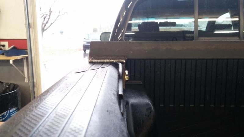

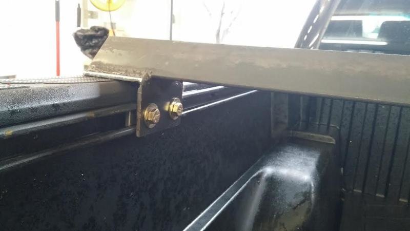

    Me and my buddy made some super mega jumbo #1 bed rails to mount the tent to.
    Gotta finish drilling the other one. The battery died on the drill. I'll shoot them with some rattle can bed liner when they're finished up. What is the span of the bolts that mount the Tepui tents?

    I believe its about 32.5" if IIRC

    Sorry, I meant in between the bolts? These bars are nearly 3 inches wide and I want to make sure I have room for the bolts to clear.
