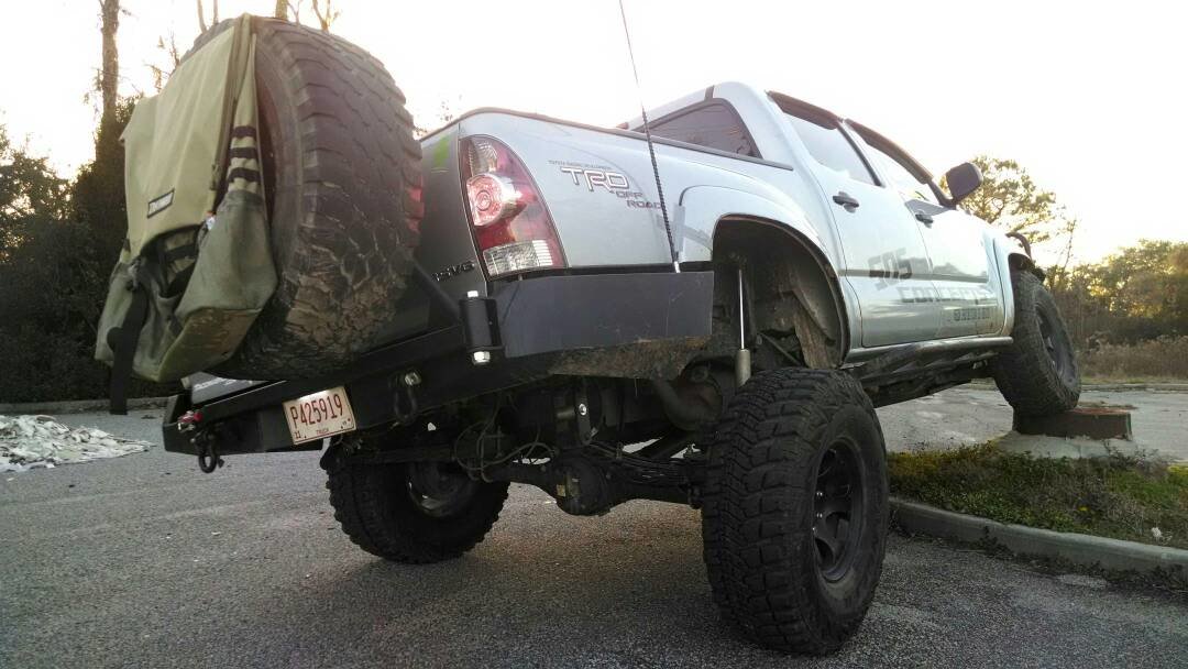

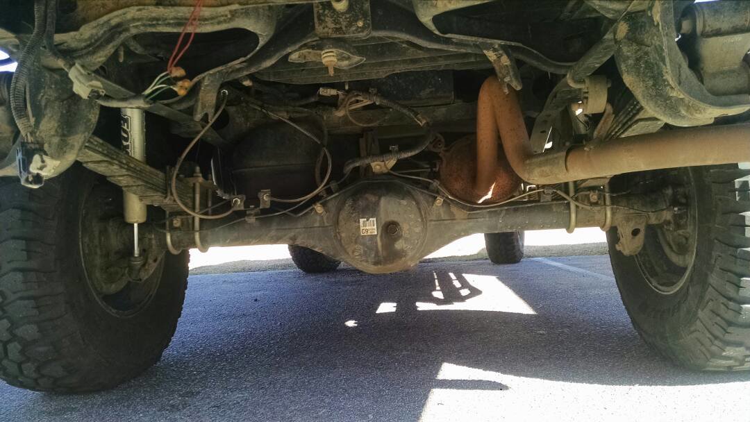

    I need better springs. The weight from my rack, boxes and RTT are flattening out my Allpoo Expos. Its leaning hard on the drivers side. Anyone have any suggestions on what to do to fix it?

    Anyone looked into 63" Chevy springs for the second gens? Maybe a 3/4ton leafpack?

    Obviously not a second Gen but mine are dakars with AAL. Seem to do the trick. You put the 35s on yet?
    Also, do you have more tools on the left than the right? Not being ignorant. Just asking. If you do, plus the gas tank, gas, battery etc all on that side already

    There's actually more in the passenger tool box, but I do have the spare battery on the drivers side. There's 12 gallons of water on the passenger side though

    There are a few people who've gone the Chevy route. I think you can find a thread on how to make the change. Anyway. you'll need one of the conversion kits (Lowrange Off Road/RuffStuff) and a set of springs. You might also need longer shocks.

    :notsure: water weight should definitely help. So im out on this one lol. Possibly broken center pin in leafs?

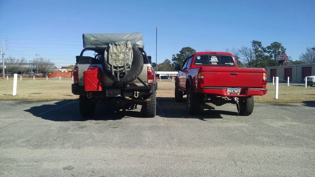

    I'll be doing longer shocks either way. Going to relocate the upper mount and do a shackle flip so I can do this:
    He has Expos too. The opposite side of his are sagging.
