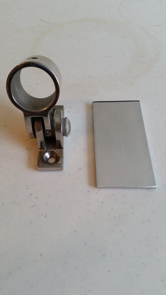

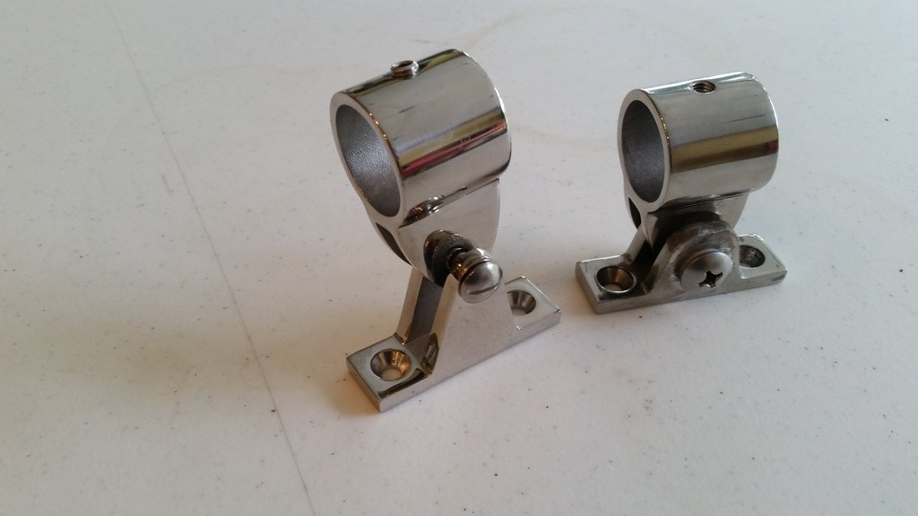

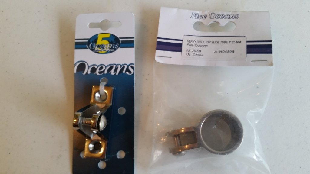

    One thing that kind of bugged me was how difficult it is to get that support bar in position for the ladder overhang. I have been playing around with an idea and just received the parts I ordered a few days ago. I cut it down because I didn't like how tall it was but that wasn't totally necessary. I also added nylon washers between each contact point to not pinch or grind any fabric and help it pivot.
    These are stainless steel bimini top parts for a boat. They are the exact same size as the tubing used for the overhang (1" or 25mm). I would have just bought the plastic ones but I could not find them in 1" or 25mm.

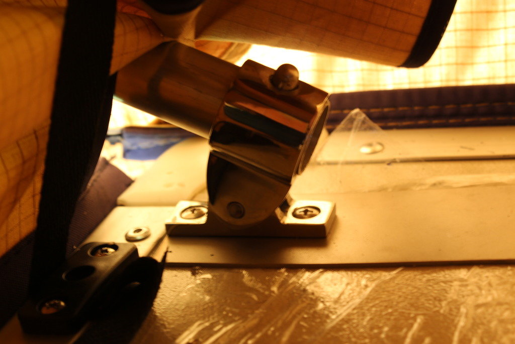

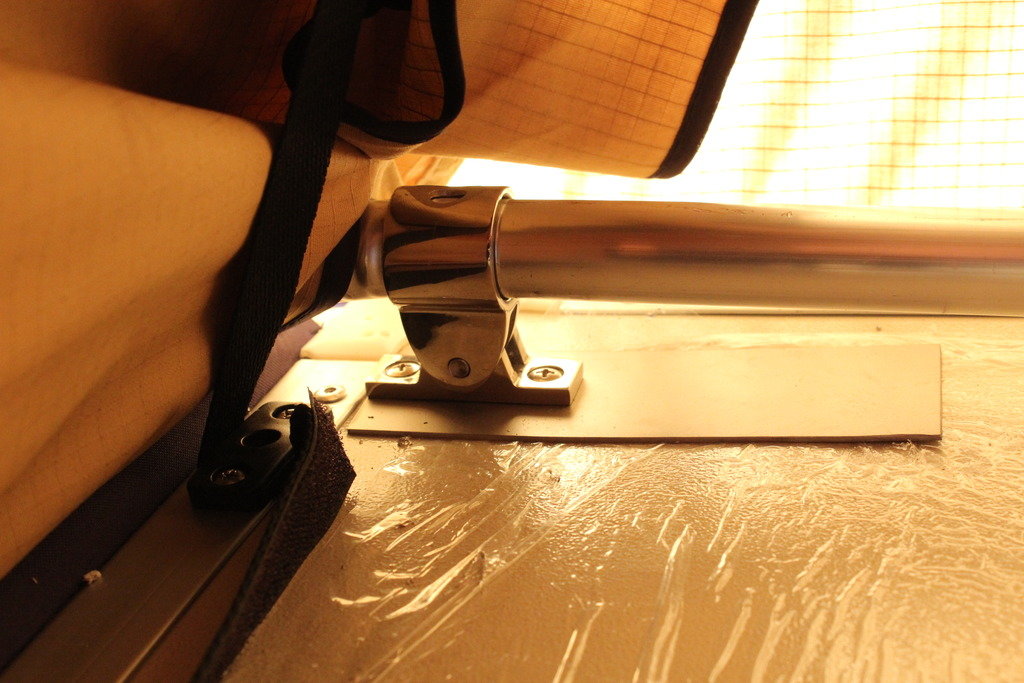

    I just finished everything up today. I think it would be best to have this type of mount in nylone. The edges of the SS mount keep wanting to dig into the aluminum rod. Also since the mount is a few inches back it doesn't keep the cover as taut. Even with these small issues, I still like it better than the original mounts. while sliding it in or out it does snag a little bit but
    This is with the bar completely retracted. I used a stainless steel plate underneath to distribute some of the weight of the bar/mount:
    This is with the bar completely out. You can see the button spring that I used in this picture. I did take this picture before making the end caps (cut down the old nylon pivot point):

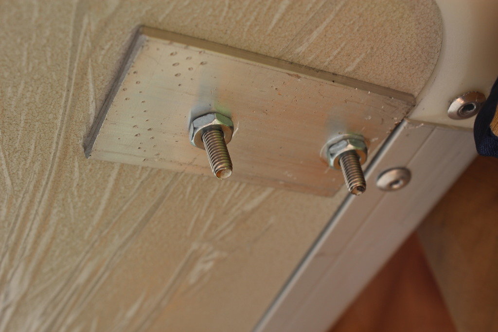

    Underside. I sandwiched both sides so that I didn't destroy the thin aluminum flooting. I did cut the bolts down flush as to not rip the cover:

    Use some wax on the aluminum and it will help prevent it from digging into the aluminum. You could also take the bar out and have it anodized which will essentially harden the aluminum, but not sure the cost would be worth it.
