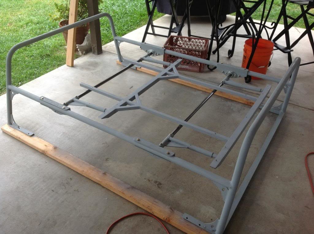

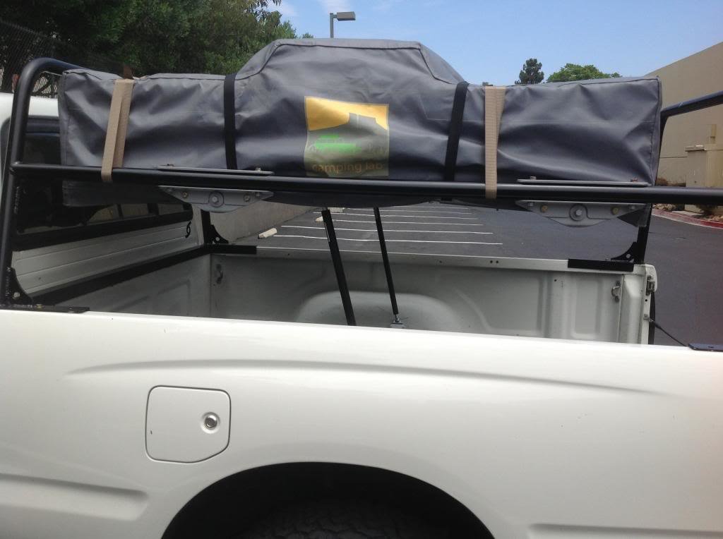

    It's been done...

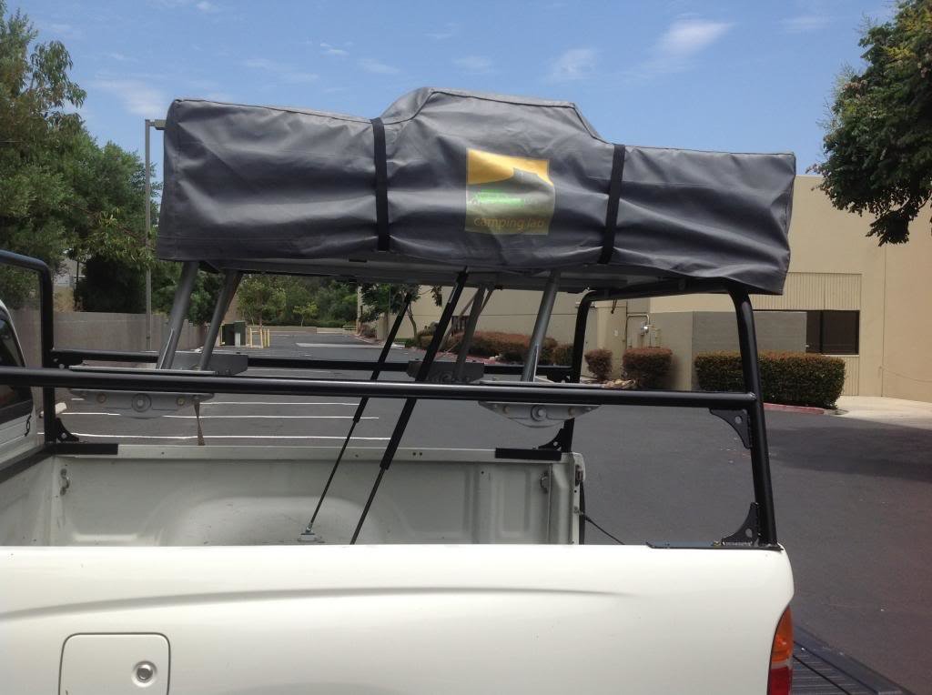

    Lowered for transportation
    Raised for use
    A short video of the action.
    http://vid1303.photobucket.com/albums/ag143/prayrocks/IMG_0261_zpsa8e1db30.mp4
    Recent trip
    Some build detail shots

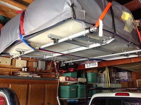

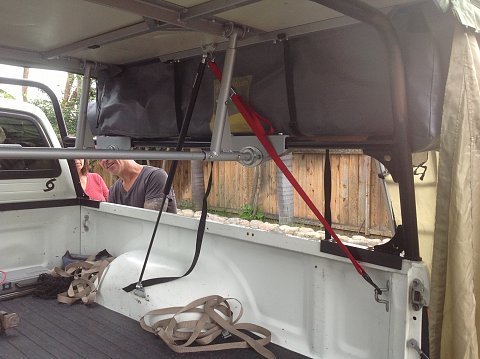

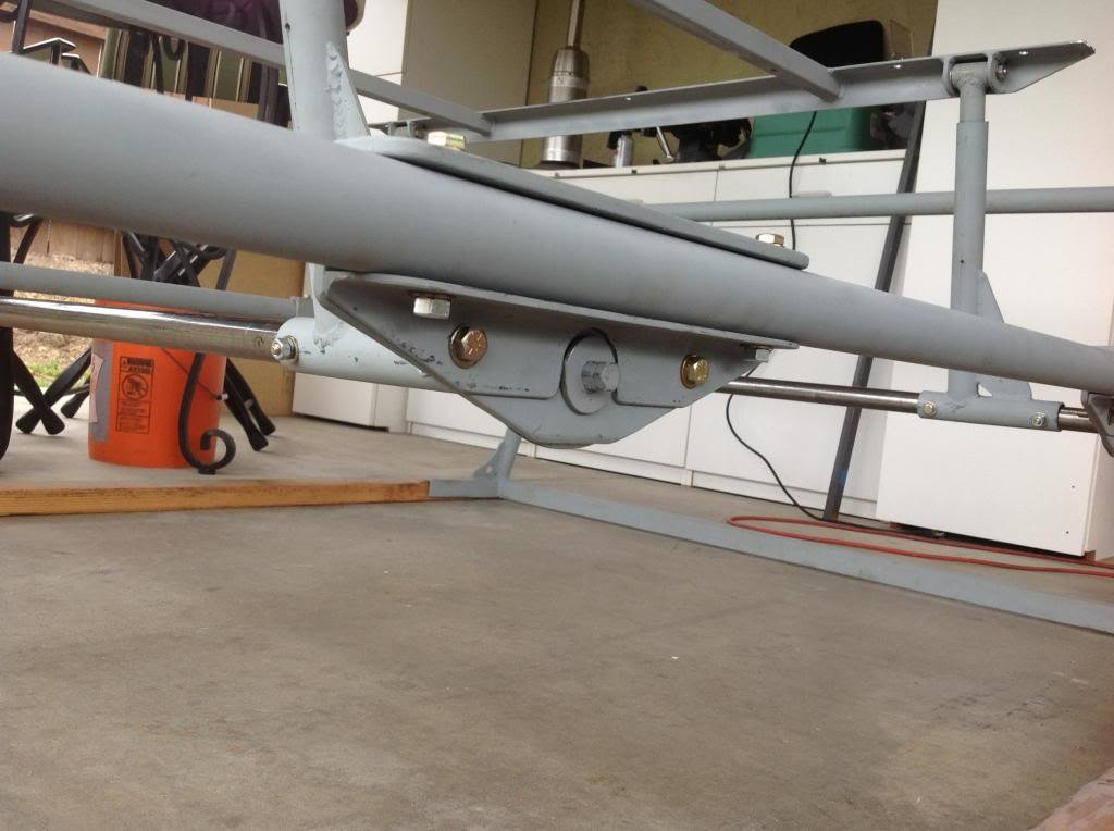

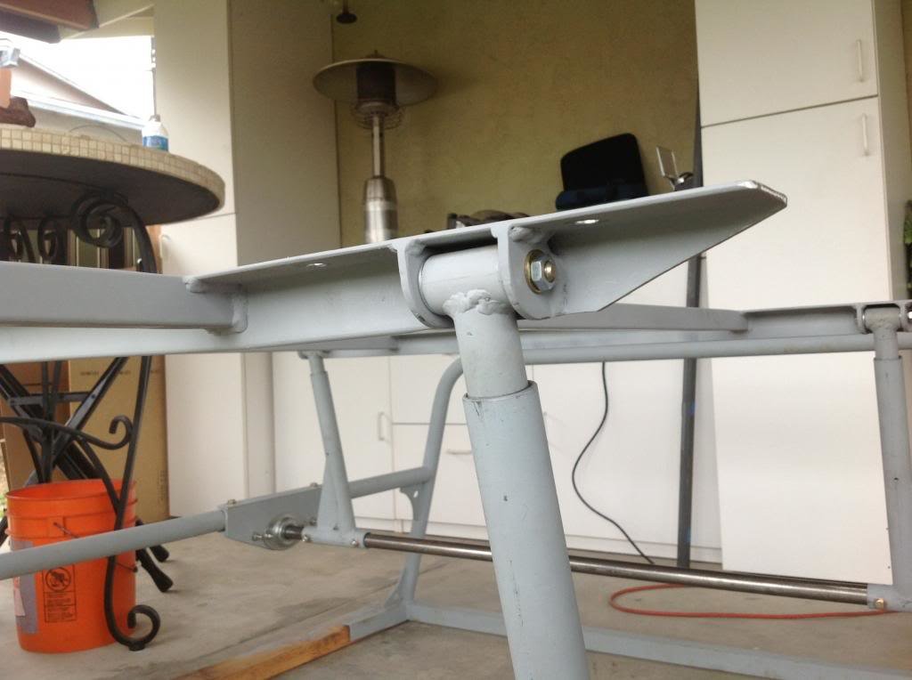

    The gas struts really make raising an lowering a one man job. I tried without the gas struts and even with two people it was a struggle to do it manually.

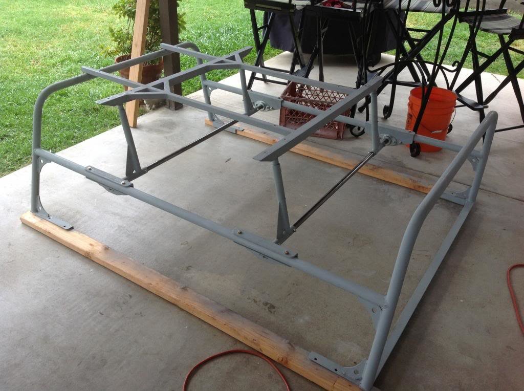

    I did away with the extruded aluminum bars for mounting the tent an fabricated a new platform bolted to the tent base. This allows me to hoist the RTT and platform off the rack when not necessary
    It's working out perfectly for me. Very secure when in the raised position, any movement while up there is in the truck suspension. My wife sleeps up there with me ;).
    Took me over two years to design and build this - I did all the metal fabrication, save for the tube bending and the welding, in my garage/backyard
    Enjoy your build :D

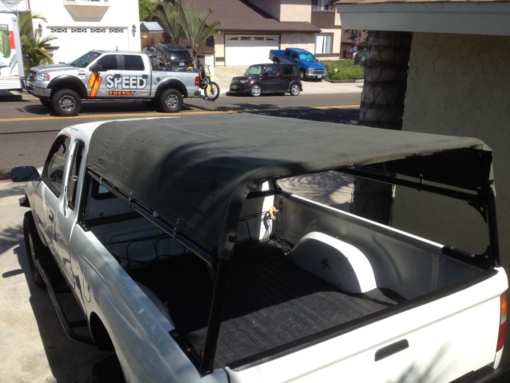

    I do leave the rack on 24/7. I've used it to strap my surfboards to and has come in real handy with lumber runs from Home Depot. Fooling around some, and I've created a 'safari top' using a duck cloth tarp, some 1/2" EMT conduit and some velcro and ratchet straps

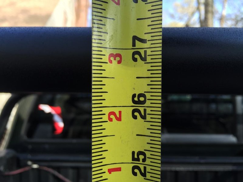

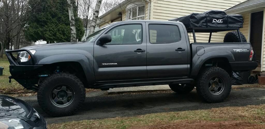

    Got the rack and tent all mounted up. Slept in it on Sunday night in the driveway. 10 inch rise above the bedrails and I have 26.25" of gear height with an OEM mat in the bed.

    Custom made bed rack. I have the Tepui Kukenam with no annex and I slept well in it the other night. Should add another couple nights this weekend.
