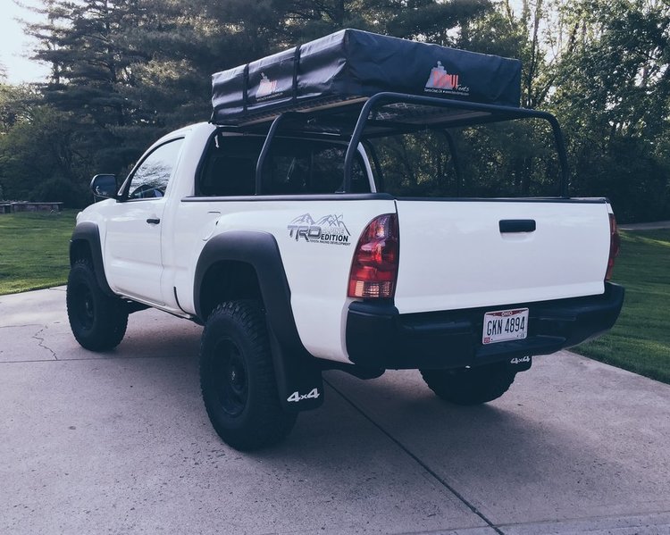

    Does anybody with an ALL PRO rack have their tent mounted like mine? It's definitely not centered on the rack, and about half hangs over the one side. I wanted to mount it as close to the cab as possible, but am a bit worried with it being so off center. ANybody else do this or have a solution aside from moving it back to the rear two tubes?

    Change the orientation of the rails. You can mount the, either front to back or side to side. Mount them side to side so you can center the tent.

    I have an allpro rack.mine is placed toward the front to allow room at the rear of the truck. It's not an issue. The rack has a full plate that runs the length of the bed. It distributes weight evenly.
    I ran it with my snug top without issue, however more crossbars would have been better to help distribute the weight. That or a prinsu rack like over my cab.
    To be honest having both, the pack rat rack is far sturdier than the snug top. Just my two cents. I don't worry about the fiberglass cracking from fatigue or my cap getting ruined anymore. And if I feel like it I still have the option to run it.

    How did you have yours running with the all pro rack? Most of the tent is distributed to one side, however it's not center. That's what I'm worried about. I could take it off and do it over again, but that's a pain, since I mounted the entire thing myself the first time. I thought about maybe making some sort of crossbar? Or, maybe it's ok just as it is. I'm just a big dude at 230, and don't want to ruin it.

    Get a good rack that disperses the weight evenly. Put your tent up there and enjoy it. As long as you don't get in the tent start jumping up and down you will be fine. Like mentioned before, sleep with your torso over the cantilevered part of the tent so less weight is on the other end.
