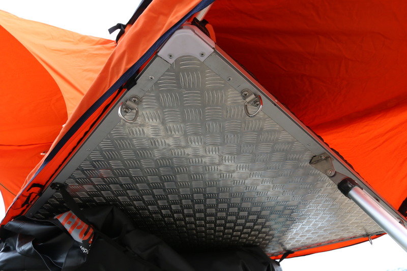

    It's not too hard to remove. You could always mod the mounting to make it quick release too. This isn't the best photo but you can see the brackets for the ladder. Just a couple bolts for each bracket. You're still going to be a very tight fit and I can't guarantee you'll fit in your garage even with the ladder removed.

    Thank you for that pic. I'm going to wait and see if anyone can post up real height measurements too. I don't mind taking ladder off and on whenever we will use it, probably like every other month or so since my wifey is a bartender and her weekend schedules are usually pretty busy.

    If you do a little fabbing you could gain an inch or so by removing the rails that bolt up under the tent and attach it to the rack. You can gain another half inch or so by removing your bedrail caps and allowing the rack to sit directly on the fenders. Removing the ladder still leaves the 2 brackets sticking up pretty much as high as the ladder itself, and without the ladder they would protrude into the cover and probably go through it eventually. Taking these on and off would be tiresome since you have to reach into the tent to get a wrench on the bolt heads.

    The measurements I gave you are pretty "real". Closed tent height is 12", the ladder is 2.5" thick at the thickest point but also has a small 'bumper' that holds it up off the tent base so plan on 3-3.5" for the ladder.

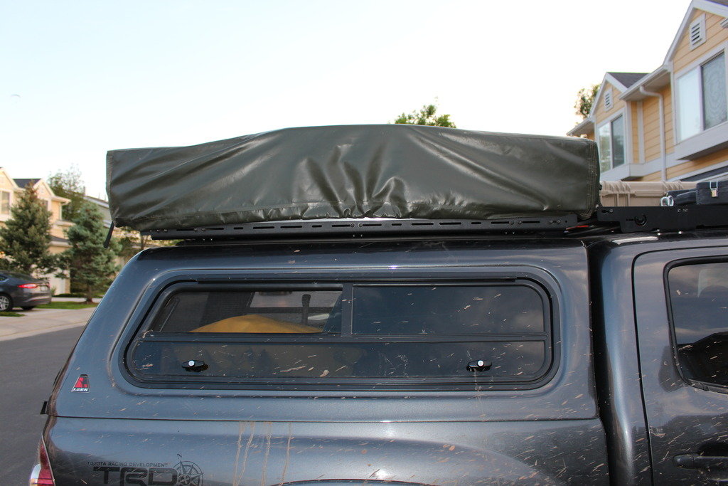

    I am keeping mine on pretty much full time now. I will remove it if I need the rack for other purposes but for most of the summer it will stay on the truck. I really don't notice much of a difference in fuel economy with the tent on or off. I hit about the same mileage before I have to fill up regardless. I do however, have my tent about as low as it can possibly go though and have other cargo in front of it that deflects the air over the tent.

    That tent is really low profile. Mine seems to ride high for some reason. Now that you mention it i got about the same fuel economy as well on our trip. I have 4 eye hooks in the cieling of my garage so i just back in to the garage and hoist it off pretty easily. I also use my rack for other things on the daily (bikes, kayaks, wood, metal, etc).

    Yeah my truck won't even fit in my garage without the tent. #townhome problems. When I have a real house the tent will probably be more temporary and I will have a setup like you are mentioning.

    is that the original cover for that tent?
