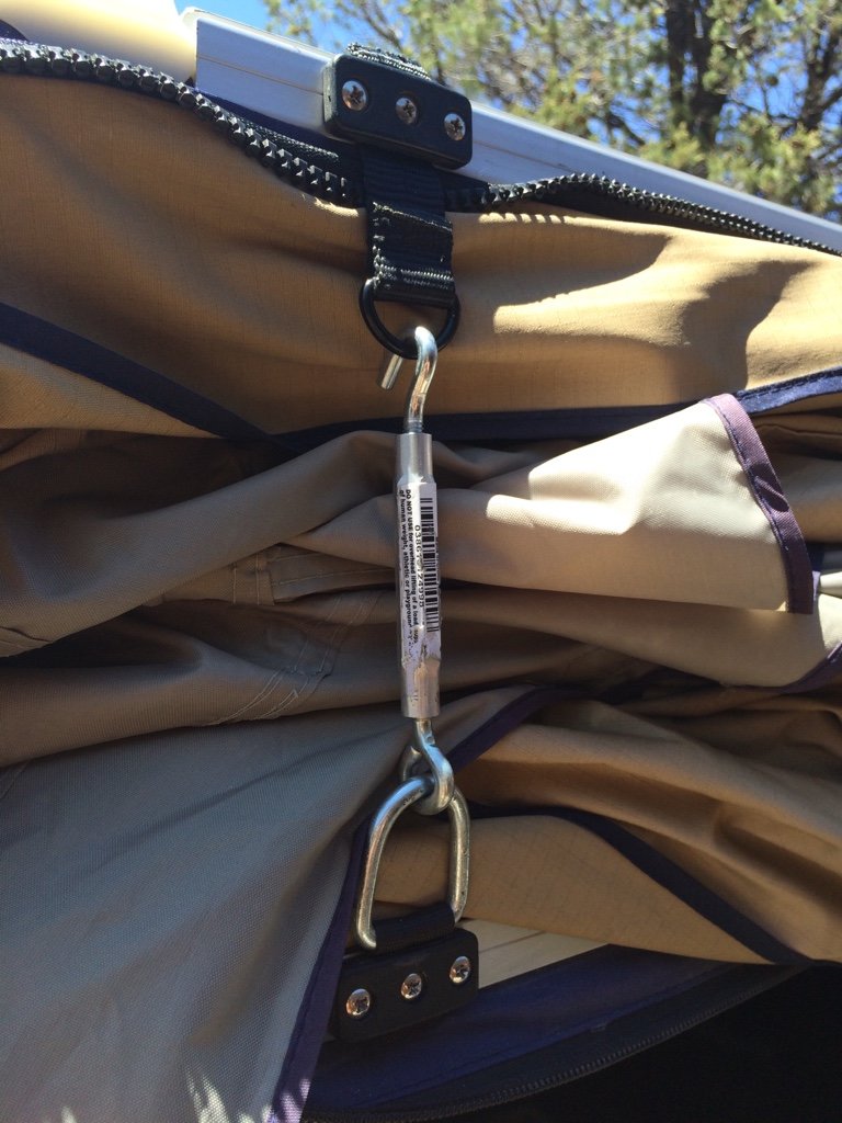

    The cinch straps on my Tepui started to tear, so I thought I'd swap them out. I don't have a sewing machine to restitch the Velcro but this looks like it will work pretty well. Just a quick 5 minute DIY if anyone is interested.

    great idea, even with just 1 sleeping bag in mine its a pain to close, the velcro just wont hold. whats the length on that middle piece?

    3". No bedding and no fabric tucked in, and it holds just right when the tent is empty. I extend it out a bit at the beginning of the trip to account for how much bedding we load in there.

    Lol, you guys bring the decorative pillows and matching down comforter and stuff with you?? Can't say I've ever had this problem, but then again I just leave two bags and pillows in there. Good idea btw on the straps, will definitely keep that in mind if mine ever fail.
