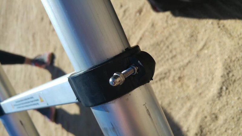

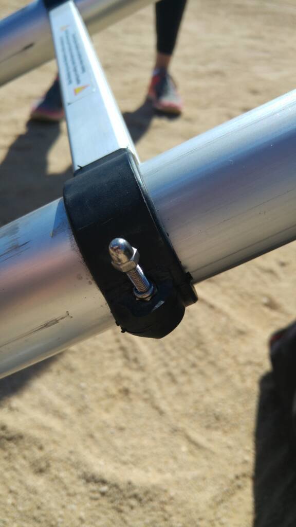

    Alright another strike against tepui.
    Some old advice is ringing true that I ignored before buying- telescoping ladders are great, but will fail you.
    The simple slide rail type can't jam up with sand or use.

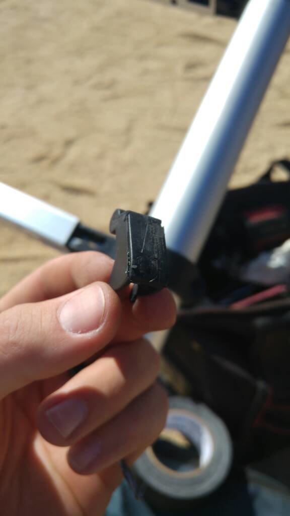

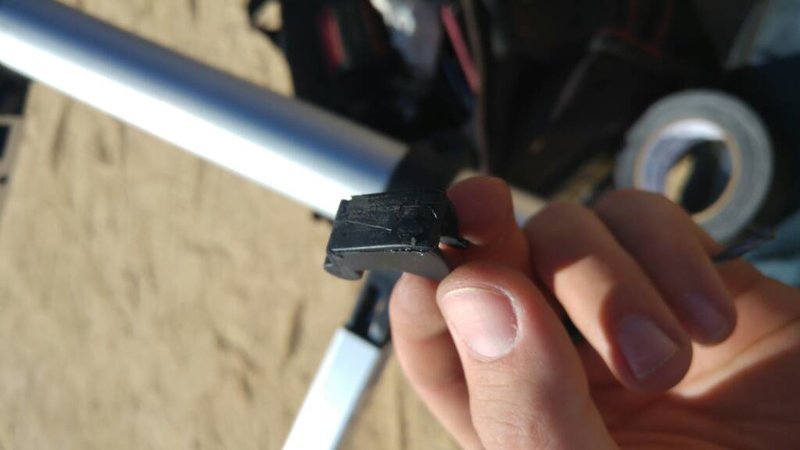

    Mine sounded crunchy and has some obvious marks where sand is in the joints. Then it decided to just stop halfway collapsed when the tab broke inside the rung. I couldn't fold the thing up, so I couldn't close the tent and drive. One stupid POS Chinese plastic tab held my day up for an hour while I played McGuiver

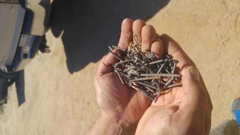

    Unfortunately, I thought loosening the outside bolts would let me pull the parts out of the rung without disassembling every other rung. Of course, I started loosening it and the fucking thing seized up and spun inside the retaining slot. I couldn't tighten it back up and now the whole rung was loose so I couldn't ignore it. Had to cut the plastic out till I could get vice grips on. Luckily the nut was useable and it matched the bolt from my gopro mount.

    I drilled a little hole through and used a the smallest nail we picked up in camp as the tabuploadfromtaptalk1458532547188.jpg

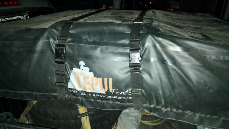

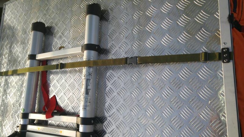

    Got home and spent some time fixing buckles.
    Damn strap that held the ladder down broke first day I had it.
    Velcro straps that close over the cover haven't really held shut since I put the 1/2" foam mat in. They wore out and got frayed in the Sun and I got sick of them popping loose on the highway and flopping the straps around. Never really made sense to me why they cinched shut on the hinge side rather than the side you need to cinch shut. uploadfromtaptalk1458533049900.jpg

    Honestly the buckle isn't a huge deal and not something you could ship me in-
    Both ends of all buckles were pop riveted in and sewn neatly around the broken buckle. I drilled em out and replaced it all with new webbing and left the ends open under the slides. Now breaking them can be a field repair.
    I'd suggest going this route - simple and replacing a broken buckle takes 2 minutes.

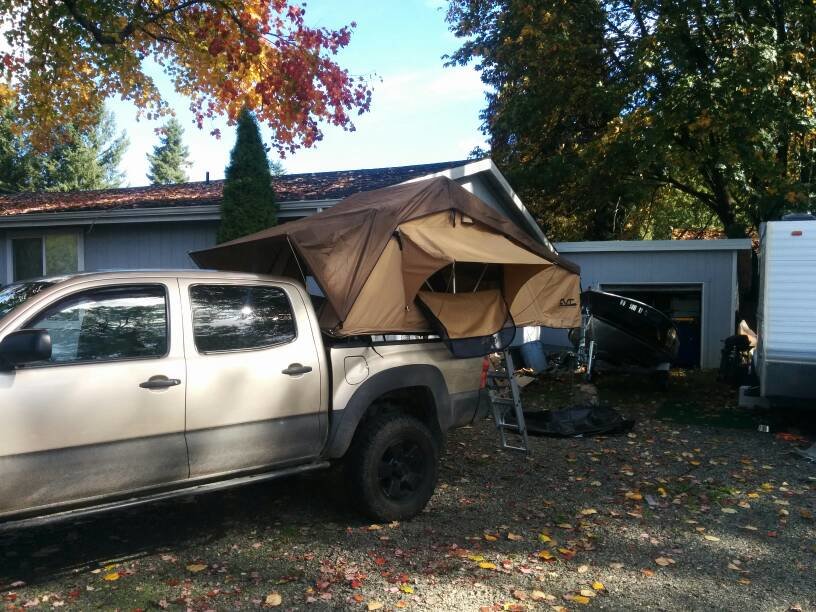

    I had mine like that for a bit. Worked fine. Just needed to drill new holes to lock the ladder in place.
