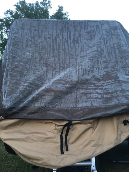

    image.jpg So in Yosemite it got to 34 degrees at night, tent had frost all over and in the inside the walls of the tent were wet. Anyway to not have this? My blankets were wet as well :(

    Had you sprayed the tent down like CVT says to do to make the fabric swell a little bit?

    Those are tough conditions to tent in. Humid there? Camp near a body of water?
    I would suggest increased air flow in the tent.
    Check out to see what features a 4 season tent has and try to incorporate them, if you can, into the RTT.

    Make sure you have all the vents open. The water inside is from you breathing so other than venting the tent it can be hard to really eliminate.
    Though you make it sound like you had a ton of water

    Any tent requires some ventilation to avoid condensate buildup. Even a tiny bit will work wonders. Best thing to do in the colder conditions is use a weather hood for its insulation and water resistance. The weather hood will let you stake the corners out so you don't trap moisture in the tent.

    No? That wasn't a joke about soaking it?

    Weather hood? The tarp

    Nope not a joke... you lightly spray the OUTSIDE of the tent... Says so on CVTs website...
    The joke I made about removing the matress to spray the inside was the only joking part
