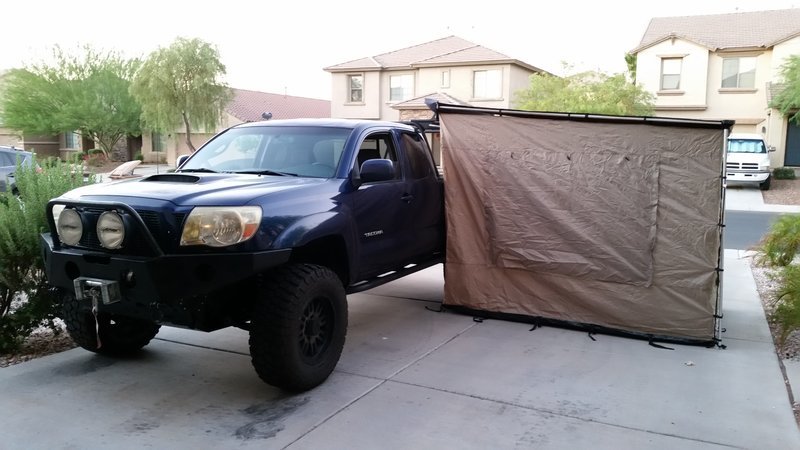

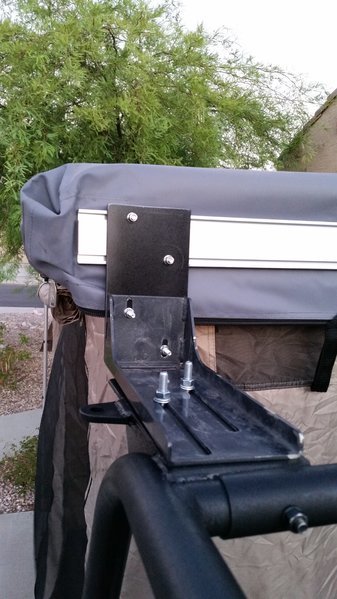

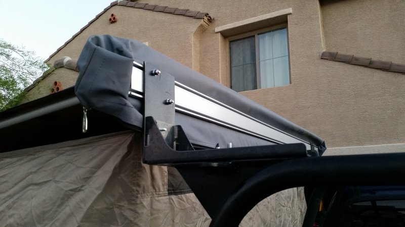

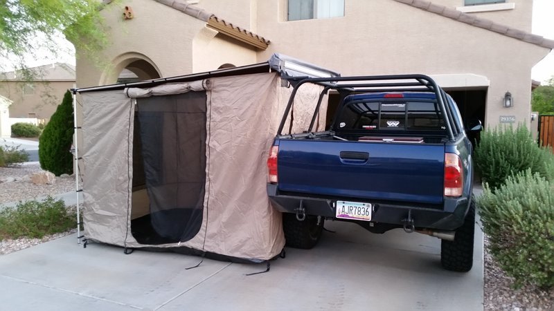

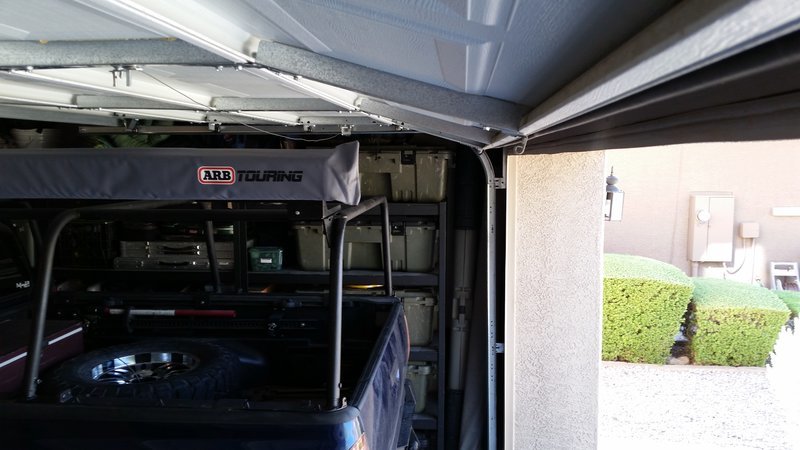

    Not an RTT subject, but close enough. When my RTT is loaded for camping, I always have the ARB awning. Bought the tent body for the awning, but my brackets on my bed rack were still a little too low so we fabbed up some new ones yesterday and got it to the proper height to hang the awning tent perfectly. It's the new basement to my RTT instead of using an annex.
    Fabbed up a 3/16" steel platform to the bed rack, mounted the ARB awning bracket to that, and then fabbed up a 7 1/2" riser plate to mount the awning to. The ARB bracket has 6" long slots in it so that I can loosen 2 bolts and slide the awning further away from the truck to get the awning body to hang vertically. Stows back in closer to the truck up against the RTT for travel.
    We welded a new CB antenna mount to the rear bracket, too. You could tow an ATV from that thing.
    The awning tent body has a higher side closest to the truck so that the awning slopes down and away and sheds water.
    Barely fits in the garage by 1/4"

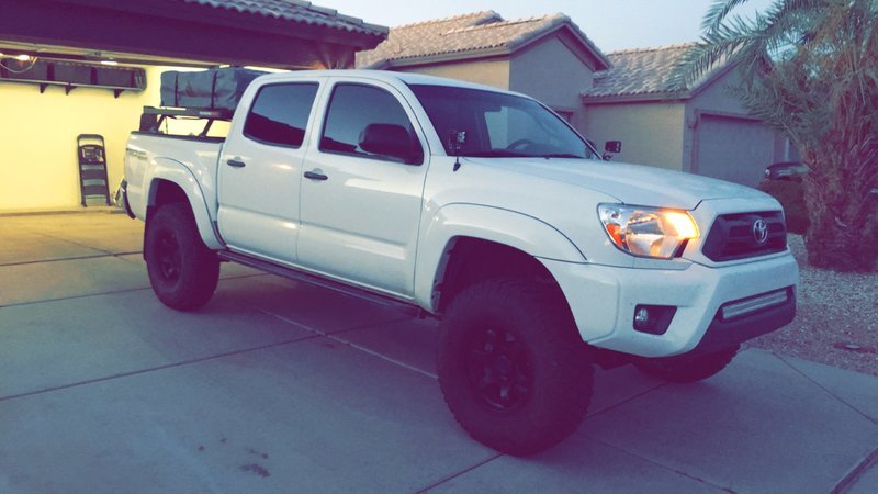

    New bumper going on next week with new lights. But this is how it sits currently... Got that bro lean. Yeah need new leafs....
