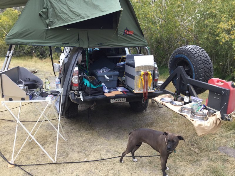

    Looks great! Welcome to the #cvtfamily

    Love photos like this. In Montana?

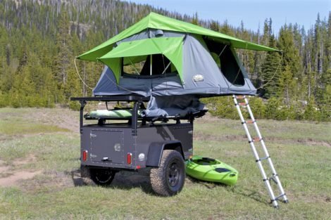

    So, I ordered a FSR original large tent from Tim at FSR. It should be in on Thursday. Tim was very helpful and even sent a video of him opening the tent with one hand. The size large opens to 78" x 96". When closed it will sit right over my long box. I'm super excited to join all of you in the RTT world and I already have 3 trips planned!! I found FSR in the group buy on this site.

    Yep, in West Yellowstone. Another member was in town on vacation, had to stop to say hi

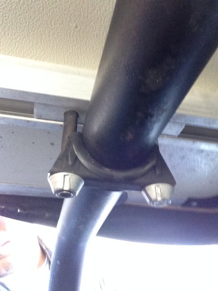

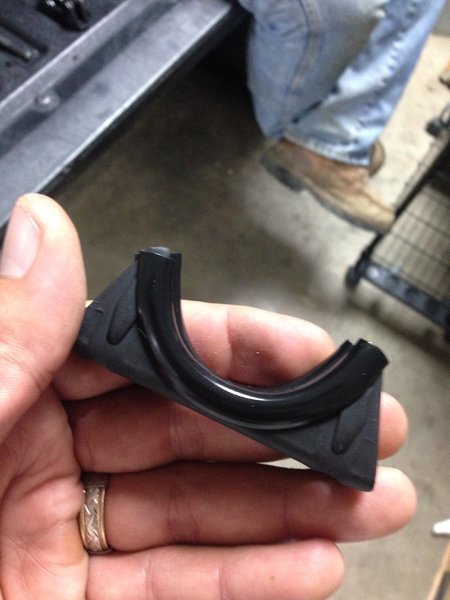

    @doreydeluxe
    Here is a picture of the security nuts and the u shape exhaust clamps we used. i hope this helps image.jpg image.jpg

    Where'd you get the exhaust clamps?

    Advance auto. There are like $2.00 a piece and the black door seal to cover edges on the clamp was another $2.00. 1 can of black paint and good to go. Spent lest that $15 on these things.

    I like that exhaust clamp idea. I was never really happy with using the normal flat u bolt washers and bending them around the bar when tightening the nuts up.

    It works pretty good. I know what you mean with bending those. I also had te problem of the rtt moving sideways during short trips. After we did the clamps with then rubber piece never had to adjusted or moved again

    I just got longer bolts that way I didn't have to bend the metal piece

    My bolts are plenty long enough but the tent didn't feel secure without torqueing it down to the point the flat washer bent.

    Oh I gothca, yeah my tent doesn't move and the washer is still fine :notsure:

    ill probably be doing something similar!! nice work

    Same. Although I have square bars.

    Thanks! Looks like a great solution. I've been meaning to find some clamps that'll fit my Yakima round bars. Not real happy with how the flat stock works with the round bars.

    That is a great way!
