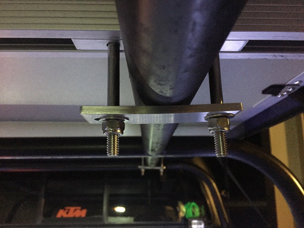

    Attaching the RTT to my all-pro bed rack, and it seems that there is extra space between the vertical bolts and the bed rack tubing(which is 1 3/4). This is due to the pre-drilled holes in the included rectangle metal bar, which i could easily redrill new holes. But is it ok up there like in this photo? Seems like there would be play for it to move, even though its attached tight. I will probably get those exhaust clamps which seem to conform better to the tubing, rather than bending up on those metal rectangle plates.

    I did some pretty bad washboard roads and some trails this past summer, and my tent didn't move one bit. The rectangle plates were bent up a bit by the tightening down of the bolts.
    I do have square tubing, however, but the same gap between the bolts.
    My .02.........YMMV

    I am on my 5th season with my RTT. My mounts look exactly like that and they have never had any issues or any movement. You will be fines if you have them snugged down.

    I tightened mine down a hair more, my flat piece isn't really flat anymore. When I tightened it down and kept it flat, I was able to shoulder check the RTT over along the All Pro bars, meaning it wasn't tightened down enough. I believe someone posted a couple months ago a different type of mount designed to be mounted on bars. Something that replaced the flat piece and cupped the tubing. Can't remember the name of them off the top of my head. Not U Bolts.
