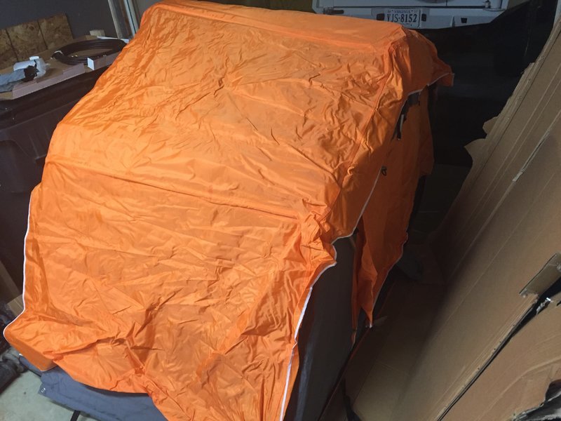

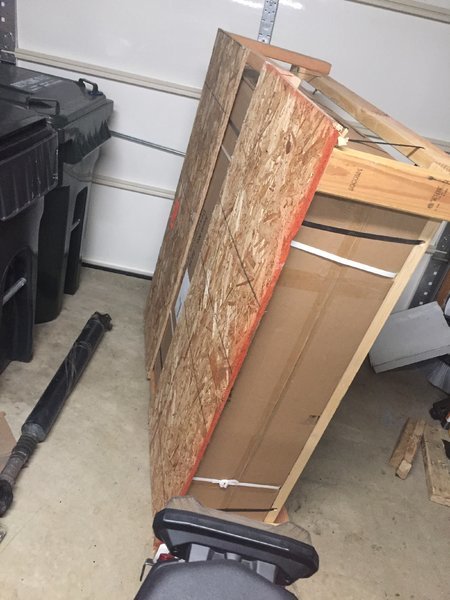

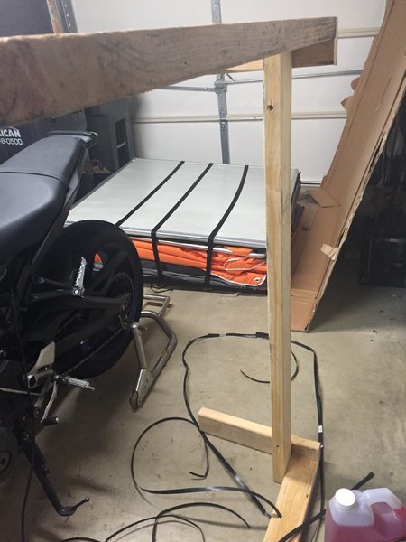

    :D Didnt get it mounted yet because no one to help me lift it onto my bed rack. Hopefully tonight in the snow.
    A downside of single life

    Spend the night in the garage?

    The tent did.

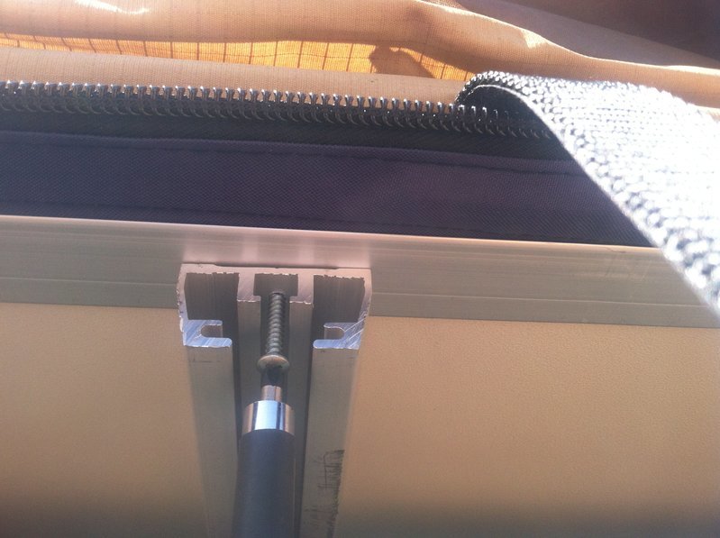

    One thing that I wanted to note about Free Spirit Recreation, is that there were no instructions for the rails, tent, or the ladder hinges, online or in the tent. I had to look up some generic ones online. I still dont know where the 4 self tapping screws go. Maybe they are for the ladder? I figured out how to mount the rails. And the clamps go on my bed rack. After I get that mounted, I will figure out the ladder and all the other supports

    That is kind of an issue with all of them..... I had three different tents and they never came with useful instructions.....
    The screws actually go into the end of the tent rails and connect the rails with the base.

    No clue how necessary those screws are to be honest. As far as I know, my dad never put them in his tent....

    do they go from the rail to the base? or the other way? there are no other holes in the rails

    From the rail into the base. The selftapping screws are supposed to make said hole. I pre-drilled it with a small bit , so the screws go in straight.

    They are very necessary. They will help keep the tent rails on if the nuts come loose. Just call it a safety feature. :fingerscrossed:

    They are self tapping. You can pre-drill just make sure you use a way smaller bit.

    Thank you for the picture! Dummy me would have put them in the middle, and that would have been pointless! I think I need to remove the cap that I have installed on one part of the rails, to put these screw in.

    Interesting. Geo does not have those screws... What size are those? Might consider grabbing a few to add said "safety feature."
