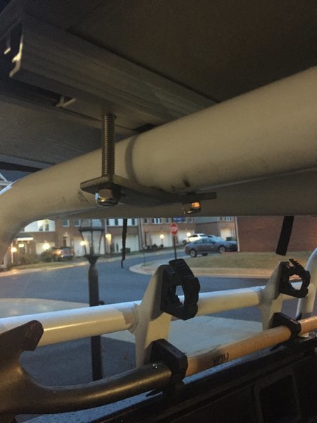

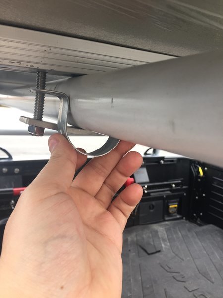

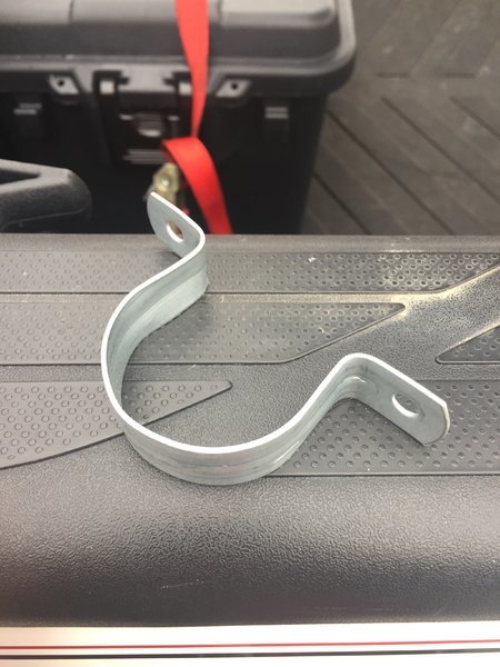

    Im going to throw a piece of rubber in between, but these should work

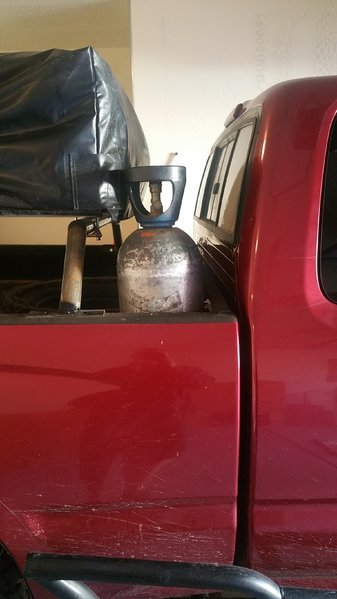

    I use exhaust clamps to bolt down my RTT.
    This is the best picture I have now.

    Front- Camburg 4x4 Long Travel 2.5" King Coilovers 2.5" King Triple Bypasses Wheelers Superbumps Rear- DMZ SUA 16" 3.0 King Triple Bypasses 3" 2.0 Fox bumps Wheels and Tires- 295/75/16 Toyo ATII XTREME SCS SR8 Dark Matte Bronze 16" Lighting- (2) 30" Combo light bars (4) Iggycorp diffused pods Tepui Ayer TRD Supercharger URD Mark III 3" Exhaust URD 4x4 Y Pipe URD CAI URD 2.85 Stealth Pulley Hurst Core Shifter with Hurst T URD Stage 3 clutch URD Lightweight flywheel URD Throw out bearing upgrade AEM Wideband AFR Gauge Speedhut Boost Gauge Craven Speed Flex Pod mount Weathertech Floor Liners BAMF Sliders Ultragauge sPod SE ARB CKMTA12 Hella Supertone horns Relentless Tailgate Reinforcement
    those seem pretty thin gauge to be supporting the tent. I know they aren't supporting the weight vertically, but once you get up in it...plus wind...Id want something a hair more stout for a grand or two worth of tent lol.

    I like this idea. Anyone ever used exhaust clamps like this on Yakima round bars?

    I like that eyebolt and pad lock idea!:thumbsup:

    I just thought that it would be better than what's there now.
    Meh, those slightly bent bars are all like that. Maybe someone from @TepuiTents or @Cascadia Tents can speak up to what sort of torque those are meant for and if they're supposed to deform like that?

    Some slight deformation of the flat bar is fine. Similar to what is in the referenced photo. That should be plenty tight to keep the tent secured and tight.
    The bigger thing is making sure the bolt threads are engaged fully in the nylock nuts. Ideally, 2-3 threads exposed past the end of the nut.
