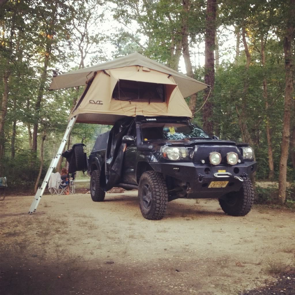

    Looking for some advice on mounting a RTT on my '12 Tacoma...I'd like to put it over the bed but I have a Pace Edwards roll away cover on my bed and would need a good solution to mount a bed rack over that (if possible)...Any ideas?
    Otherwise, I guess I can put the RTT over the cab but here's the follow on question...
    The THULE site shows the max load for my fit kit / bars as 110 lbs??? Obviously with us in the tent and the tent weight itself, we'll be well above 110 lbs. What are most folks using to mount the tent over the cab?
    Thanks for the help guys.
    Rob

    C6450B0B-349D-4BCB-AB3F-34FFD03C0998-140_aa966280e37a0d062e49ca1364e621fa3a1a74b7.jpg
    Thule's weight rating is designed for the maximum speed that your vehicle will be traveling. With the wind resistance that increases the stresses of 110lbs to way more than that. I've never seen a "this is how much weight the roof rack can hold while parked" but me, my g/f, and our dog sleep in ours and there is absolutely no worry in my mind about the amount of weight on the roof rack.
    I also believe that the weight rating is for a fixed point on the rack. for example if you were carrying a heavy piece of pipe it will have a small contact patch on the roof rack, and the rack will bend if too much weight is applied. With a Roof top tent the weight is spread out much more evenly.

    excellent point Josh. :thumbsup:
    The Thule system is a proven winner for the cab.
    My only concern is adding the rail system to a cap that was not specifically built to handle one - I can see running into an issue going that route.
    For the cab Thule or Yakima make in happen. :cool:
