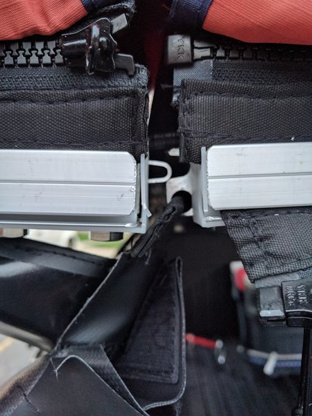

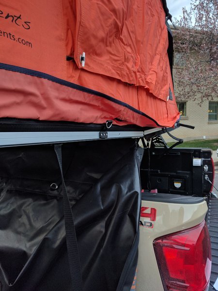

    IMG_20170406_194119.jpg IMG_20170406_194138.jpg Having a slight issue my rtt is not lining up in the channels anyone have suggestions? Tepui Kukenam Ruggedized only on the right side left side is mostly good.

    I had the same issue and I had to pull those straps( in my previous post) out of the way
    So they are to roll up the cover?

    Huh how did you do that ? It didn't look like mine were in the way I'm going to go out right now and take pics and try to fixit. I originally thought it was an issue with the anti condensation mat being bunched up

    Fold it up and make sure nothing is getting pinched first. Remove the anti condensation mat and mattress if you need to. Second would be your hinge if the one side lines up and the other does not

    Ok cool yeah only one side is having the issueill update shortly thank you guys for the help!

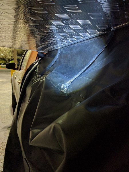

    Can't figure out what's up

    Thank you buddy, I shot them an email and talked to REI. Waiting for a response from Tepui I know they have great customer service. After all of my investigating I think it is an issue with manufacturing but I want to give them the benefit of the doubt to make it right. Waiting on response and will update soon.

    Re there two matching straps (without the D-rings on the other half of the base? I added similar straps to support the cover when I've deployed the tent. I can roll/fold the cover up so it doesn't drape down the side of the truck. Giving me access to the bed from under the tent - or lowering the cover to give SWMBO more privacy (my annex is only three walls)

    It should compress the rest of the way when you get in it. My CVT does that too
    Edit: or does it not line up whatsoever?

    No line up whatsoever

    Mine does that too... I usually get under and press up by the joint as I push the base into the other... I do it on each side. sometimes it doesn't want to do anything, but most of the time it slides in nice and tight.

    Got my issue worked out it was the straps that go inside the tent and hold the mattress Velcro on place they were too tight on one side
